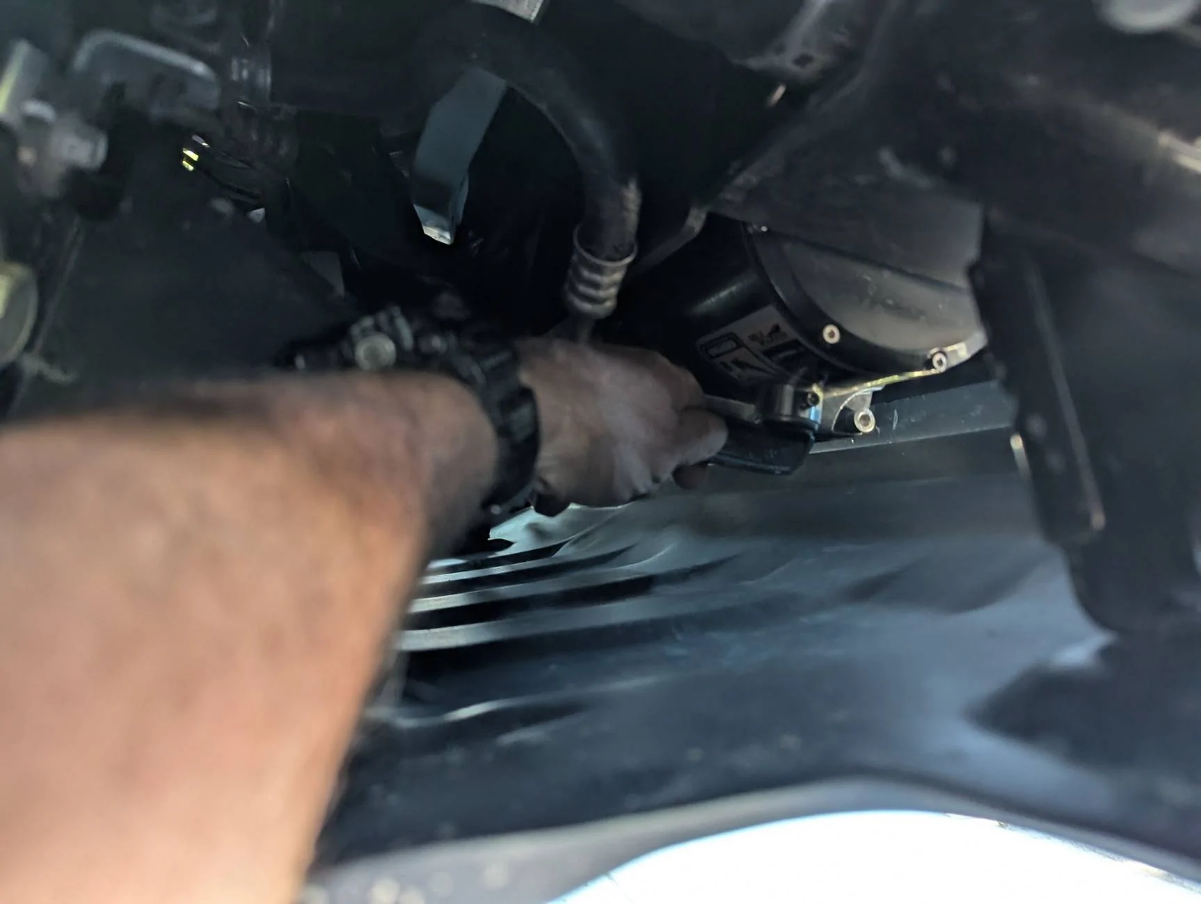

Didn’t read all the posts. How do you get to the winch lever to allow it to free spool? What about attaching the remote so I can move winch in or out?

Free spool lever is easily accessible from the passenger wheel well since the winch is inverted and the lever is at the bottom.

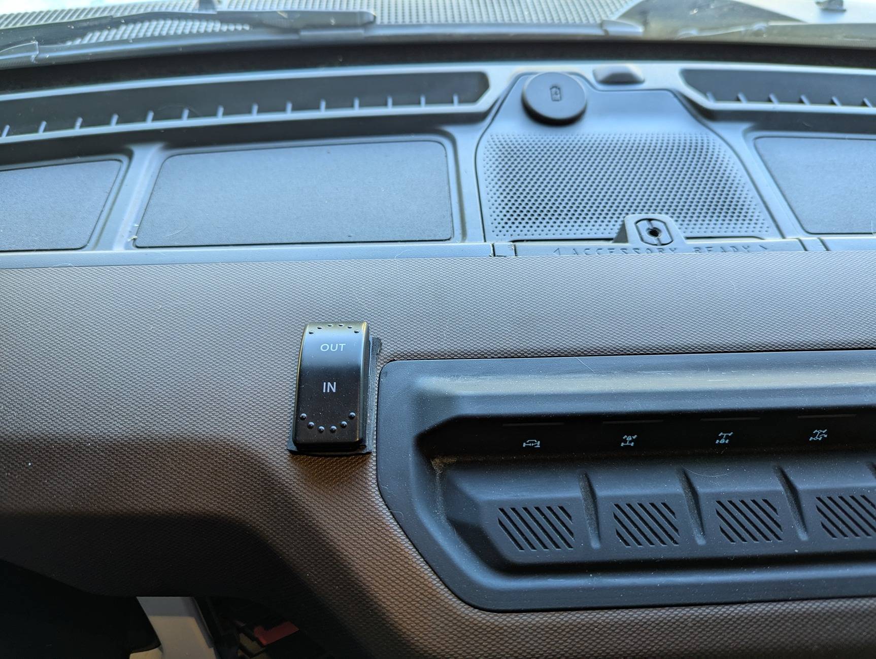

There is a capped plug for the remote that mounts right next to the fairlead BUT there is also a spooling switch that is mounted inside the cab. I mounted mine on the top of the dash right next to my hero buttons.

took these just for you....
first is the free spool lever. fairly easy to reach from passenger side wheel well.
Ford Bronco NEW Hammer Built High Clearance Hidden Winch free spool lever

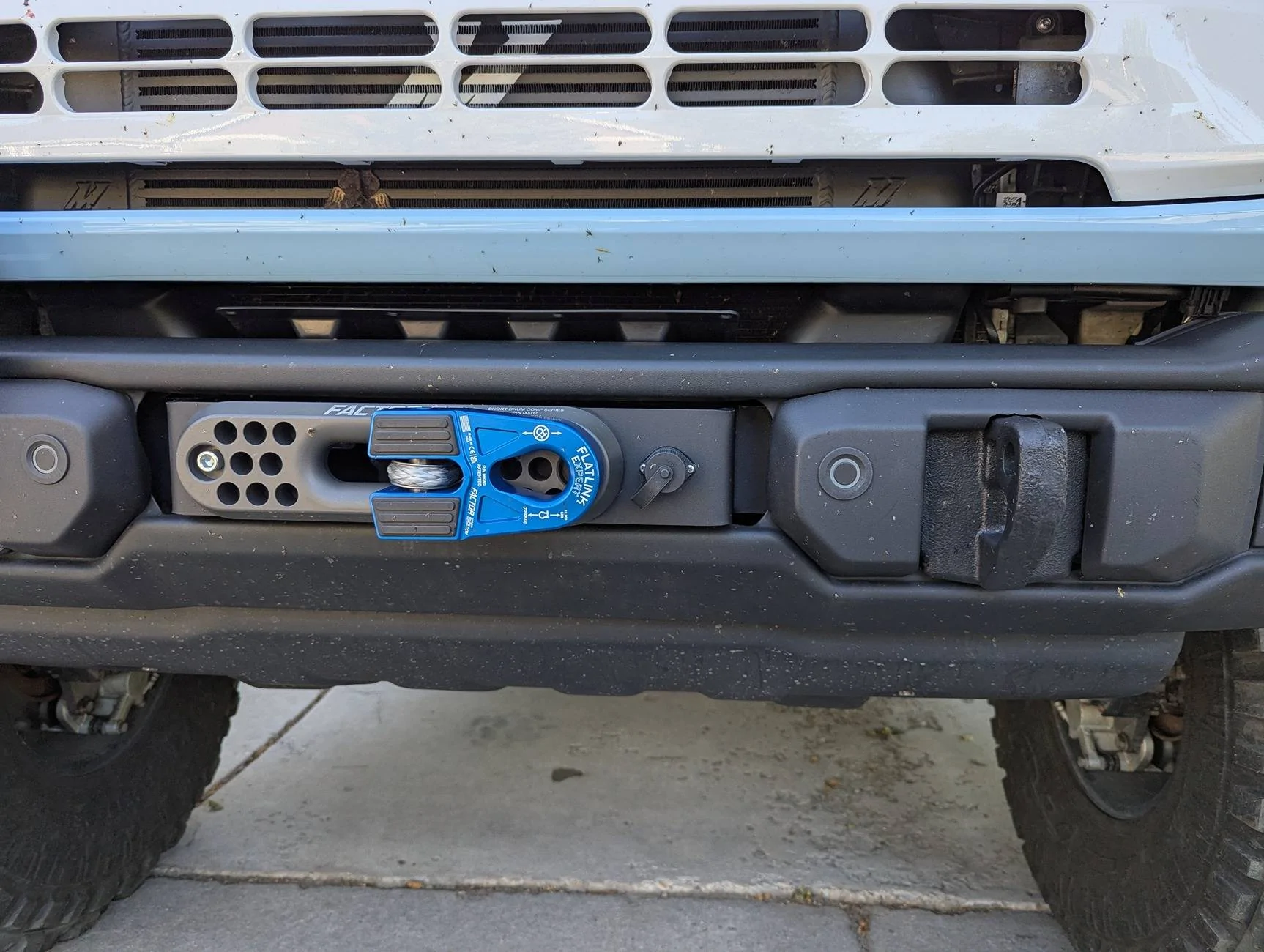

second is the wired remote connection... It is the "cap" on the right side of the fairlead.
Ford Bronco NEW Hammer Built High Clearance Hidden Winch remote connection
And then there is the in cab control switch.... I mounted mine on the drivers side of the "hero" switches on the dash.
Ford Bronco NEW Hammer Built High Clearance Hidden Winch in cab spooling switch

The lever can be accessed by reaching your hand behind the skid plate. One can also drill a hole in the skid plate to access it from the bottom
