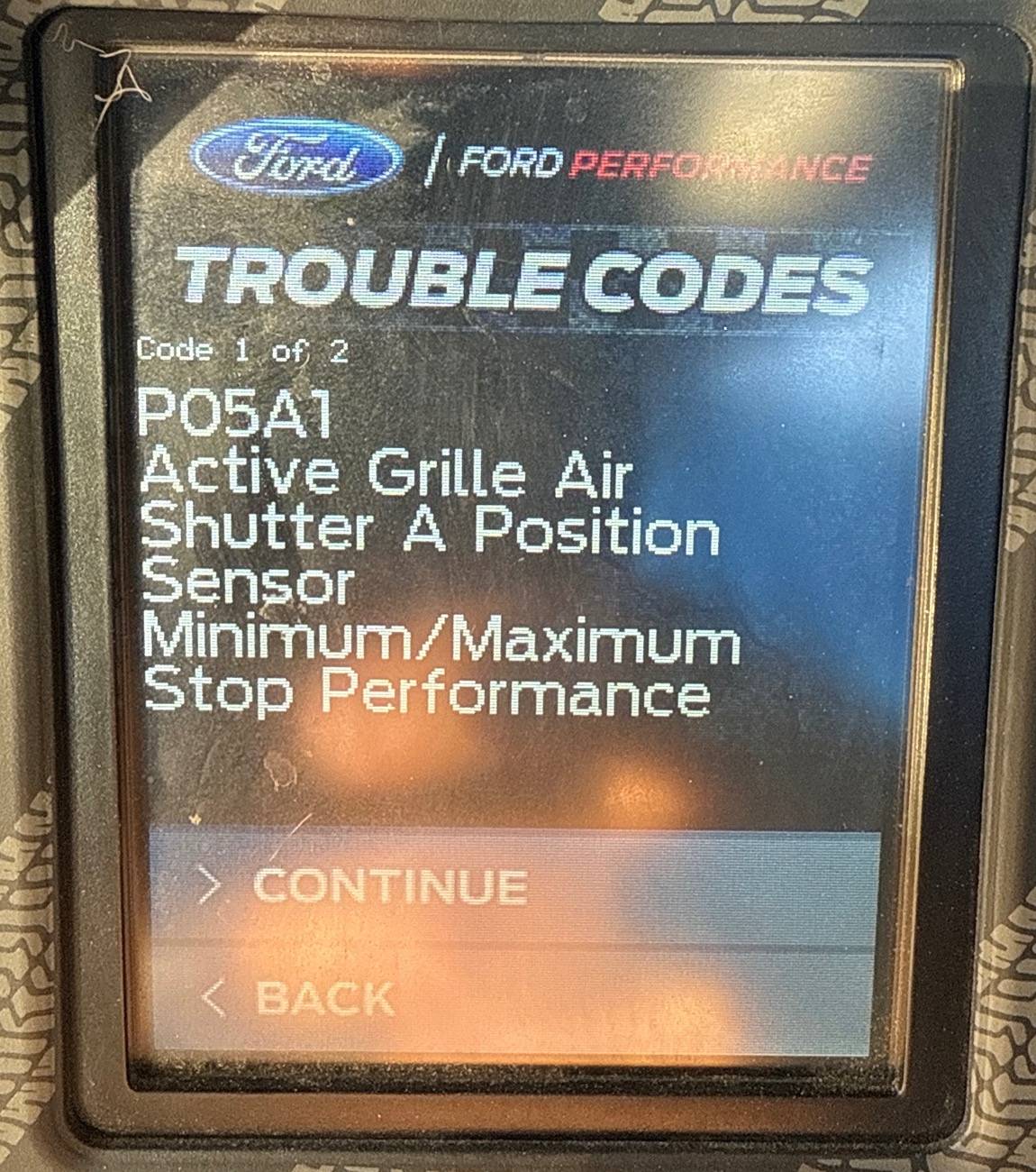

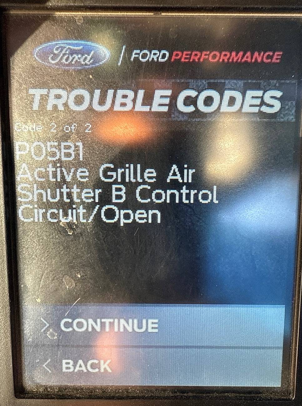

Here are the codes I am getting with it removed
Interesting. I'll have to double check mine when I get a chance tomorrow. Not that I'm going to change anything or really care since the Bronco operates great without them, and they definitely are never going back in.

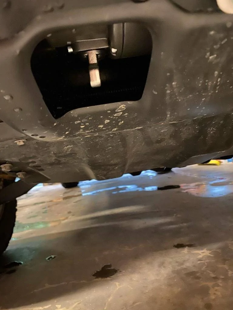

By mounting the winch upside down, it places the lever in an accessible position. There are some situations where it might be a little difficult, due to the width of the stock skid plate, but it’s better than being completely obstructed and inaccessible
I don't disagree, exactly, but personally I prefer being able to cover my winch up almost 100% and avoiding clutchlock from water intrusion that then freezes and/or snow slush berging up around it.
The AEV Colorado Bison has a similar issue with a feet forward mounting and reclocking to a downward clutch access.
Ford Bronco NEW Hammer Built High Clearance Hidden Winch 1741633027149-l3
When you're working within the OEM design, you just end up having to make sacrifices. Nature of working within those specific limitations.
The fact that this works with your bumper AND OEMs is amazing design work.
A worthwhile tradeoff, IMO. Clean lines, better approach angle, and protection > super easy access to clutch lever
