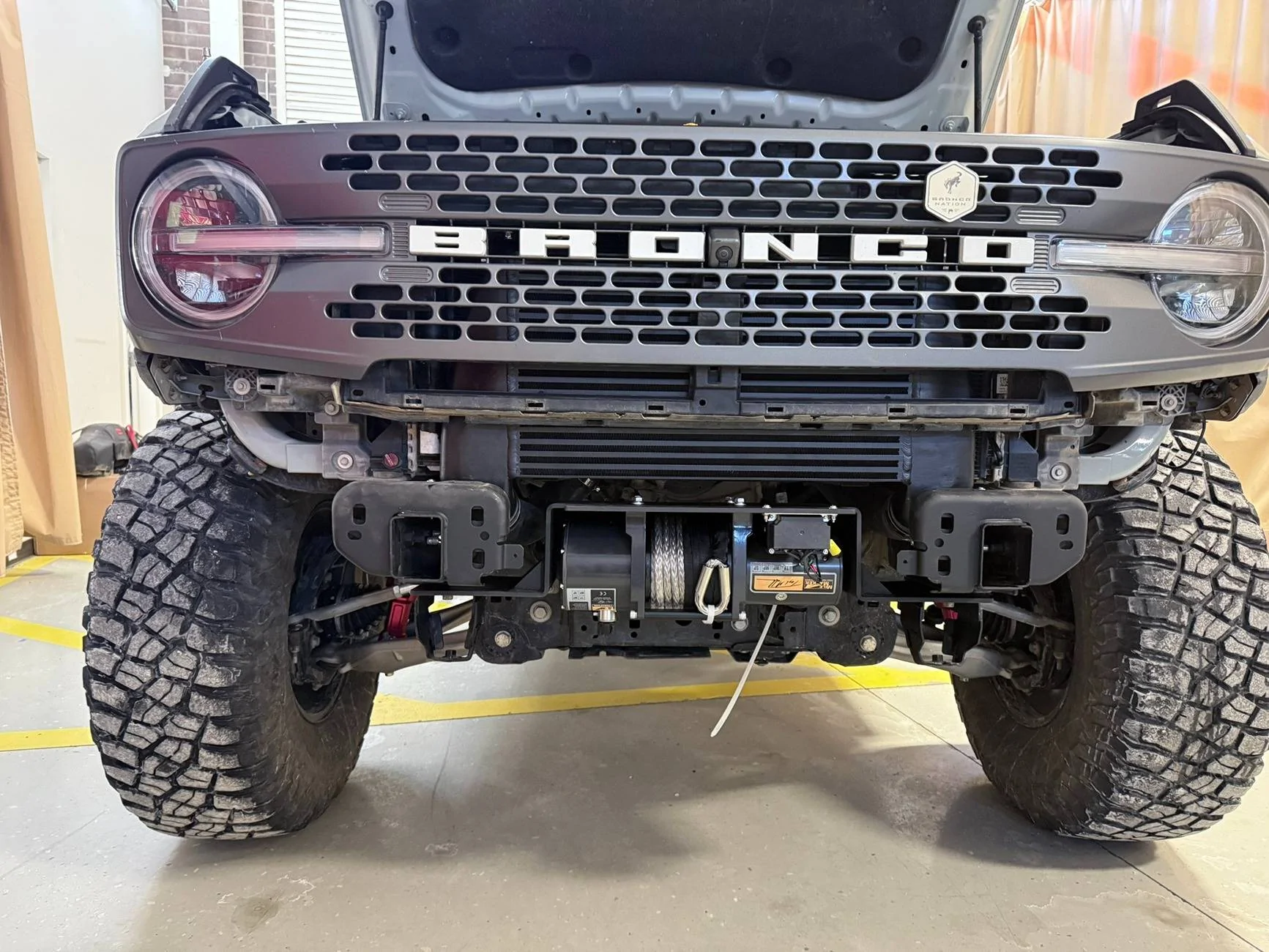

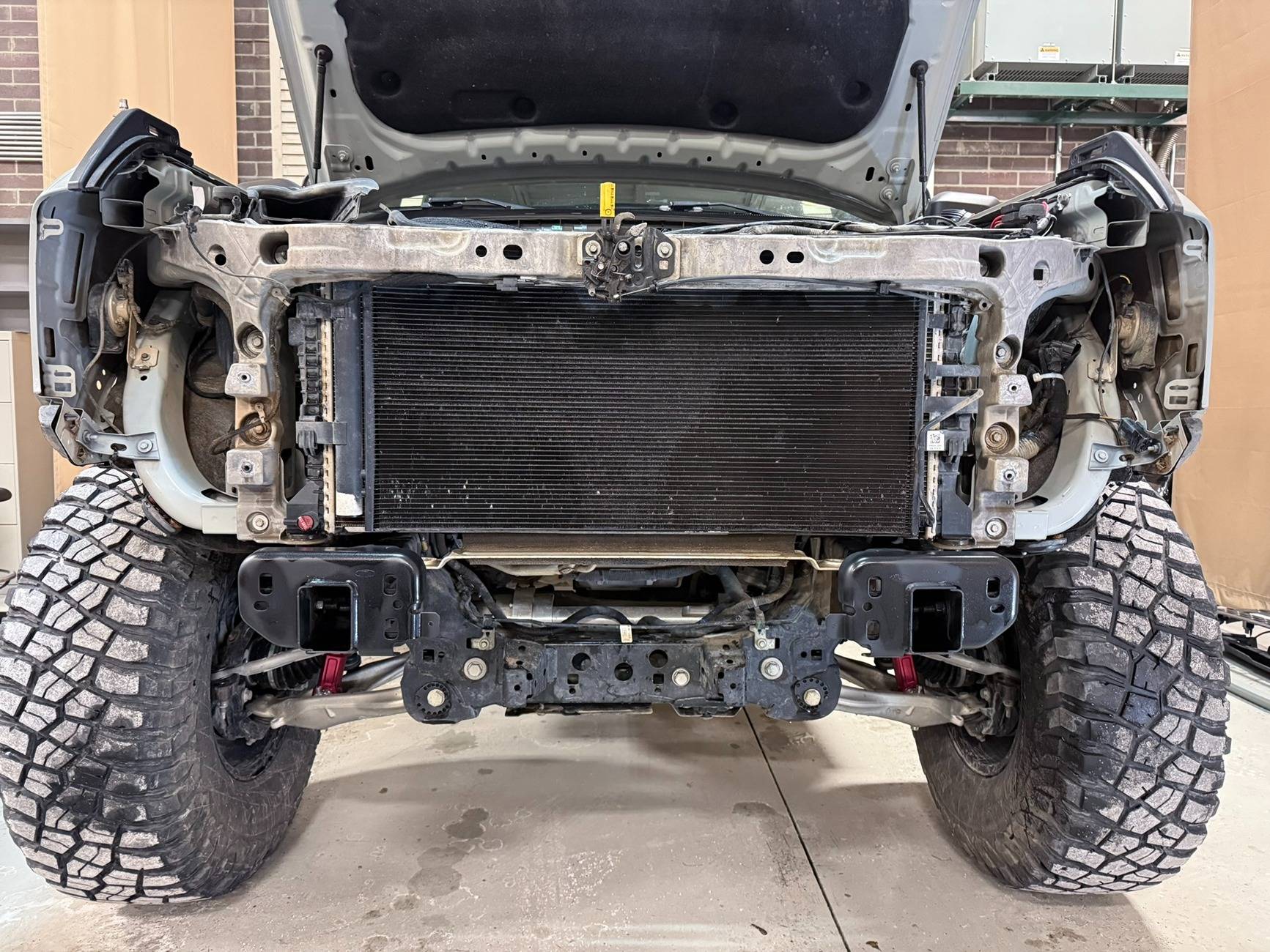

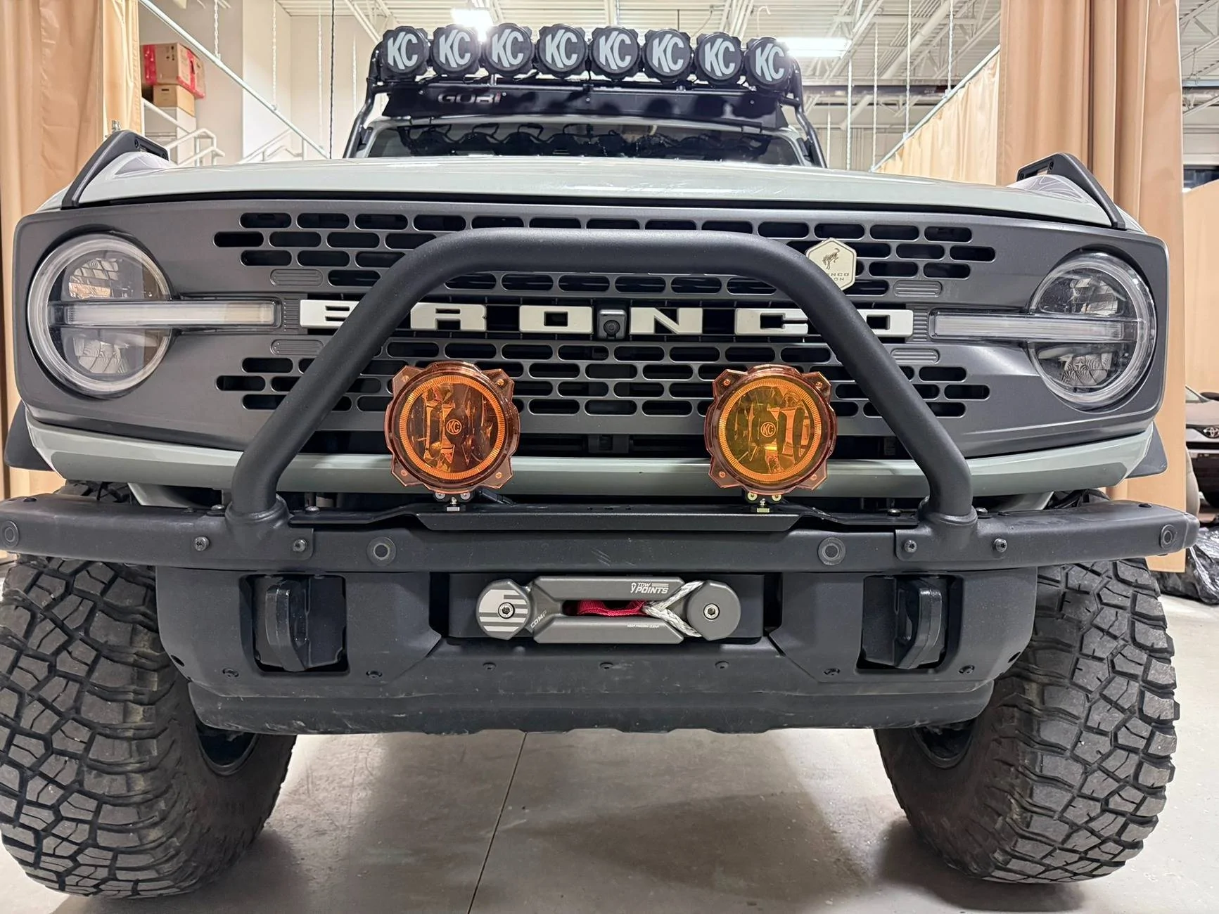

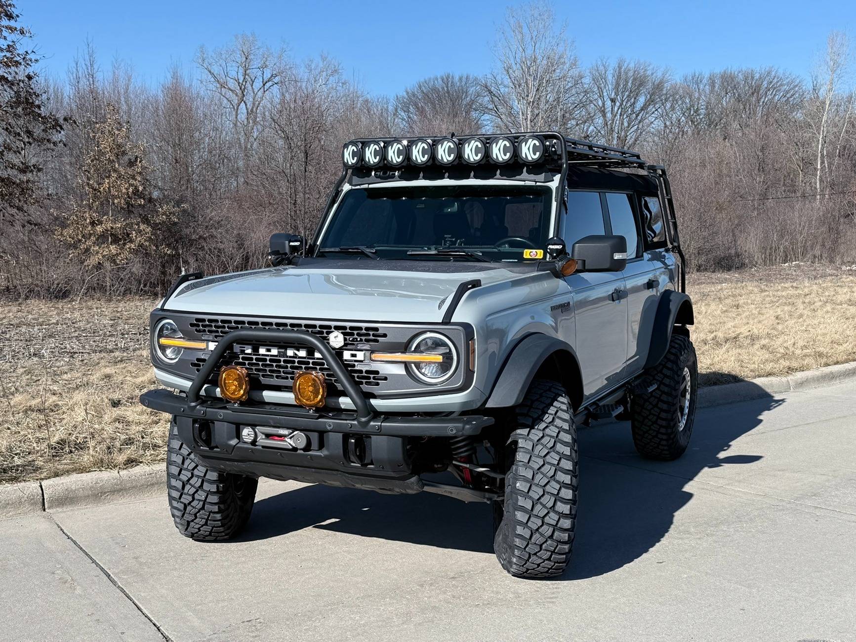

Hey all! I had the privilege of installing this hidden winch mount on my Bronco and I could not be happier with how it turned out! From the time Alex first started mentioning the possibility, I knew it was the answer to repeatedly smacking my previous winch mount on ledges and climbs. That winch served its purpose, but I wanted more clearance.
Alex and HammerBuilt really did a great job on this project, all around!

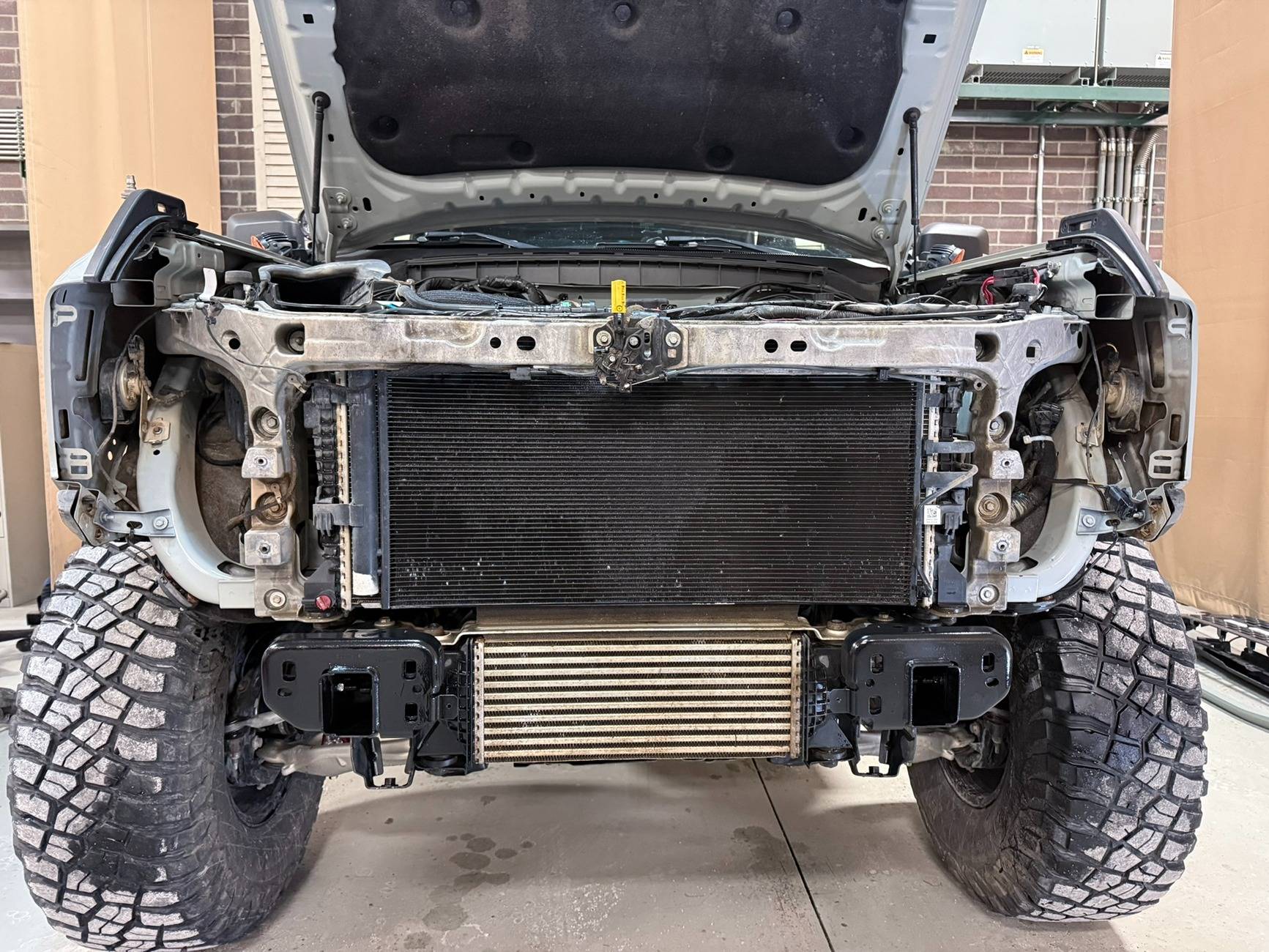

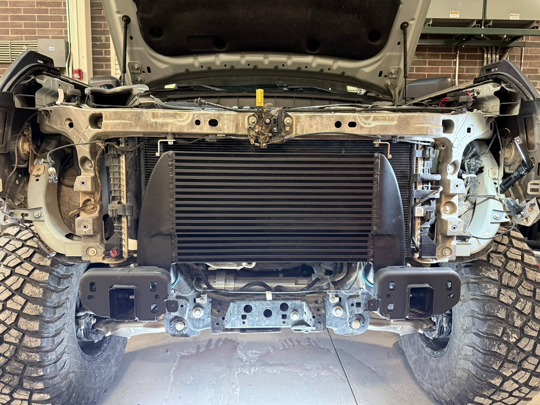

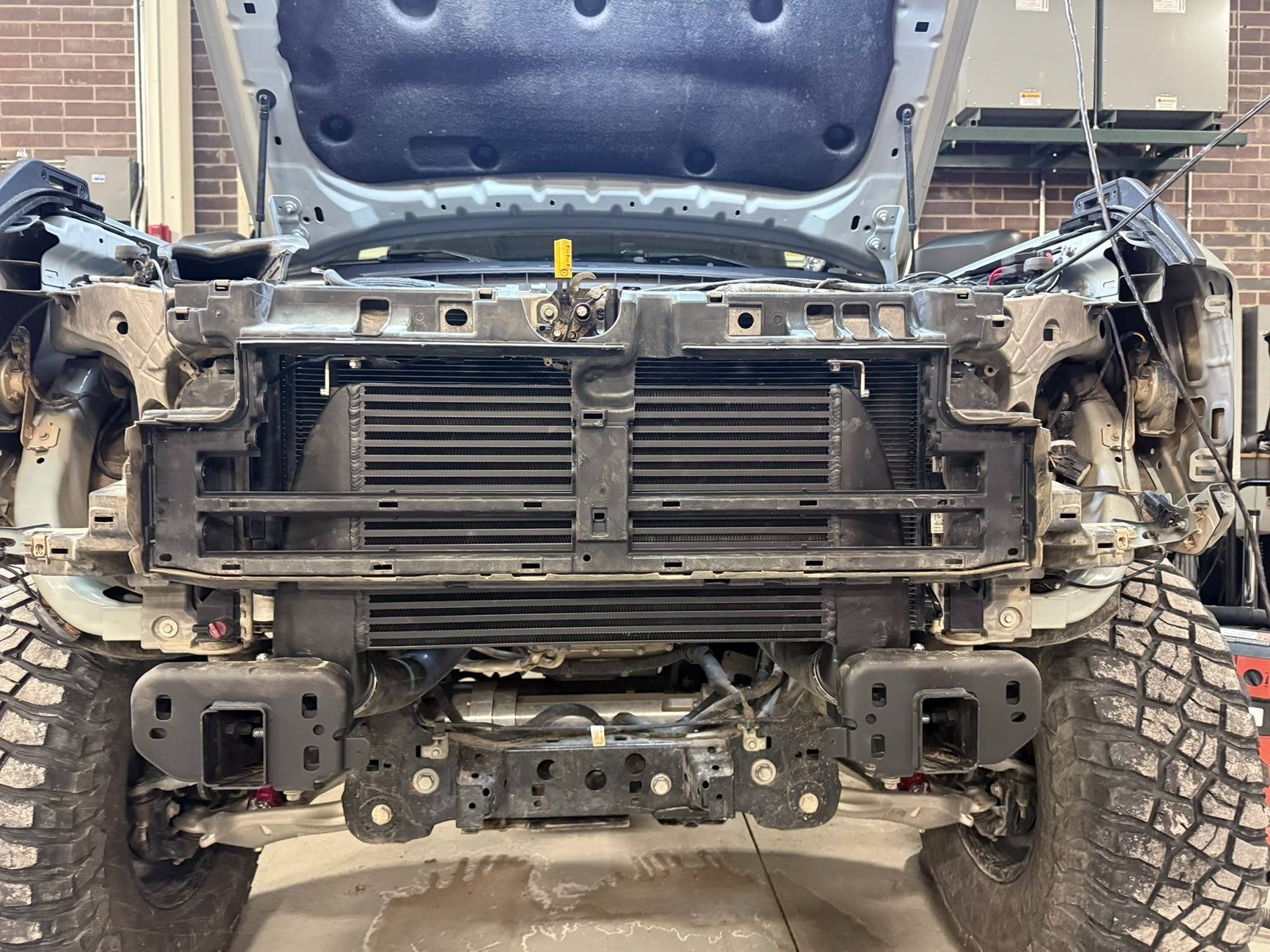

I opted for the Wagner high mount intercooler, as I did not have ACC to relocate. That kit is a little more DIY in that there are currently no instructions (I believe Wagner is working on that) and the hoses (for the 2.3L) needed to be cut to length. There are actually some great threads in 6G where others already figured that out and have some great pictures of their installation.

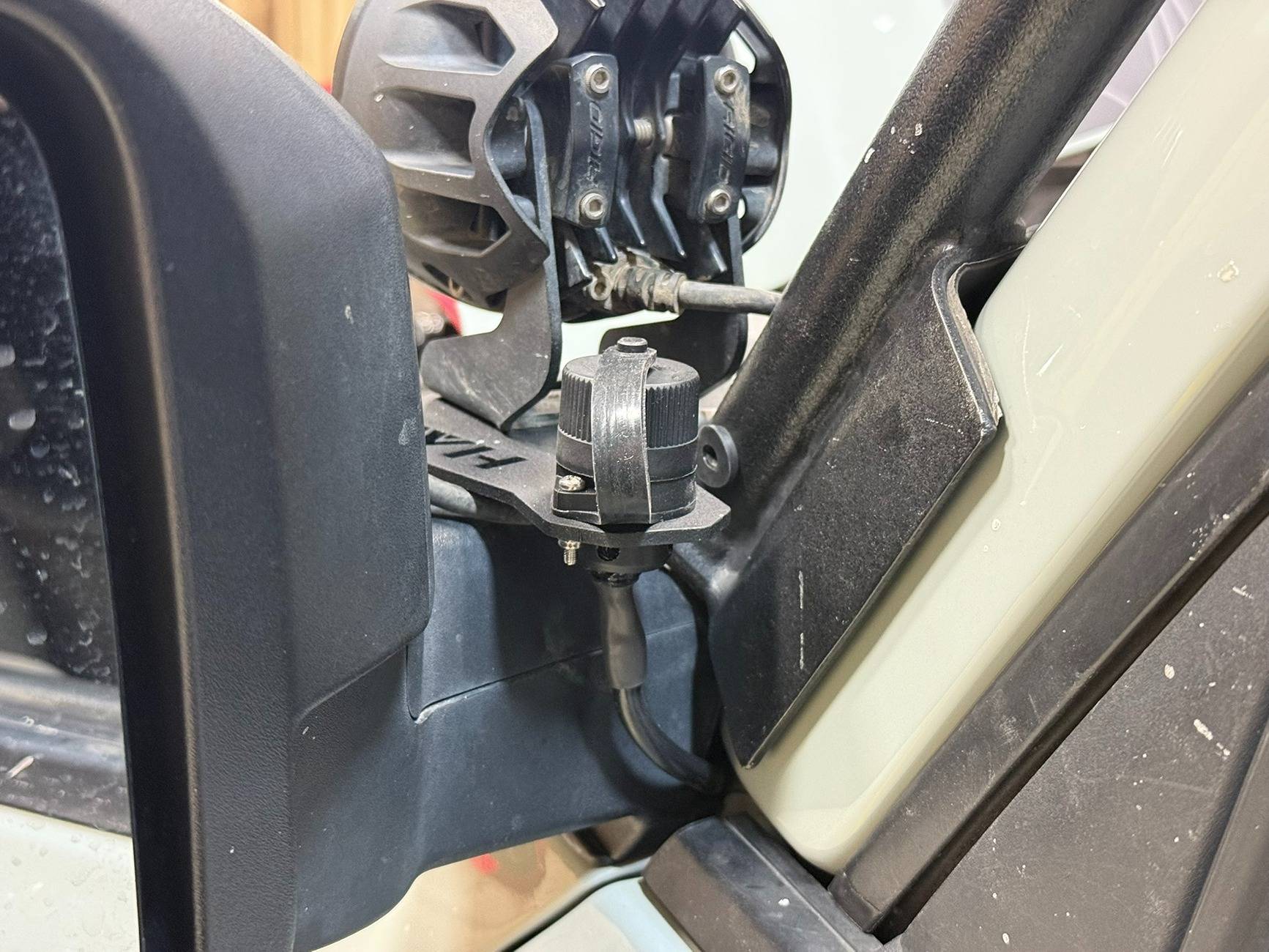

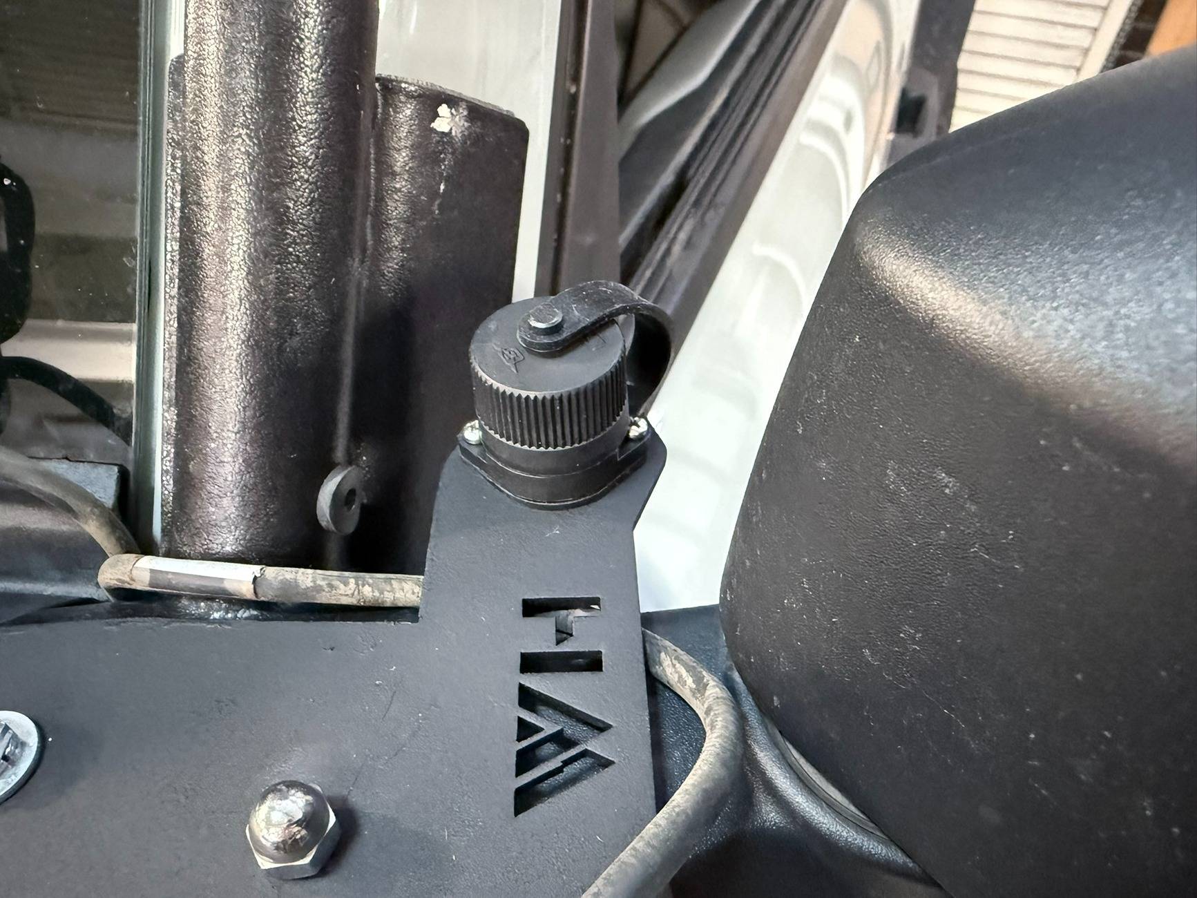

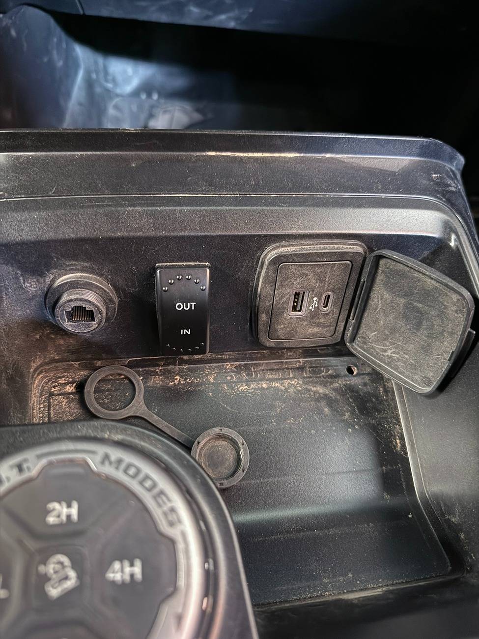

I put a custom touch on my install and modified my Warhorse Bronco light mount to accept the winch remote plug and mounted the rocker switch (another winch control input provided by MileMarker) in the cubby in front of my gear shifter. That allows for winch operation without needing to dig out and connect the wired remote.
HammerBuilt also had the clever idea to mount a light above the winch drum so you can take a peek and see how the line is spooling. I wired that to come on when the winch power is on.
The installation was straight forward, but definitely takes some time from start to finish.
Again, I am super happy with the end result and Alex, and the team, was great to work with! If you are looking for the highest clearance winch option out there, I believe this is it.
