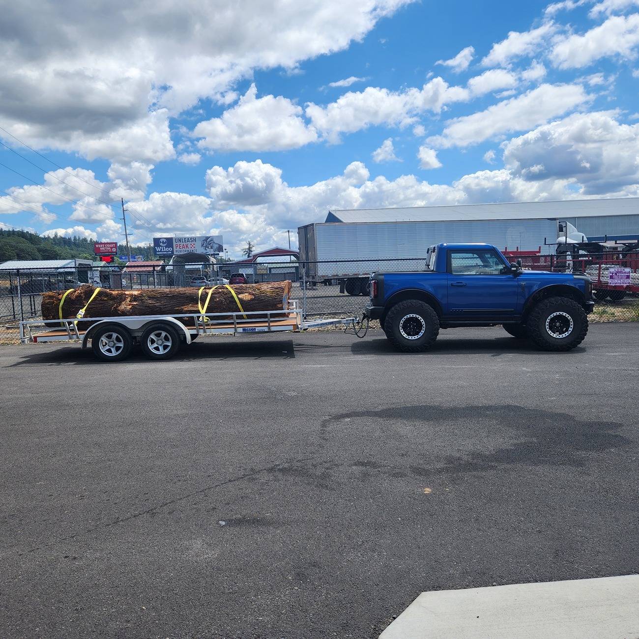

I recommend a tandem axle aluminum setup. this little trailer only weighs 950lbs and can haul 4500lbs. I bought it to haul my airplane, but use it for all kinds of things.
This one is "Mission" brand.
