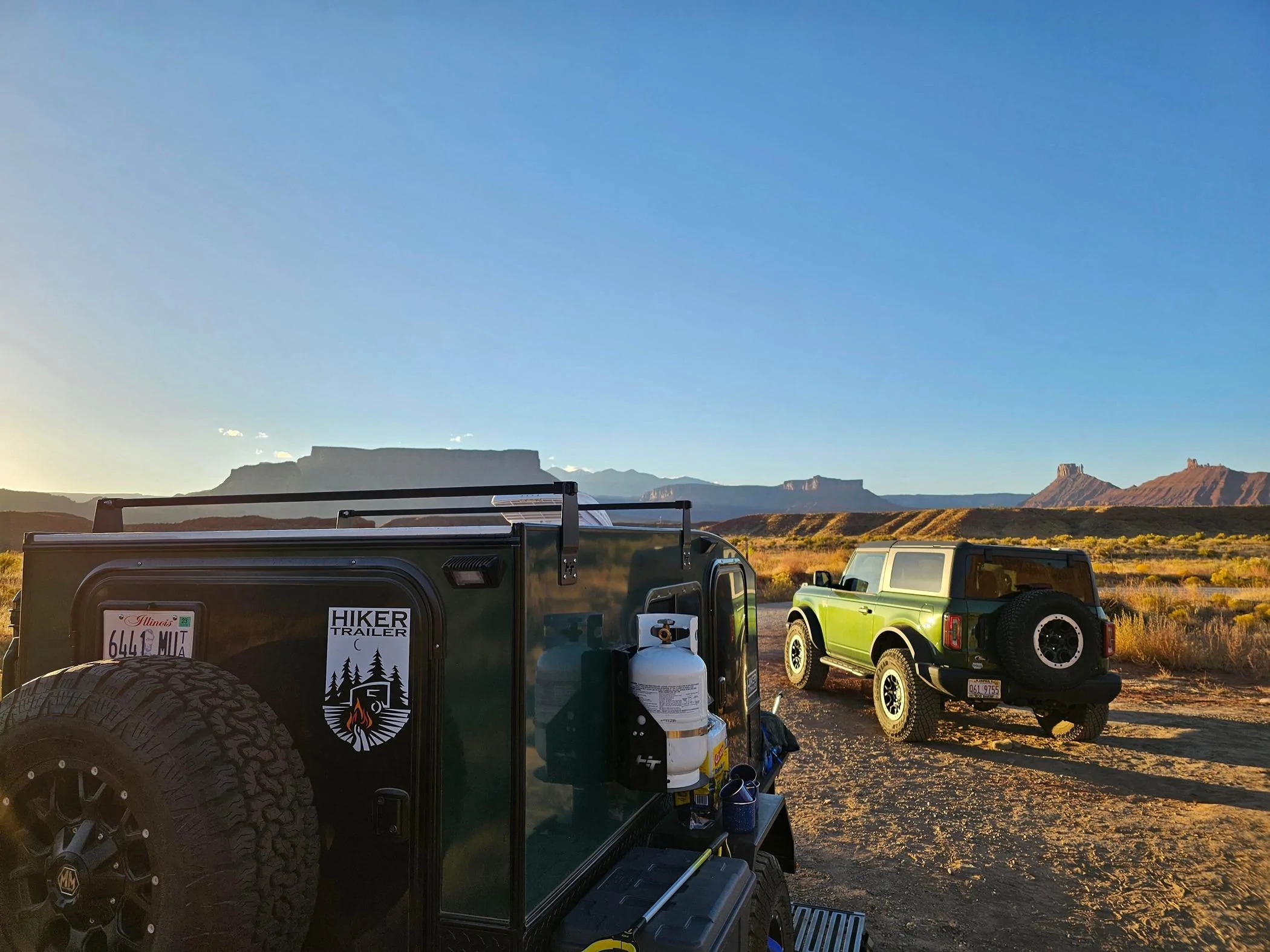

I have a 2 for badlands I tow a camping trailer with. GRVW is 2500, so well with capacity.
When I brake, I can feel the trailer braking. The wheels aren't locking up or anything like that, but I can feel a slight tug from behind (hopefully that makes sense).
I have my brake controller set to it's lowest setting. This is my first trailer I've towed, so I am just curious if this is normal? I appreciate any input from those trailer veterans out there.
Picture of my setup for interest
