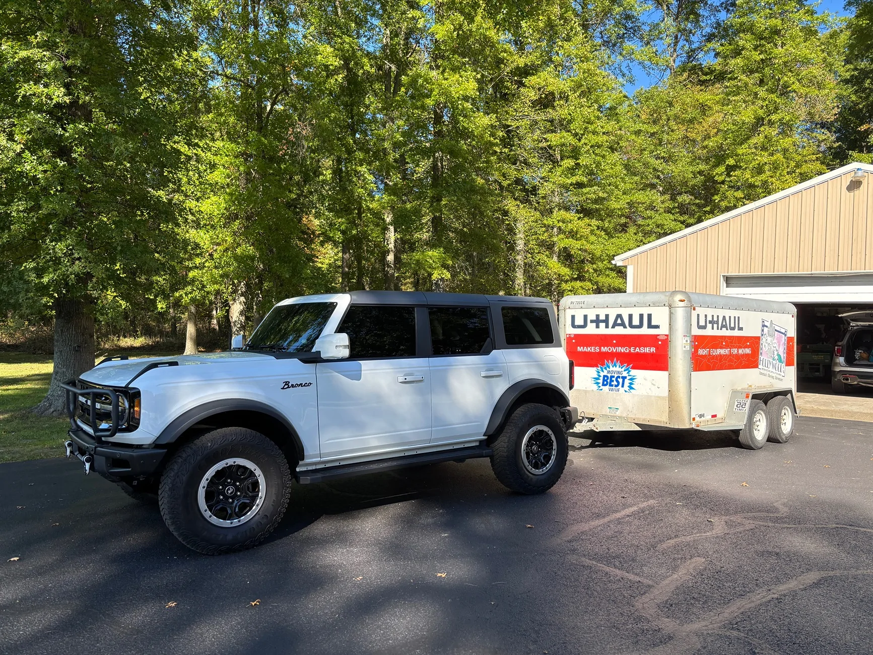

1200 mile round trip with one for me and zero issues. I was pushing the weight limit but bronco didn’t know it was there. Ran about 70-75 the entire time. Get a 2-3” drop hitch and you’re good to go. Mine cleared without removing the spare

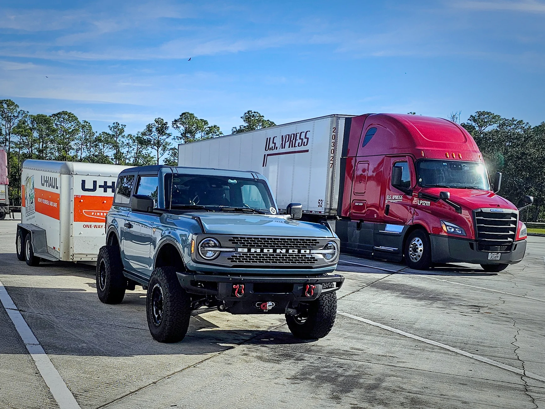

I may have taken a 6x12 across the country once.
Ford Bronco Towing a U-Haul Trailer IMG_20241221_100056_028
There's a 'glide Harley in there, tools, etc. I'm not saying it was over the Bronco's tow rating, but... 😂
I had two different ball hitches; one hung a couple inches lower than the other, but that's perfectly normal I hear.
I did use a 12" extension from Harbor Freight which helped greatly.
I had the 4 or 6" drop for driving, but I put a floor jack under the tongue and switched to the 2" drop to align with the ramp to load/unload the Harley. I don't remember if it is 4 or 6" but I had an Icon Stage 4 suspension and the stock 33s on at the time so it was probably 6"
