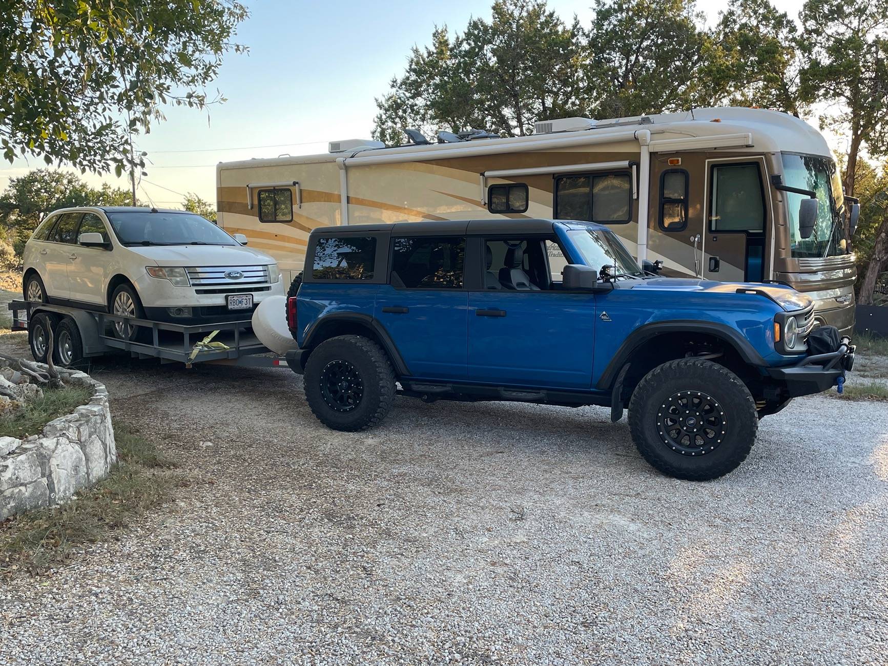

The springs and hitch limit the Bronco’s towing ability not the power. True.
And loading a heavy trailer to keep the tongue weight light can cause uncontrollable sway.

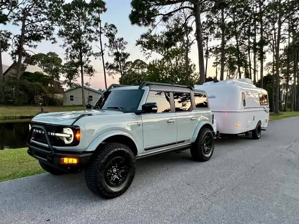

The two camper trailers I’m thinking about is the Nucamp tab 320 black Canyon package and the Casita camper trailer.
Of course heat is the killer for any vehicle longevity

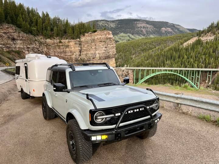

I've owned both a tab 320s and then bought my Casita in 2023. I went on a 2.5 month
trip from FL through Colorado and then to Montana and back . 7,480 miles total on that trip. No issues!
