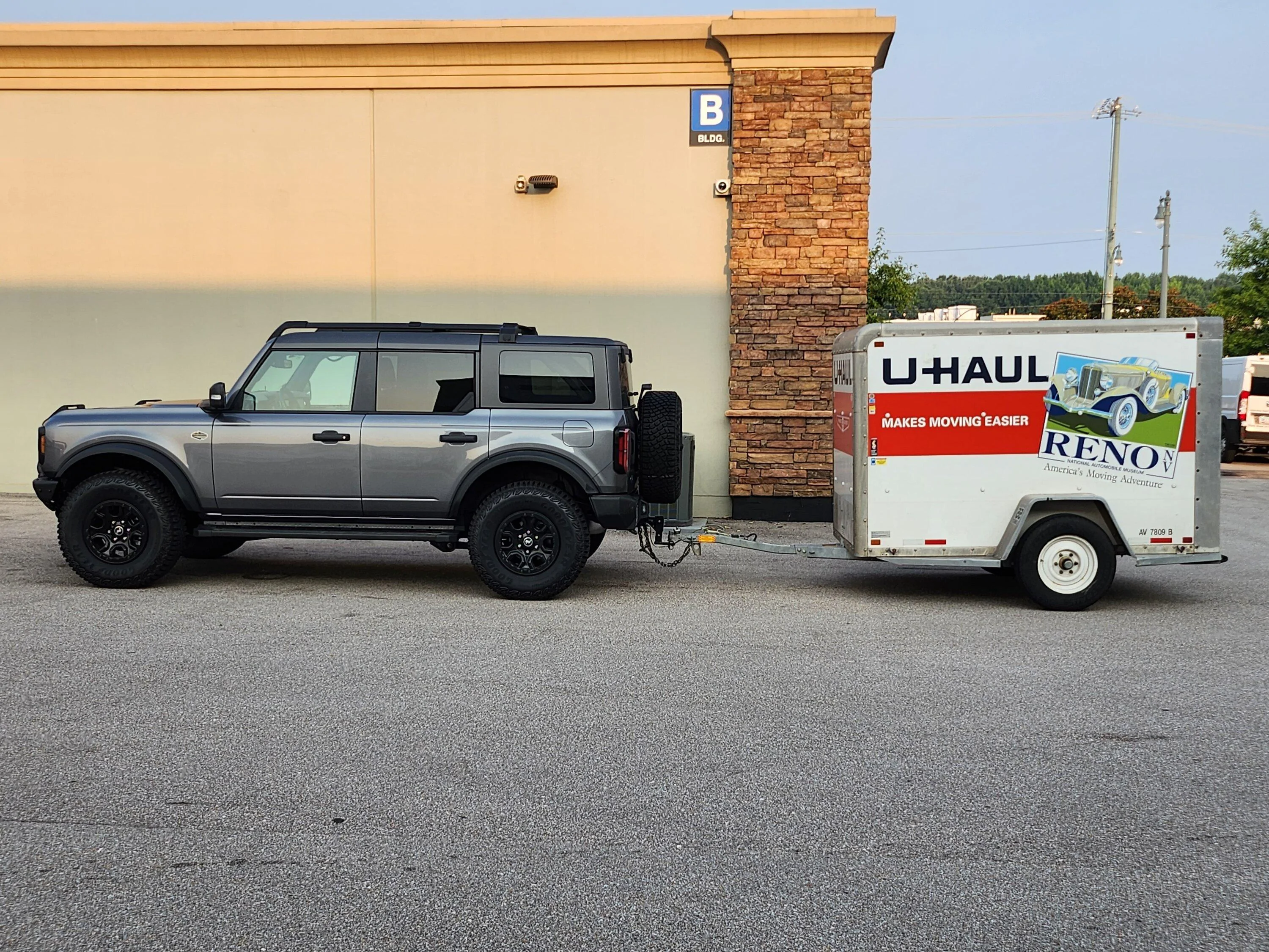

Here is pic of our Wildtrak with a small U-haul. If you zoom in you can see how far I had the hitch dropped.
We had furniture in the U-haul and some stuff in the back.
Ford Bronco U-Haul trailer hitch drop 20230717_071006
It towed perfectly. Only thing about U-haul is the 55mph limit they have for their trailers.
