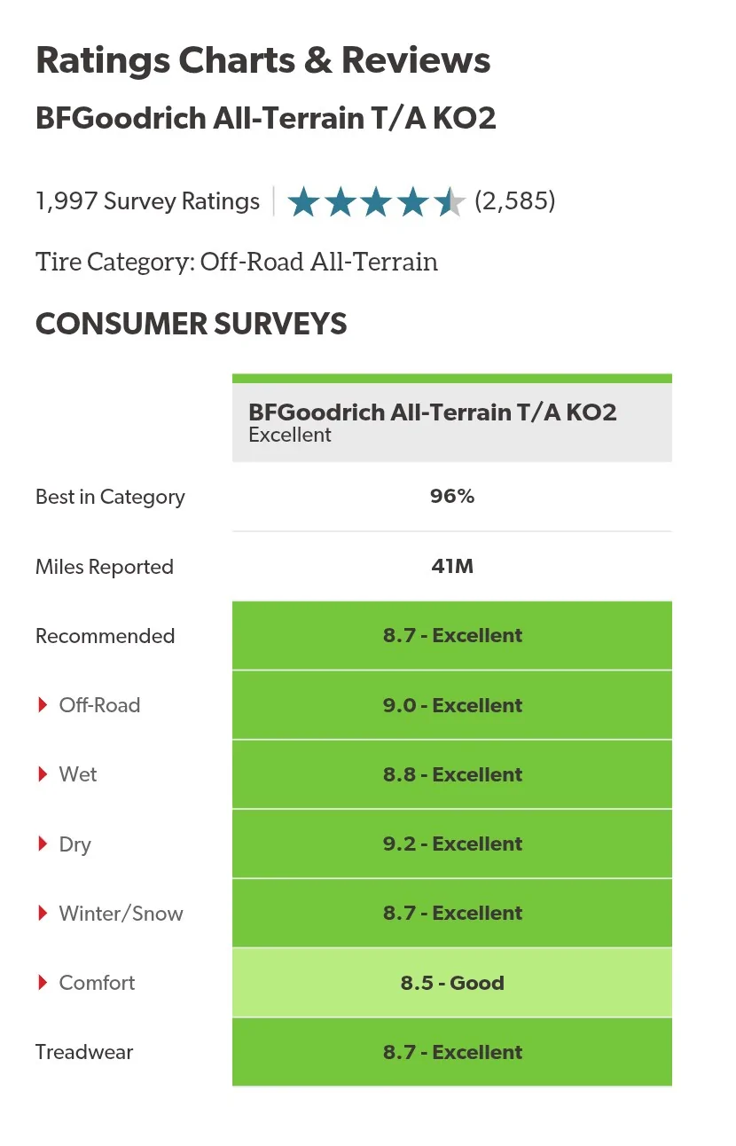

I think nearly 2,000 surveys speak volumes, and it's reflective of my thoughts on the tires...
I love all USA made tires, I just haven't been let down by BFG yet, so I keep buying them.

If you look at all the tire rack data, the KO2 does worse than the others in all of the wet testing, except I think the Hankook Dynapros. If you look around at other testing reviews you see the same thing. The toyo, cooper, firestone, general, yokohama all do better in the wet road performance categories.
My opinion: I've owned and driven trucks and SUVs with all of the above AT tires and the K02 is the absolute worst on wet roads. It's ok on dry roads, but sketchy over 75mph. Does fantastic on light trails.
My experiences with K02s have been in a F150, a Tundra and in a Blazer. Best is a close one...either the Cooper or the Toyo At3. I hear the K03 is a drastic improvement in wet traction. When the time comes for fresh shoes, I'm considering them as well as the Toyo At3.
