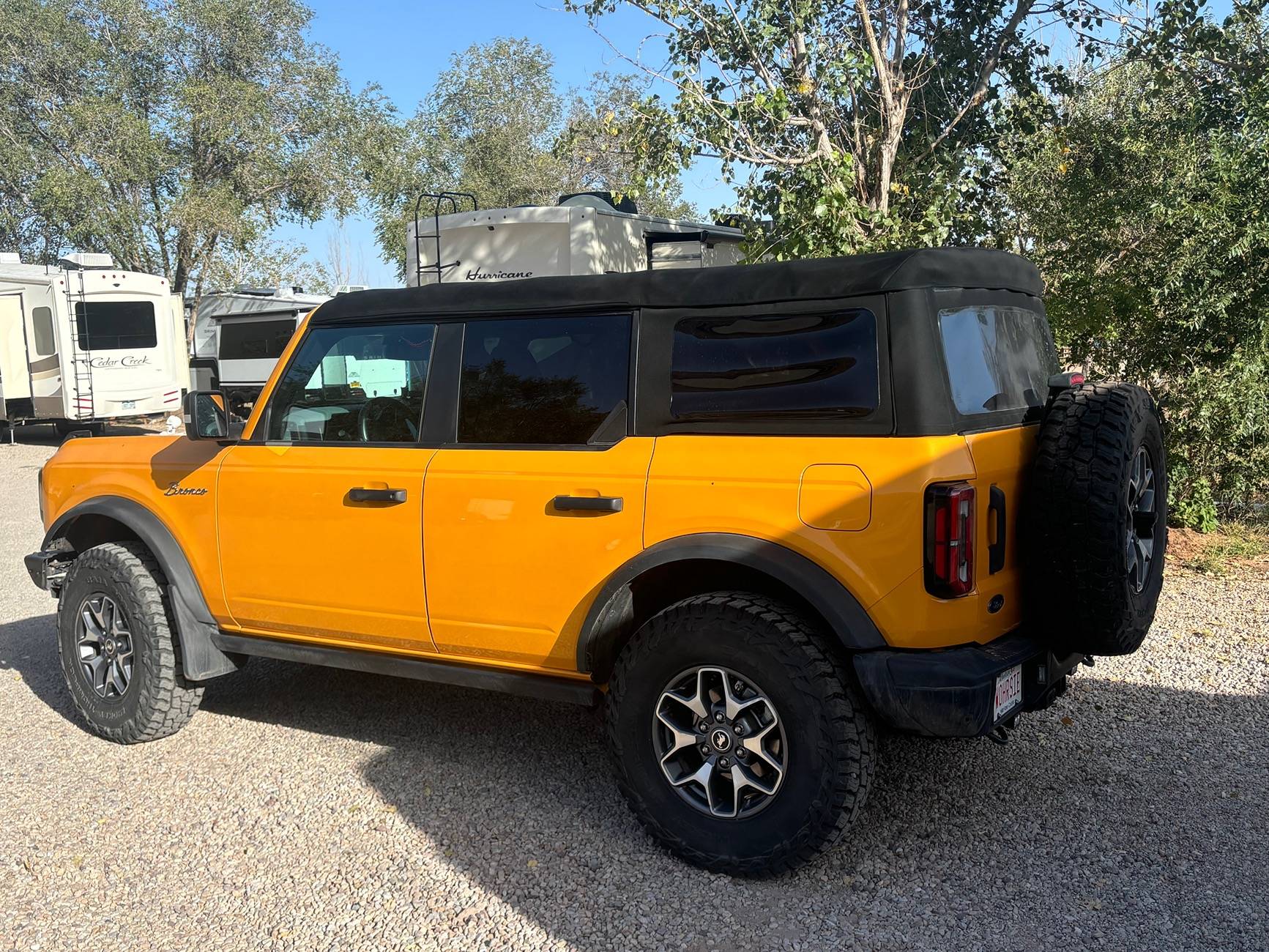

I’m in Moab right now and just replaced my stock 33” KO2s with the Mickey Thompson Baja Boss AT “pizza cutters” in 255/85R17 (35” diameter). Couldn’t be happier. They do not rub at full flex with the crash bars in (1” lift in front) and I’ve noticed a significant improvement in both clearance and the ease of rollover with the larger tire circumference.
They do not look that narrow either, due to the heavy side lugs on the tires. And science says the narrower tires actually perform better than wide tires at lower inflations. Google that subject for some great studies.
I have a throttle commander on the 2.3l manual and I adjusted the sensitivity so there’s no noticeable difference in throttle response.
All in all, I’m officially converted to the pizza cutters on the non-SAS Badlands.
Thinking about these tires. Did the spare fit underneath the brake light without any trouble?

Yep.
Put the tires through their range on sand whoops and rock ledges without any rubbing. Very happy with the Micky Tees.

Note I do have a 1” lift on the front - not sure if it would clear without it.
