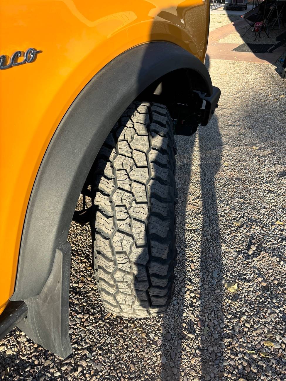

Thanks, and yep - I have the 255s and not the 285s. I replaced the OEM BFG 285/70R17 with the 255/85R17s. I’ll correct my OP. Holiday brain at work… :)
I’ve run them for three days on the rocks aired down to 18psi. I started the week on my K02s and cannot feel much difference in sidewall flex, but I haven’t run the Bajas on a trail I’ve run already with K02s.

Good points and good discussion. For consideration - look at the width of the tires used by the Ultra 4 vehicles as a guide to what racers use for widths.
The biggest advantage for me was the tire clearance sitting on stock Badlands non-SAS suspension with the 1” front lift, and on stock 17.8 rims. I am not rubbing on the front with the crash bars still in place though I will post up if I encounter rubbing on the harder trails I’ll be doing this week.
Another consideration I had was the reported superior winter traction from the Mickey Thompsons. I live in Calgary and commute 3hrs to Fernie, BC every weekend for skiing. I can say that the K02s and K01s were terrible on ice, to the point where on my F150 for years I ran Bridgestone Battleaxe A/Ts for acceptable severe winter performance. These days I do run full winters on the F150 (I got two sets of wheels and tires with my 2019 F150) but I want to see if the Bajas live up to their reputation on my Bronco.
For the record, I compared the Bajas to the Nokian Outpost 285/75R17 and the Falken AT4s in the same size. The K03s are not yet available in a size I was interested in (10.5x35).

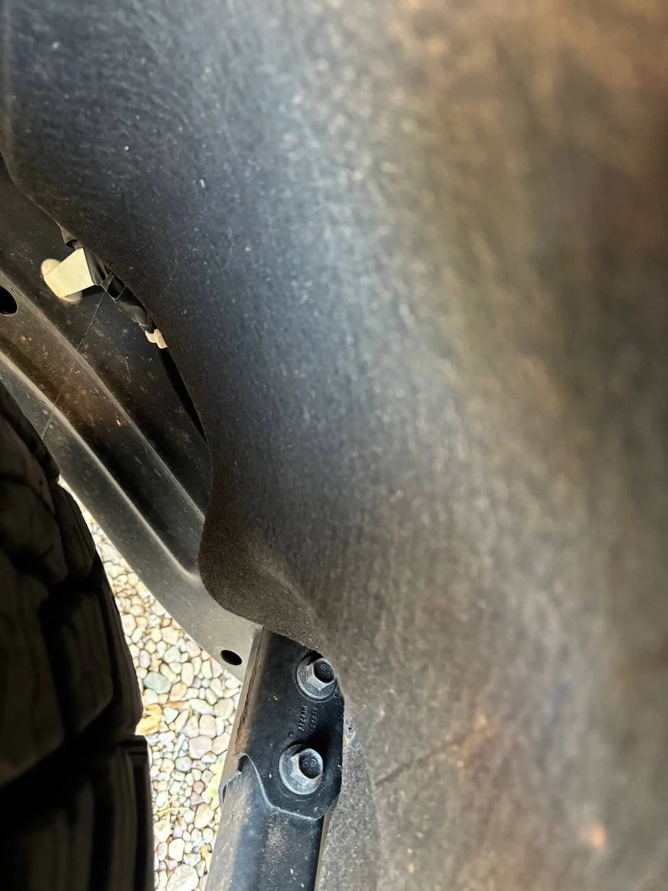

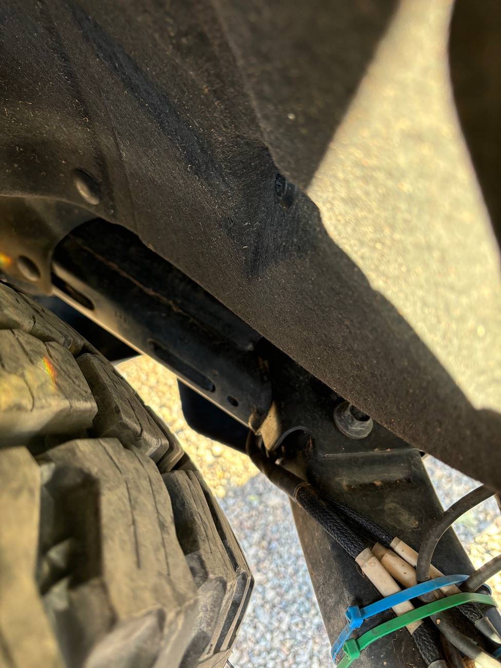

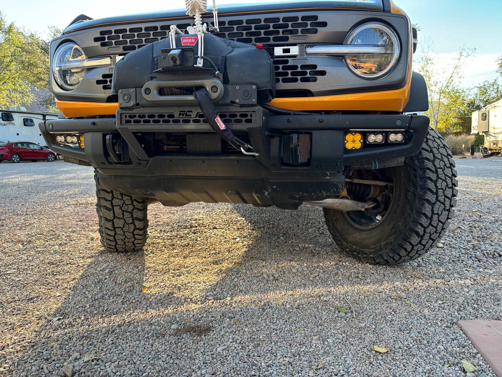

I did Box Car Loop and Kamikaze yesterday. Moderate-hard ledges on them. Climbed and descended with ease - I was amazed that there was no knocks on the bottom as I certainly would have been hitting the control arm mounts and rear bumper recovery hooks if I was on the 33s. Climbing the ledges I used rear locker and walked up effortlessly. Both my wife and I were shocked at the difference to the 33s.
I aired down to 19psi. Plenty of flex in both the sidewall and tread. Air temp was 26C yesterday.
I’ve attached pics showing the clearance front and back of the front wheels with a 1” RC leveling lift. Stock wheels with no spacers.
I may try Top of the World tomorrow or Wednesday, wife-permitting…
