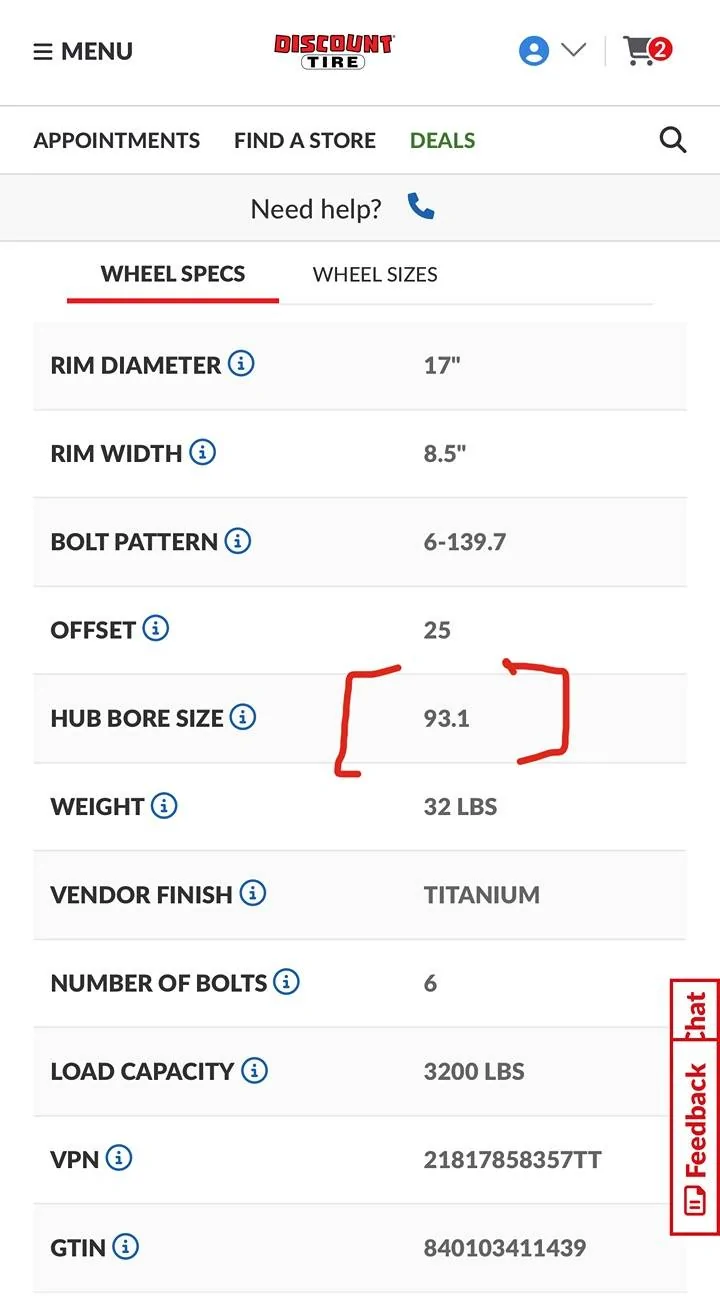

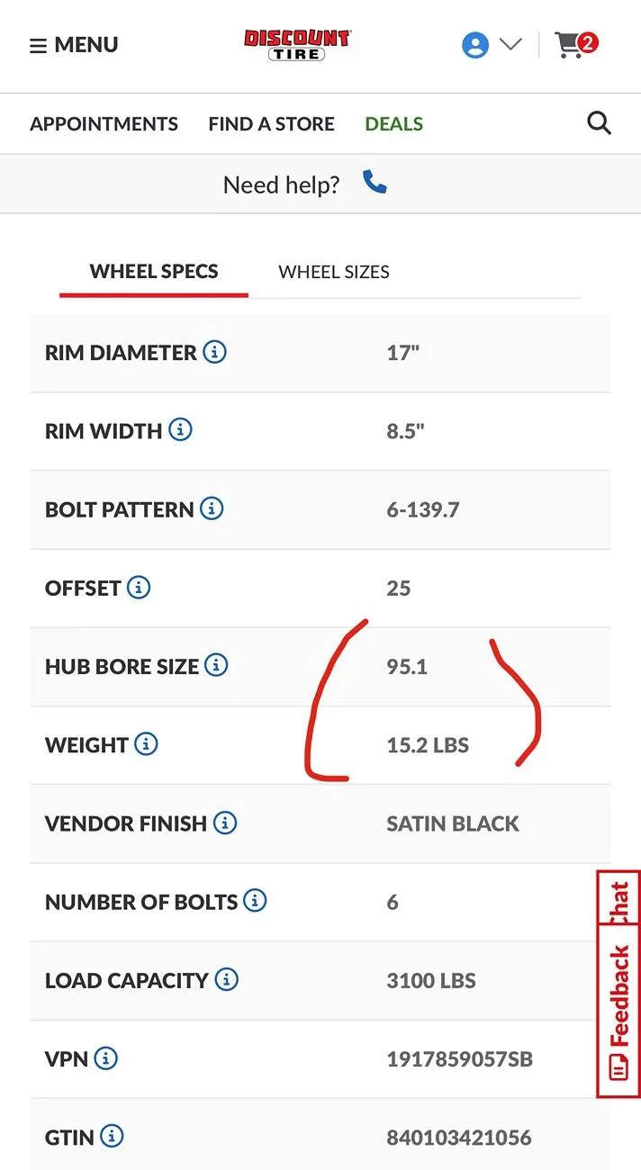

I’ve been eyeing the Rebound Pros for awhile. Nearly wet my pants several weeks back when I saw DT had a version that was hubcentric (93.1) vs their near miss (95.1).
Jumped on the Icon site to see if they released something new. Couldn’t find it. Called DT and after a day or so of some back & forth, the rep called to deflate my hubcentric dreams and confirmed it was indeed a 95.1 hub and not 93.1 as shown on the site. He apologized and said they would fix it.
Today it still reads as 93.1. On the regular Rebounds the hub bore is correct but the weight is listed as 15.2# which I believe is an error too.
Not knocking them, they are great to do business with and I prefer them over most but definitely double check specs.
