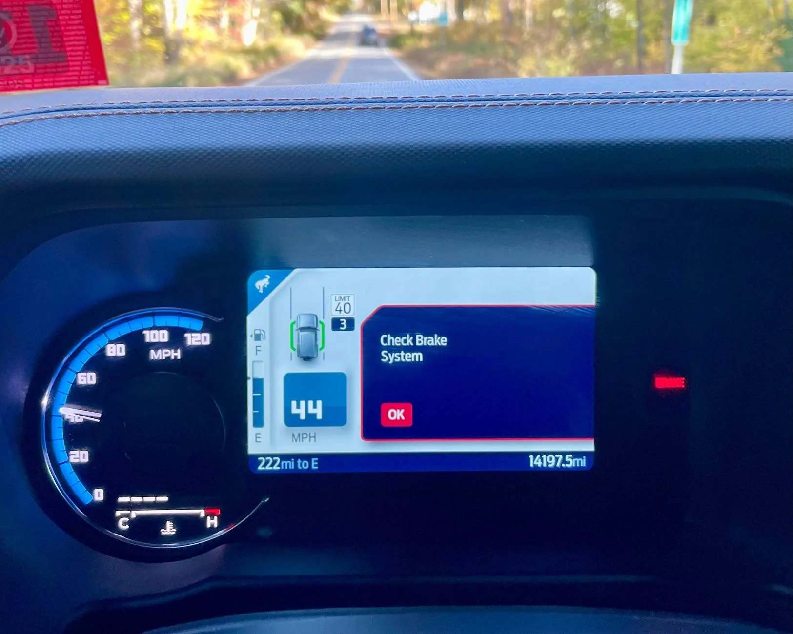

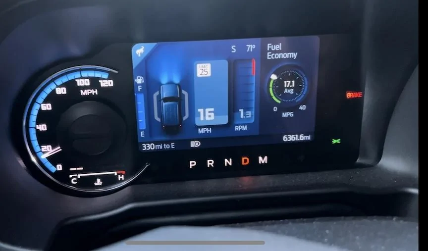

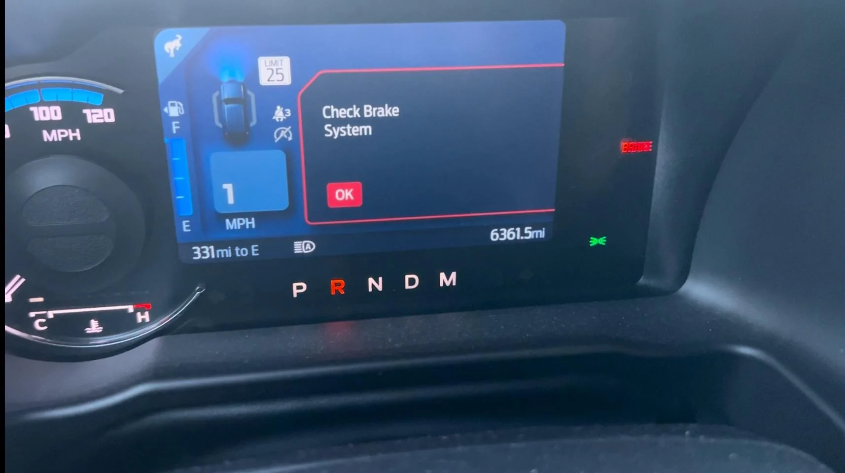

Good to see another thread on this. I've had the same problem intermittently and took it in, but dealer said no stored codes, nothing they could do. It recurred again last week so I took some pics (and video) to bring to them.
Warning came on during cold start up (not cold day), and BRAKE light stayed on for between 5-10 minutes. It went away on its own, while I had the vehicle on.
2023 2.7TT, OBX Advanced.

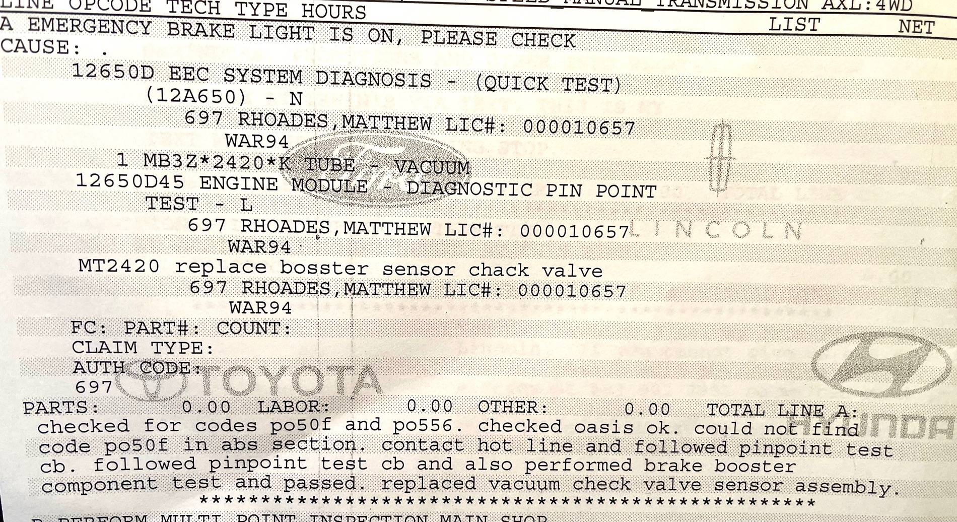

Unfortunately this just happened to me today. 2024 2.3/MT Badlands with 14k miles (took delivery Jan. 2024). Left home for an errand....Brake system error happened after accelerating relatively aggressively on a highway on ramp. Pulled off, tried putting parking brake on/off, powered off, still there. Went grocery shopping, with the car off for about 20 minutes. Problem did not re-appear upon restarting the Bronco...but did re-occur about 15 minutes later on the way home. No noticeable loss in brake function.
Am taking into dealer tomorrow - will report back.

Brought my 2024 2.3L/MT Badlands into my local dealer for this issue. They had to order a part (vacuum check valve sensor assembly). No issues since then....have driven approx 300 miles since then, local, highway, mild trail...and has not re-occurred. Fingers crossed.
In my case, I never had any noticeable loss of brake performance when the warning came on.
Here is the summary per the sevice advisor/service invoice:
