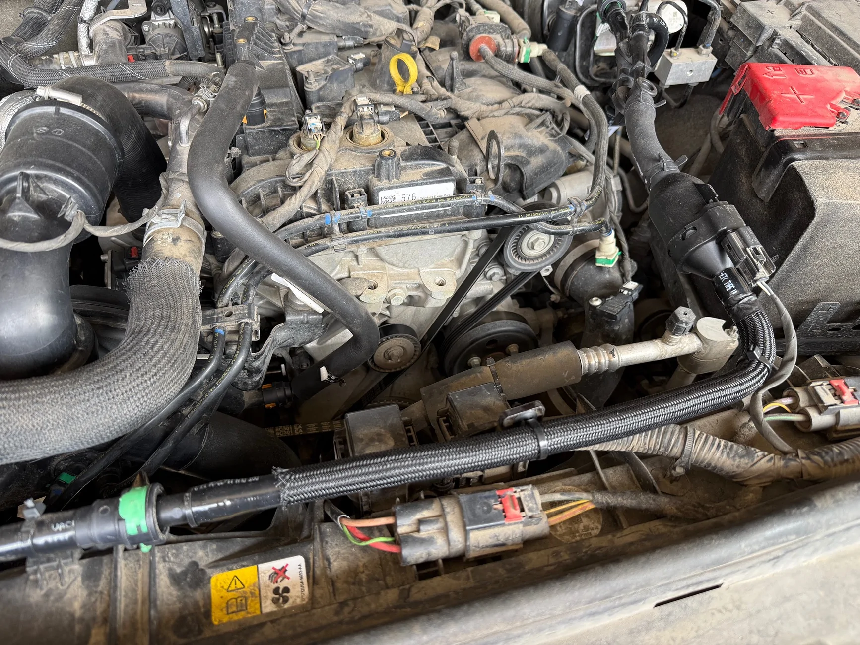

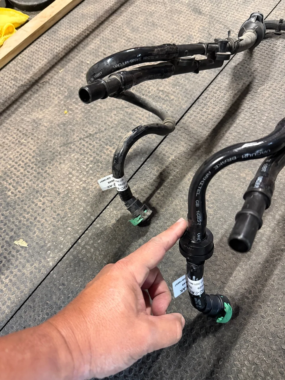

I ended up replacing the vacuum tube with the built in sensor and check valve. Problem is resolved, but honestly this is B.S. Ford knew there was issues with the original design. the new design has the check valved moved from the line going to the air intake and now the check valve is connected to the line going to the engine, plus with a redesign on the hose. See photo's
Ford Vacuum Tube MB3Z-2420-L (Original Part# MB3Z-2420-A, multiple revisions prior to L version)
Ford Bronco Brake Light and Check Brake System IMG_2299
Ford Bronco Brake Light and Check Brake System IMG_2302
