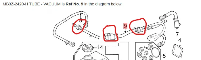

7,8, and 9 in this diagram are the hoses involved, and the loss of assist is caused when the vacuum in the brake booster fed by hose #7 has no vacuum.
I believe the common cause for the problem is that one of the check valves circled fails and allows vacuum to leak back into the intake manifold through hose 8.
There was a TSB for contamination in hose 8 causing problems as well, and ford might be requiring the technician to check for that or even clean out that hose as well, and cleaning that hose out could be adding a bit of time.
But the contamination TSB was for a fairly narrow number of 2021 Broncos, so it's unlikely to be your issue, and would also behave differently I believe.

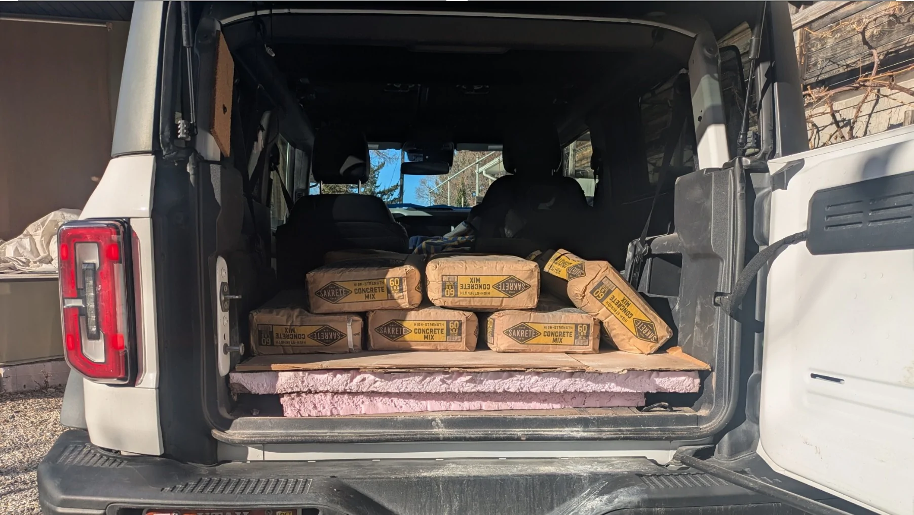

Started it up, everything seemed fine, went to home depot picked up 720 lbs of concrete for a yard project, on the way home floored it all the way up the hill (at least till I hit 90, figured i should slow back down), couldn't set off the brake warning so I think it worked.

I have to show off my level load area, high tech solution to slide in bags of concrete...

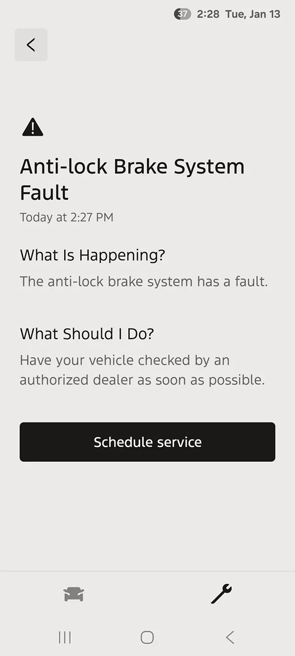

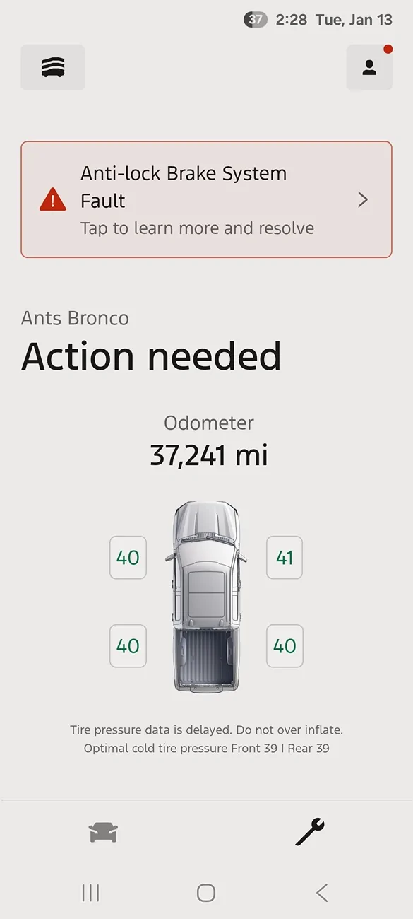

Came in today to my local ford dealership for an oil change and tire rotation. Now my dash brake light stays illuminated and the app is showing an abs fault. Never had this issue prior. The tech screwed something up. These buffoons been trying to figure out for the past 4 hours. Wtf man. Battery test came back ok, they drove it and mechanically everything works. Idk

I'd bet they knocked the connection off on one of your wheel speed sensors... (Or pinched the wire, and they need to put a new one in now)
