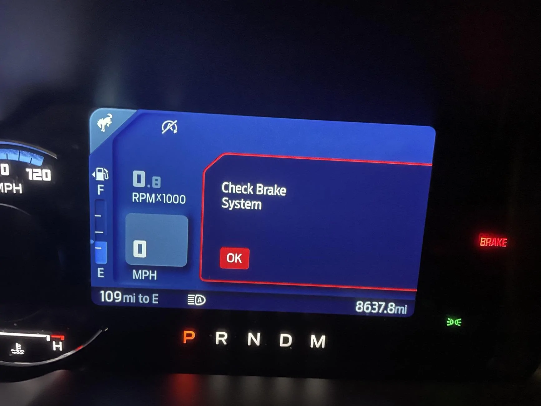

I took a picture to show the service advisor. So far, knock on wood I haven’t had the light come back. I got the warning light and the message and it cleared within 5 minutes. The warning chime scared the crap out of me the first couple of times.

I didn’t have that problem mine thankfully was only the light. That sounds scary!
