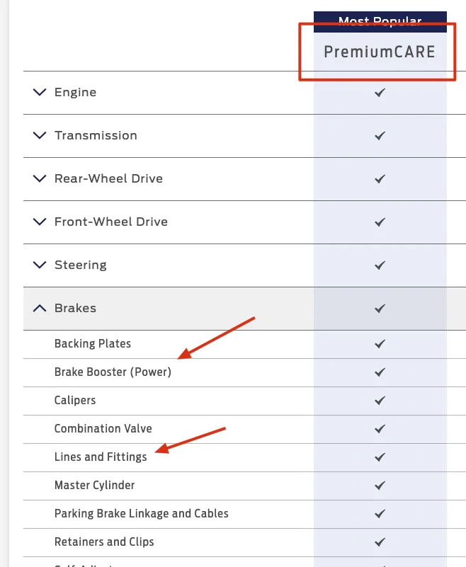

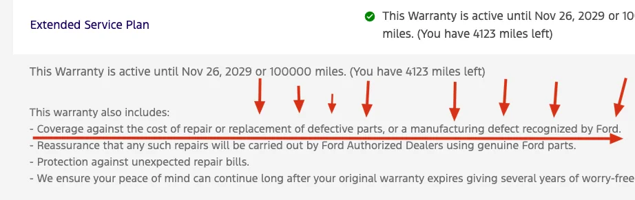

Man, the logic on this is mind blowing. Mine is currently in for this *for the second time*, on the updated part, no less. They replaced this at 48k, under warranty as well, but are now claiming that that repair was a good faith repair that they did. Cue today and they want north of $650 to fix this. (What actually happened is that they replaced the brake booster when I told them it was more than likely the vacuum line, and had a bit of egg on their faces when I brought it back a day later with the same issue. "Oh, huh, looks like you were right....").
Even under the premiumcare warranty, it fits the criteria and would 100% be covered:
and from the ESP website:
IMO, a TSB is 100000% admission of a defective part and/or (sub)system
This is telling too:
Mine was replaced exactly 25 months ago.
Not all vehicles exhibit TSB issues. Sometimes it happens, sometimes vehicles go their whole lifetime without the issue ever happening.
Yes it’s a known issue that could happen, but regardless, it’s not something that will be covered forever. That’s just not how it works for any manufacturer šŸ¤·ā€ā™‚ļø
In reality, this issue should’ve been a full recall in my opinion, but I don’t make the rules.
As far as ESP, some brake related items are covered, but not everything is covered even if it seems like it should be. It all depends on the base part number. It’s not bumper-to-bumper

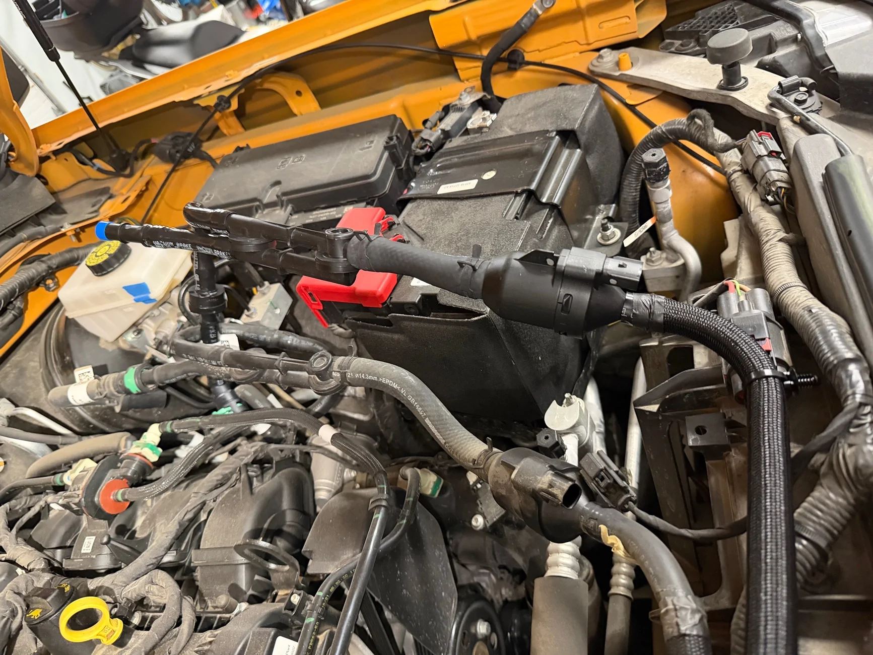

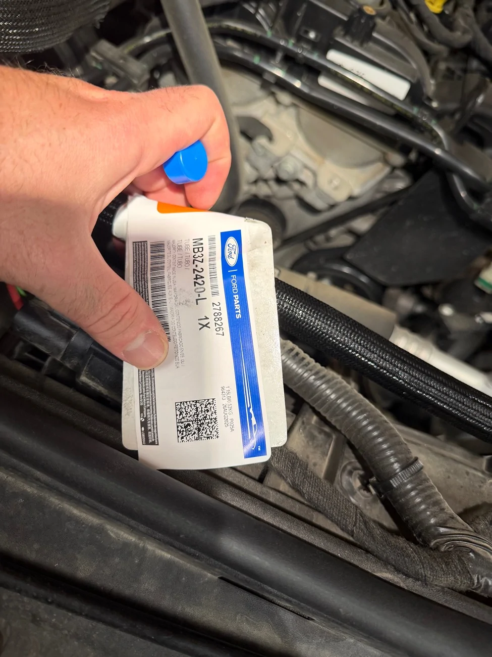

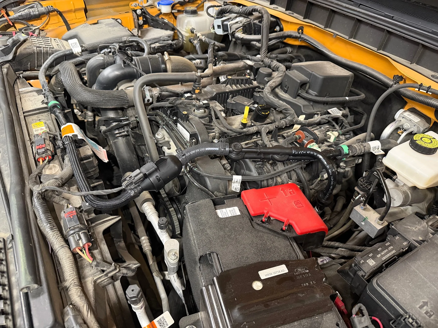

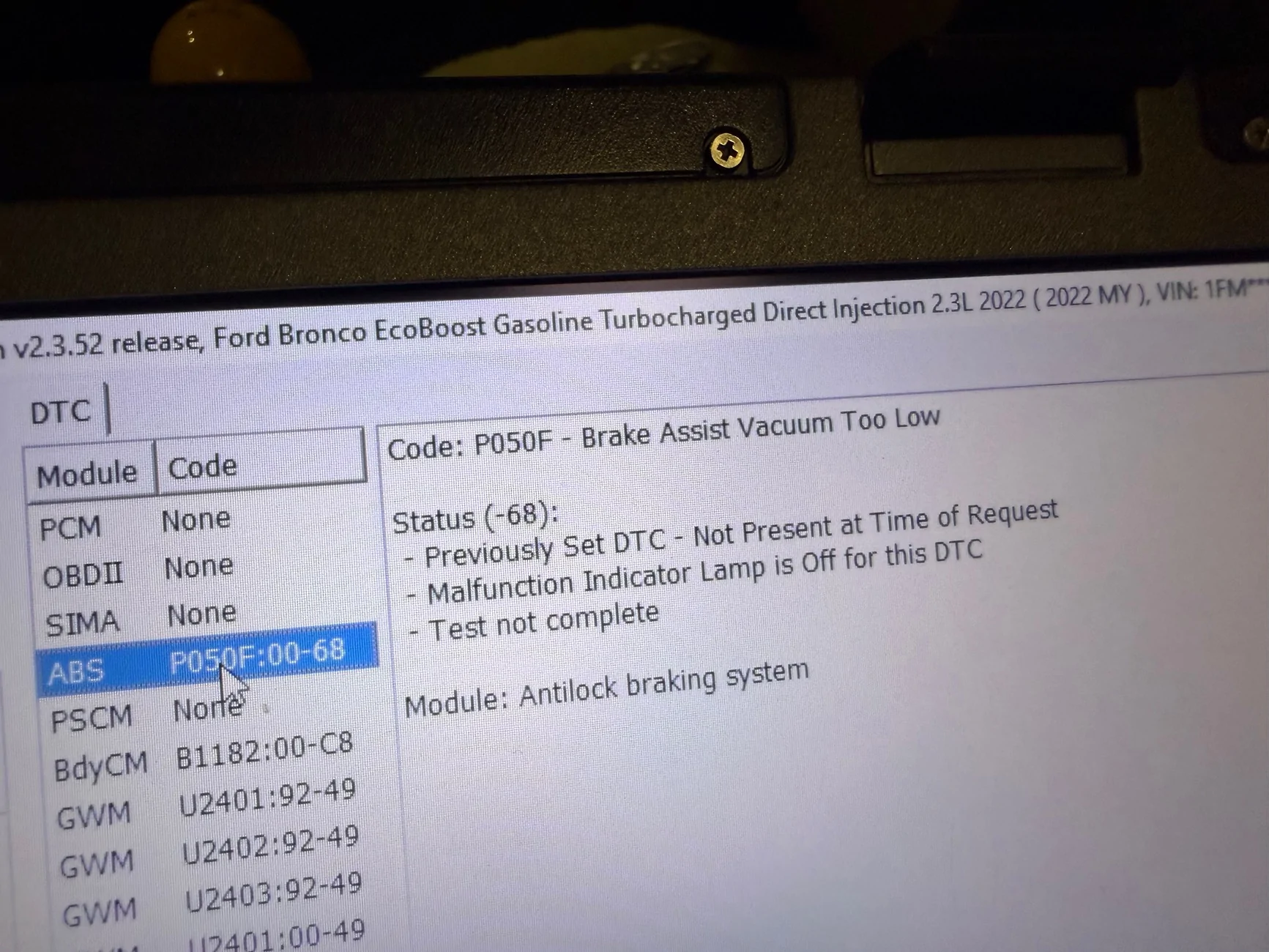

Thanks to this thread I went ahead and took care of my check brake issue today. ā€˜22 2.3 manual - hard brake pedal at start for the last month or so - threw the error when I got on the throttle last week.
I went with the MB3Z-2420-L replacement part. It fit perfect, although mounted up in the engine bay somewhat differently, had the check valve at a different spot. Took about 10 minutes to change out, with most of that time futzing with the vacuum line clips
I’ve cleared the error in FORSCAN and it has not returned.
I’ve attached some extremely poorly taken photos (sorry) of the new part sitting next to old, new part installed, part number, and of the ABS code I was getting.
edit: I’d also like to note that, after the part swap, the brake pedal is no longer solid before starting (after sitting overnight). Seems the system is indeed holding the vacuum much better after the swap.
