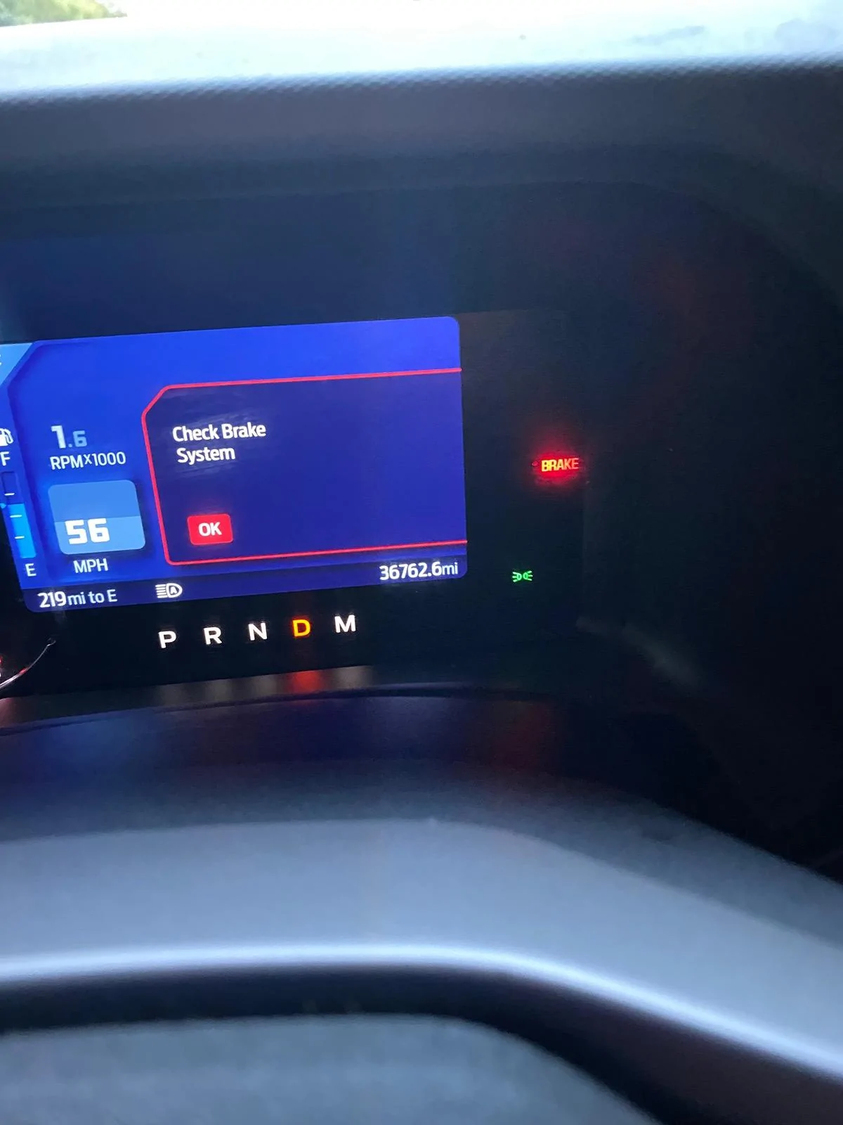

I appreciate you posting this. I am taking mine into Ford this afternoon for a separate issue I will show them my pic from yesterday and the thread on here.
I had the same experience yesterday with my 2.3 Big Bend 8k miles. Did the vacuum part fix it?
Did ford replace this vacuum sensor part for free considering it’s obviously a common issue? Mine is doing the same thing and they said it will be $1,000 to fix. It’s a 2022 with $36,000 miles.

Same just happened to mine today. Light came on but no obvious issues with brake system while driving, yet 😳 I noticed when I turn it back on, brake has to be pressed harder while pushing the start button. I put in a call to local service dept and awaiting call back
The exact same thing is happening to my 2022 Bronco. They are saying it’s the vacuum sensor. Did they fix this for you at no
Is this covered under warranty? My local mechanic and i changed the pads and routers. Will this void a certain warranty? This seems to be the exact issue i am currently going through.
Ford Bronco Brake Light and Check Brake System IMG_2886
