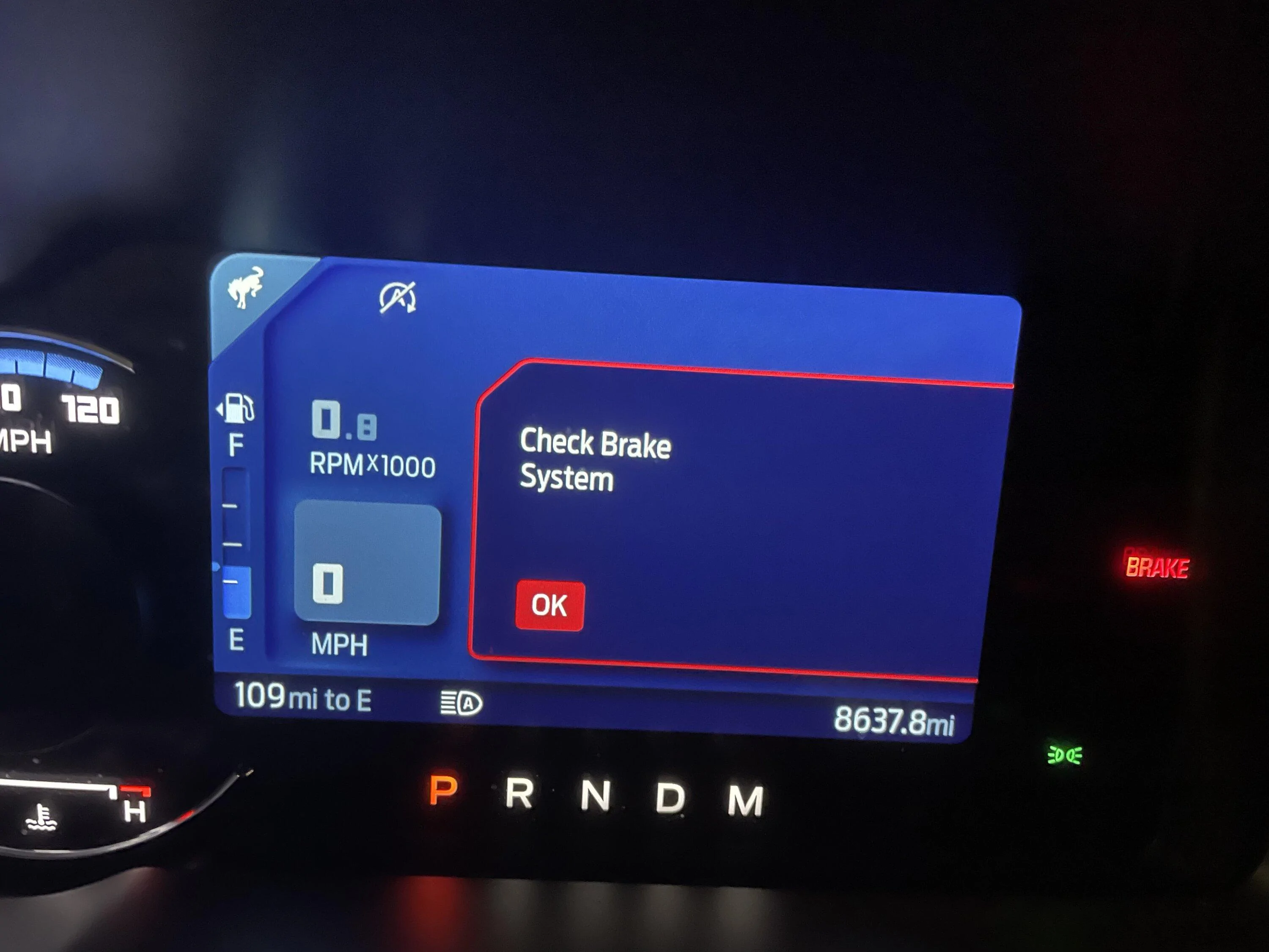

Just happened to me tonight driving on the expressway at 70 mph. Brake light came on and breaks pumped for a second. Pulled over turned car off and break light still on. Haven’t noticed any breaking issues yet. Anyone have a remedy to this?
I have had this happen twice now.

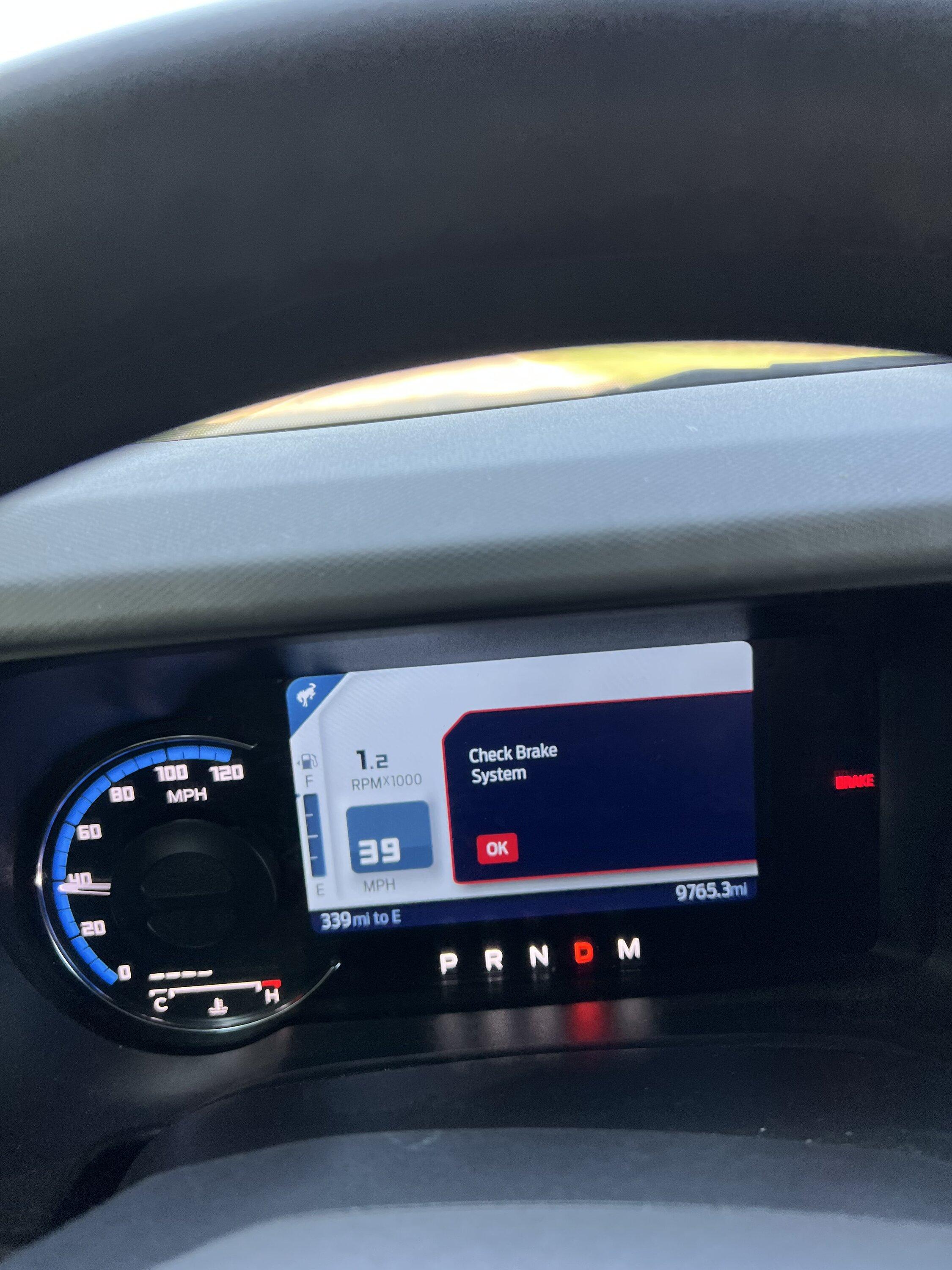

I appreciate you posting this. I am taking mine into Ford this afternoon for a separate issue I will show them my pic from yesterday and the thread on here.

Any update? My check brake system light just turned on while I was backing out of a parking space. Turned it off then back on, and the message and light came back on

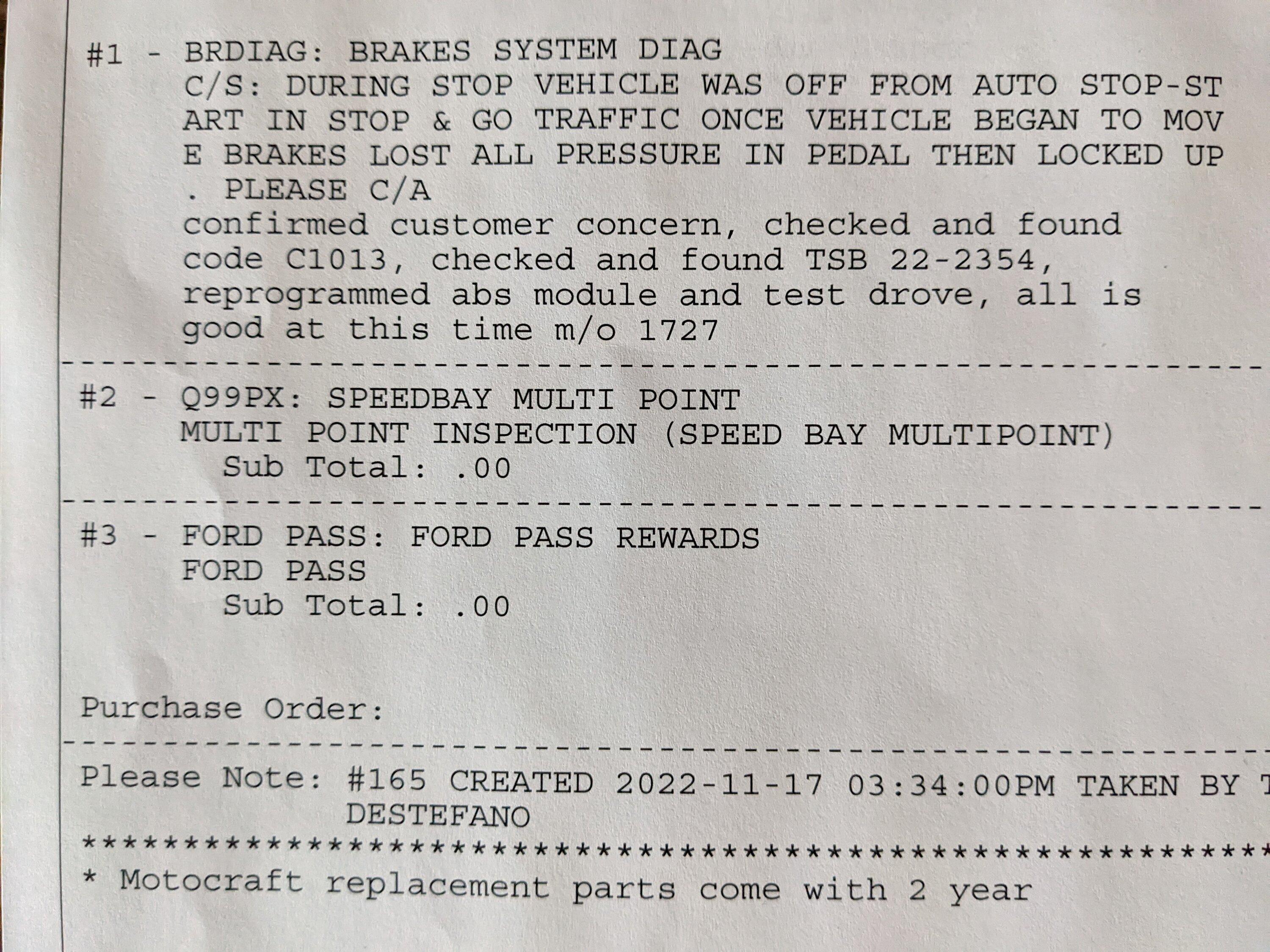

2.7 here with cascading ABS module failures. Apparently there's a new TSB to address this by reprogramming the ABS module. I haven't experienced it since taking it in.

SSM 51201 2021-2022 Bronco - 2.3L - Intermittent Illuminated Brake Warning Lamp With DTC P050F In The ABS Module
Some 2021-2022 Bronco vehicles equipped with the 2.3L engine may exhibit a red brake warning lamp and brake system warning message in the instrument panel cluster (IPC) with a diagnostic trouble code (DTC) P050F in the anti-lock brake system (ABS) module. This may be accompanied by an intermittent firm brake pedal after driving for long periods at highway speeds. This may be due to improper sealing of an internal diaphragm within a brake booster vacuum line. To correct this condition, replace the vehicle's vacuum line with the latest version service part number MB3Z-2420-H or later. Refer to Workshop Manual (WSM), Section 206-09 for installation instructions. For claiming, use casual part 2420.

Unfortunately the Check Brake System warning light is back. Took to the dealership today and they said an engineer from @Ford Motor Company will have to come take a look at it. Stay tuned.

I took mine in on a friday and they had it repaired and ready for pick up by Tuesday, It was the same thing that everyone else said (something about brake diaphragm something something)
