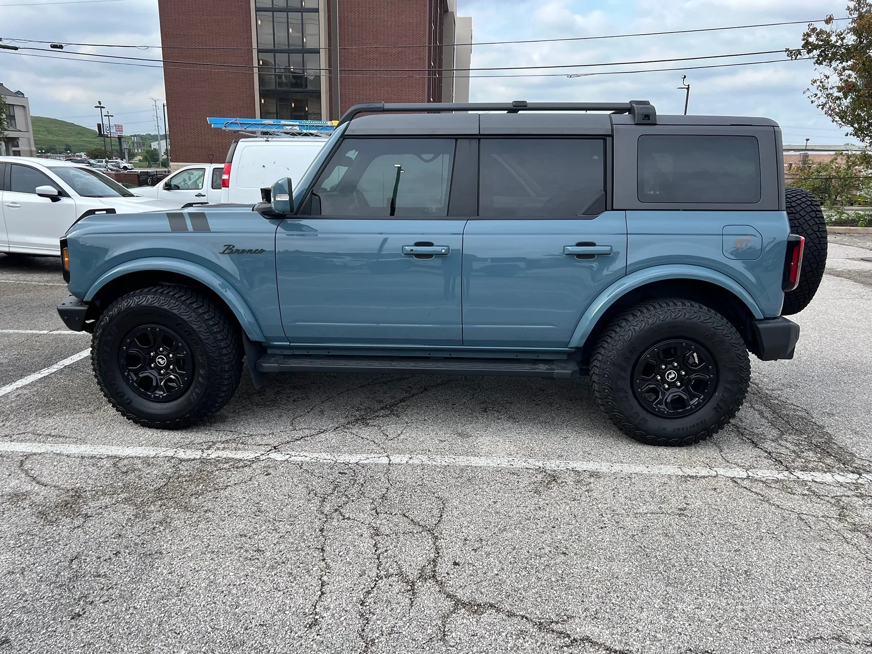

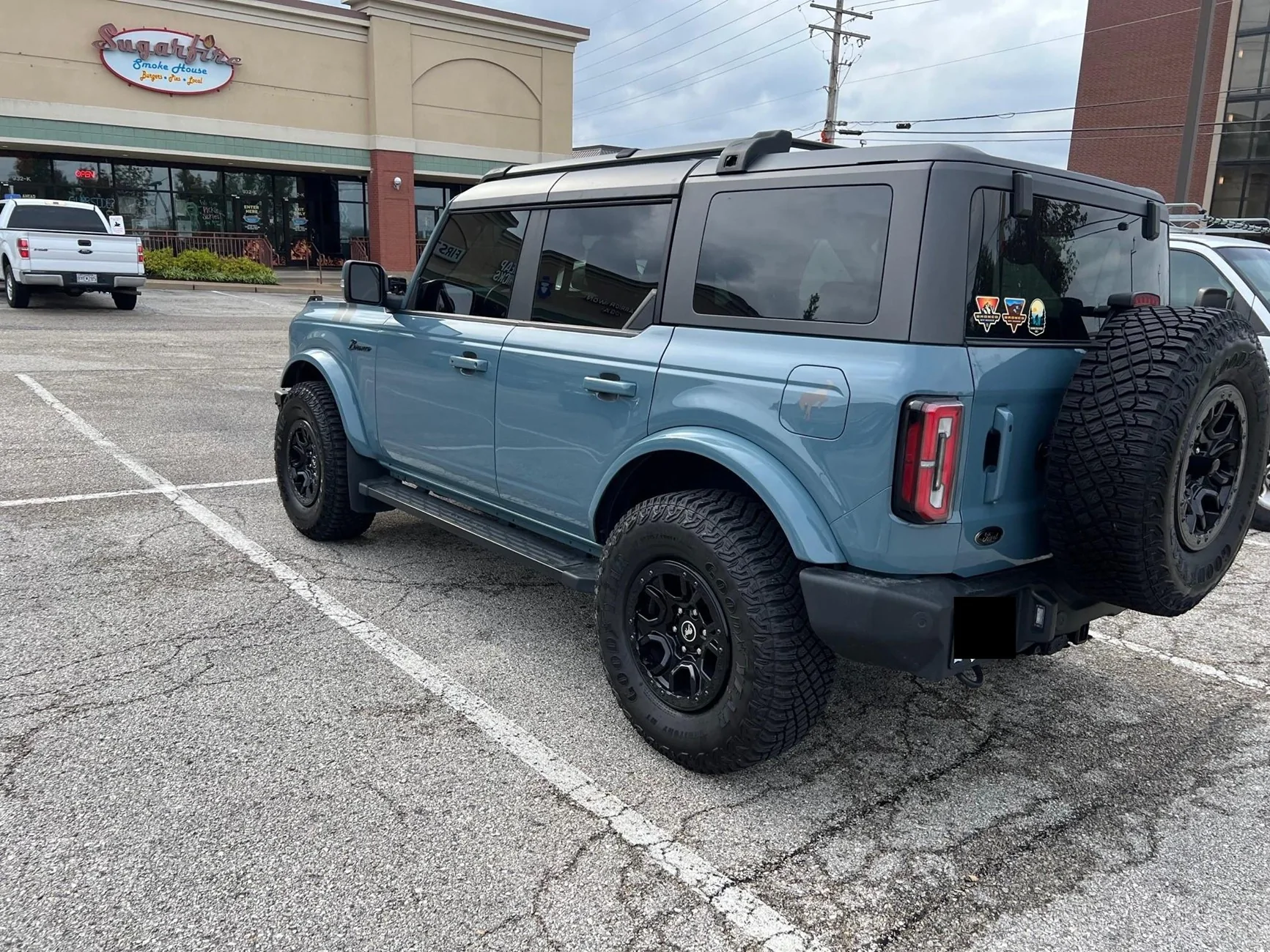

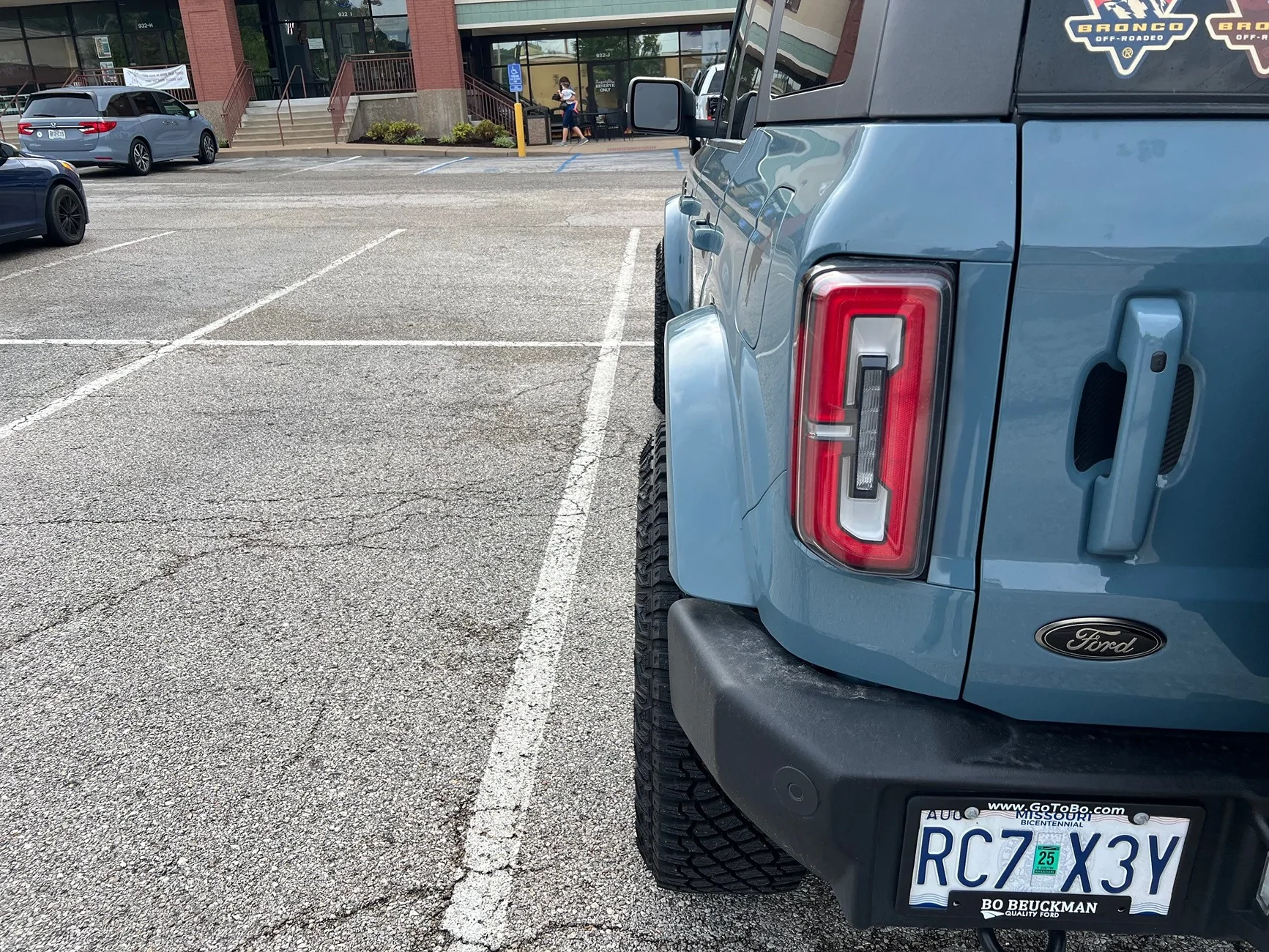

no lift or spacers. I may add 1" or so later
@Joemama, what is the offset on those wheels? I want to pull the trigger on some aftermarket wheels but not really sure what offset is needed. I have a Badlands (non-SAS). Looking to add the Fabtech 2021+ Ford Bronco 4WD 1.5in Leveling System if needed to get some 35x12.50 tires on there.
+30mm
Joemama
joe
Oct 21, 2021
89
75
St. Louis, MO
Hyundai Sonata
They are takeoffs from a wildtrak model. 17″ Ɨ 8.5″ wheels with a +30 mm offset.
and yes, crash bars are removed.
