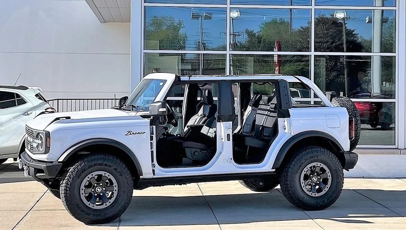

BORA 1.25 installed last year, made In USA.
That stance looks awesome, thanks for posting. A little sneak peek of what mine will look like!

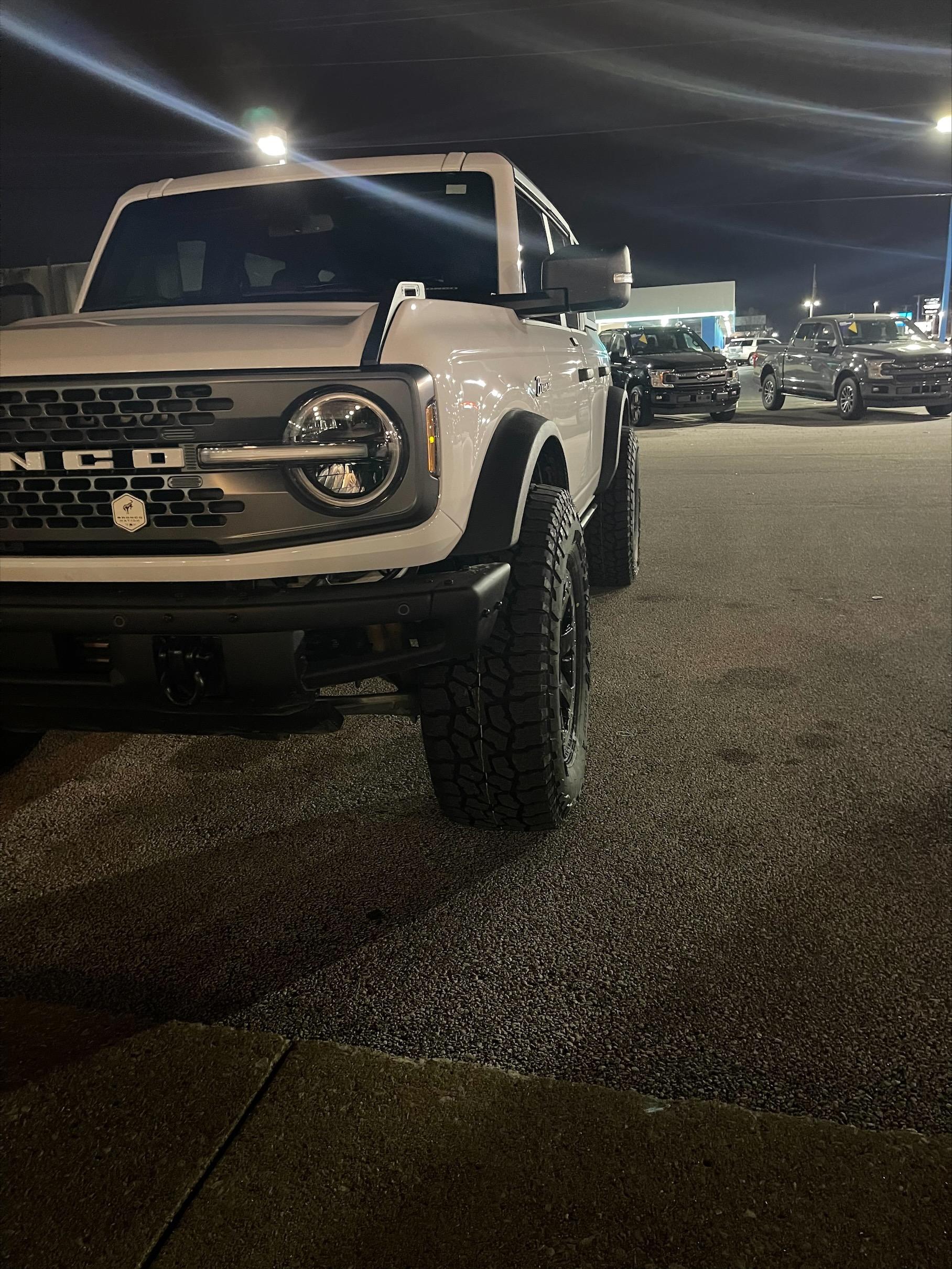

Or keep your eyes open for some standard flares. I waited probably 6 months till I found someone selling theirs local and drove 2 hrs to pick them up. I found them on Facebook marketplace for 250$. About same poke as having a 1.5 spacer.

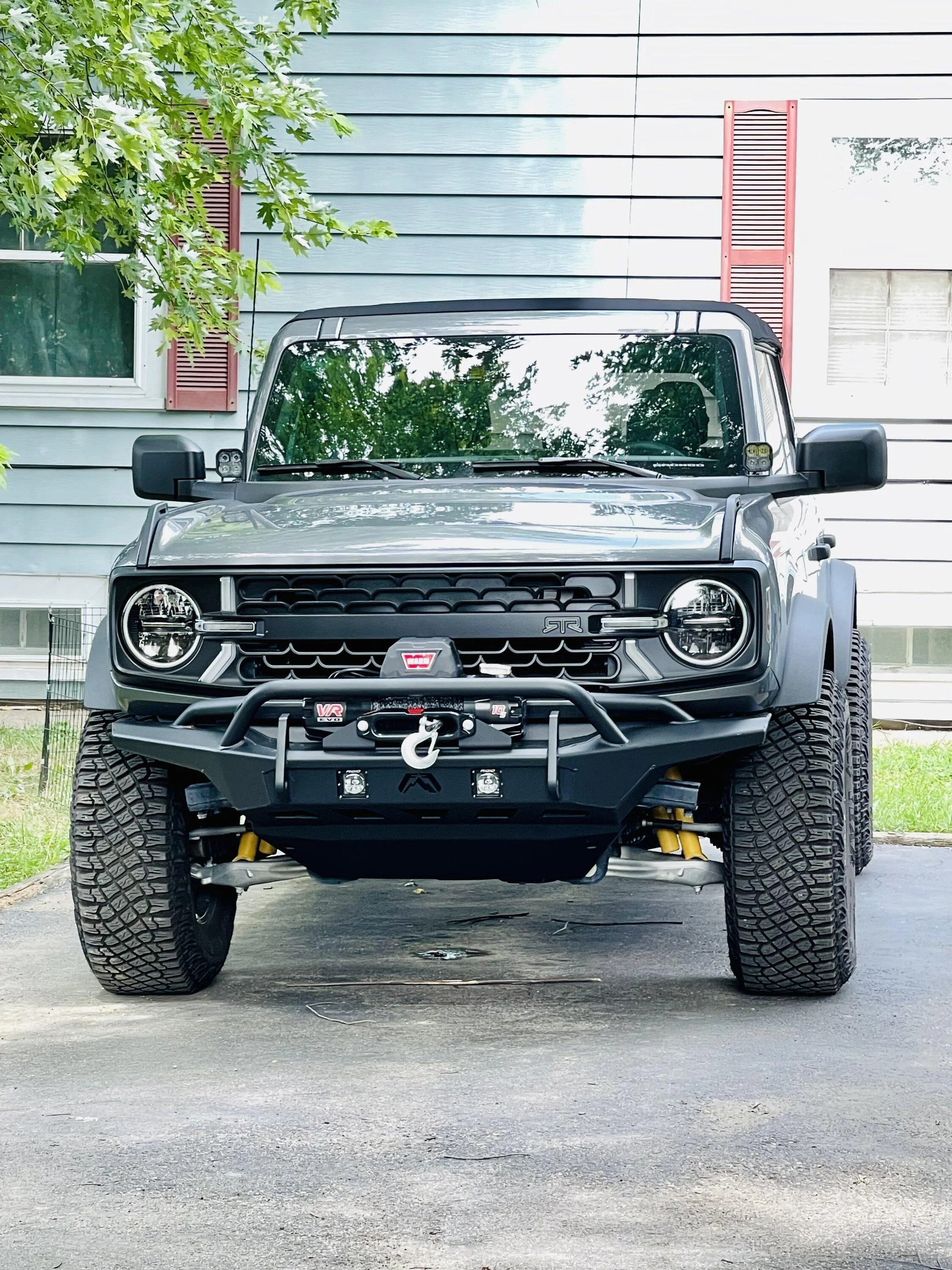

Non squashed BL with 1.5" BORA wheel spacers. ~10k miles on them. No issues on or off road.

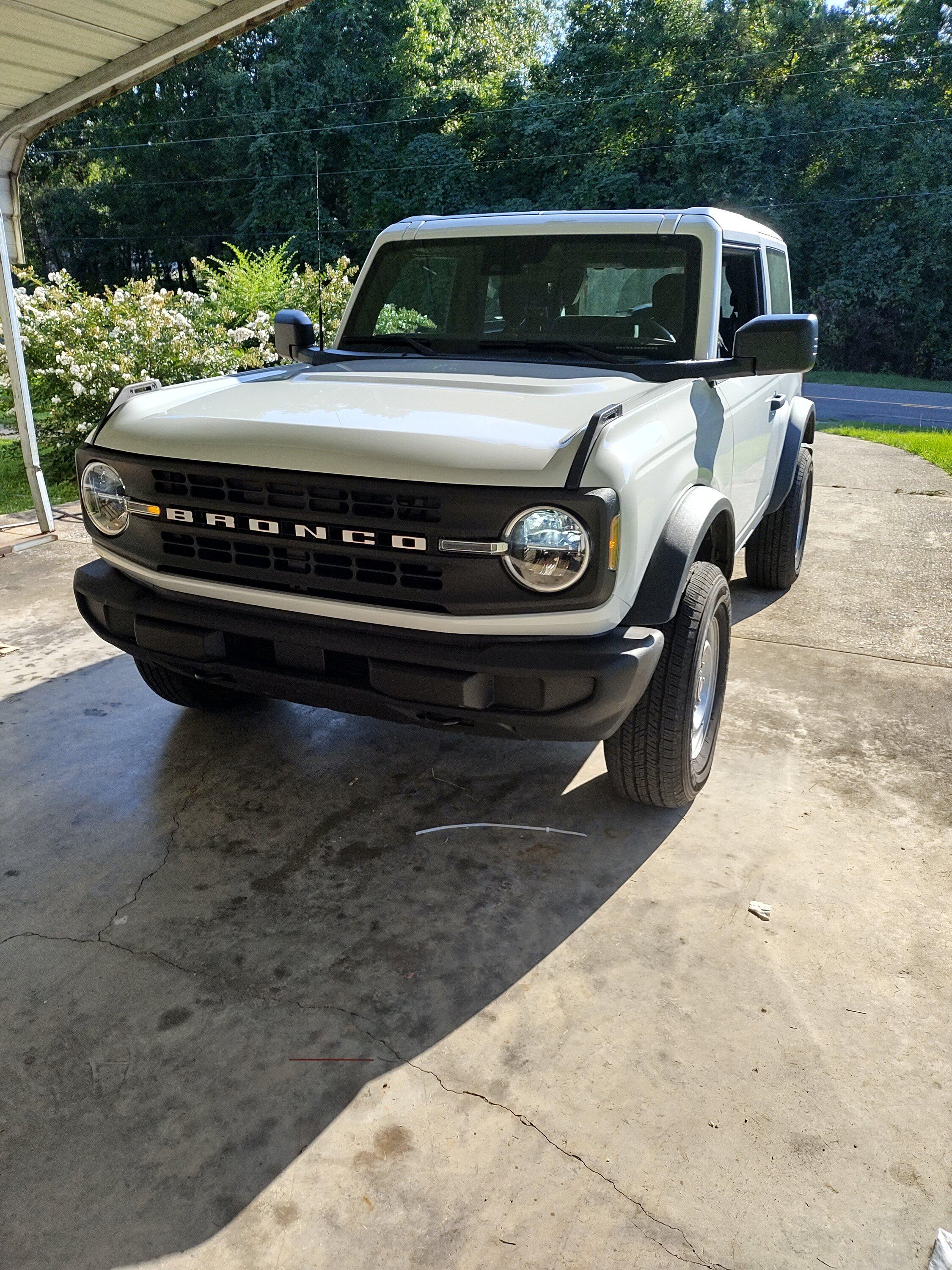

1.5 was a perfect sweet spot for me. I'm just stock 30" thought. Improved handling greatly and got rid of the top heavy feel. Also just made it look so much better.
Looks good. Did you do it yourself?
Yes. Wasn't hard. Just time consuming. You can go to the showcase section of the website here and mine should be the first one on the list right now( same picture) I have a list of all the things I've done. Only thing not on there is the afe Apollo gt scorcher which I ordered yesterday. Also have pedal monster but have to wait for an exchange cause I ordered the wrong one.
Awesome. Thanks!
