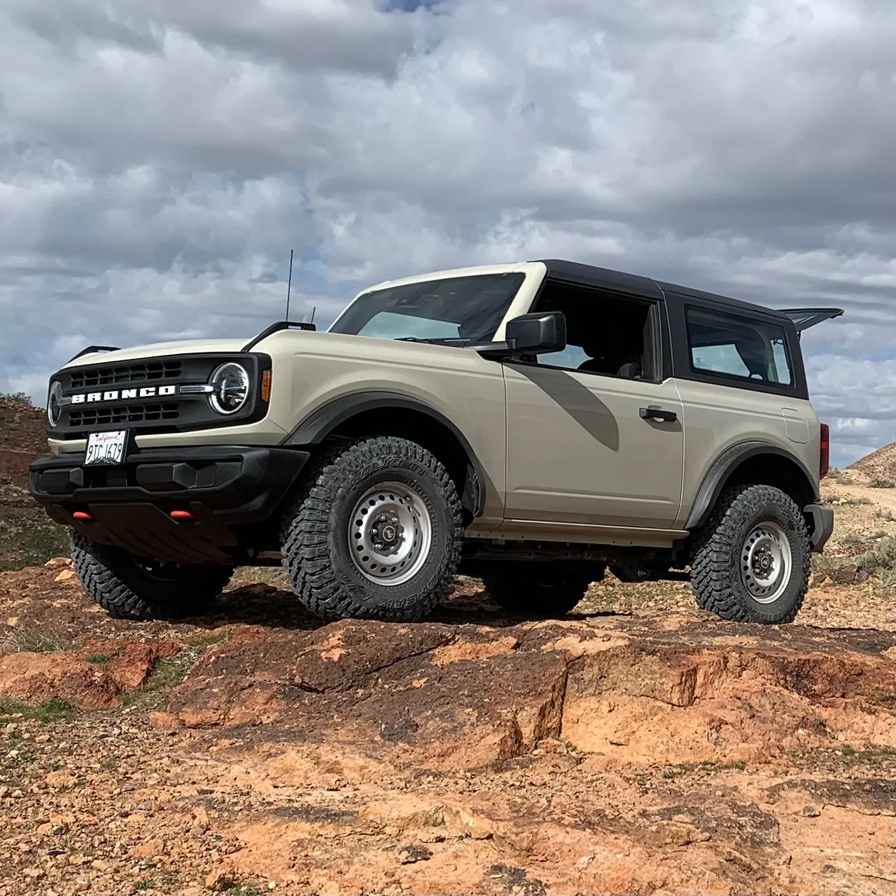

Got my 2 door base spinning 255/85 16’s (33”). It’s just a weekend runabout with an occasional desert day run. Could use a little boost, mostly for aesthetics, maybe a little less scraping on the trail.
I was thinking 2” spacer lift would suffice. But maybe I should consider having something like the Eibach coil overs swapped in.
Or just leave it (K.I.S.S.) as I am not interested in going down the build evolution path.
