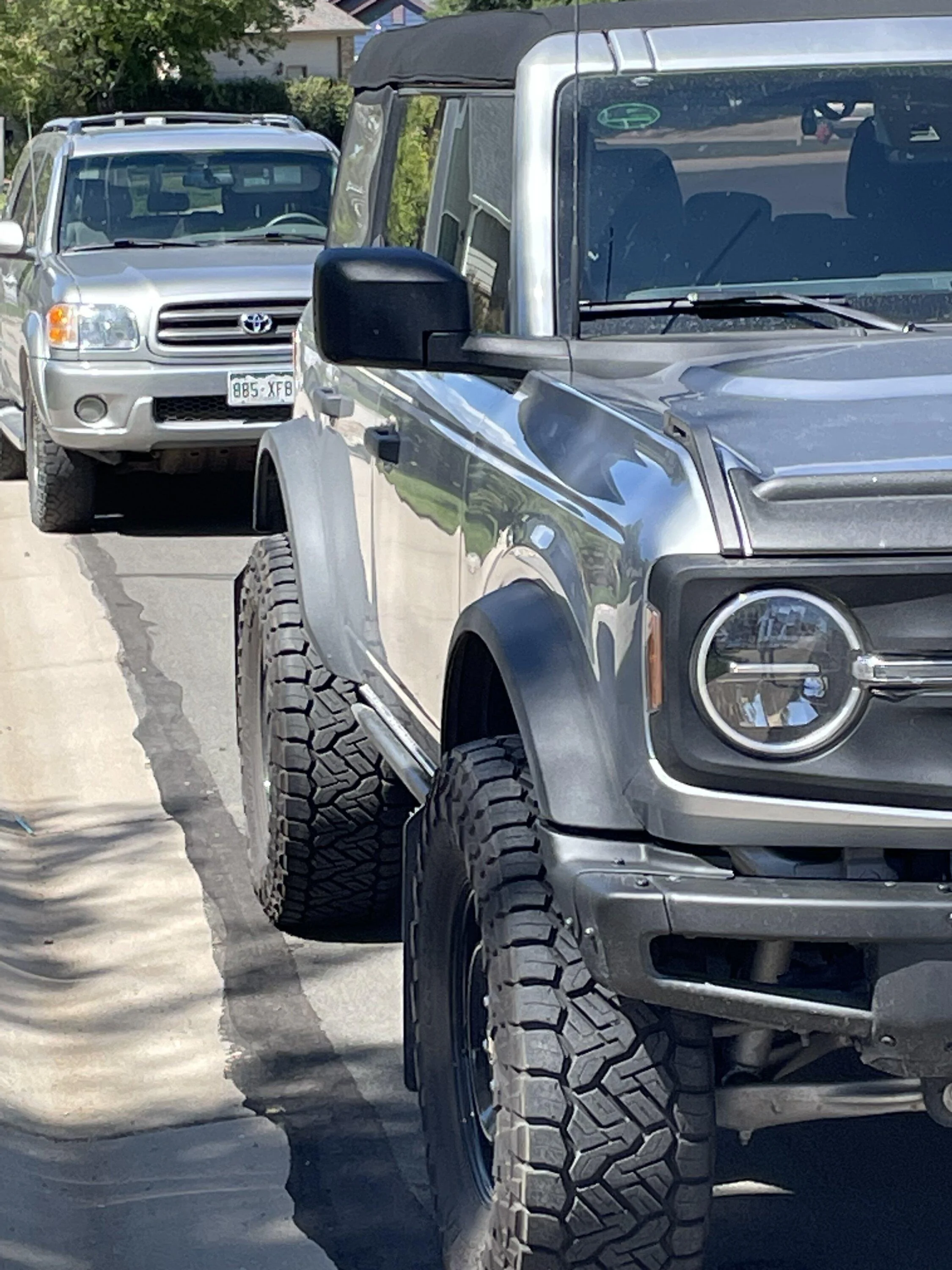

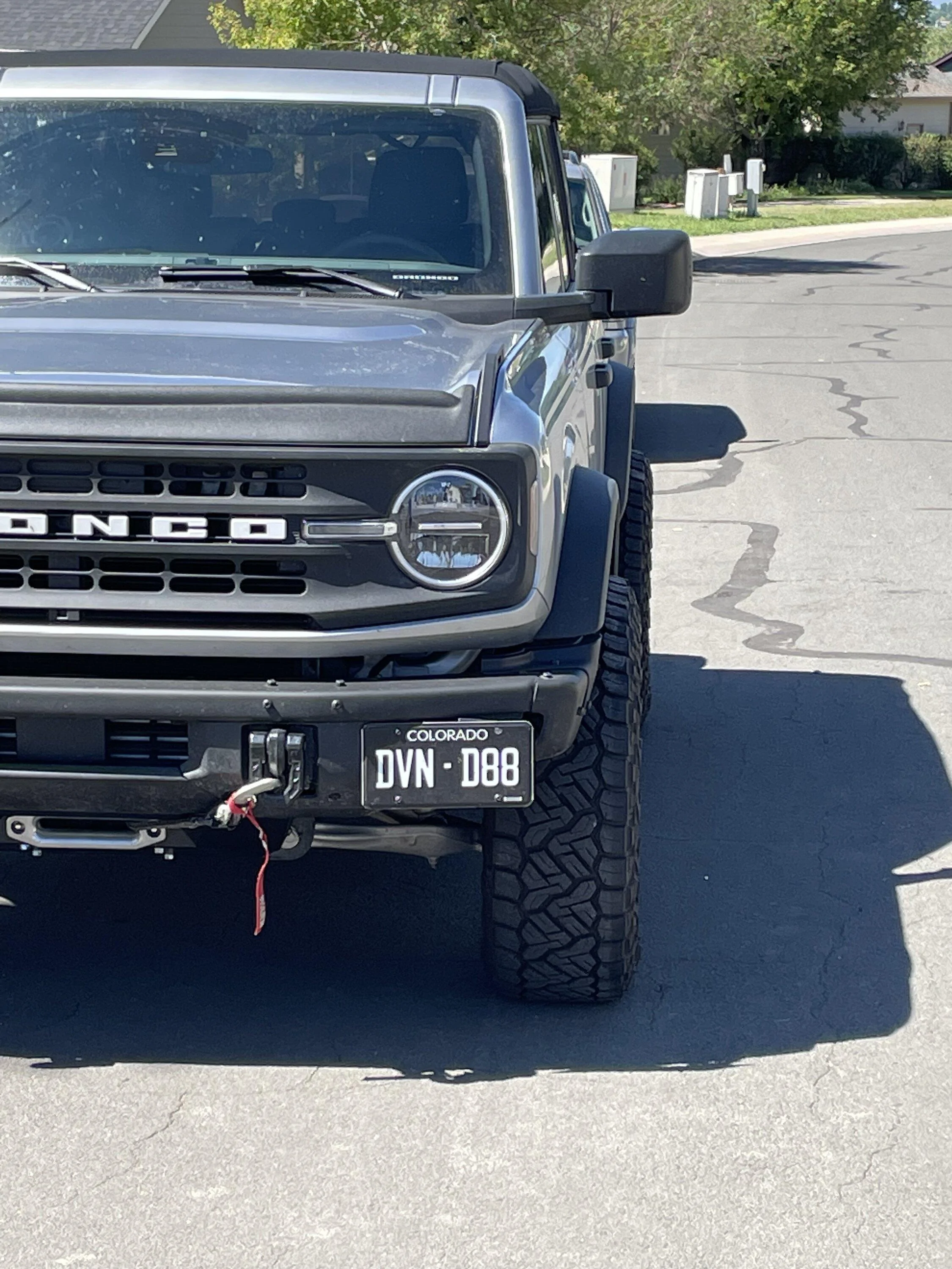

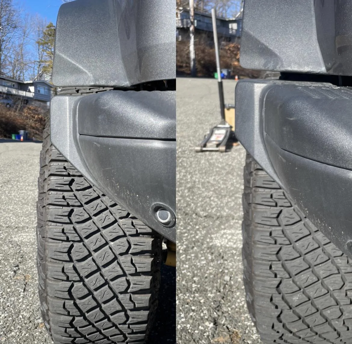

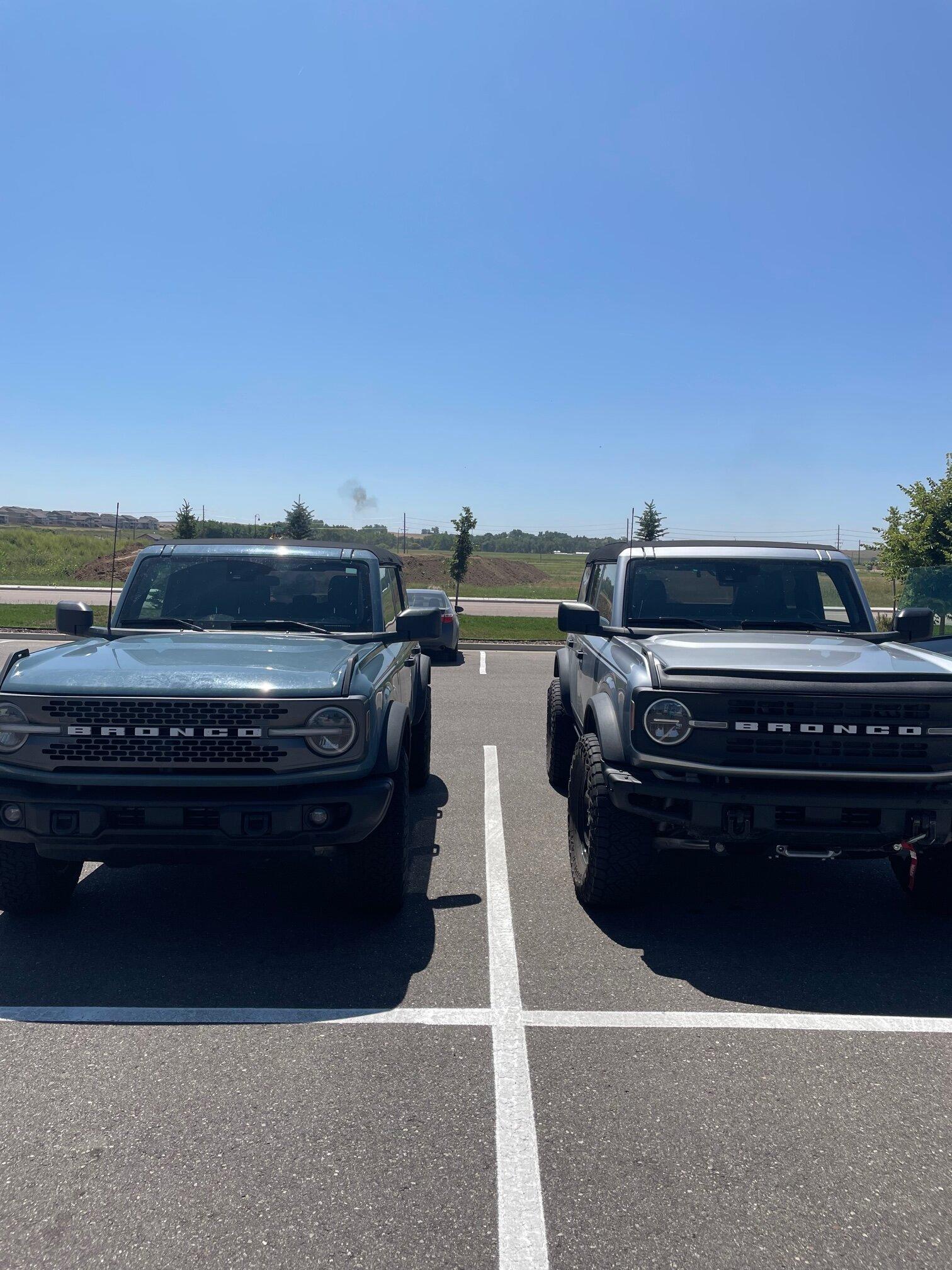

i installed 1.5” KSP wheel spacers this pst weekend. I’m very happy withe the poke it added. the tires now match the Rockblokz flaps. I added a few pics, below. I added a pick with another Bronco to compare.

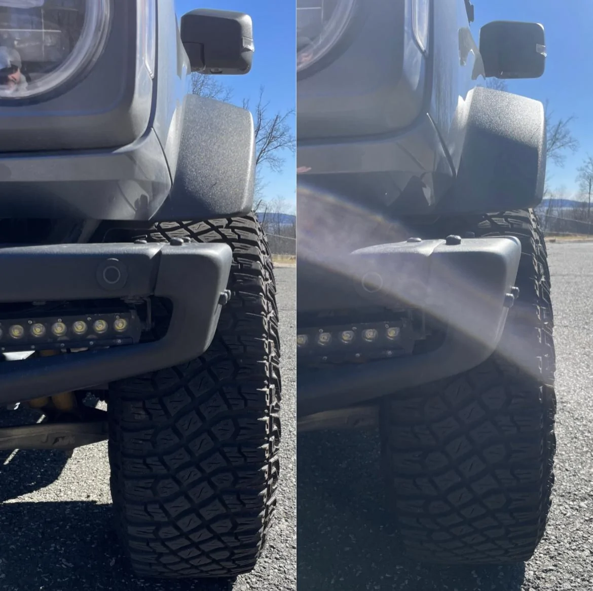

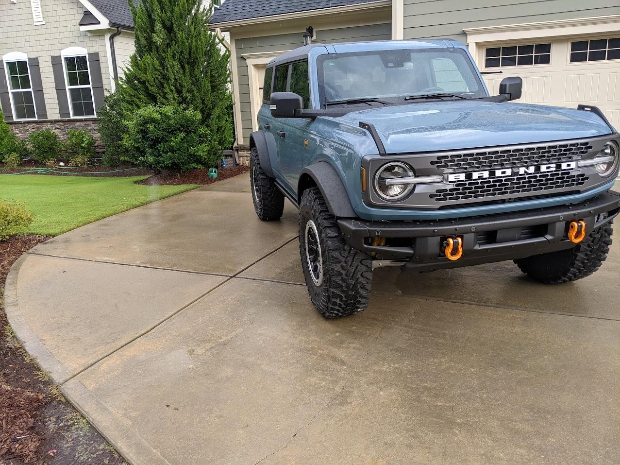

I went with 0.75" Bora Spacers, which gave me the best offset for running 37's and no lift. Just cleared the crash bar mount on the front and the slider in the back. The pockets on the backside of the sasquatch wheels are just deep enough to clear the studs protruding from the spacers. 0.75" is definitely as thin as you can get.
Now that I am on Eibach coilovers, I will either go with 1.25" or 1.5" spacers or 0 offset wheels once I get new sliders installed that have better clearance.
Photo from before I installed the lift with 37s:

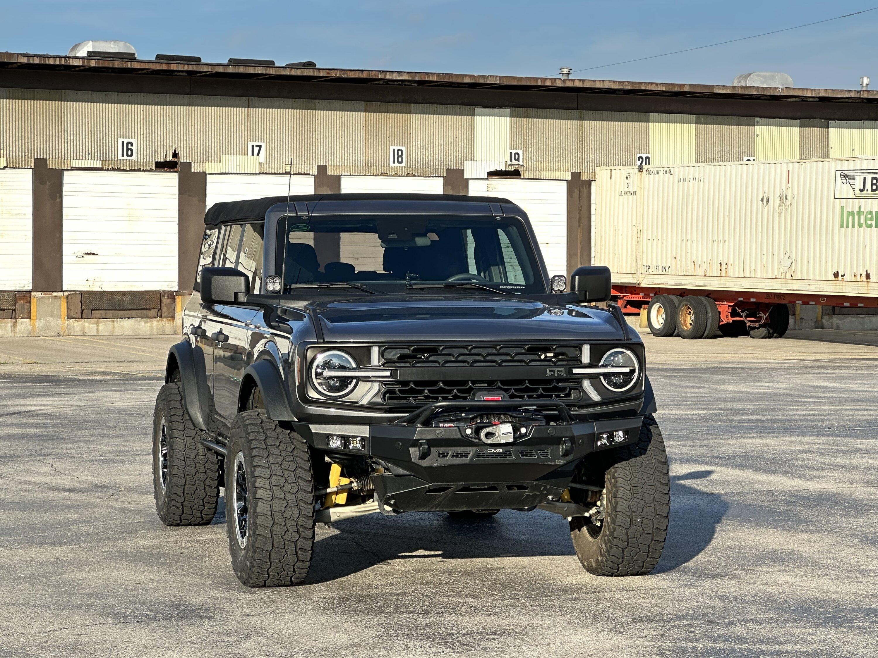

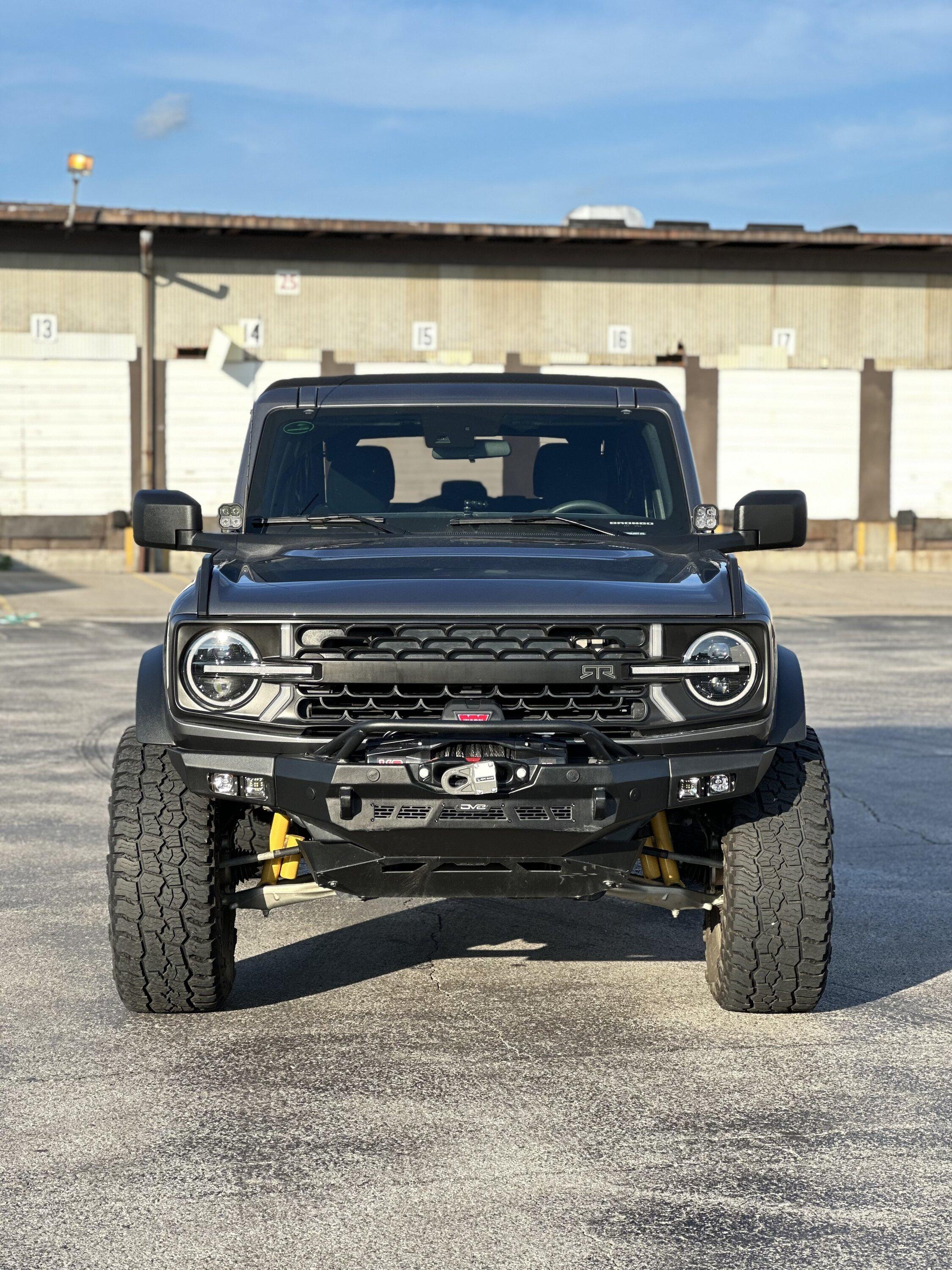

Here’s some 1.2 spacers I put on yesterday to give me a zero offset wheel to run some 37s. This is a Sasquatch with standard flares installed.
Just seeing this pic, looks great! I would say though you are way wider than zero offset. I am running zero offset 17x9's with 37's and my tires sit flush with my SAS fenders. If I am reading right you put the smaller ones (non SAS) on yours? That is the "POKE" I am looking for. I am told I have to go 1.4's to clear the studs but that is way too much I think. I was thinking 1.2's but my question is do the studs poke out of the 1.2's at all??? I don't want to trim my studs. BORA (BORN OFF-ROAD) says I have to run a 1.4 but seeing yours I thought I'd ask was the stud hanging out at all???

Watch FB marketplace for non Sasquatch flares that’s how I got mine. I think the smallest spacer you can get without trimming the studs is 1” when using a Sasquatch wheel. I’m on 37s and fox elite coilovers now but still running those 1.2 wheel spacers.
