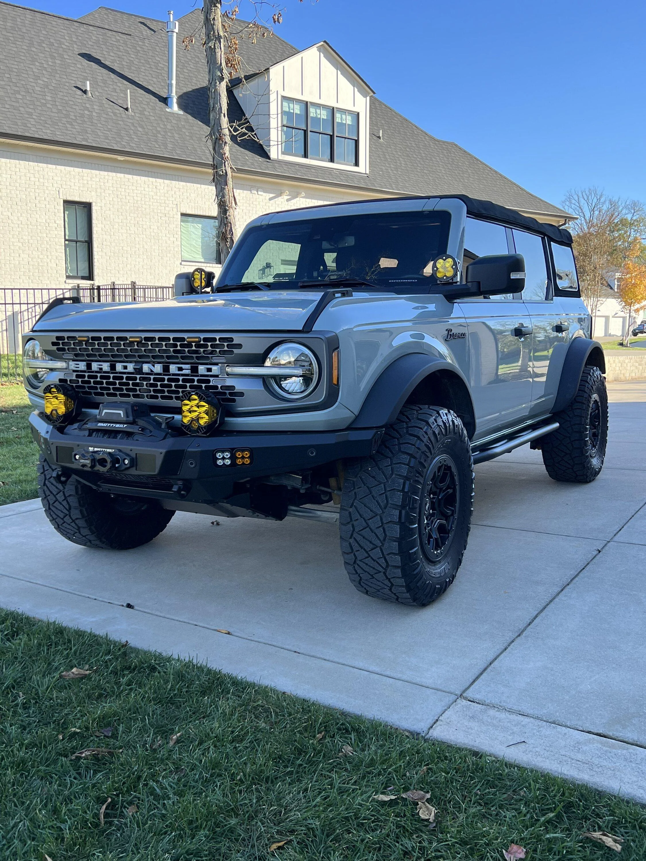

If you look closely at the pics, you will notice that the studs do not protrude past the 1.25” spacers at all (especially on the rear)
I probably could have gone with a .75” spacer and still been good because the stock SAS wheels have a hollow between the holes on the back side.
If your aftermarket rims are 0 offset, then you already have the same amount of poke that I achieved with my 1.25” spacers.
(Factory SAS are -32mm, the spacers bring them out to 0mm)
Hope that helps.
Thanks, yes that does help. Correct, the aftermarket wheels don't have the void in them to allow a little wiggle room. With my lift and the 37's (IMO) with my zero offset wheels it has that "mail jeep" look (not really but to me) so I just wanted a little poke and to me a little more stability. I don't what that "oh lord that looks stupid look" so the smaller the better but I haven't found anyone to tell me really if any stud has to be trimmed on the 1.25 spacer.
When I talked to BORNE Off Road they told me the smallest I could go without trimming studs was 1.4 which by your pix isn't true which is why I am so confused. In the end I am looking for only a total of 1/2 inch to 3/4 inch of poke, not the Carolina squat poke goofy look. Slightly more aggressive but not where someone would say that looks stupid with spacers.

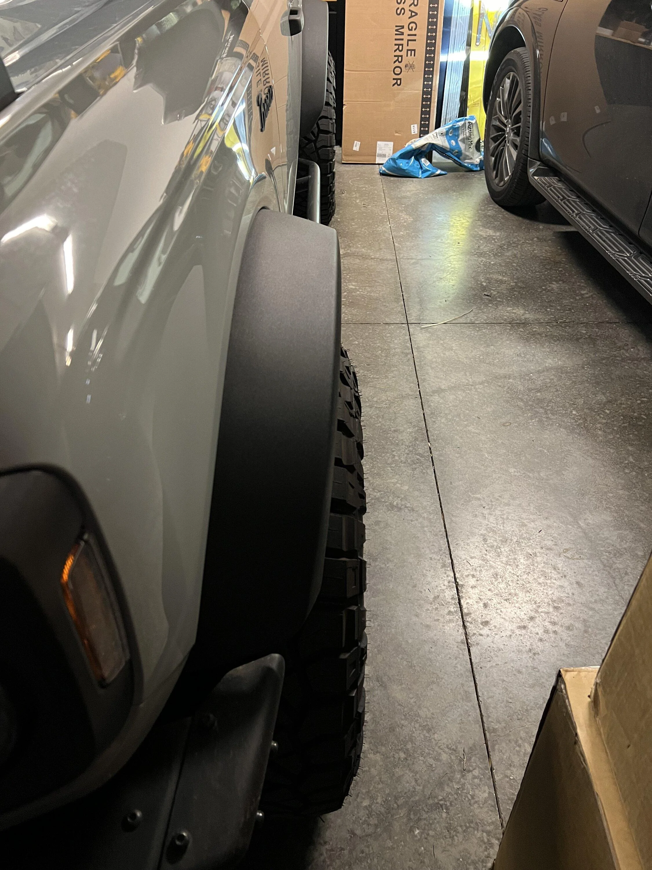

i installed the borne off road (mishimoto) 1.4" spacers on my badsquatch and i had the stickerfab front mudflaps, and the passenger side did rub the flap at full lock. i had to swap em out for the iag mini flaps and now no more rubbing

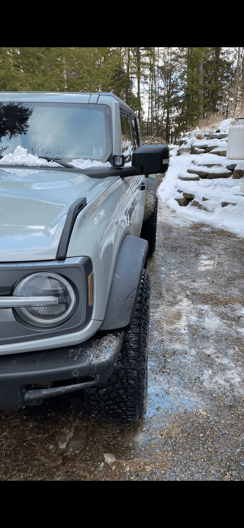

1” Mishimoto. No rub. 35s
