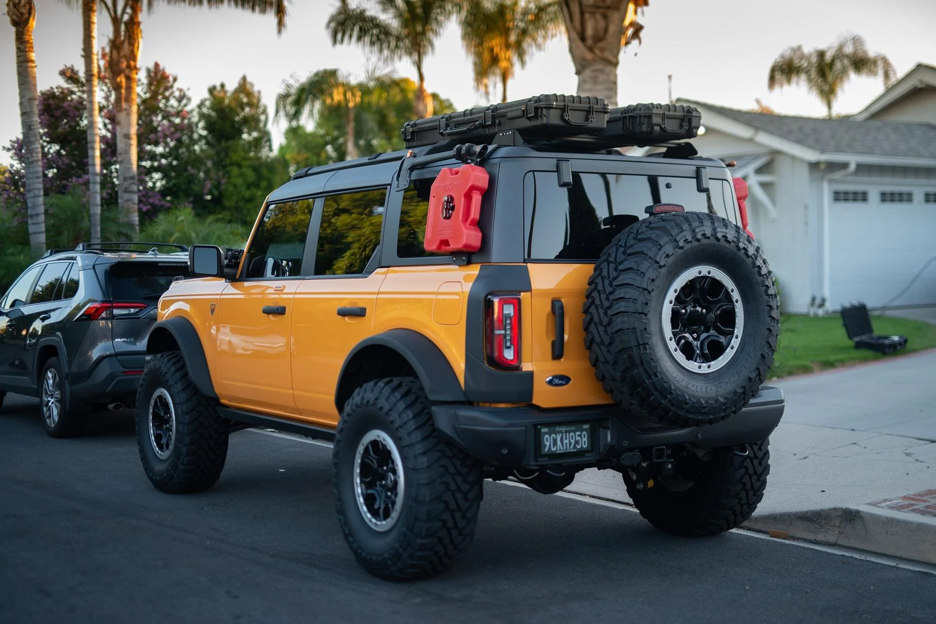

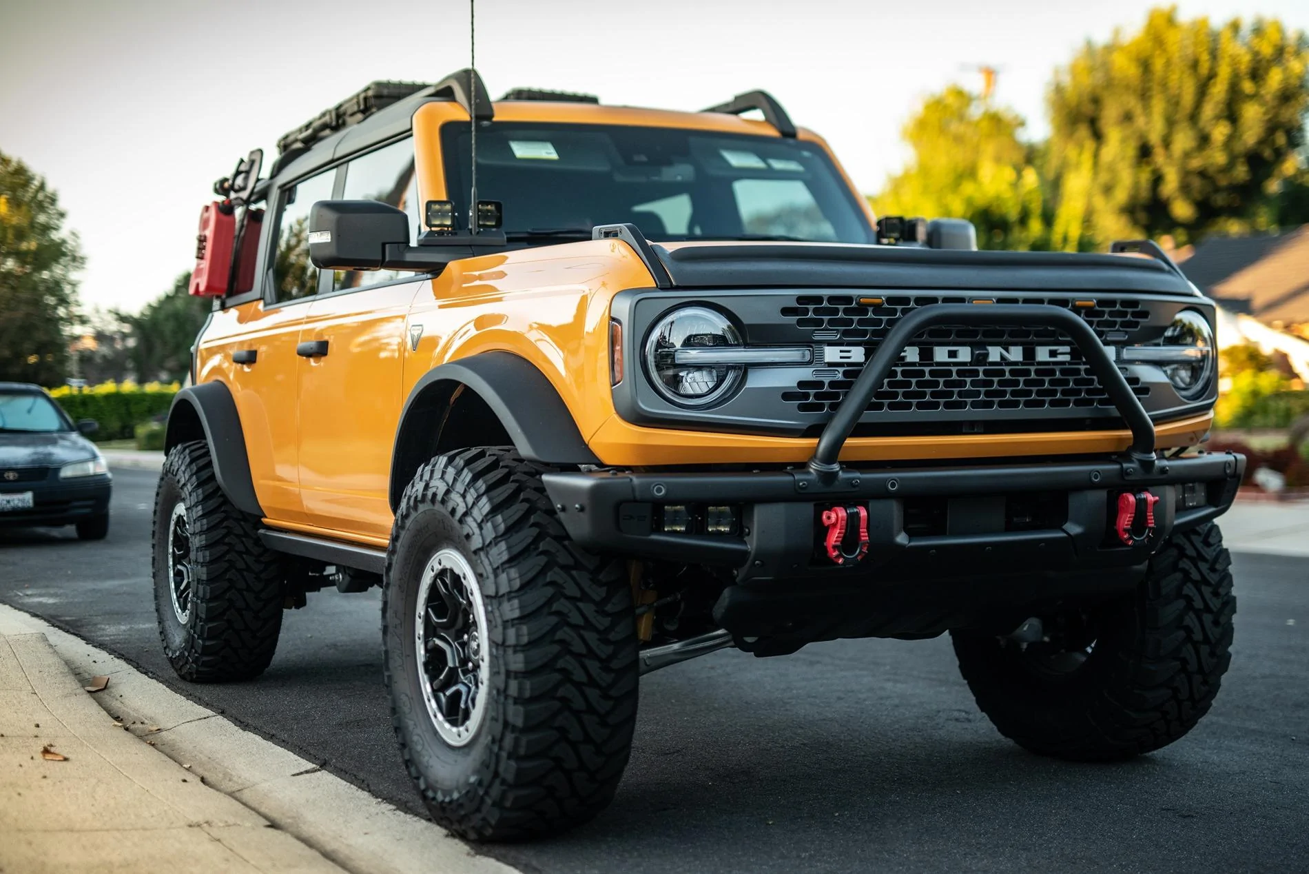

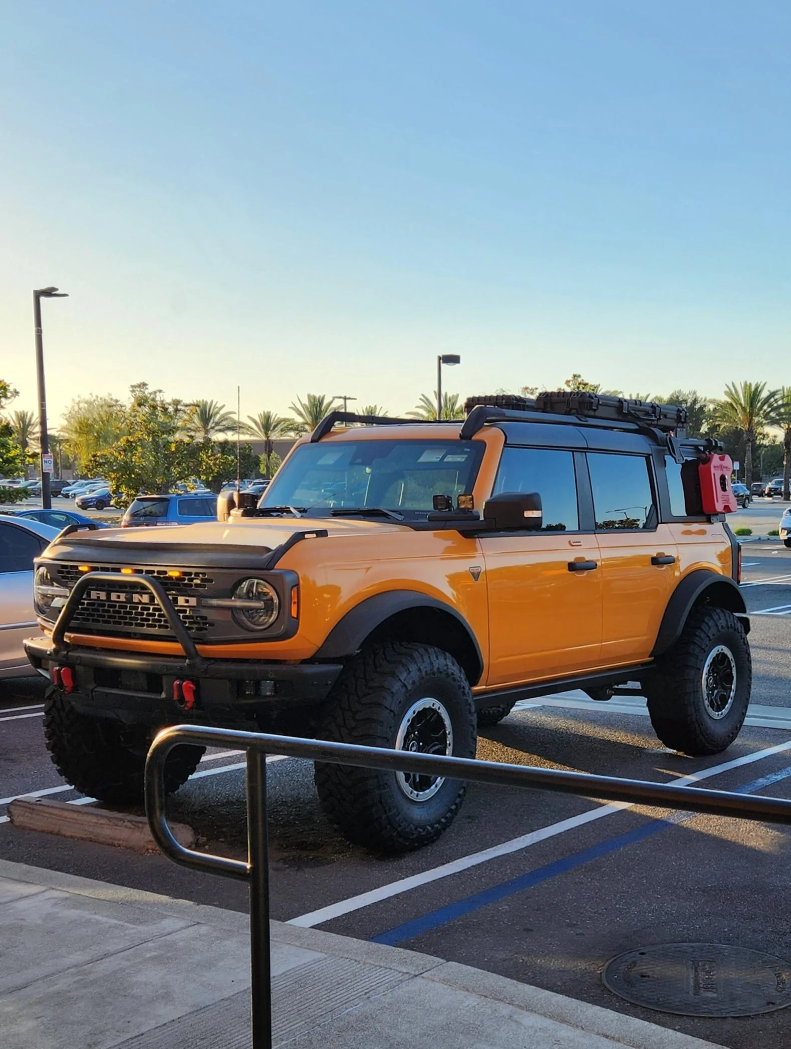

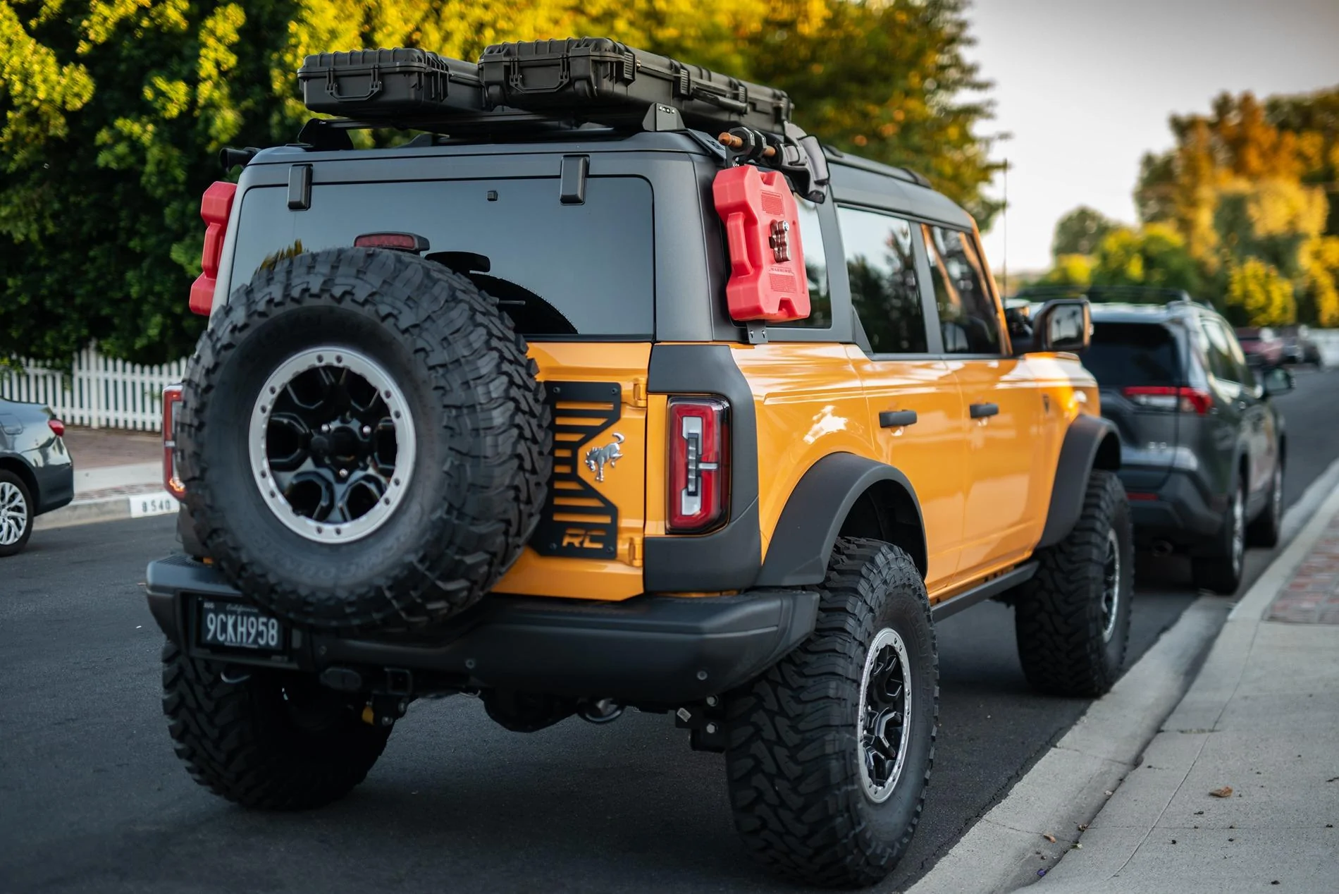

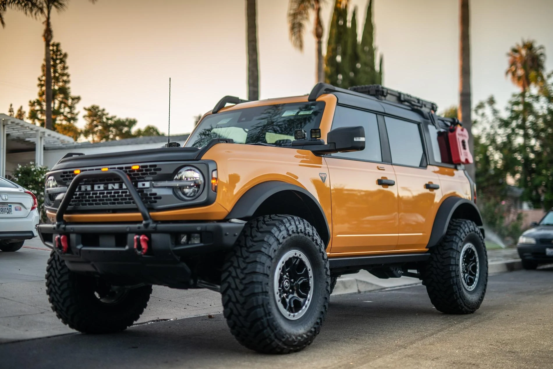

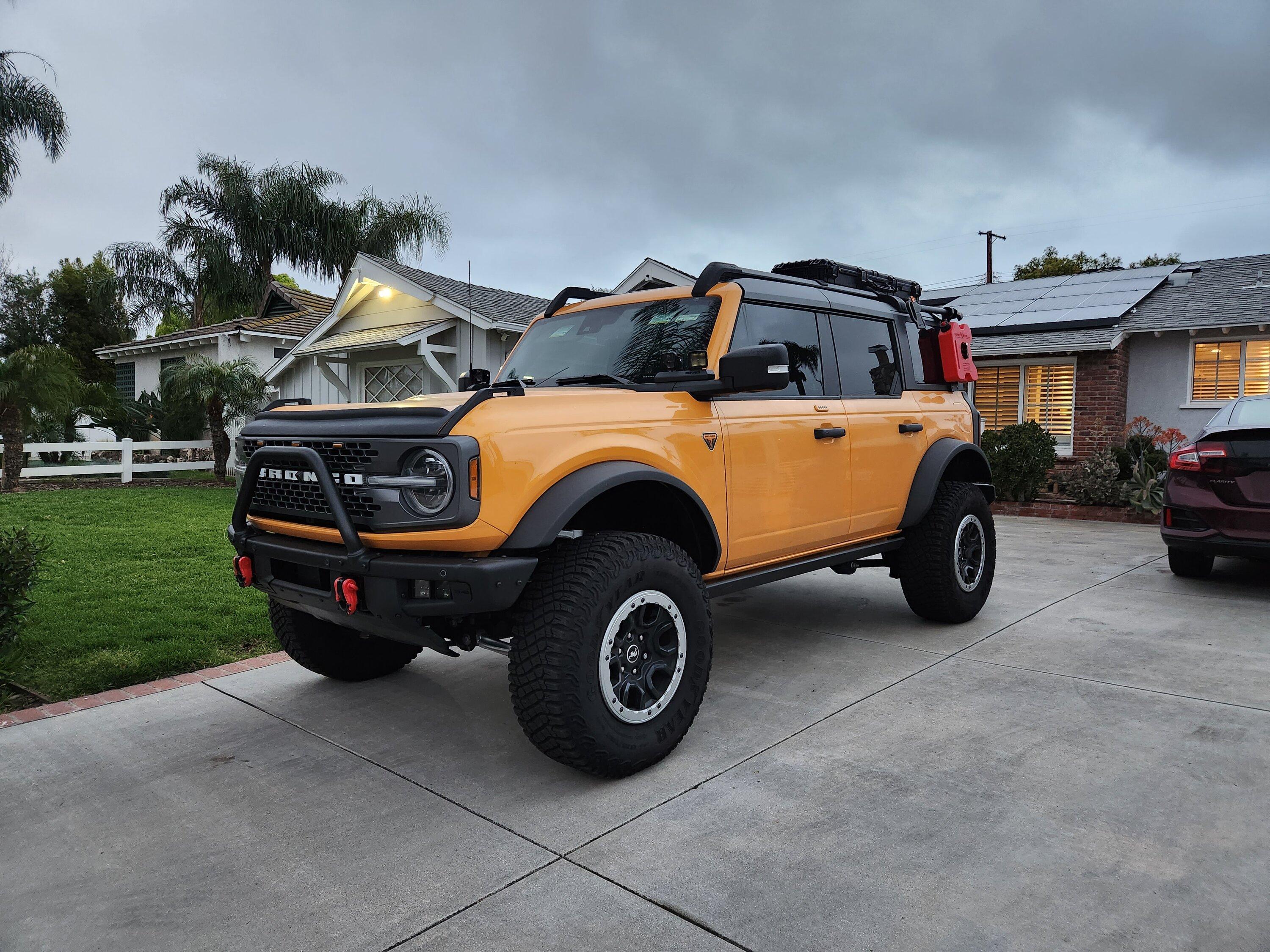

SURE! Sorry haven't been paying attention in the forum. Sold it about 3 months ago. Really glad I went with the 37x13.5 Toyo M/T. Completely change the look. The new owner is enjoying it as well!
Definitely your going to need the JKS kit or trim the frame. Also if you have the OEM rockslider, need to trim that too. ITS ALL WORTH IT though!

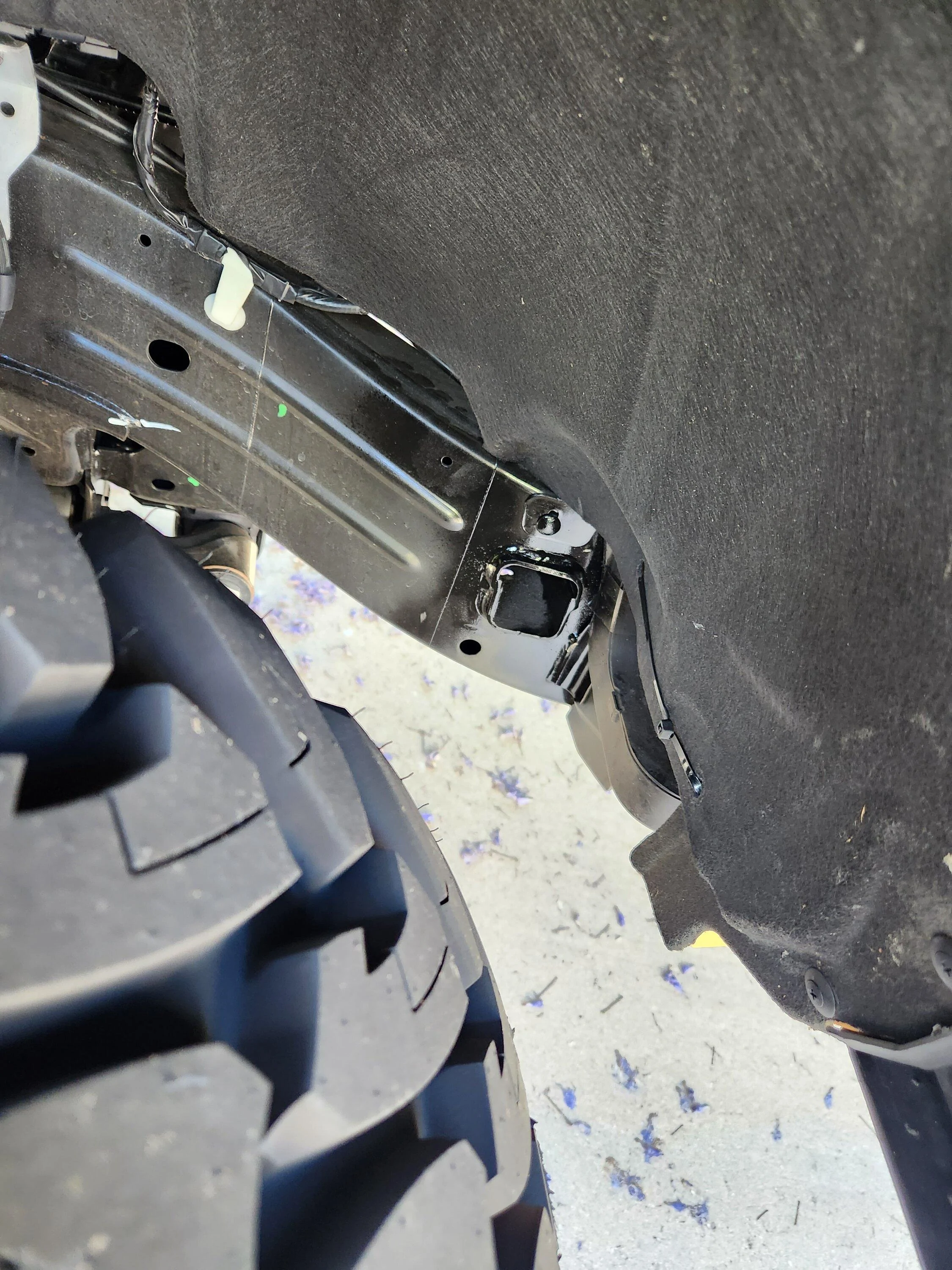

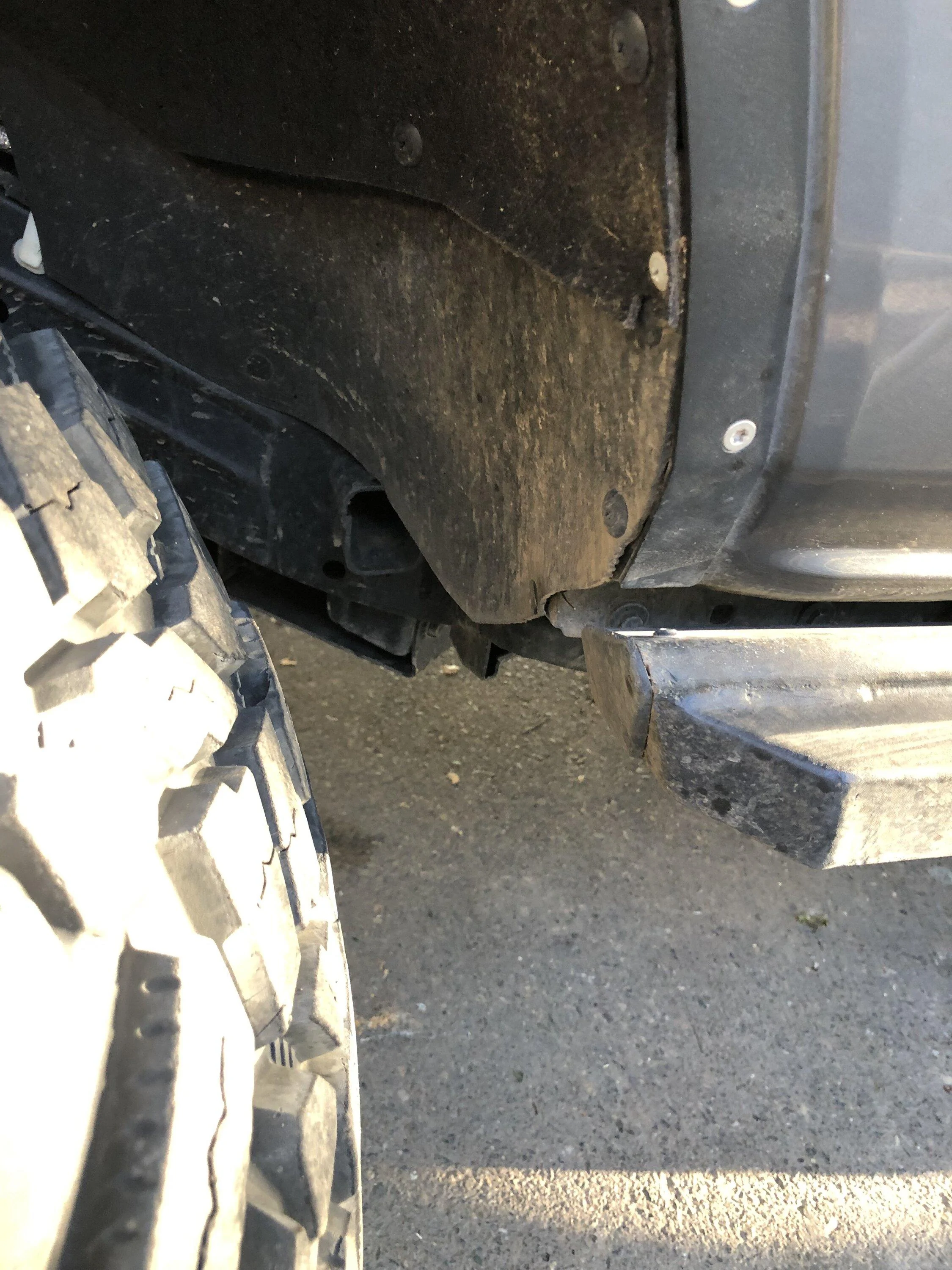

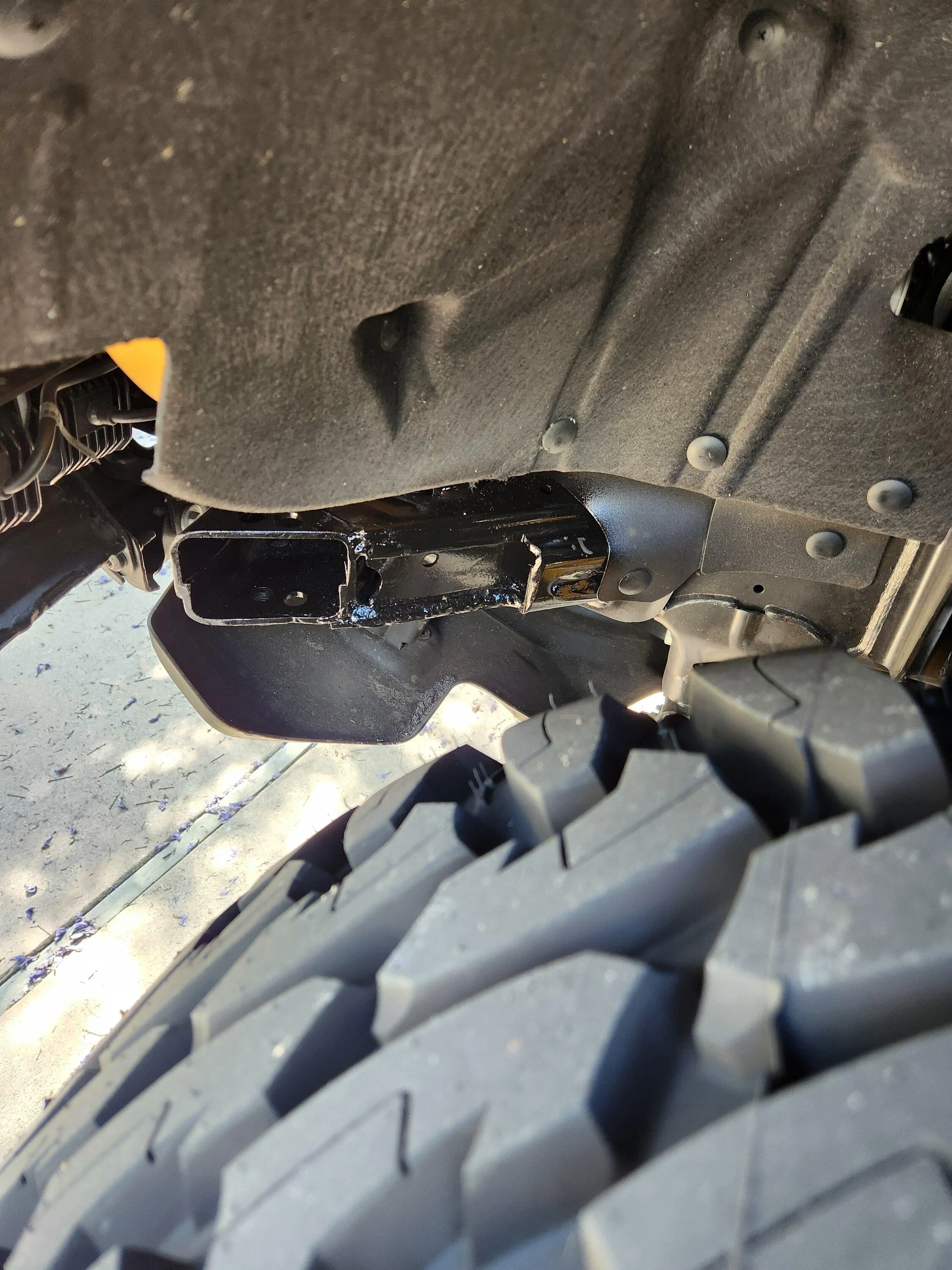

Okay I decided to just go for 13.5 wide Toyo 37s M/T. Don't regret it at all. After reading posts for days, looks like even with 12.5 I would still need to do some trimming with 37s. SS Bronco was spot on. Drove it 100miles on first day in the city/freeway. No rubs until backing out and doing full lock. Seems to rub mostly on OEM sliders. Will be cutting it 1in 1/4 and cut both crash bar mount. The honeycomb one is easy hehe.

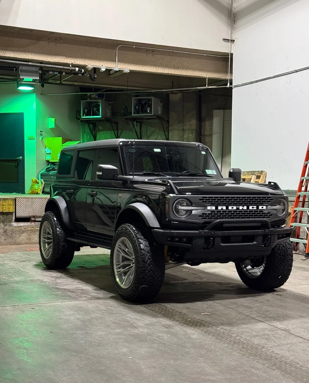

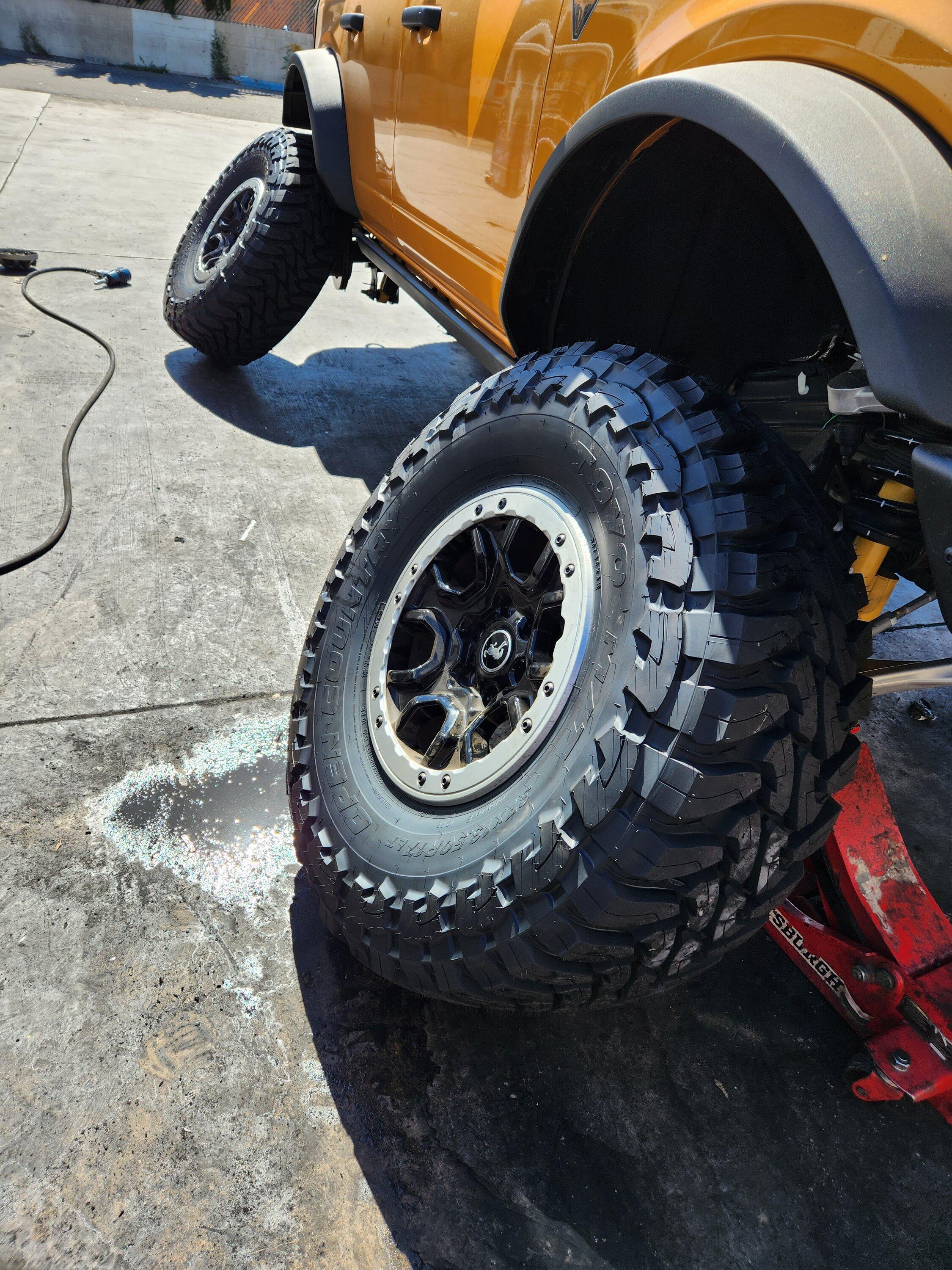

37X13.5 22 -22 offset Ferrada wheels
BDS LIFT KIT
TRIMMED ROCK RAILS
REMOVED PLASTIC BLOCKS BY INNER FENDER
TRIMMED FENDER LINER
SLIGHT RUBBING WHILE BACKING AT FULL WHEEL LOCK

Nice, what tire is that?
