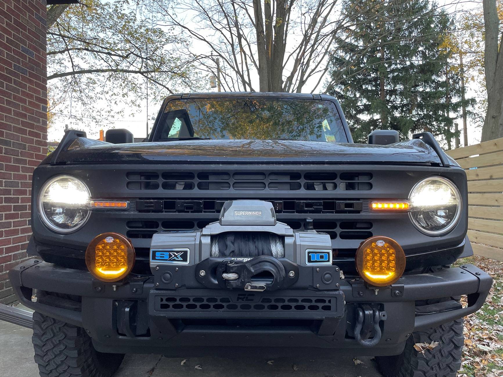

From the Great Lakes region here. Rain weekly (at least) and snow/ice for a couple months in the winter. I have a Base non-sas w/ the 2.3/Auto combo you have. Mud terrain tires, no winter service rating.
I gotta say, it’s hard to imagine spinning out on wet roads with this thing. Hydroplaning or slick clay aside, this seems like 💯 a problem with too much skinny pedal or taking corners with too much speed.
As far as getting stuck goes, I’d start by learning the true limits of your open diff in a controlled environment (off road park). Once you know the limits, install a winch to cover you in real-world scenarios where you might underestimate the difficulty level.
If/when I decide it’s time for an e-locker, I’m going to also make that the time I regear the 3.73 for something that can handle tires bigger than my current 33’s.
Ford Bronco Anyone added a limited slip differential? IMG_4778

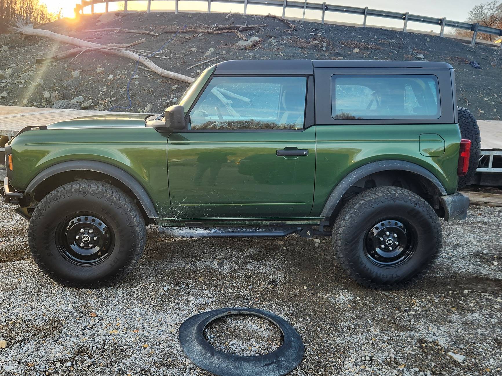

base on 37s just use your mode sand mode and low not hard on the pedal if you have a auto two foot it . i go the same places every other bronco goes . i do have a 4 door with a locker but i hardly every use it. it has all the modes i use sand mode and two foot it.its on 37s to. tires can make a differnts to. take it out of drive and shft it you self much easer on the trans and makes the goat mode ingage much easer. my base is a 7 speed i use crawl and sand mode on the harder stuff. i have been told if i had a locker i woundnt have any fun. i do put on a good show sometime been on a winch cable twice when on 35 on 37 did the same trails with no problem. are group we want you on 35s and a locker .
Ford Bronco Anyone added a limited slip differential? 1000000873
