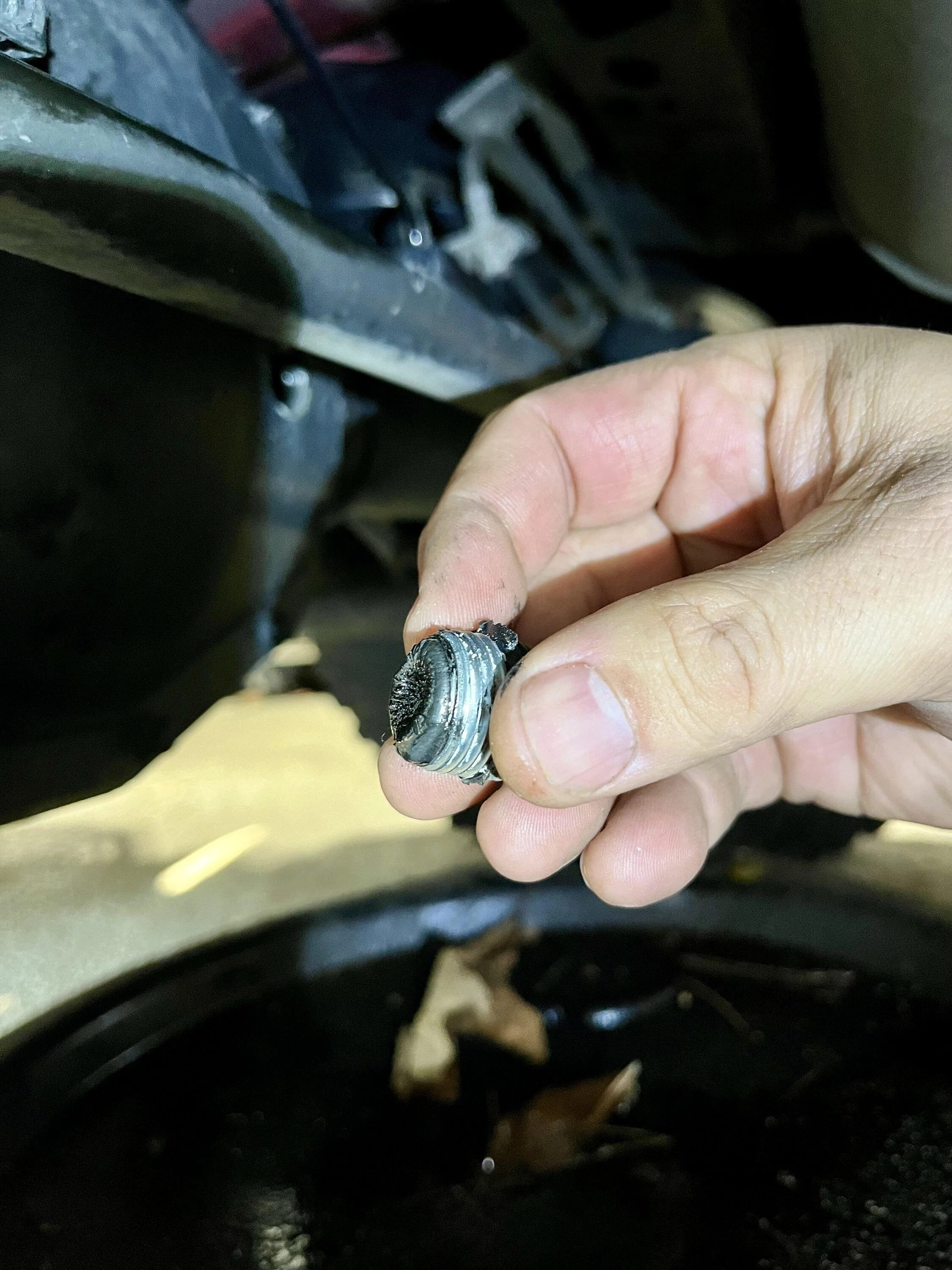

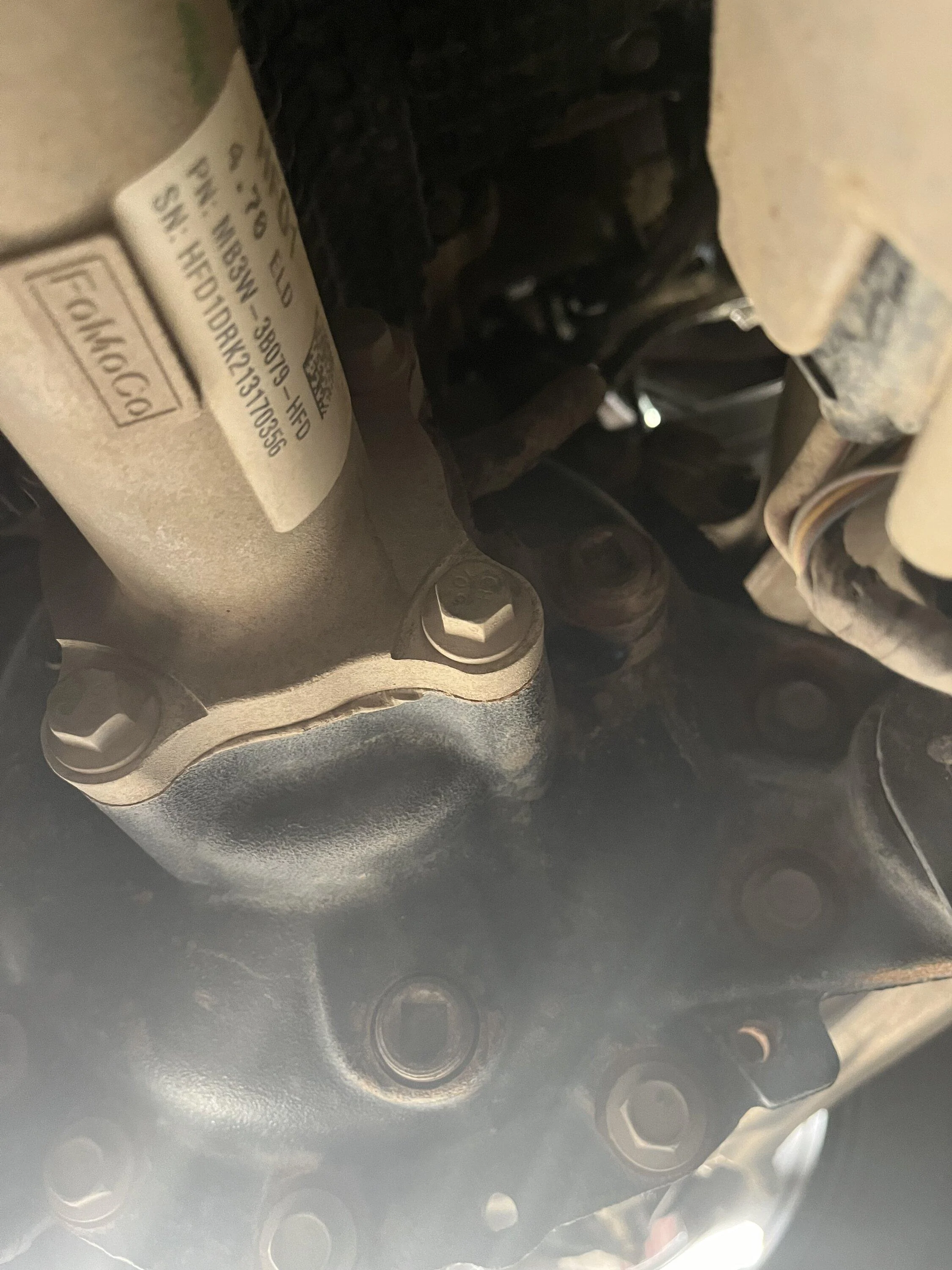

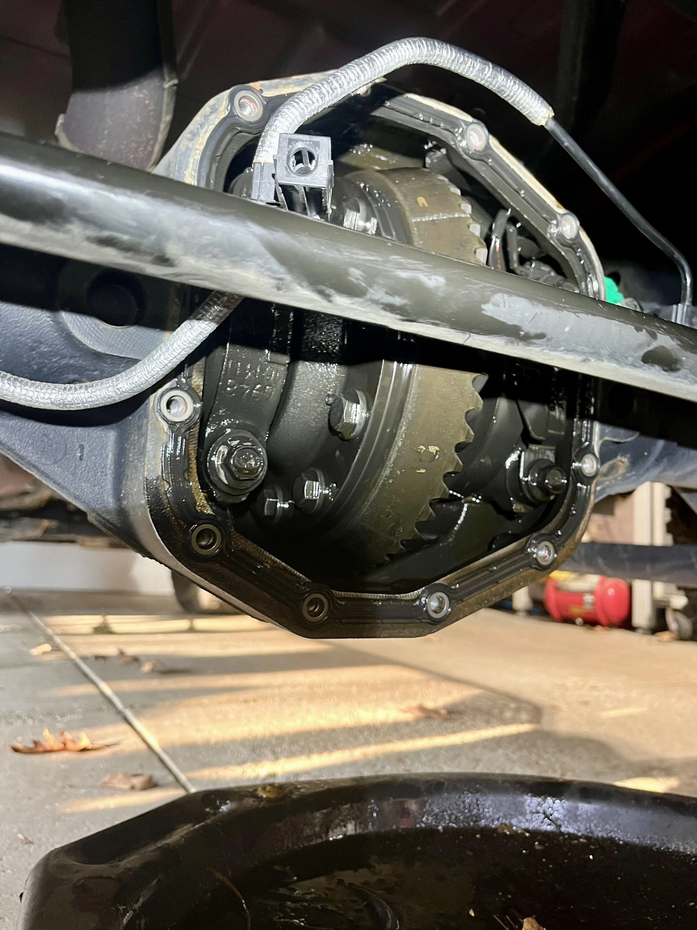

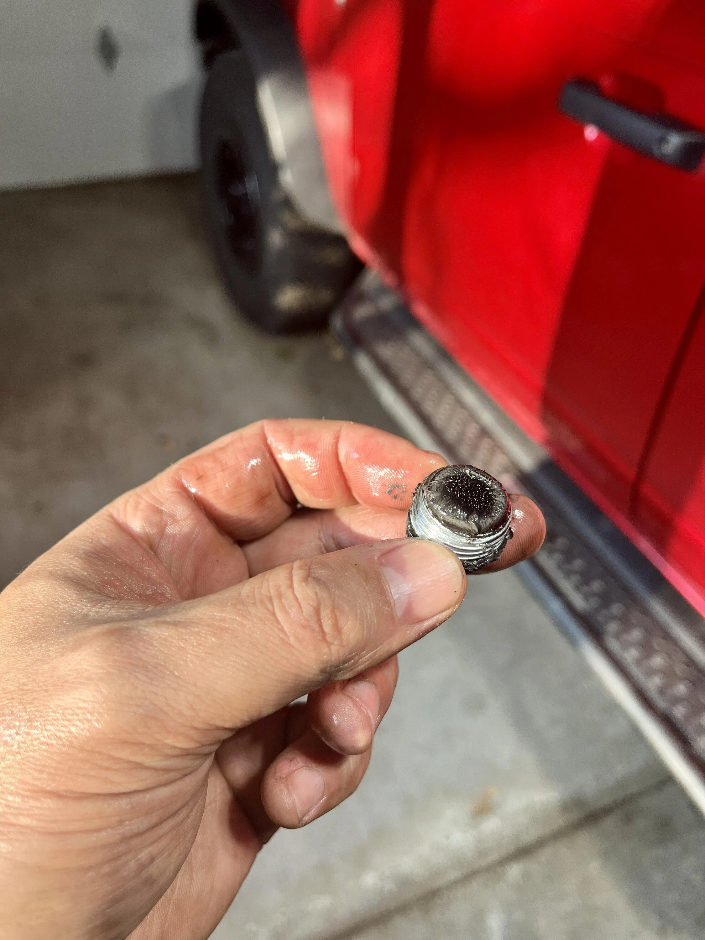

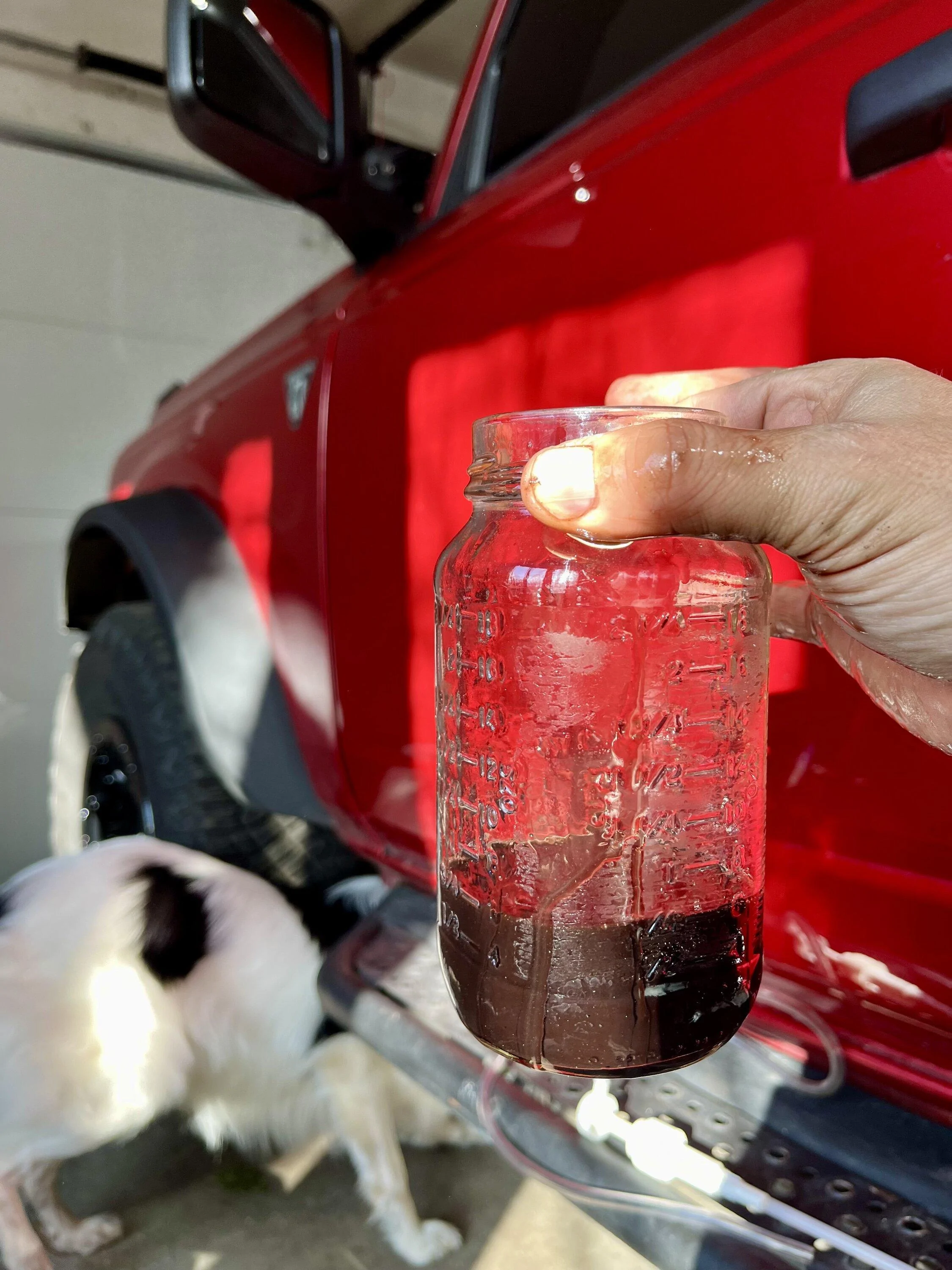

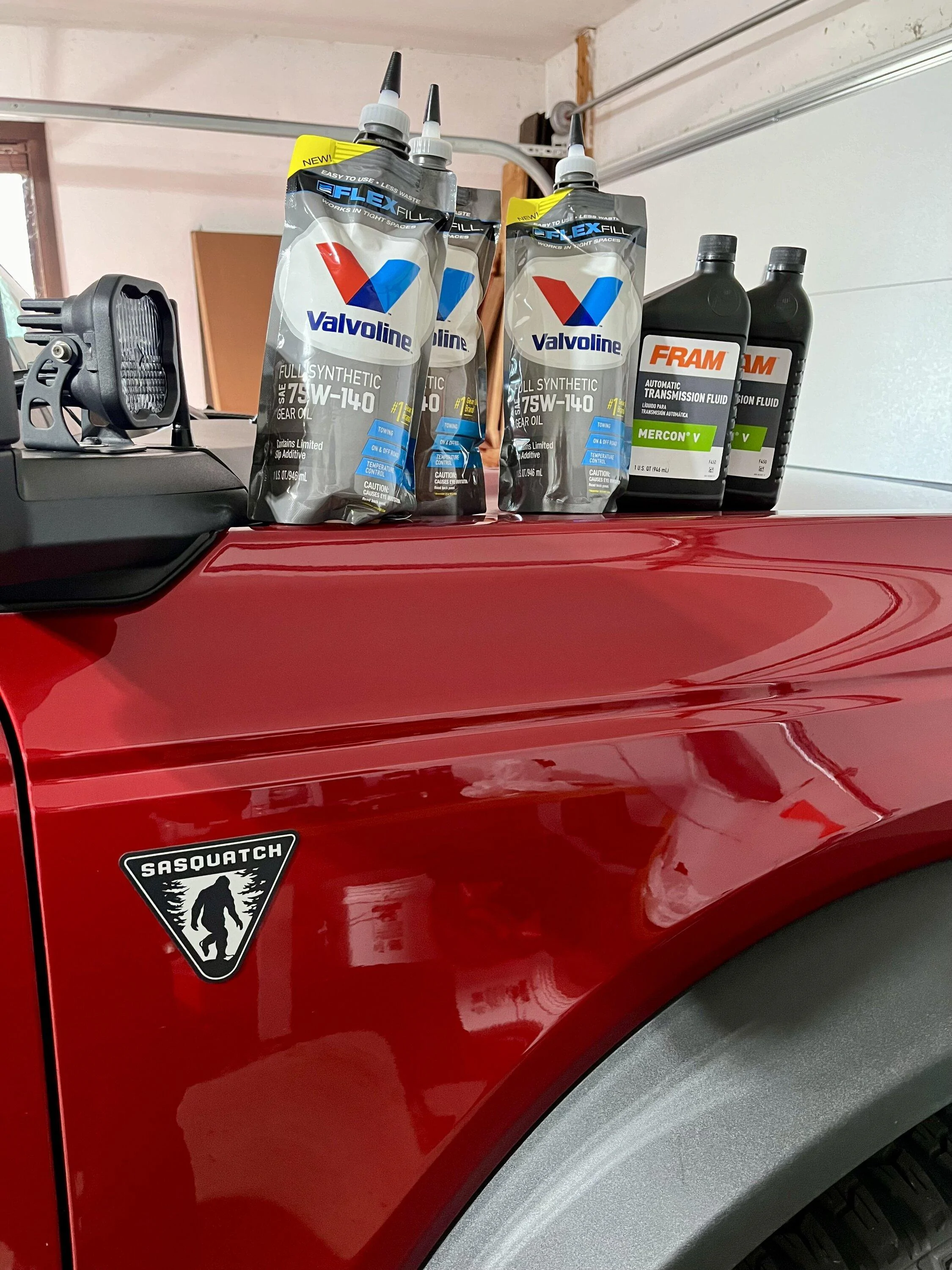

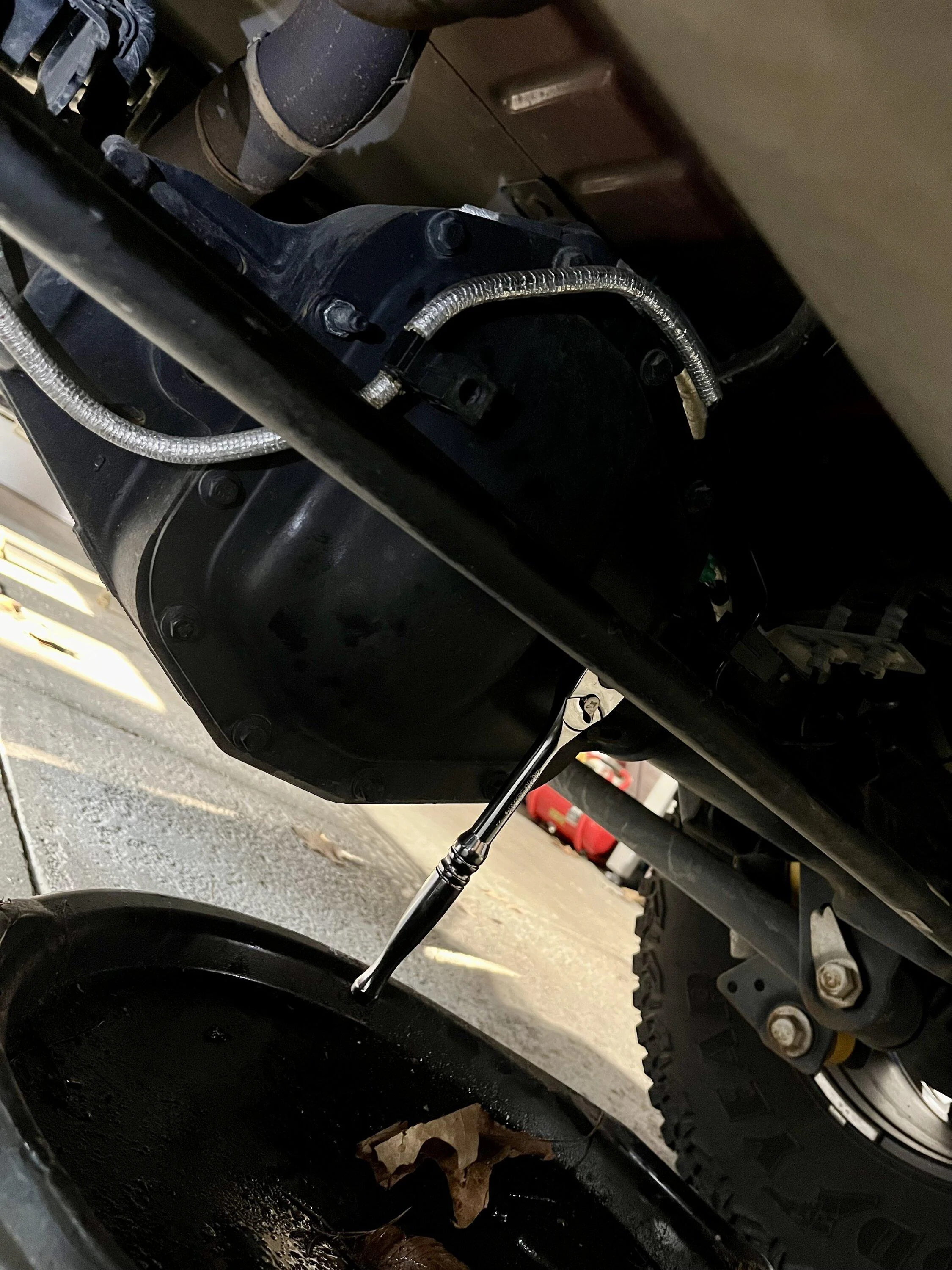

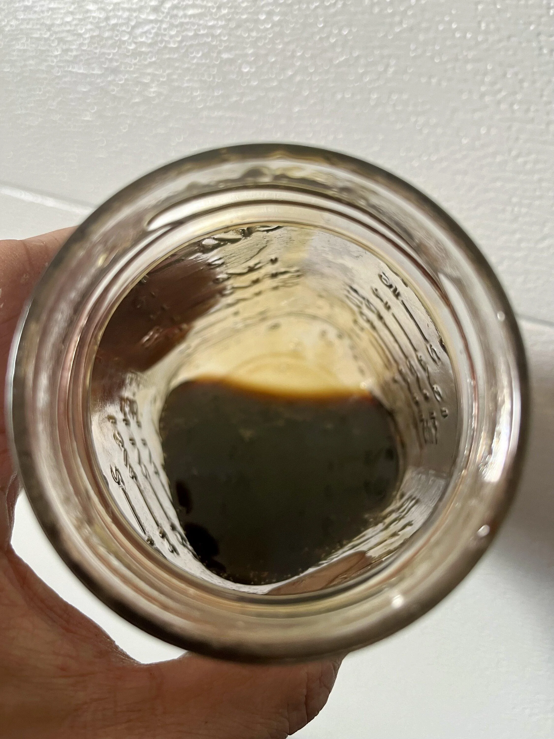

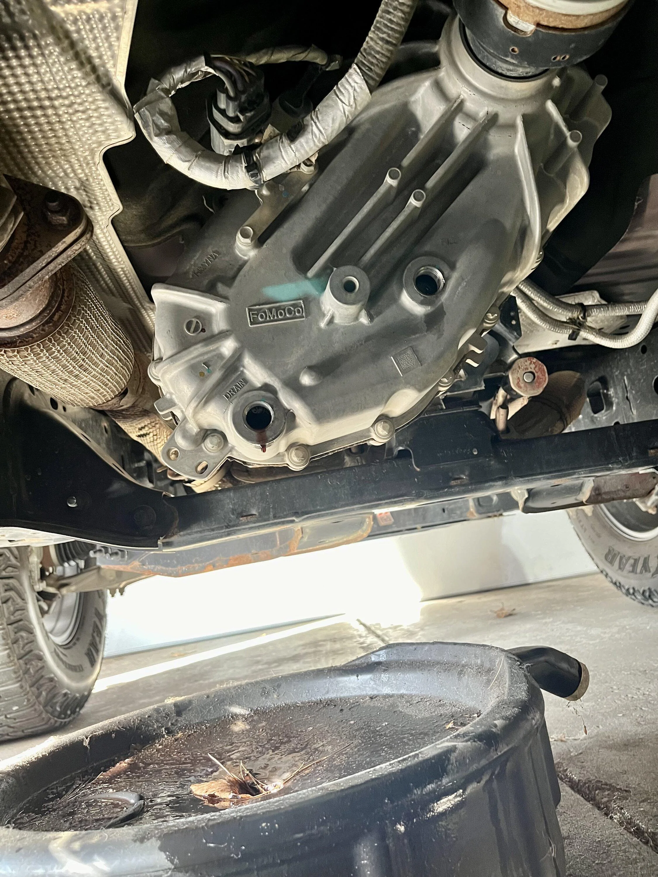

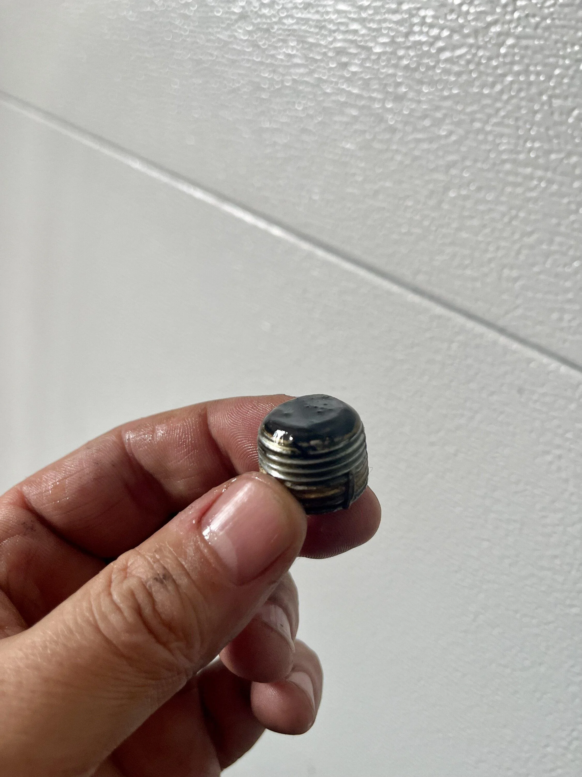

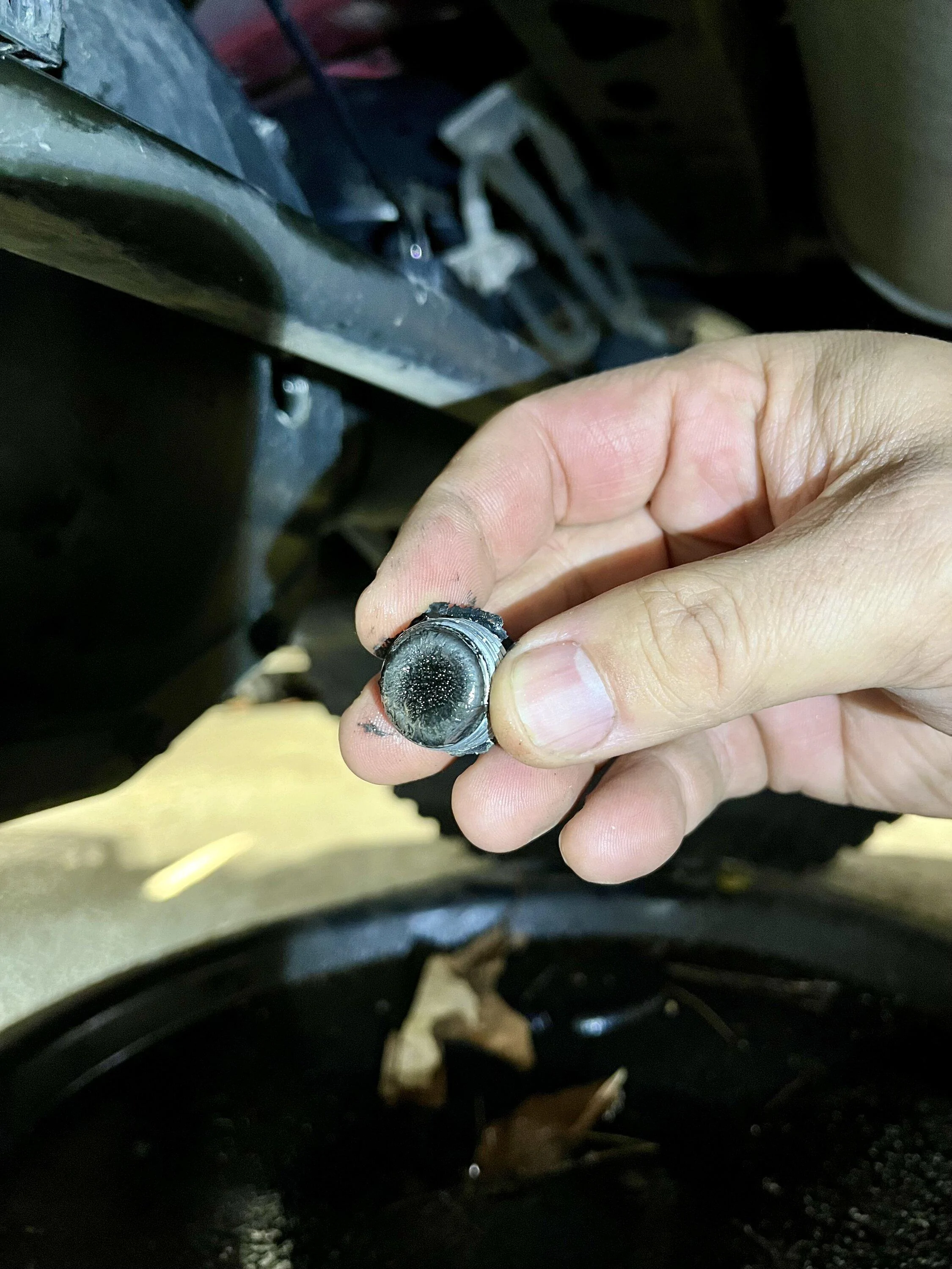

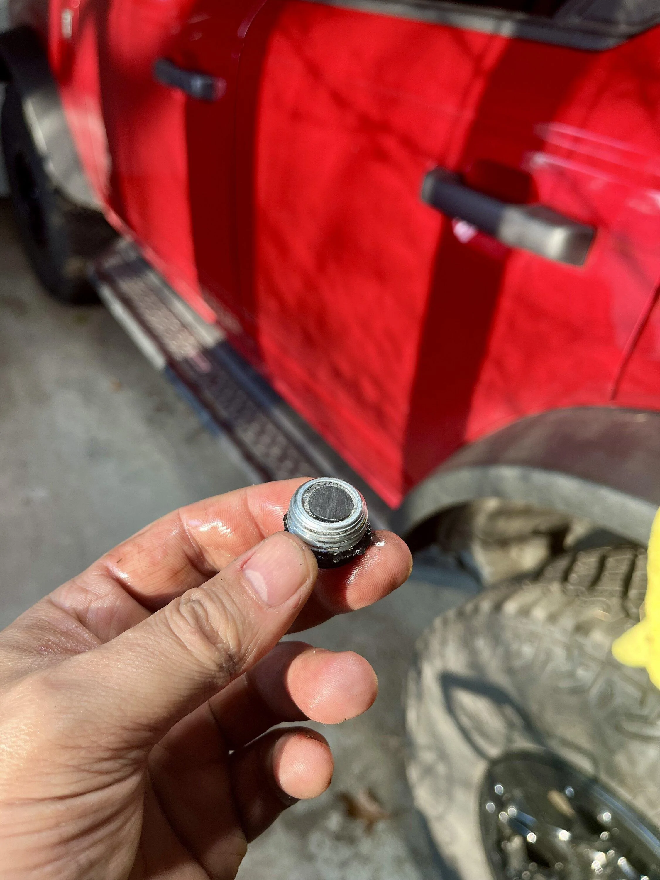

Well I should have done this 1.5yrs ago on Redrum. 2021 Basesquatch 2.7 Rapidred. 22,200 miles.
Thanks @CarbonSteel for the reminder 🤙🏽

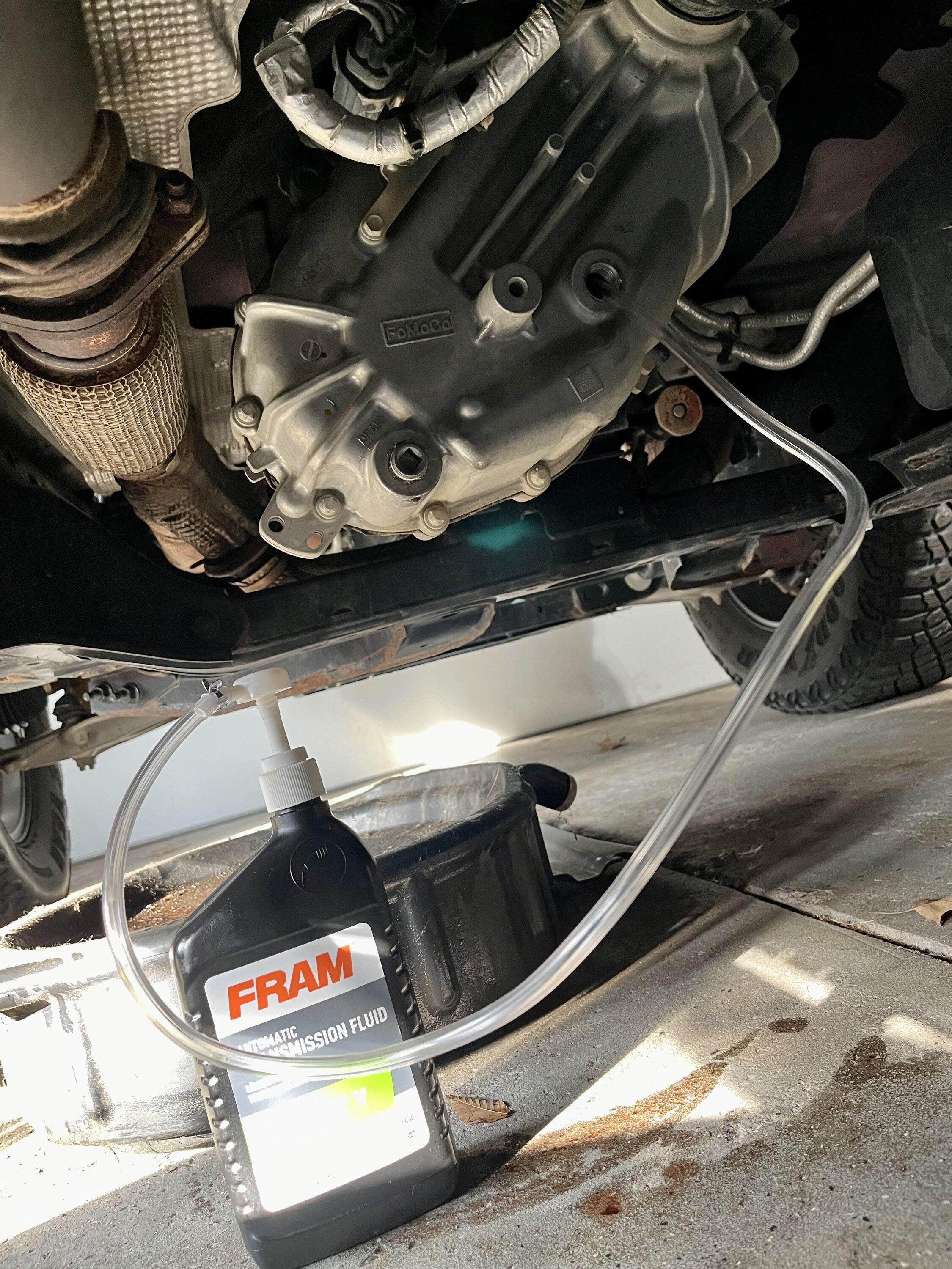

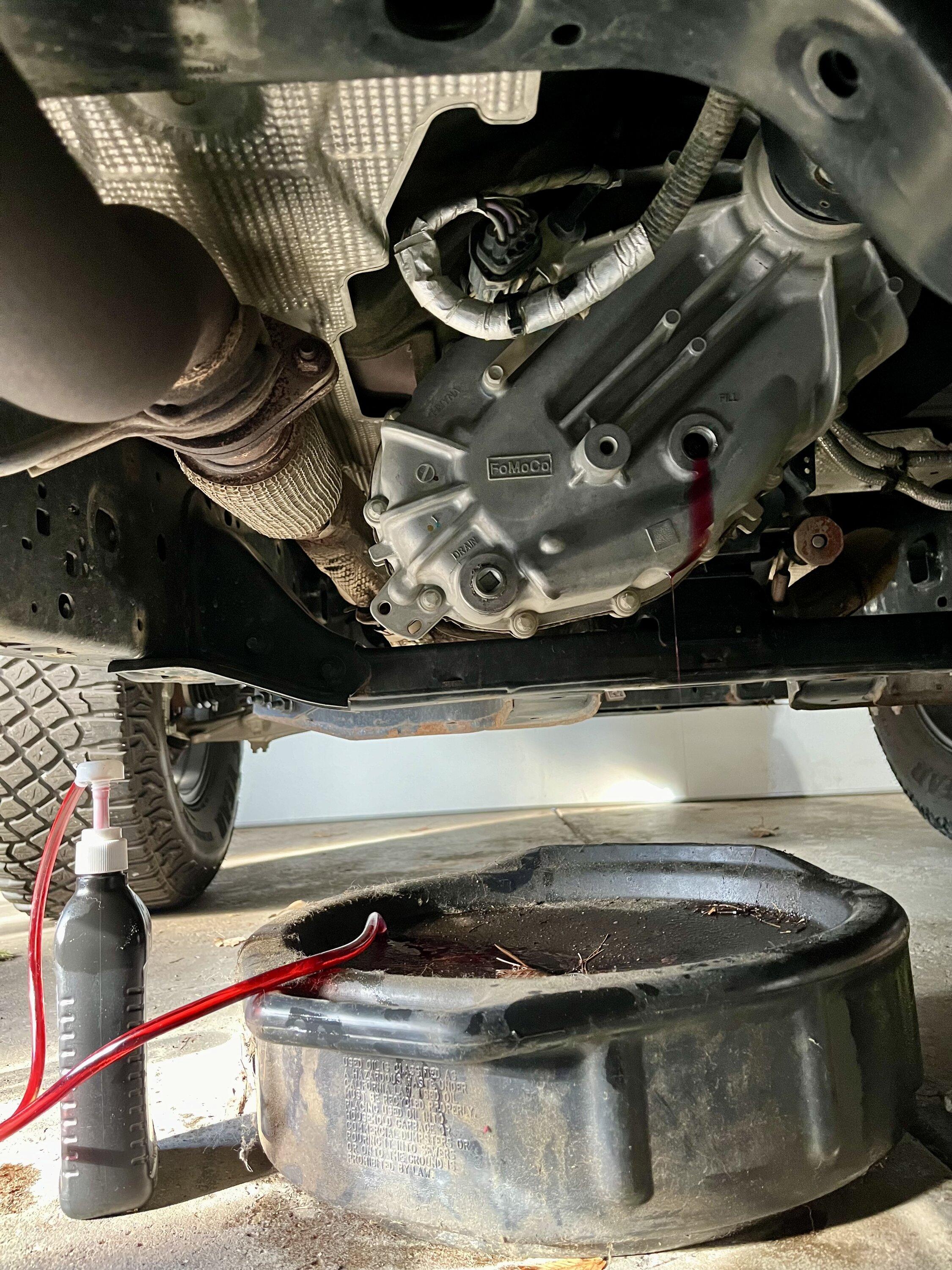

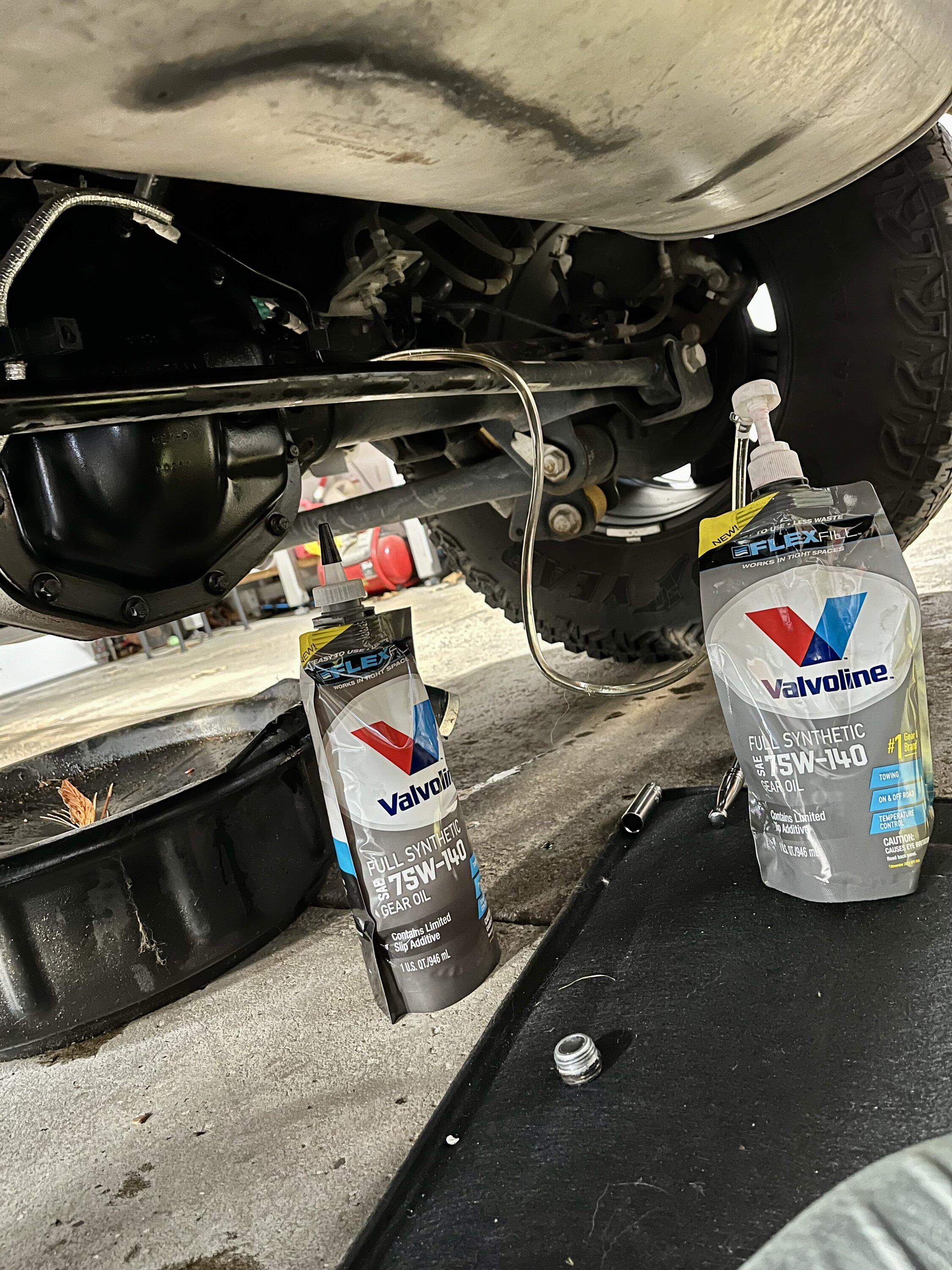

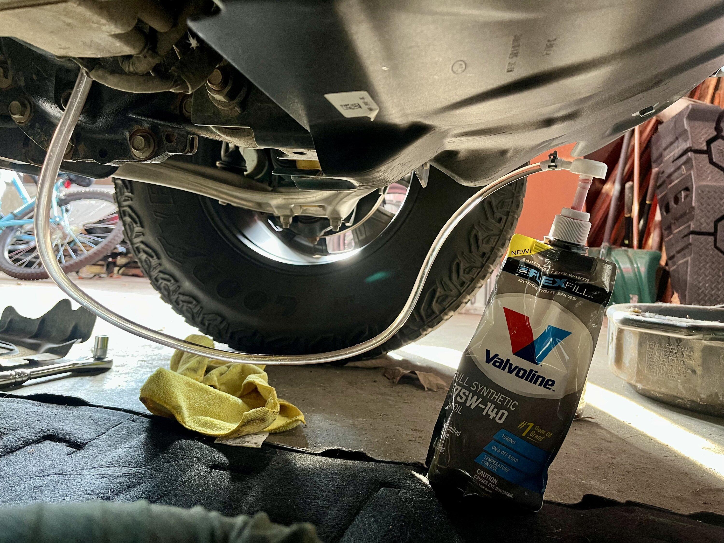

What is the little pump deal you're using and where did you obtain (looks like a liquid soap dispenser top)? I like that idea and your tube addition to it. Looks really handy and like it fit the container tops well.
How much off-roading have you done over the 22k miles? Thanks for sharing!
I’d say above average to a fair amount. ORV parks, Sand dunes, trails, couple heavy onroad winters too.
Performance Tool W1139 Quart/Gallon Fluid Pump and Hose for Vehicle Oils and Maintenance https://a.co/d/6LyGiKG

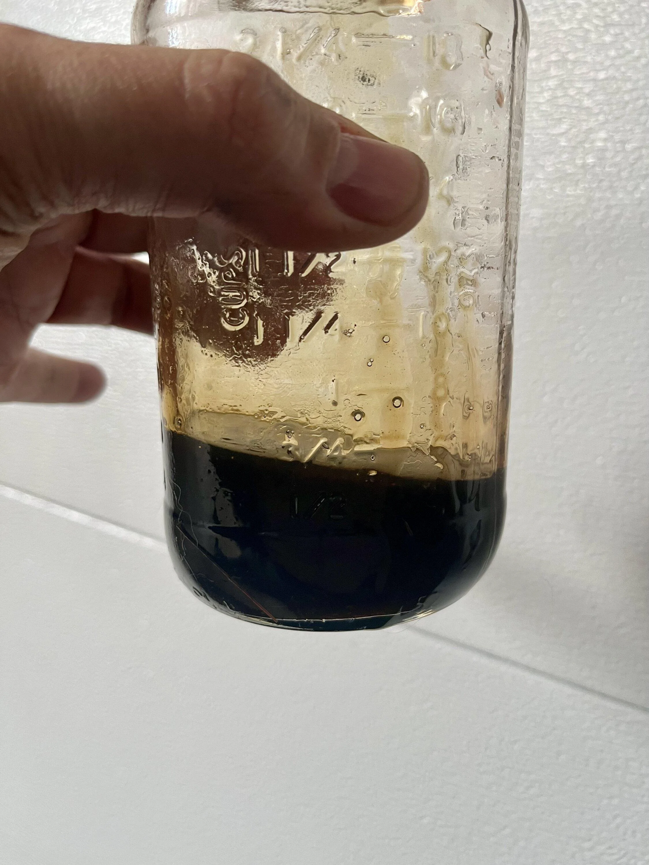

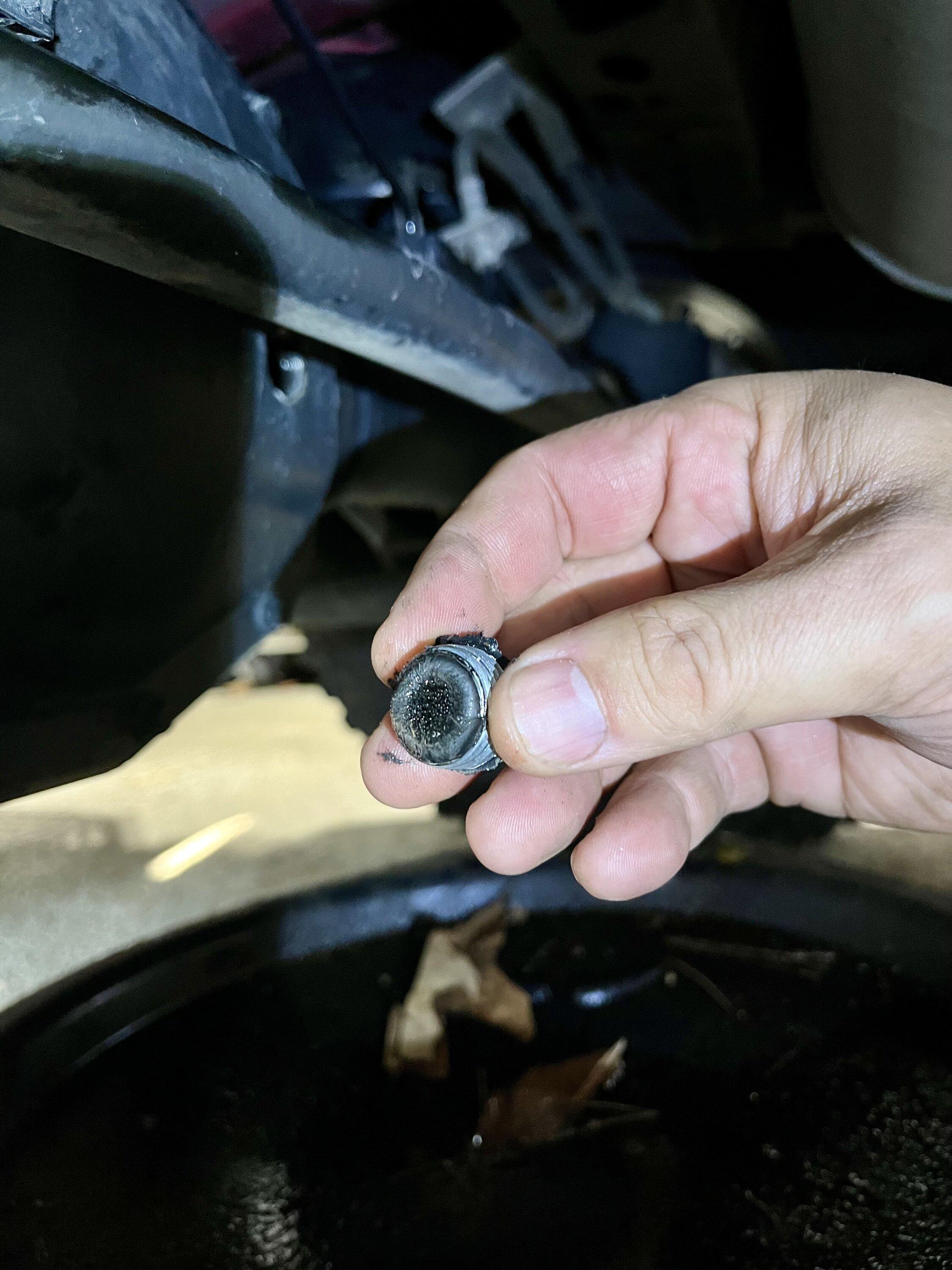

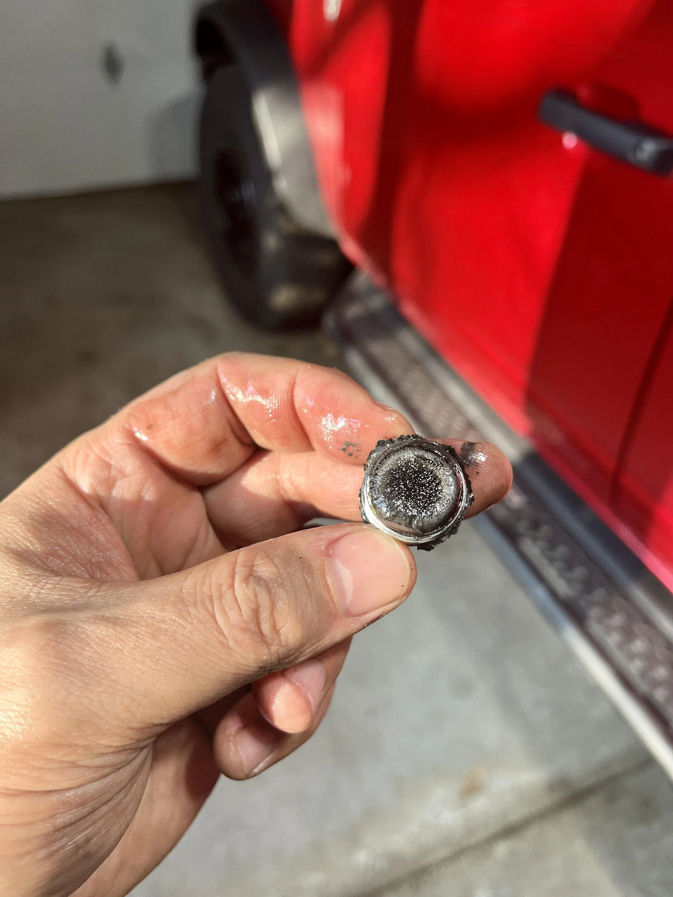

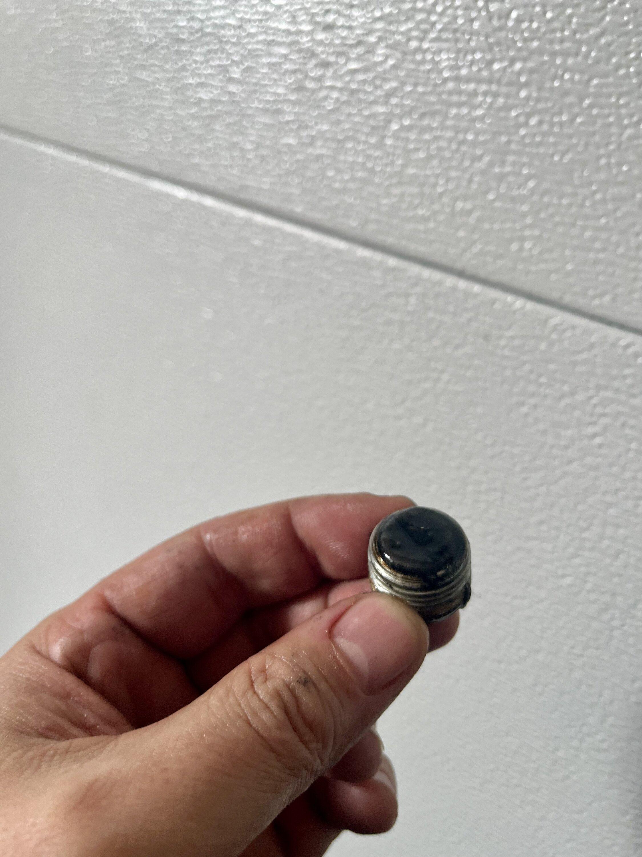

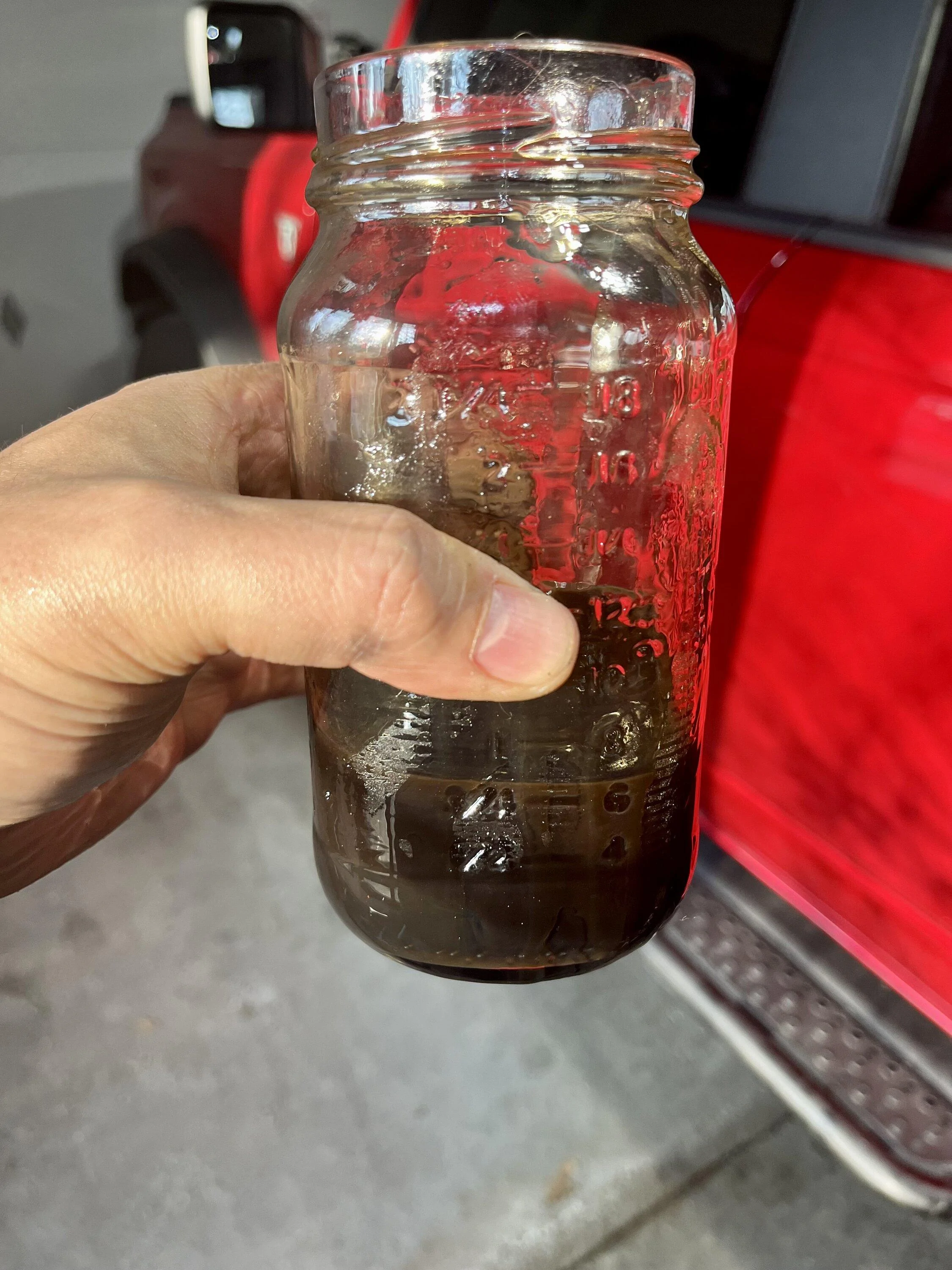

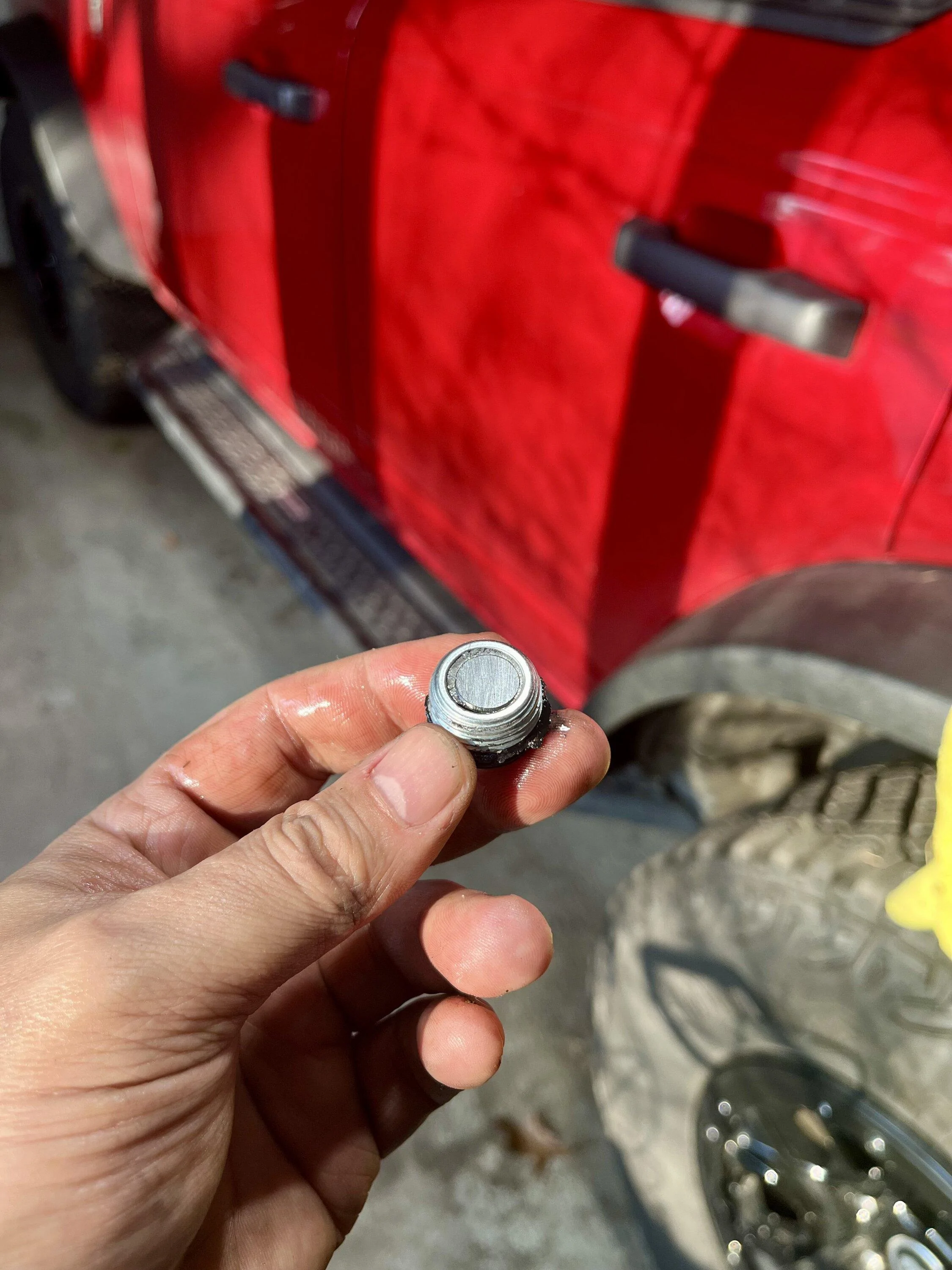

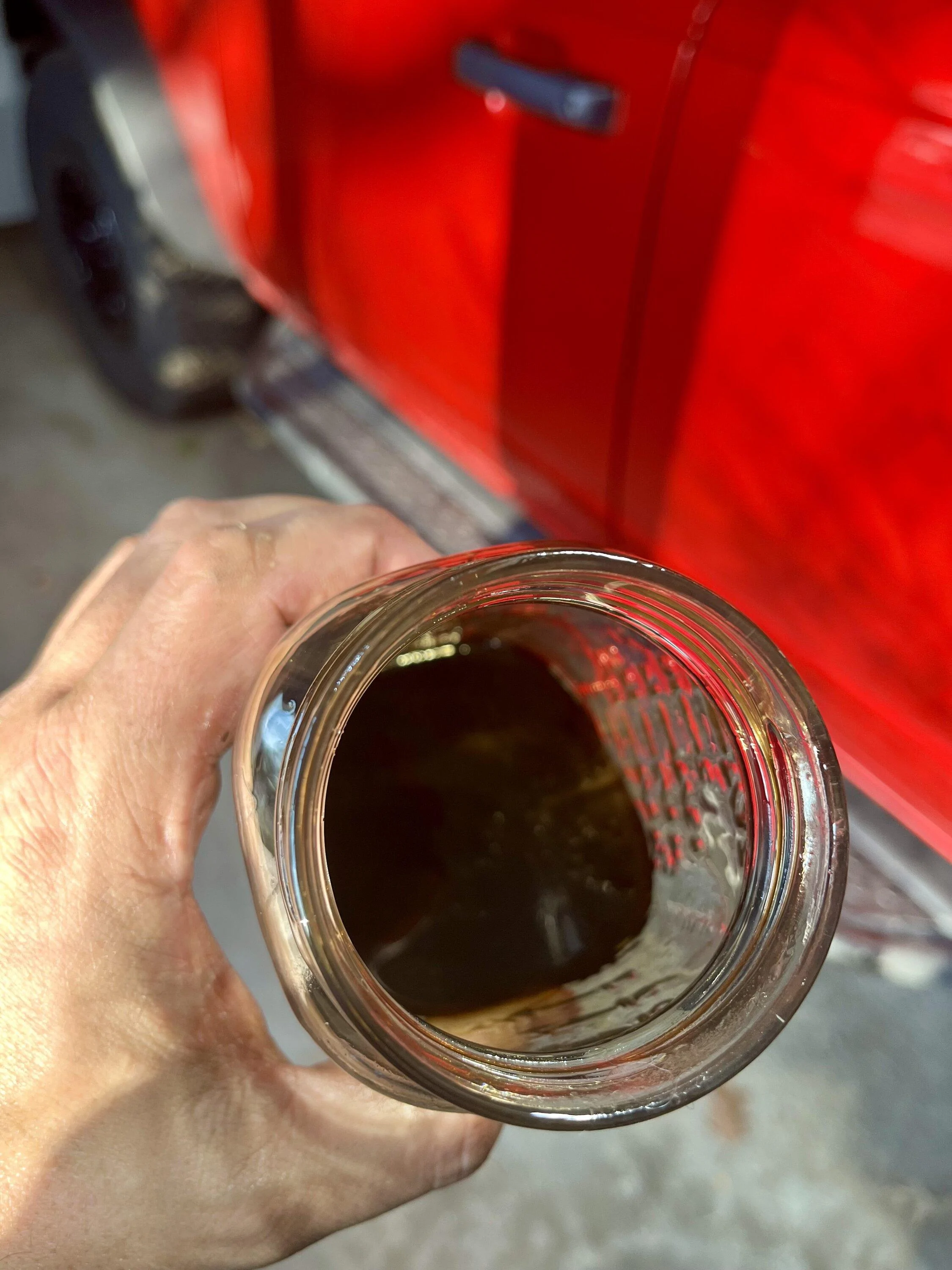

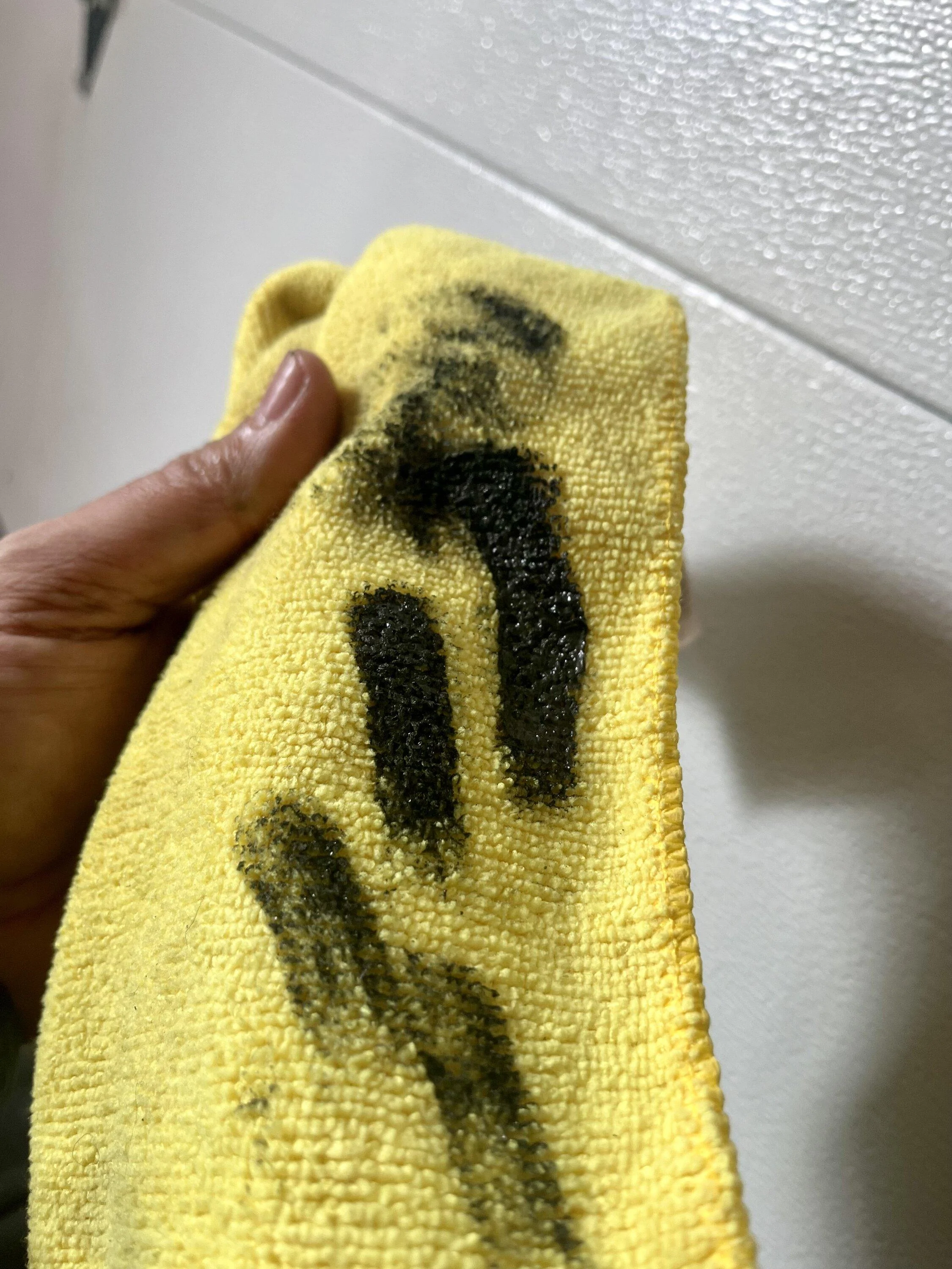

Nice pics and good dog! @BAUS67 Here's another dark fluid change like you were talking about in the other thread (I think with Snacktime?).
BAUS67
redneck
Jan 3, 2020
5,448
17,256
Central PA
This one is not quite as bad as the other one. I was going to post this in Snack's thread so @Felix808 could see it. This one here looks like many I've seen. 😁

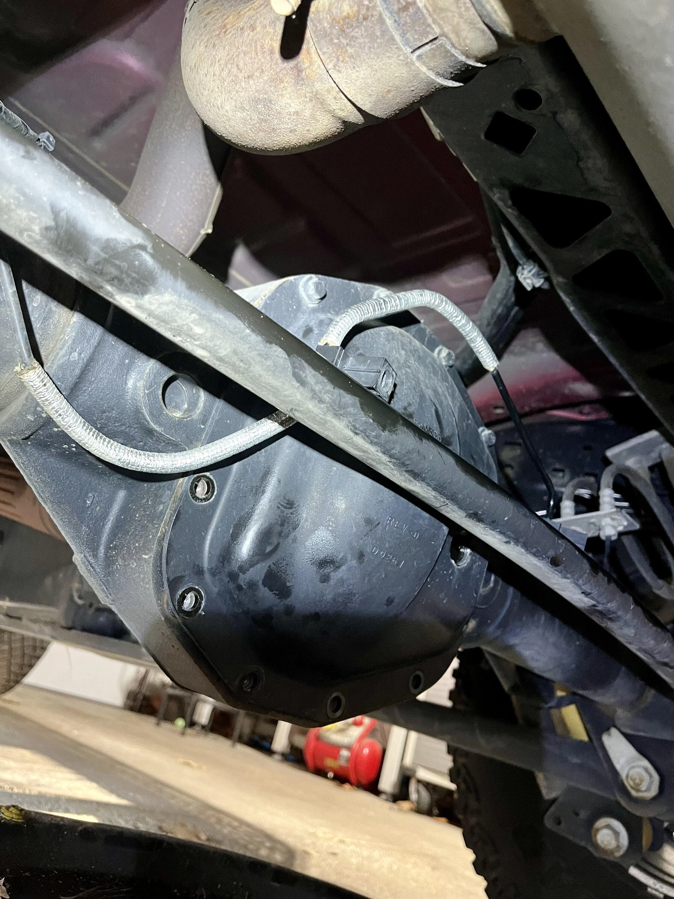

Is there a thread that explains all of this step by step for those that are following. I have a WT 2.7 with 12k. I'm usually lucky to keep a car to 20k, but this damn Bronco is a keeper and want to go the extra mile. I have never changed fluids in a transmission, or diff and would appreciate some details. I found the Valvoline and the pump, but not seeing the frame oil on amazon and only "Genuine Ford Fluid XT-10-QLVC MERCON-LV Automatic Transmission Fluid - 1 Quart"
Any directions/step by steps would be appreciated!

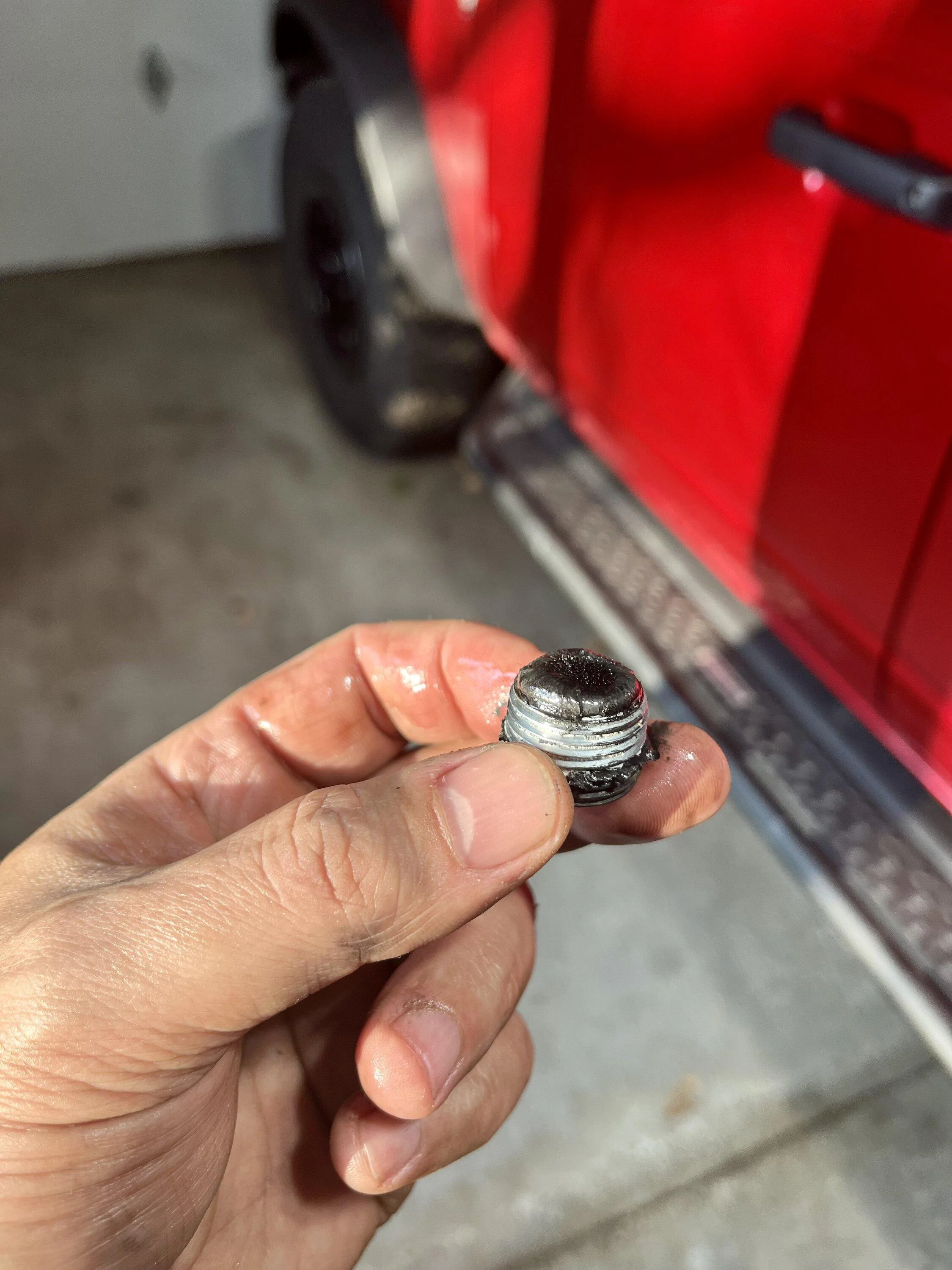

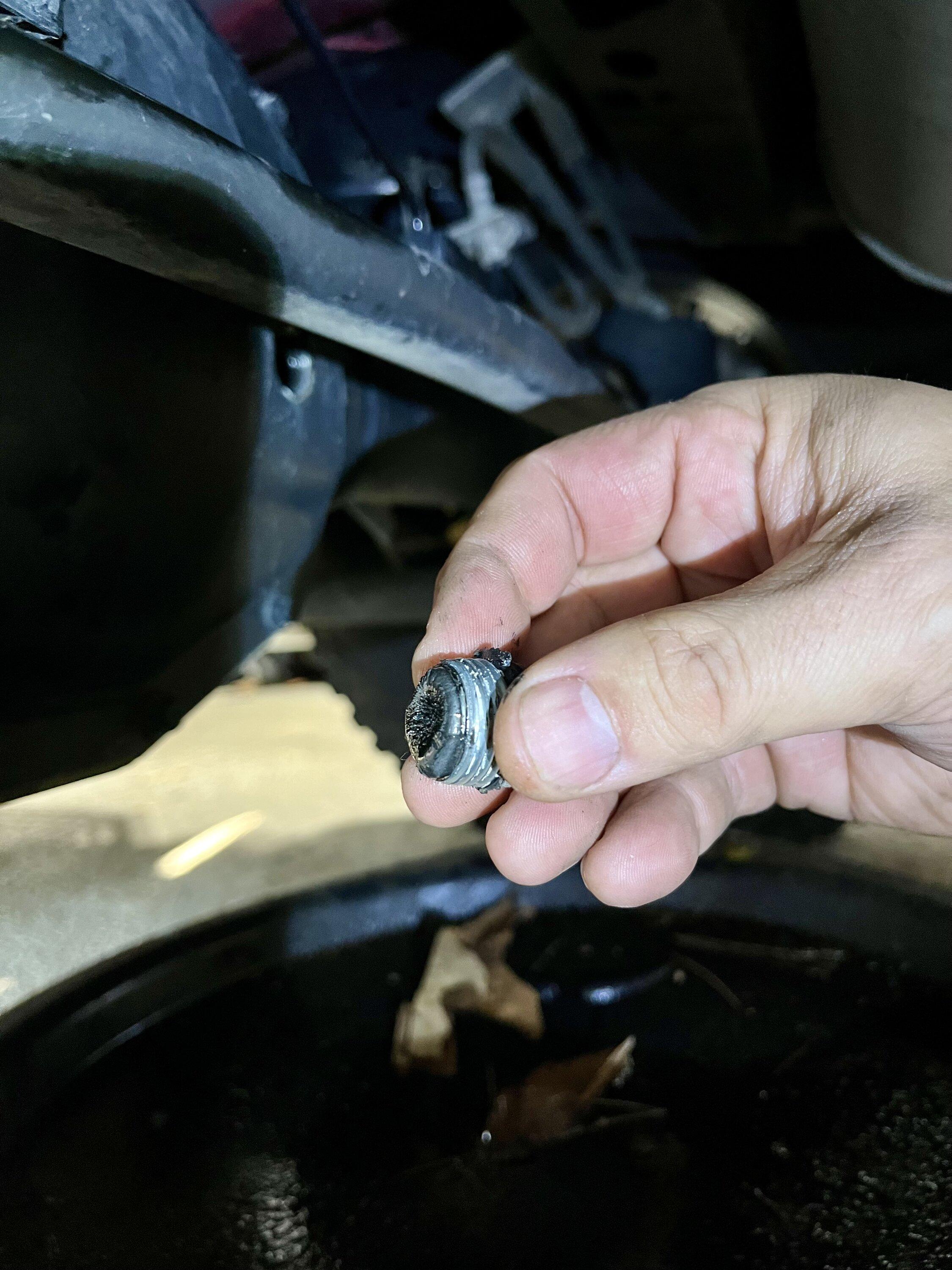

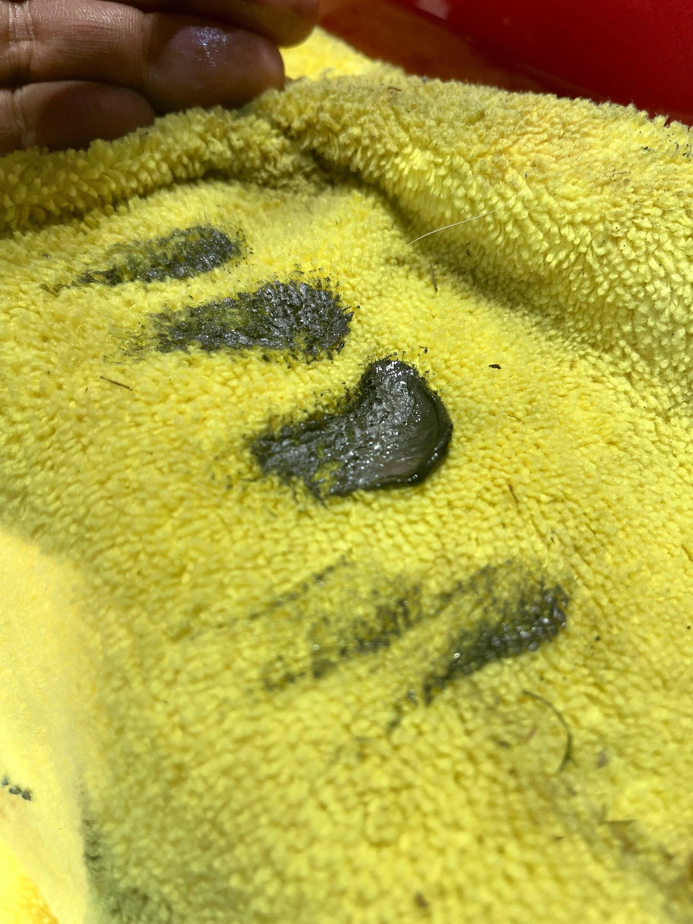

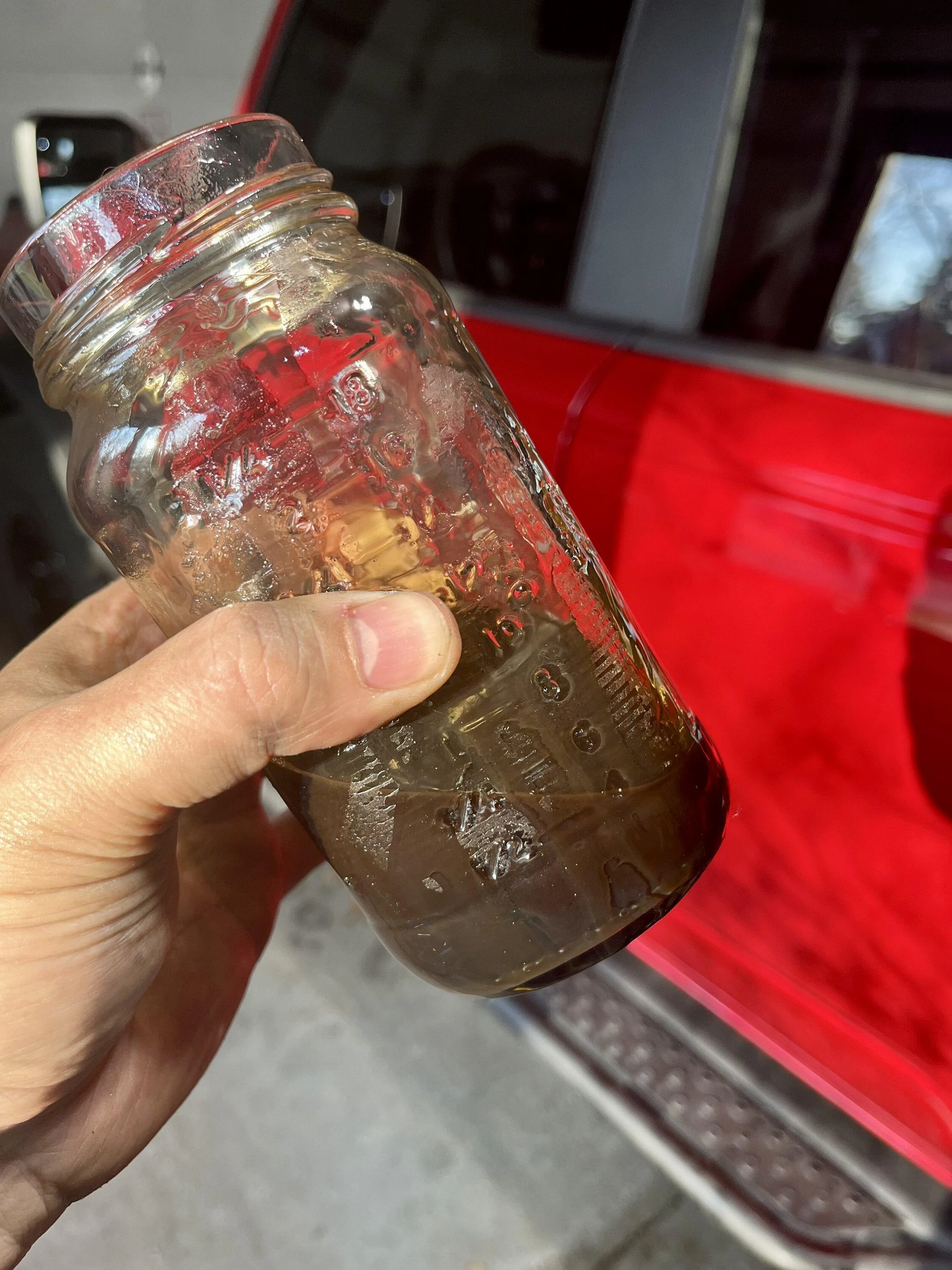

That oil coming out is low and dirty ((Needs addressed!!))
