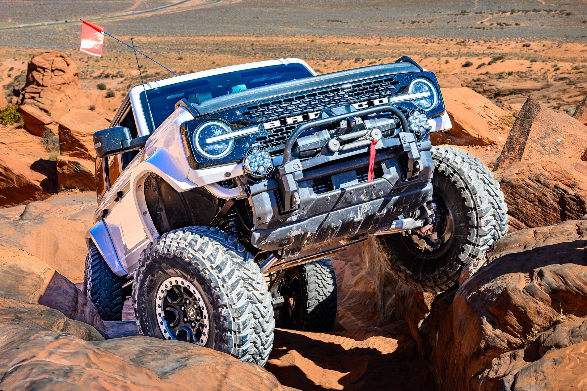

The owner of that bronco was in my group! Seen it in person and it’s crazy clean. Unfortunately it’s never seen dirt:(
Man, that feels a little sacrilegious. 🙁
I’m glad someone has seen it. I was scheming all sorts of ways to try to justify going to Cali for bumpers, lol. They look so good and the guy doing the fab seems like it’s his passion, not just a job and pays attention to the details. Love to see that craftsmanship!

The owner designed it and Stellar built it. The owner has some super sick builds. I think he sold this one or at least tried to

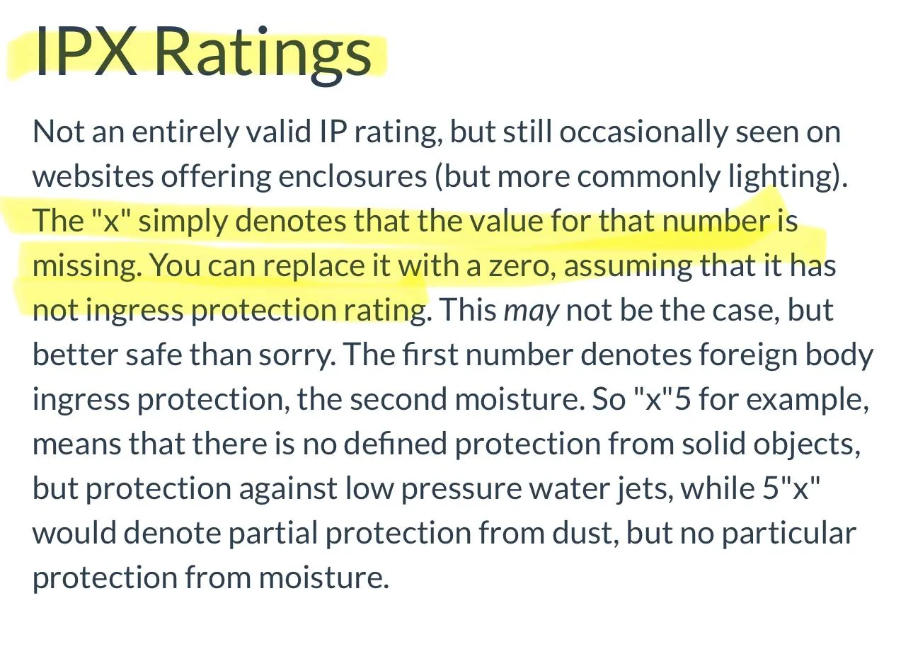

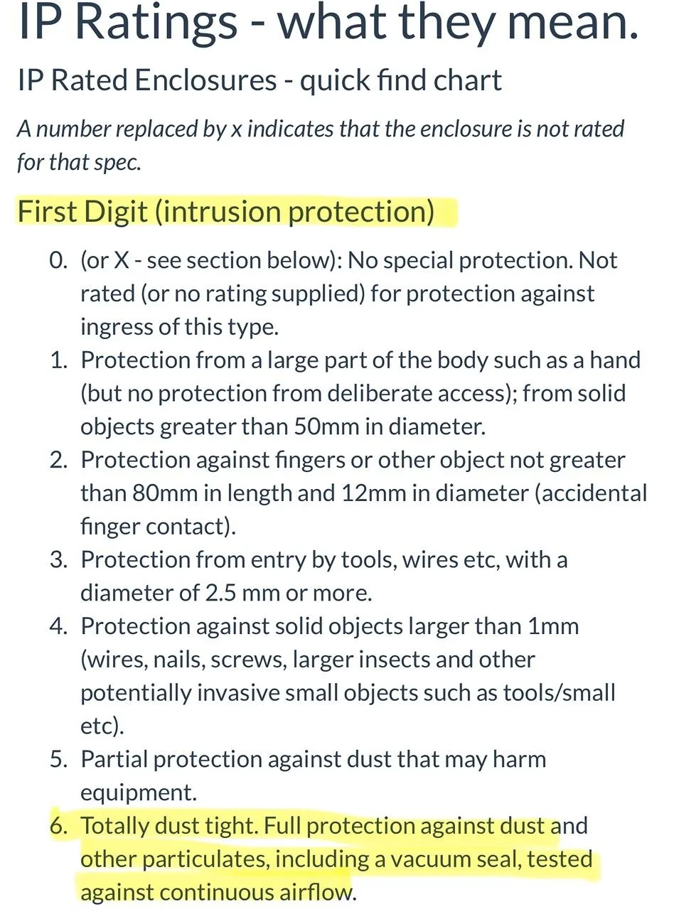

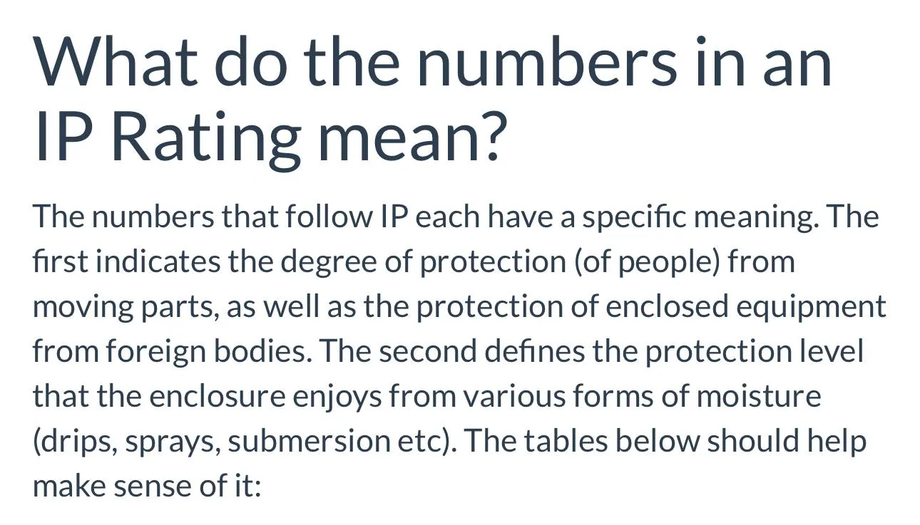

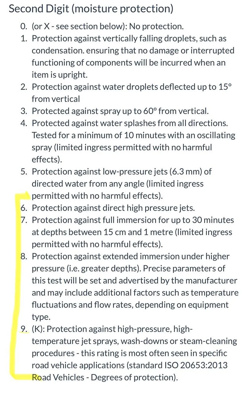

When I was researching, I was also looking pretty closely at IP waterproof ratings (since I park outside year-round and many winching scenarios around here would involve deeper-than-expected water) and construction of the housing (more metal, less plastic). The lighted drum and controller were nice perks as well.
When shopping I also liked the lighting on the Superwinch winch and controller. Thought it would be a handy feature. When I added the RC winch yesterday for someone else I noticed it had a load indicator so it cycled through green, yellow and red to give a visual cue. Not sure if just gimmicky or useful but I also thought it could be handy for quick reference.
Also you raise a good point about Ingress Protection (IP) ratings. Most I’ve seen live between IP66 to IP69. Here’s some data on how to decipher their meaning
https://www.enclosurecompany.com/ip-ratings-explained.php

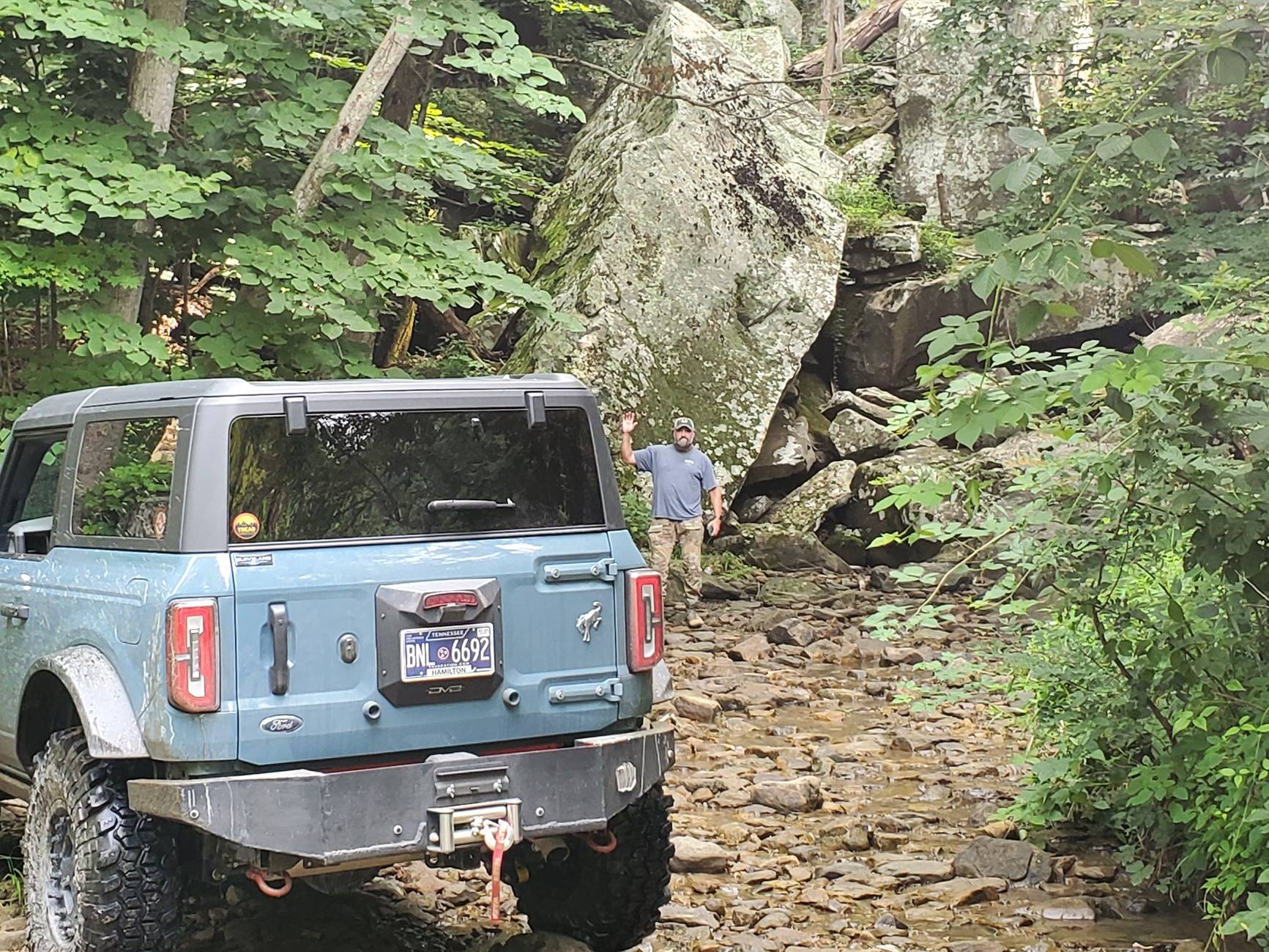

Here is mine, no polish just plate steel.
Ford Bronco 12k Winch Comparison: Pull Strength, Pull Speed, Power Amp Draw 20240727_111755
I normally carry a shovel and axe on the attach point but wasn't this day.
Mine has a 3" bodyift.

Sweet. Any pics behind the bumper or without it mounted? Curious to see your cradle and subframe mods.

It's on my build page.
