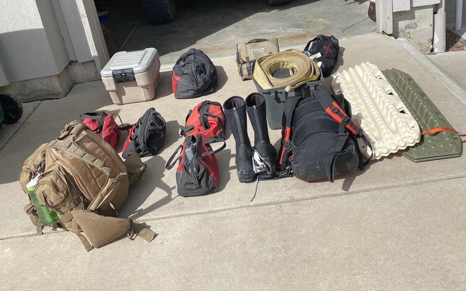

Here is all my light-duty recovery gear. Most is around 30K pound working strength, but varies. I have another 125 pound bag with all the 50K pound gear.
you don’t have to have all this stuff, and I typically vary my gear load depending upon who else is wheeling with me and what gear they have. I will make a separate post and open this stuff all up and explain what and why I carry it. But my answer to your post is you or your group should carry gear designed to get you out of the terrain you are traveling in. Going to the store? Make sure your spare has air and the factory jack is still in the vehicle. Going to Moab? Some steel cable for going over rocks should be in your bag and I guarantee you a handyman isn’t going to be your best option when you are hung up sideways on a nasty hill! I am pretty sure all my recovery gear easily exceeds the cost of my Samurai, even with mods!

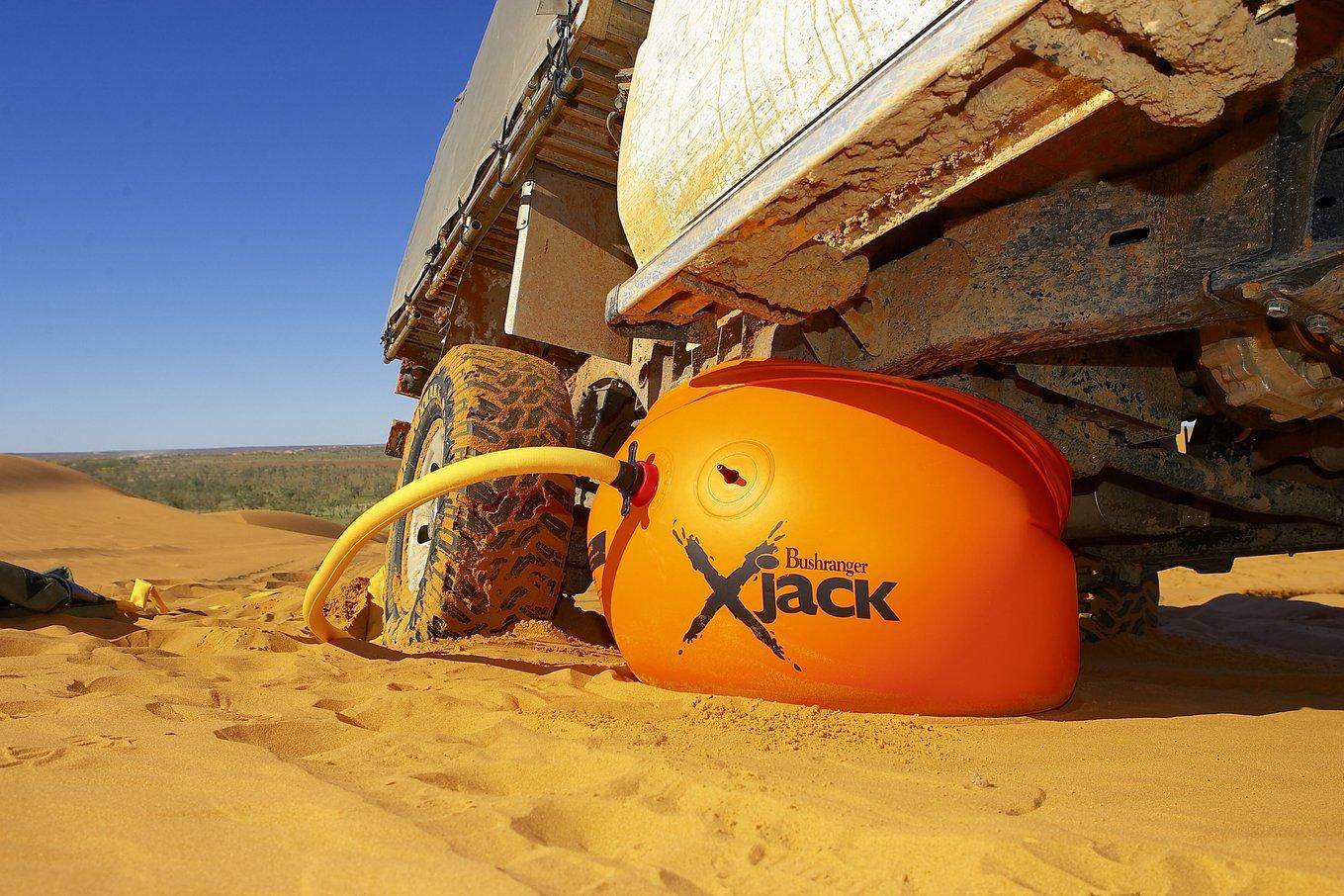

what do you guys think of the ARB Bushranger?

Got one of those for my son in law for their camper , sometimes it's hard to find a good spot to lift from on the side of a road
He hasn't tried it but man that thing is heavy

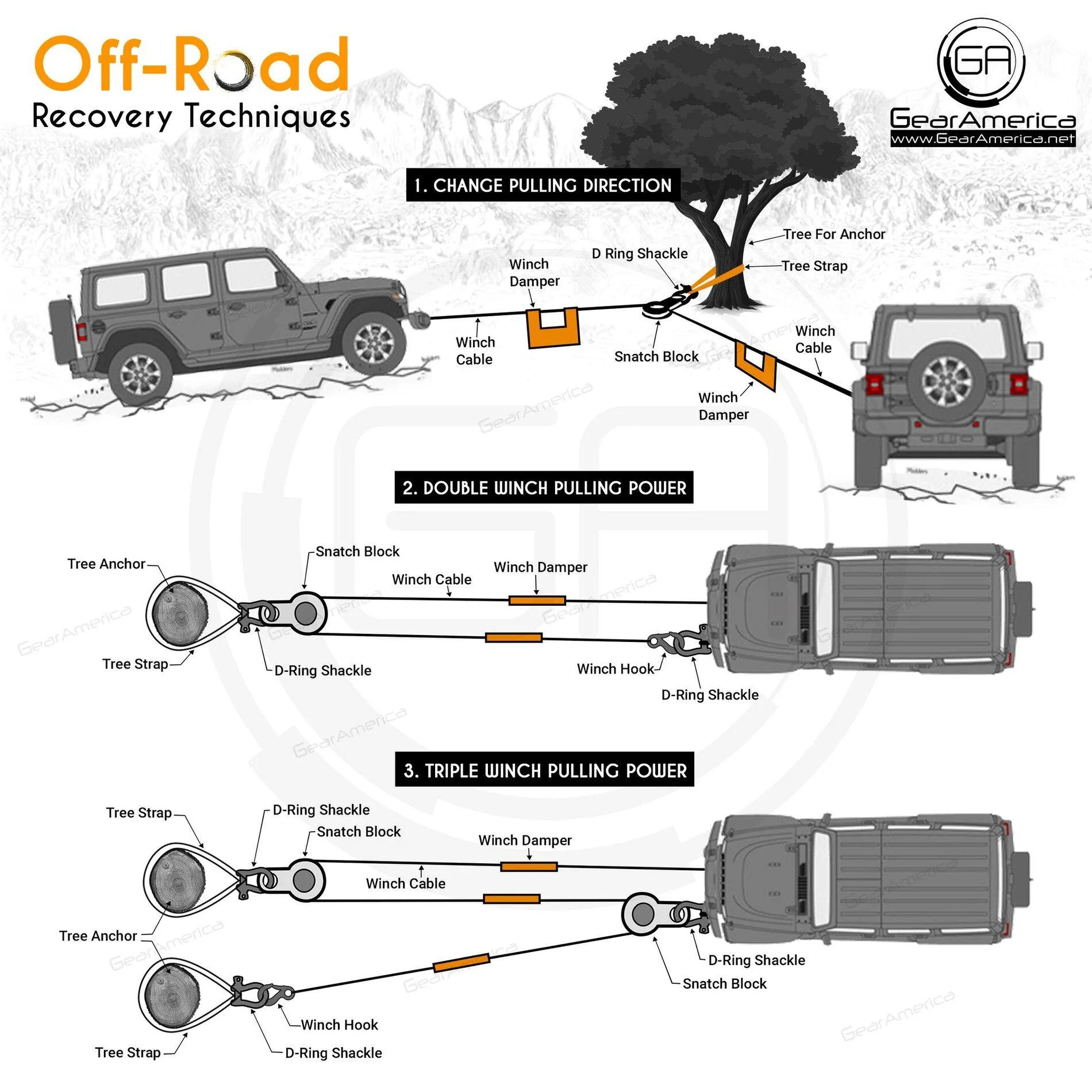

Here is an example of using a 12K winch to apply nearly 36K of pulling force on a stuck rig.
Thank you for the diagram @The Bronze, it is great to have those experienced in offroad recovery on the forum helping those of use new to to offroad. Before you posted I had gone off on a Google search trying to learn like @Headsong asked about. We need more of these kinds of how-to's to help fill in the long wait ahead. Here are a few links I found helpful.

OK, walking the dog and trying to work this physics magic in my mind.
Why can't you just stick a decent block and tackle in, rather than running to different points and pulleys? So you have a solid point, string to your Power Puller, string that to a block and tackle, and to the truck? You could get away with a smaller PP....if you've got maybe 4:1 or 6:1 b/t?
I don't see why it needs to be complicated with lines running all over the place. But I'm a sailor and we hang deer, so my uses have been different!

4:1 Mainsheet, ex-sailor here, but the experienced offroaders can help us learn the differences for winching, here are a few helpful links.

And so that makes my point exactly. If instead of using the snatch block on the tree (when he's pulling the Fiat out), you put a 4 or 6 pulley block and tackle there....you don't need heavy equipment...
