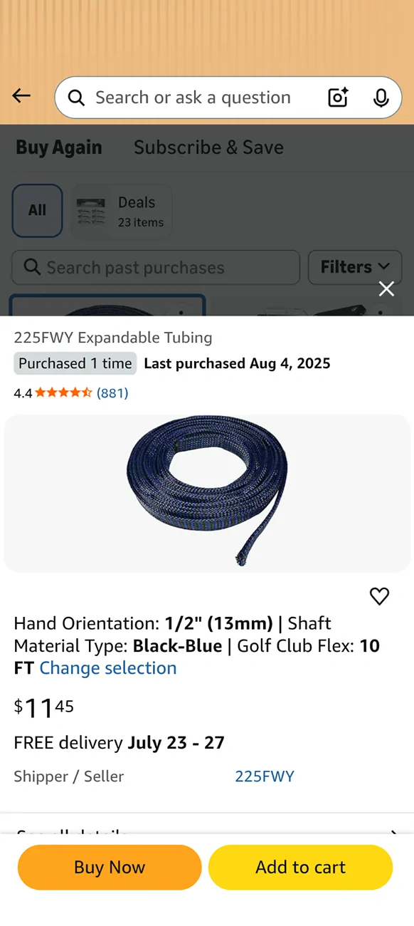

This is what I got off Amazon for my winch power cables. Comes in a variety of colors
Ford Bronco Winch power wire covers Screenshot_20260719-200404
