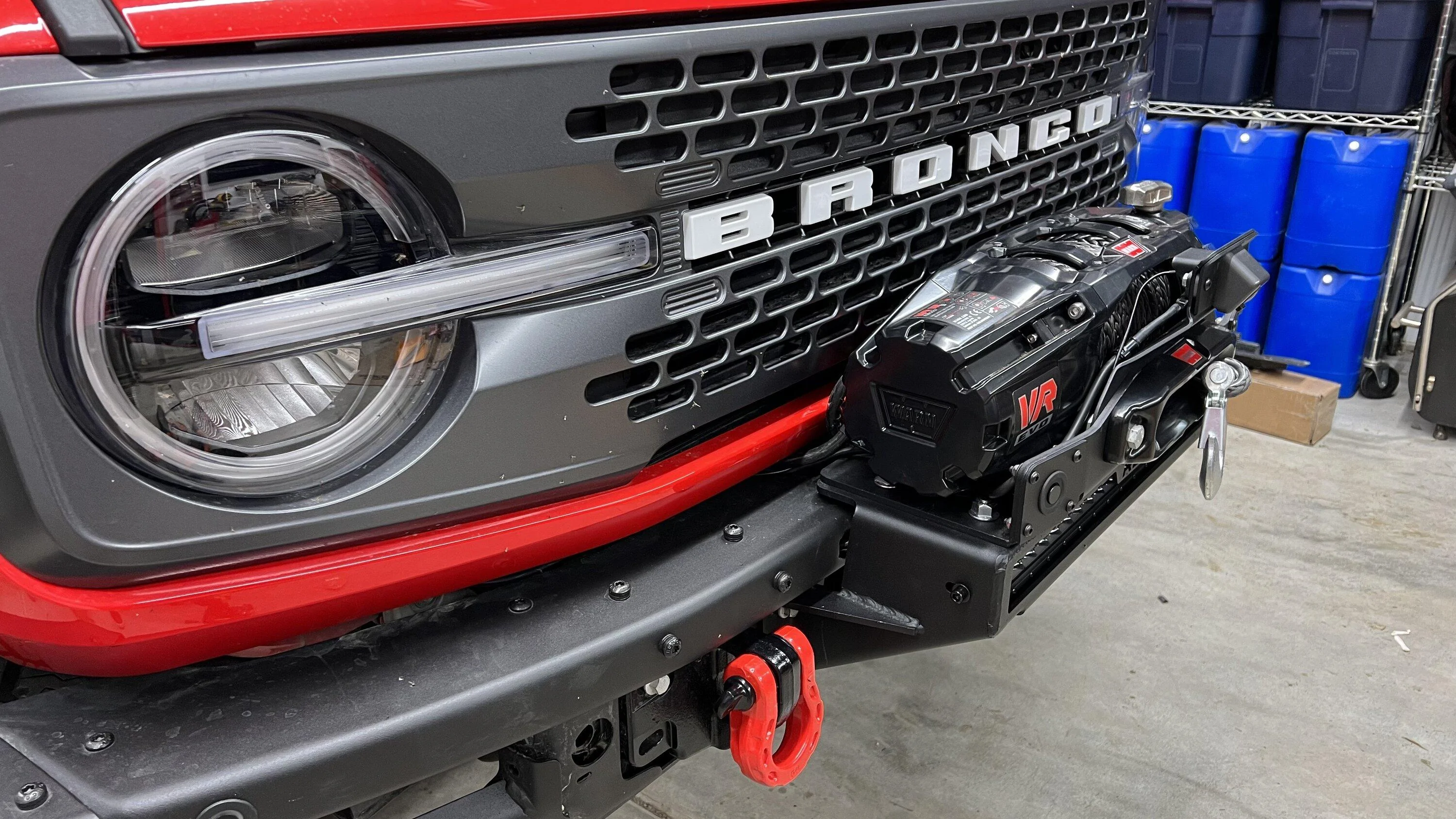

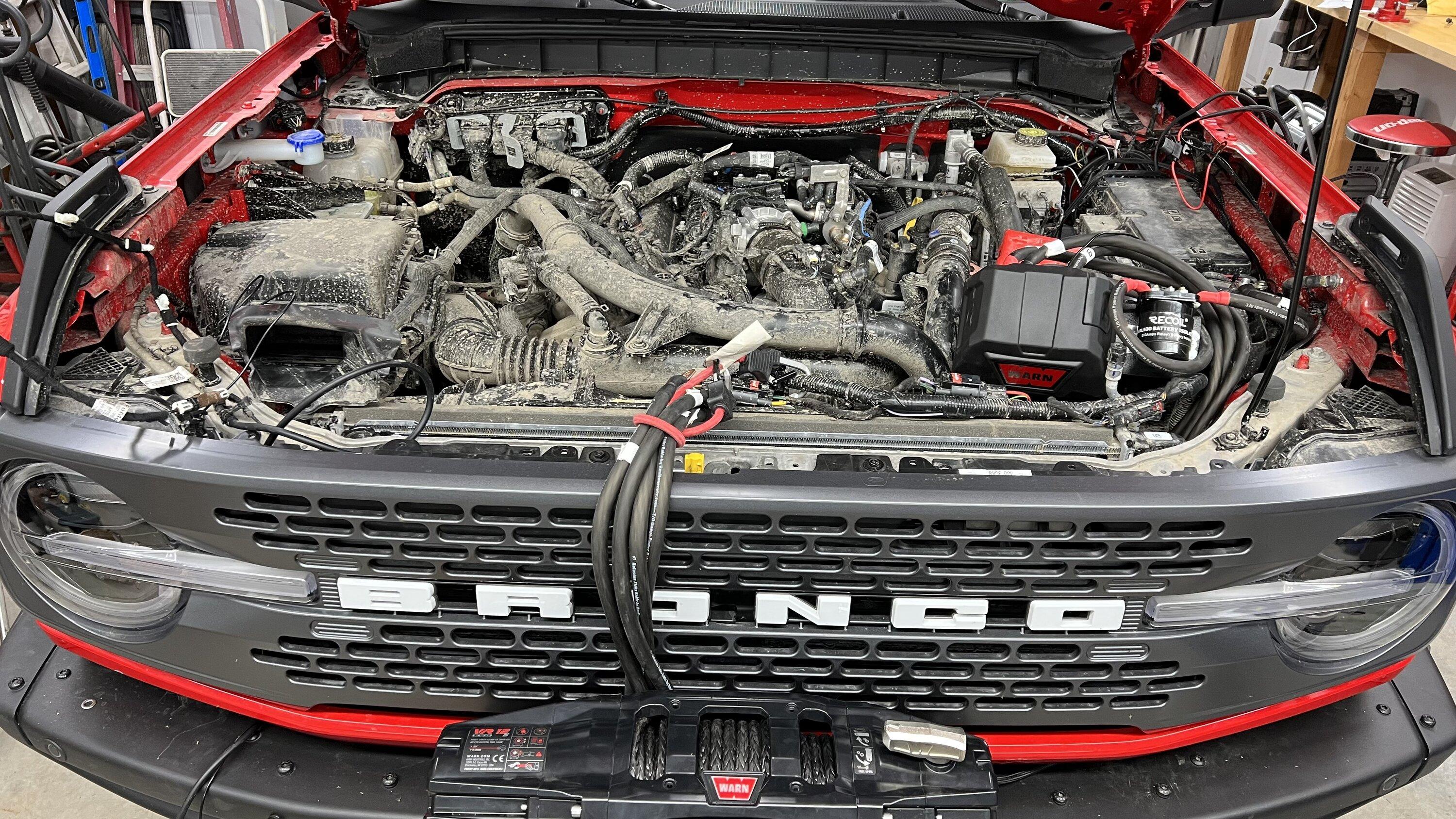

All the wires that come with winches are undersized. Do they work, yes. Will the wires heat up and smoke, yes. We haven't caught anything on fire over the years so that's a plus.
Your math is correct, you need monster wires that no one uses. I didn't want to worry about letting my wires cool down on a long pull so I opted for 1/0 and kept the wires short as possible, 5' max, may have cheated a little longer. Left a little extra in case I switch bumpers.
Ford Bronco Winch wire gauge clarification 1662564180769
I have washed the engine bay since then, it's probably just as bad again after last weekend. 😁
