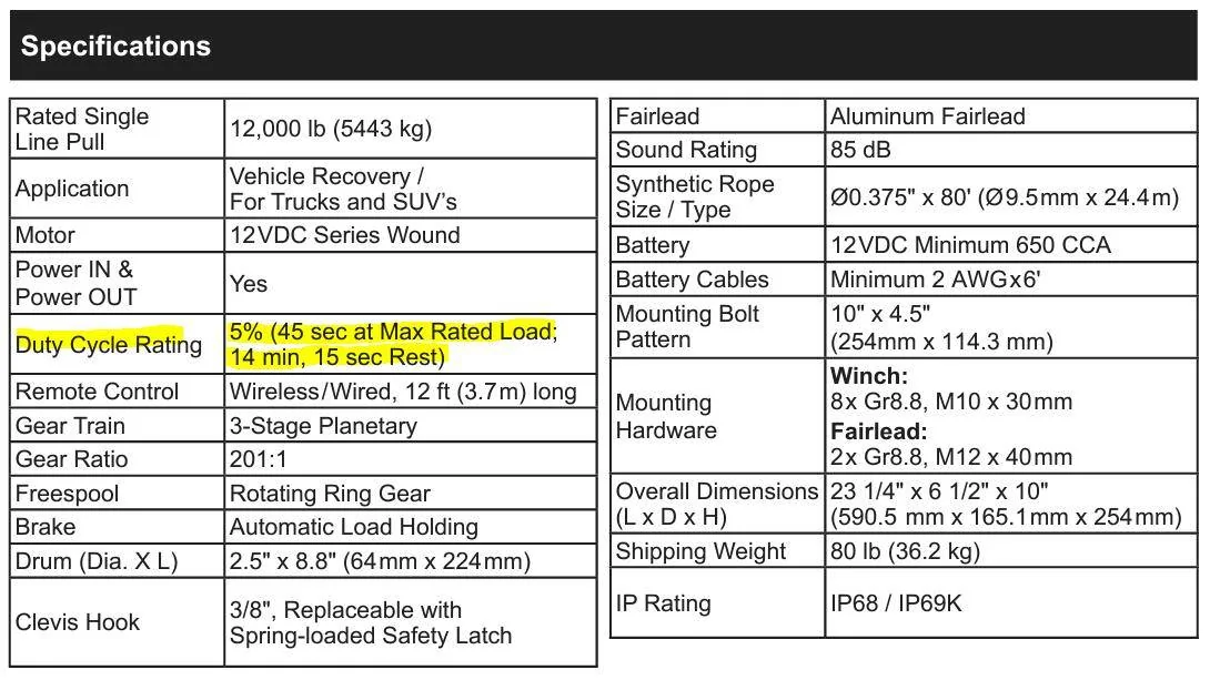

Are these test results or claims? Electric winch claims are complete bullshit, throw them out. If you try to actually pull their rated numbers they're going to fail.
I did not perform my own independent testing, nor do I plan to do so.
The charts are compiled based on manufacturer data. That is why you will see some variances with results at 3,000# but not 4,000# for some brands and others may show 4,000# but not 3,000#. They all report a little differently.
I agree there is opportunity for them to fudge information but I would like to think they are publishing data based on actual test results they performed and not just whimsical grasps into thin air. Granted, they probably publish the *best* of the results where I would prefer to see a weighted average after throwing out abnormal high & low outliers.
But quite honestly, if you burn up your winch and can prove their data is bunk, they will probably claim you subjected it to an abnormal duty cycle. The bitch of that statement is no one really publishes duty cycles. Well kind of...HF Apex Badlands has some duty cycle information in their manual.

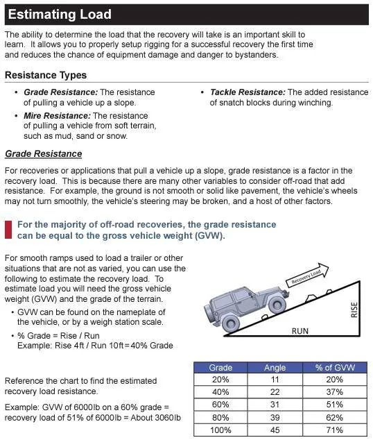

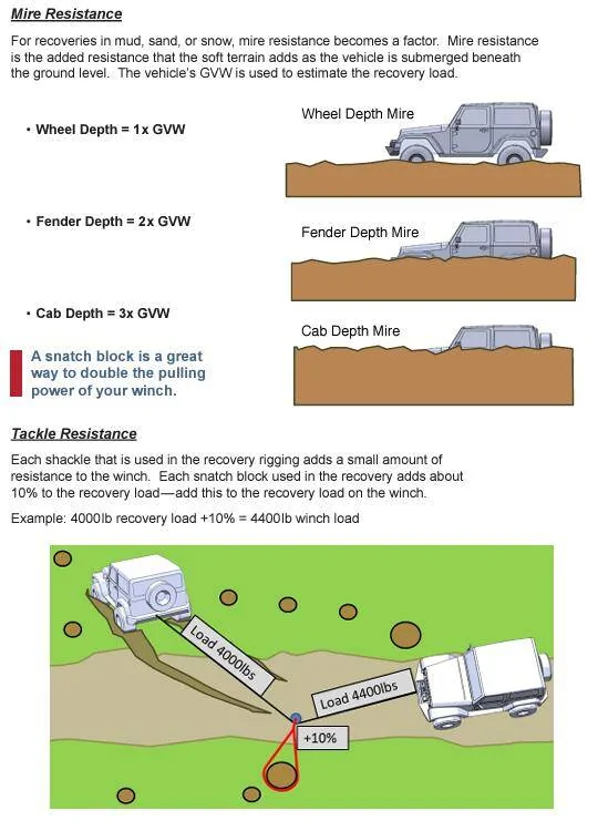

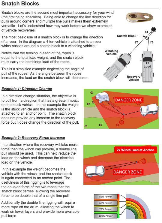

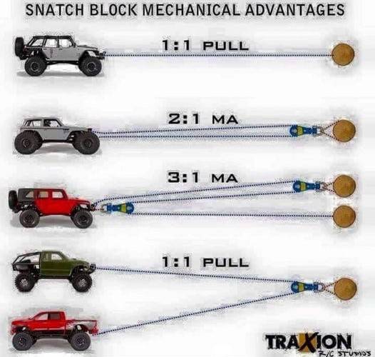

The good news is that you don't actually need to pull 12k lbs with vehicles this size, unless something is mired up over the hood in mud.
I guarantee you, 100%, that if you take any of those winches and connect them to a load cell to an anchor point, they will smoke before they ever hit their rating. It's not even a question of duty cycle, they can't do it once.
That said, you don't need to pull to their ratings so over-prepare and use mechanical advantage any time you can.

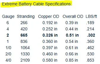

I am curious what wire gauge everybody is using on their winch. The ironman4x4 manual says it comes with 0 gauge but there’s no way. I purchased 4awg and it’s the same exact size that came with the Ironman 4x4 12k.
You can't properly gauge wire thickness by looking at the outside only. The sheathing (aka insulation) will vary based on what you buy. See wire tables I added below.
My Warn came with 2 gauge. This has been a hot topic for me lately. I've called Warn 2x and BatteryCablesUSA 1x to discuss. I was trying to run 1/0 wire (aka 0 gauge) and due to relocation and other constraints couldn't make it all work right. Not so much the diameter of the wire, but more to do with lug size, length & stiffness (lol, set myself up) of the heat shrink, etc.
Lots of variables to consider. One of the most important being distance you need to run, and amps your winch pulls at max load. Then consider you use intermittently, not continuous. You can go down a rabbit hole real quick.
Edited to add.....
All screen shots pulled from here for various types: https://www.batterycablesusa.com/2-gauge-battery-cables-2-awg
Welding Cable:
Ford Bronco 12k Winch Comparison: Pull Strength, Pull Speed, Power Amp Draw 1731957564598-n6
Regular Battery Cable:
Ford Bronco 12k Winch Comparison: Pull Strength, Pull Speed, Power Amp Draw 1731957661895-i
Extreme Battery Cable:
Ford Bronco 12k Winch Comparison: Pull Strength, Pull Speed, Power Amp Draw 1731957617198-4z
