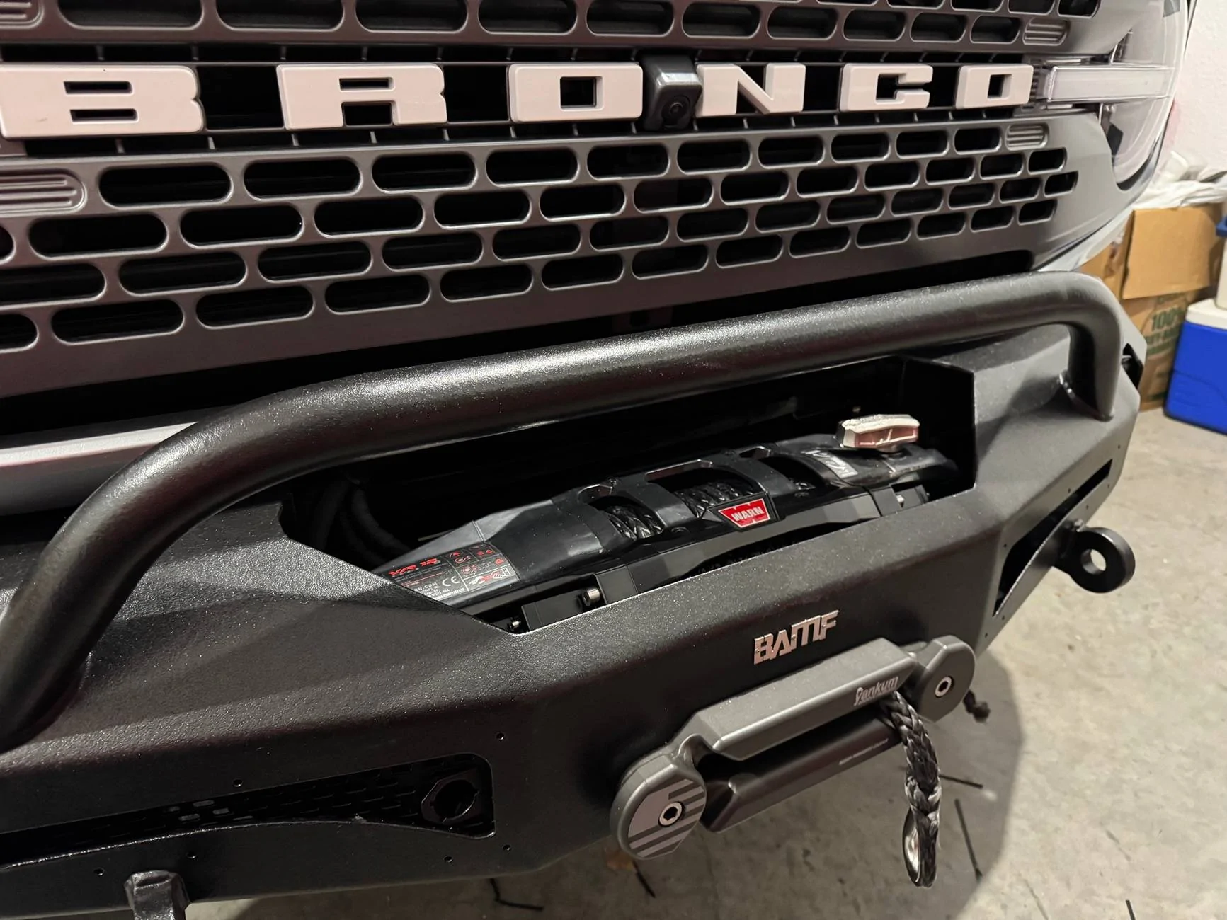

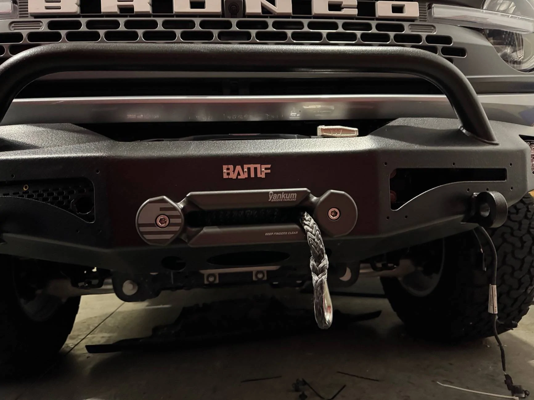

Finally got the bumper & winch installed along with Yankum fairlead. Will be tying a new knot probably later today.
Ford Bronco 12k Winch Comparison: Pull Strength, Pull Speed, Power Amp Draw IMG_1792
Ford Bronco 12k Winch Comparison: Pull Strength, Pull Speed, Power Amp Draw IMG_1791
