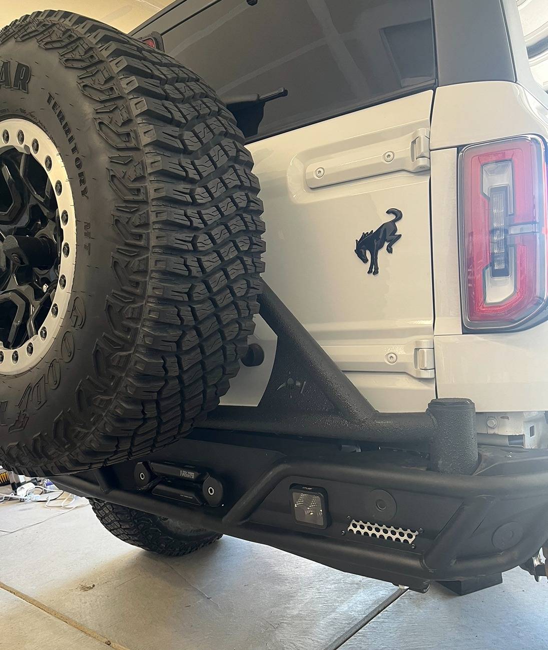

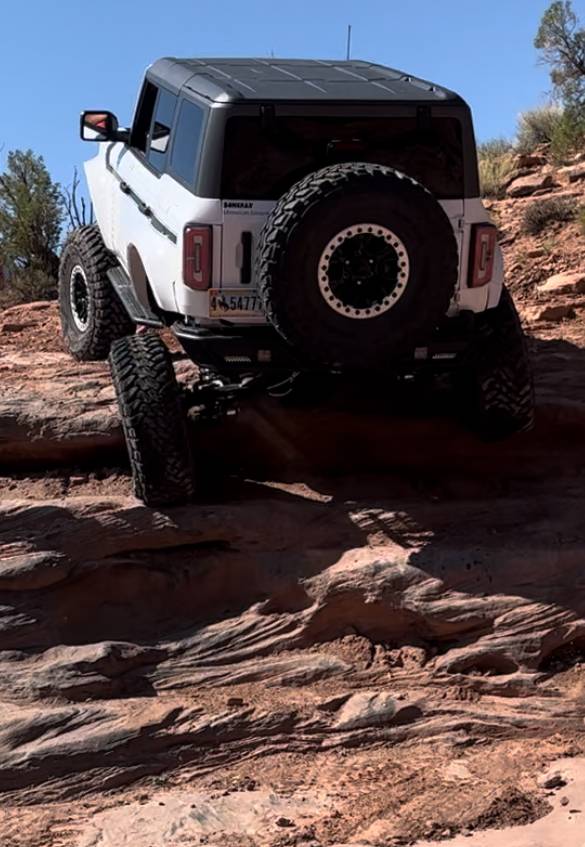

Wiring aside, what considerations are needed for putting a winch on the rear? How much trouble would it be to remove when not in use? (E.g., remove for the winter, reinstall in the spring.)
I’ve not done a hitch mount but heard mixed opinions on them.
If you got fab skills or beer to pay a buddy with fab skills, I would prefer something like this. Also including the front bumper video for fun.
I can’t remember her username but there is a girl on here that has an APG rear winch setup that isn’t as custom but somewhat similar to this one.

Use a cradle that goes into your 2" hitch mount. Use Anderson connectors for power. You can either make an extension cord or run permanent cables. I'd go for an extension cord you can drape along the side of your Bronco. Use hooks to hang it.
This was always my preferred winching setup for fullsize pickups. Just a hitch mounted winch that you could put front or rear when needed. But there's just not a whole lot of room in the Bronco compared to a pickup with an 8' bed, and I really didn't want to have one bouncing around the cab. So hard mount it is.

I absolutely love that front bumper. I want to say someone quoted it as being ten grand or something crazy. So maybe I don't love it that much.
Is the girl you're referencing Mrs. Sierra Bronco? Because she does have a similar setup with an APG mount.
There's also the problem with the spare tire. You'd have to remove it to get clearance for a hitch mounted winch.

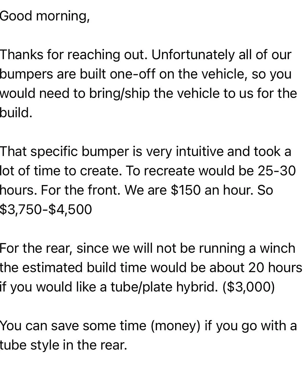

Well MF’er….maybe. <\ Samuel L Jackson voice>
In my head I had separated y’alls build from the other one but maybe I got it mixed up. I don’t recall the other one being as extensive but maybe you did the rear bumper before the rest. It looks similar but assuming there was 2 then they would be the same bumper. Unfortunately my list of cool chicks that drive bad ass Broncos is pretty slim, lol.
When I talked to Stellar back in January this was a ballpark quote they gave me. I’m Midwest so the distance thing to CA was a deal breaker for me. Tried finding someone local but they were all scared, lol.
Hoo! So that number must’ve been for both bumpers and winches front/rear.
I’m sure there are other lasses out there that have rear winches. It’s funny-when we first started accessorizing the bronco she was terrified of simply pulling a panel. Now if there’s an accessory that requires the use if a cutting wheel she has dibs. 😂😂

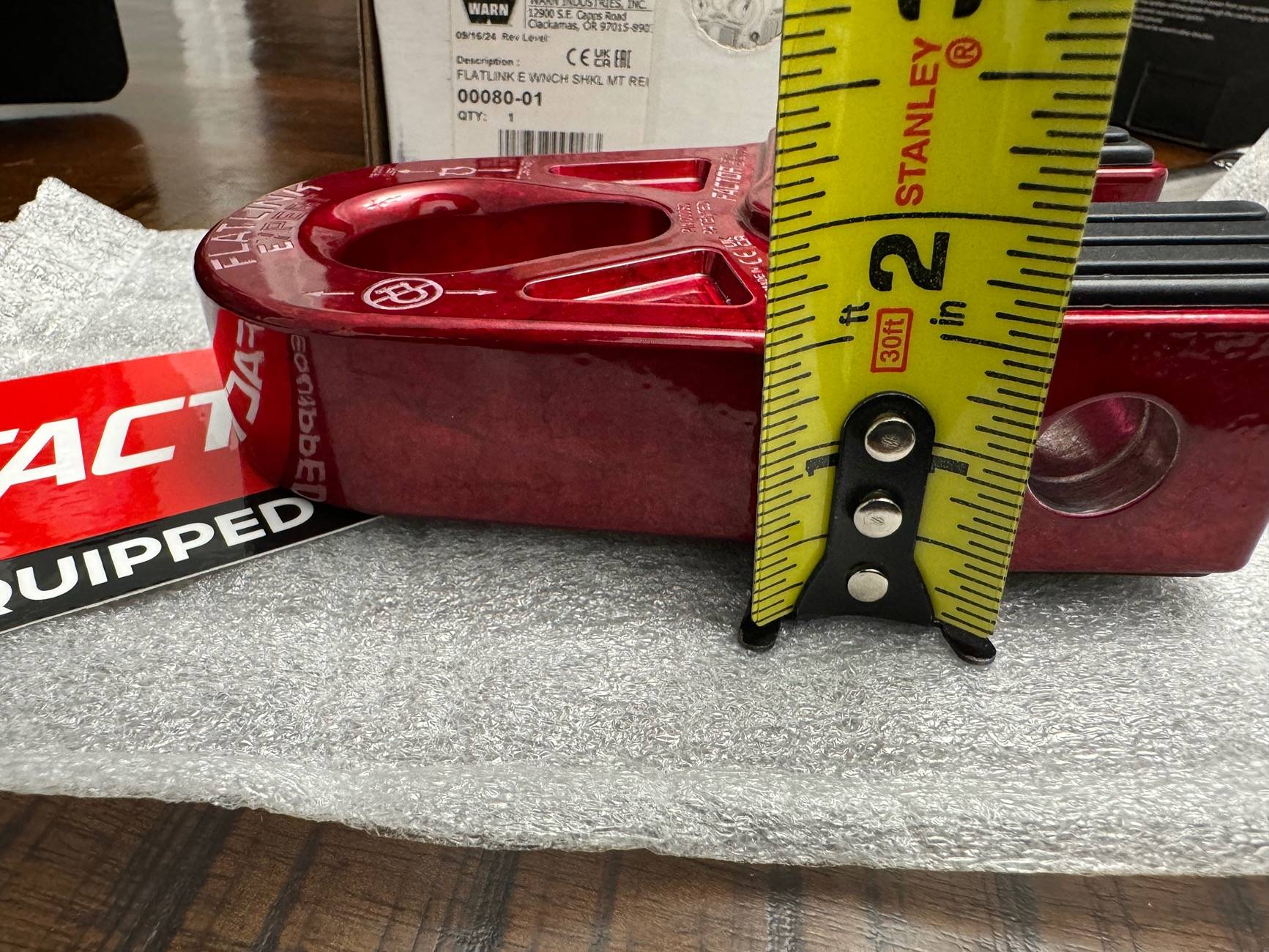

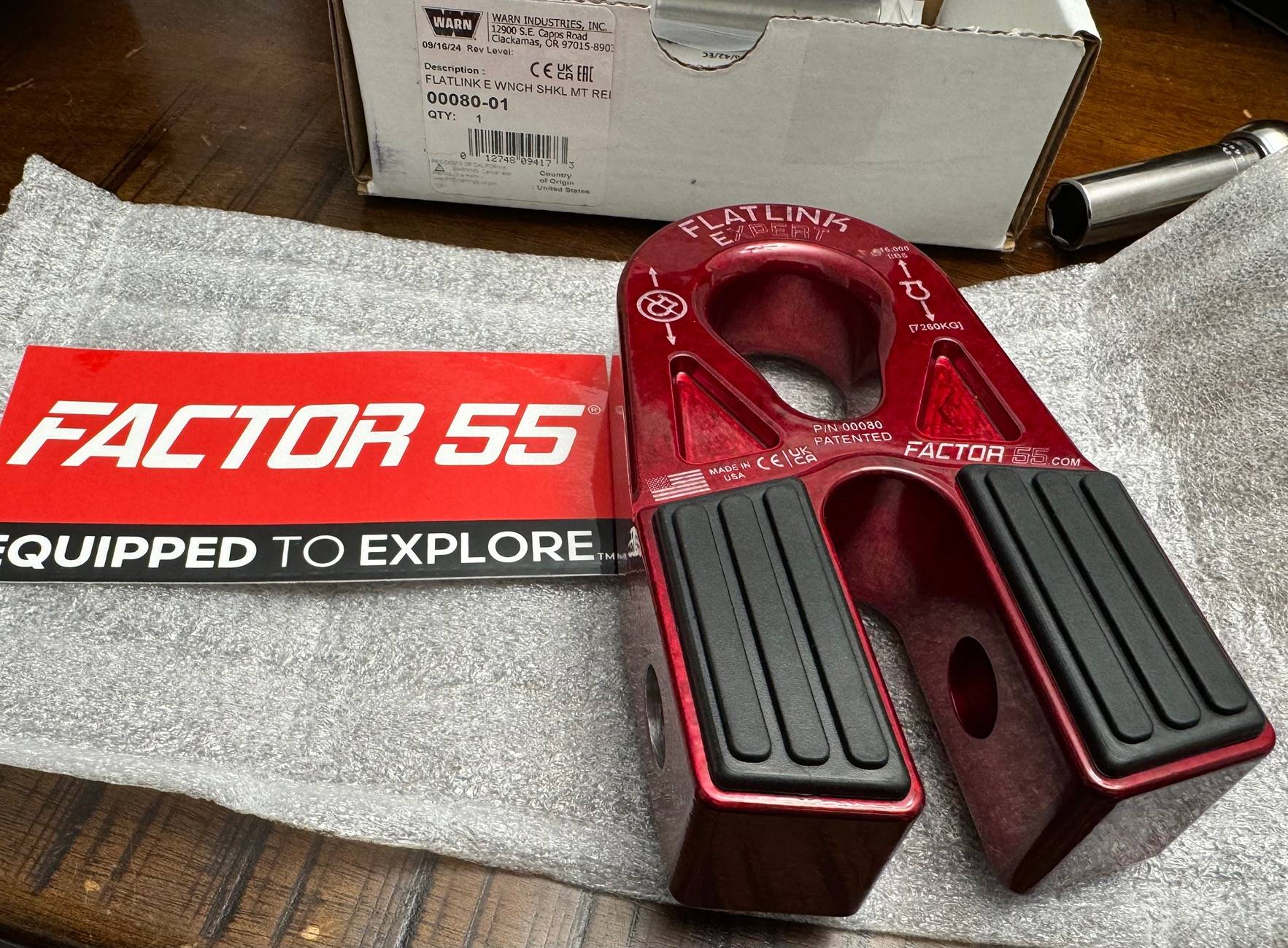

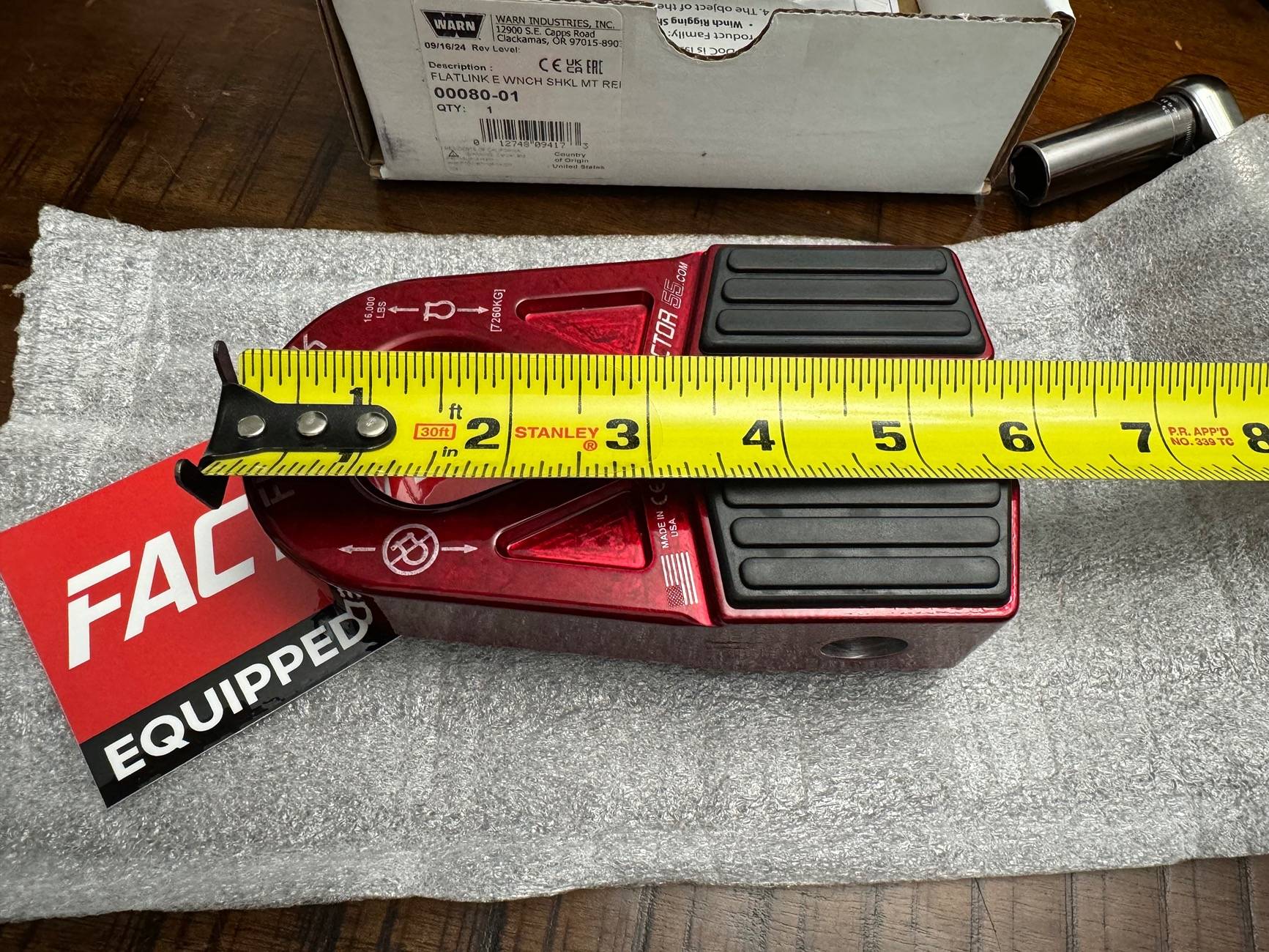

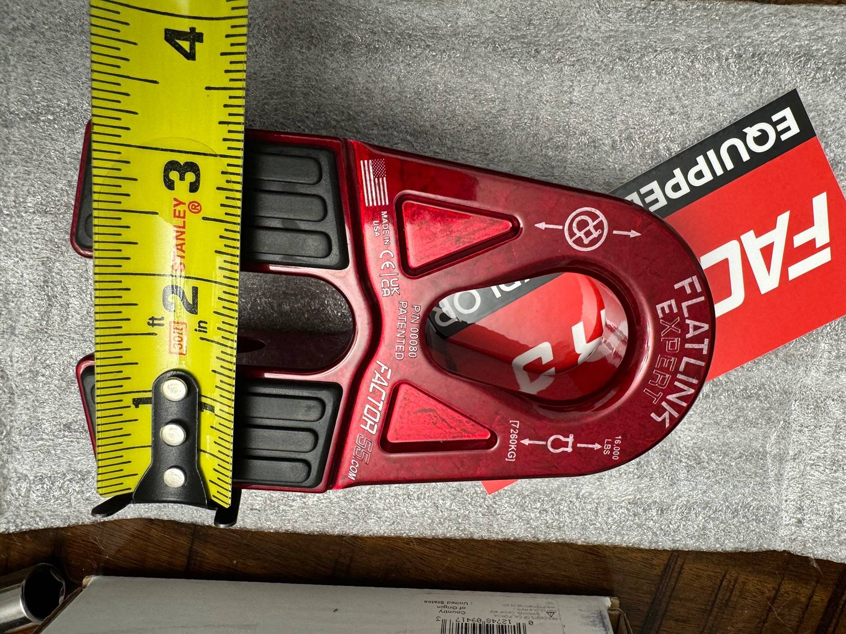

Any issues or concerns with UV exposure on the exposed portion of the rope?

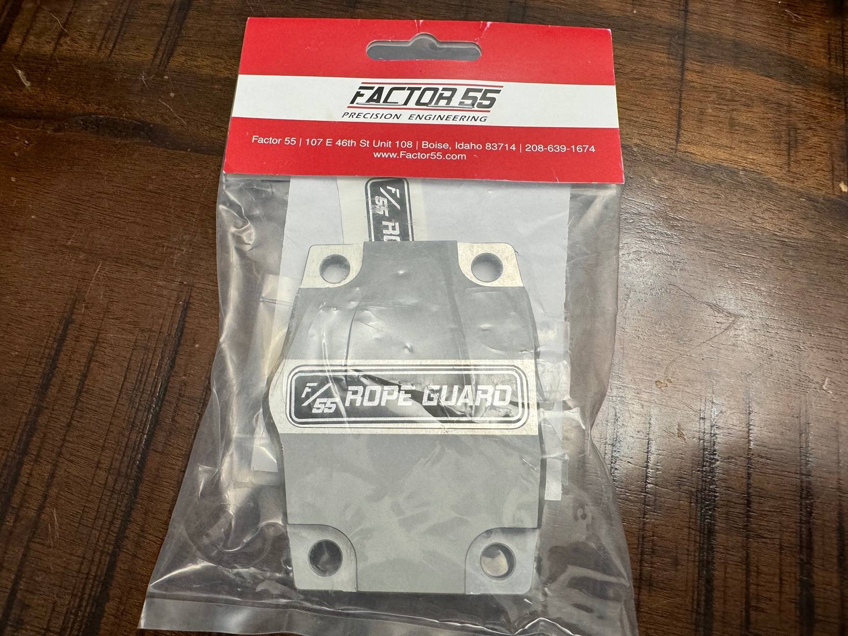

I got my Factor 55 Flatlink E in with rope guard the other night. I was second guessing that decision and thinking I should have leaned this way instead.
That’s a pretty good chunk of metal that could fly at my head. Plus it’s a dark red metallic color instead of “Warn bright red”. I may not even see it coming, lol.
Nah. Not worried at all. If it breaks it’s easy to retie. But that’s a good point.
