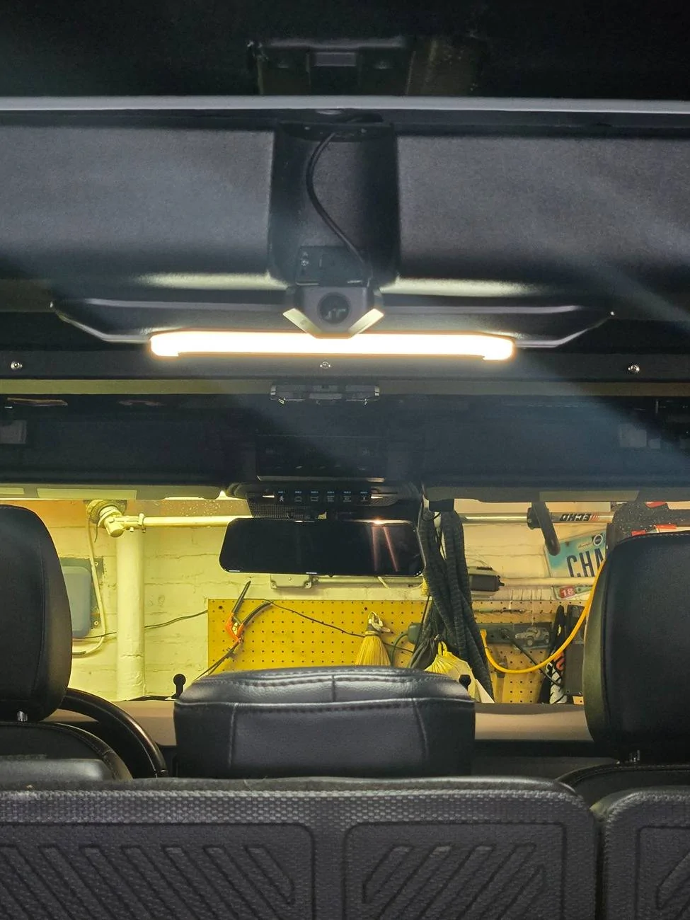

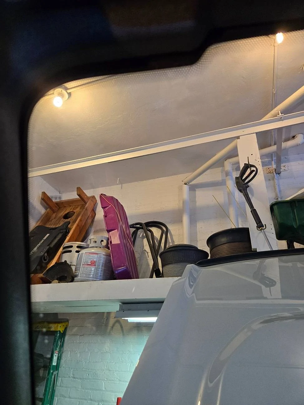

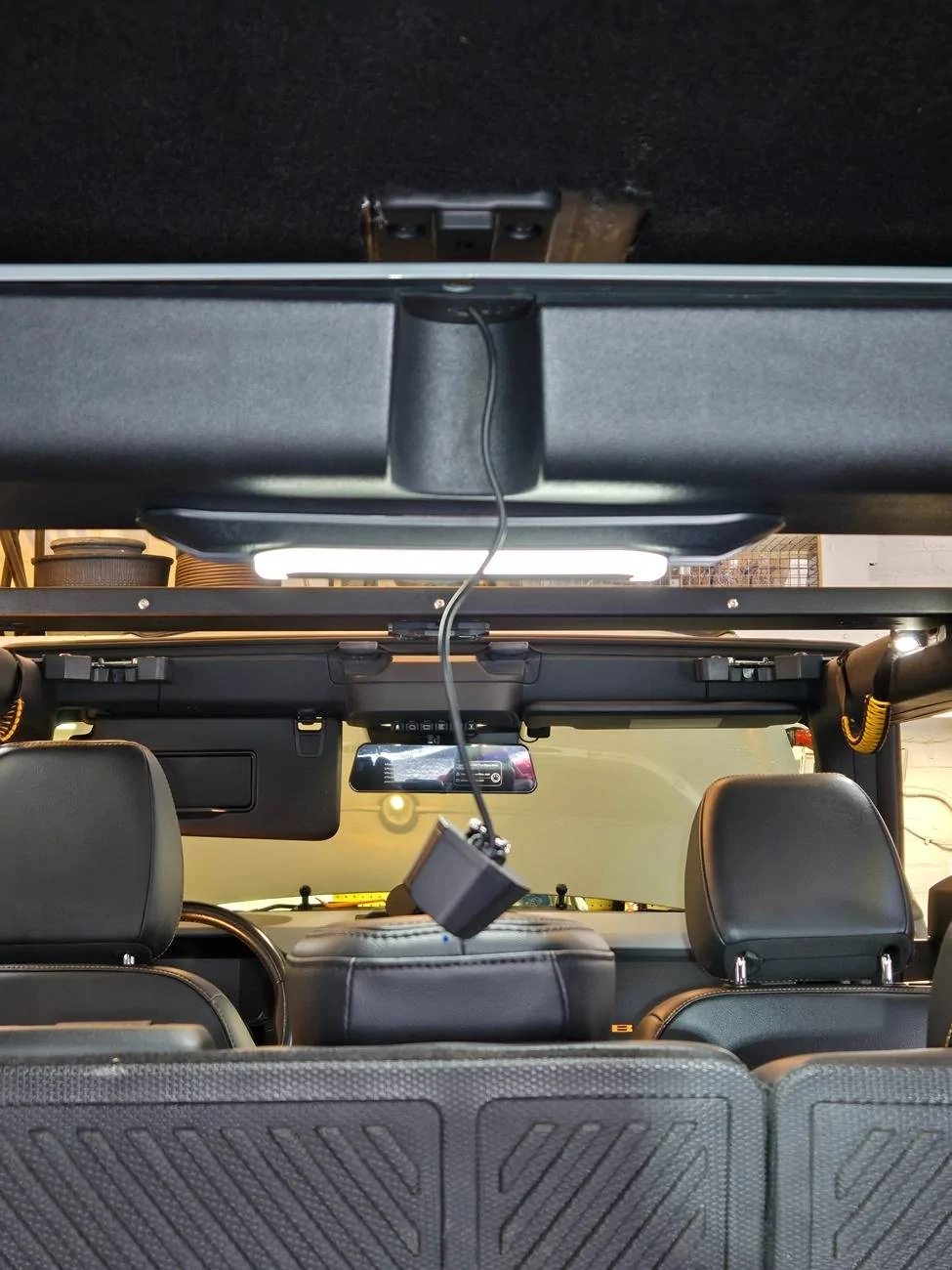

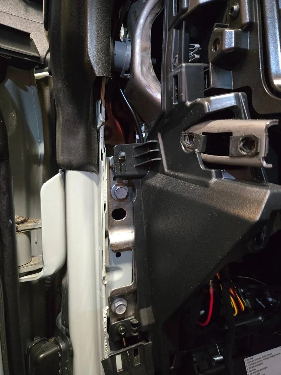

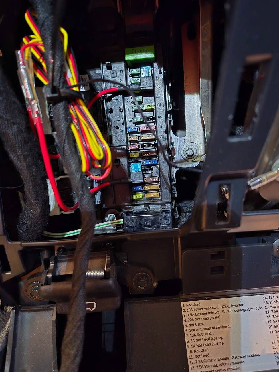

Installed the @WolfBox this morning. Took me right around 2.5 hours. Went off without a hitch. Not going to do a super involved walk through since more qualified people have already done so, thank you @RustysBronco & @TheLawnDart & @Ninjak for all of your guidance.
Went the hardwire route. Routing up to the dash and up the A-pillar went well. I ran the back camera wire along the passenger side behind the airbag paneling and through the back rollbar cover.
Originally mounted the camera up in the cranny and then dropped it down a few inches for more coverage. Didn't want it outside because of all of the weather disruption. My back up camera gets gunked up constantly so I figured why have two back there getting gunked up? Few pics below, not very good, sorry. The pics of the windshield were only to demonstrate I had no wire poke. Lighting in the garage sucked, but had to be in there because it is below freezing here in Cleveland.

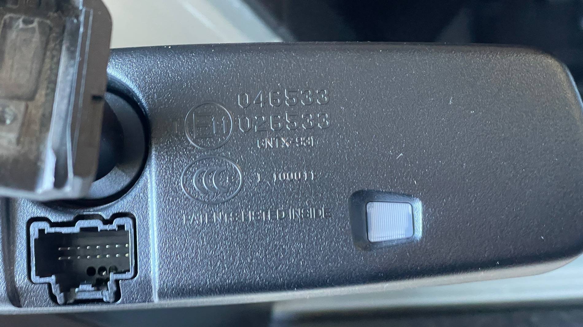

Also...it appears there's a light sensor on the back of the OEM mirror. I'm hoping that is not being used by the headlights in any way, shape or form? For auto dimming mirror hopefully?
The headlights sensor is the little bubble on top of the dash, by the middle of the windshield.

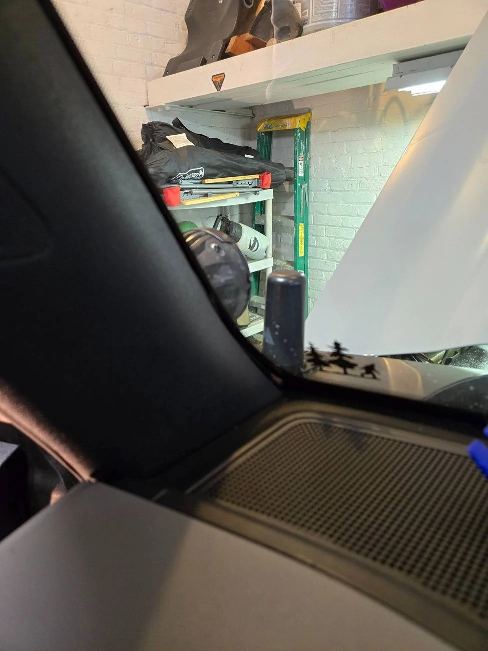

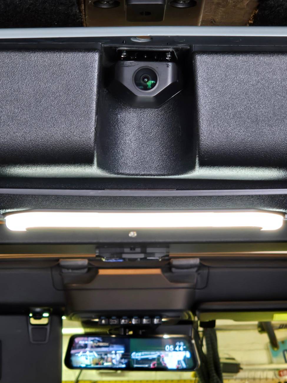

Installation finished. I opted to do the camera inside the vehicle and we'll have to see how it looks at night.
My only real quip is the Dongar power adapter is bulky and for the life of me, I could not get it behind the plastic cover. It's all sitting behind the mirror. A right angle USBA to right angle USB C will tidy things up a bit but still won't be optimal.
I'm guessing it's auto-dimming for the mirror then.

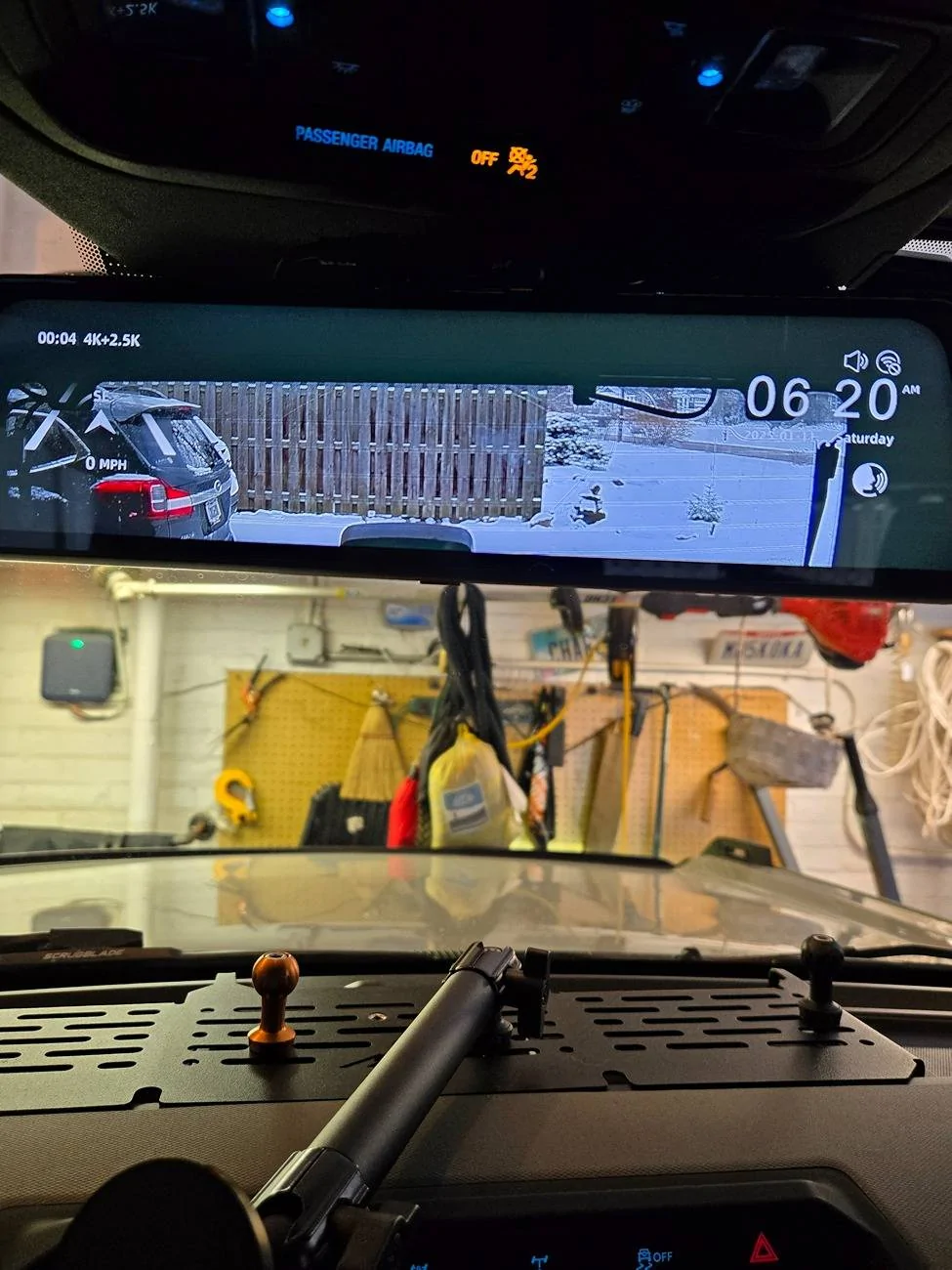

Had a chance to drive around tonight and even with the tint, the rear view with the camera inside the cabin is more than adequate. If there are no streetlights or cars behind you with lights on, you can't see anything really but it'd be the same with the regular mirror.
Still getting used to it a bit as the perspective is much wider with the rear camera vs. looking at the rear view mirror. There's just a disconnect in object size which is emphasized by the sideview mirrors. The same object is much smaller via the rear camera. It'd almost be nice if there were a zoom function to equalize the perspective somewhat. I'm sure I'll get used to it.

The sensor on the mirror is just for auto dimming the mirror. I found this out when I got tinting done, they had it upside down and the mirror was always full dark. Took me a few days to figure out why.
