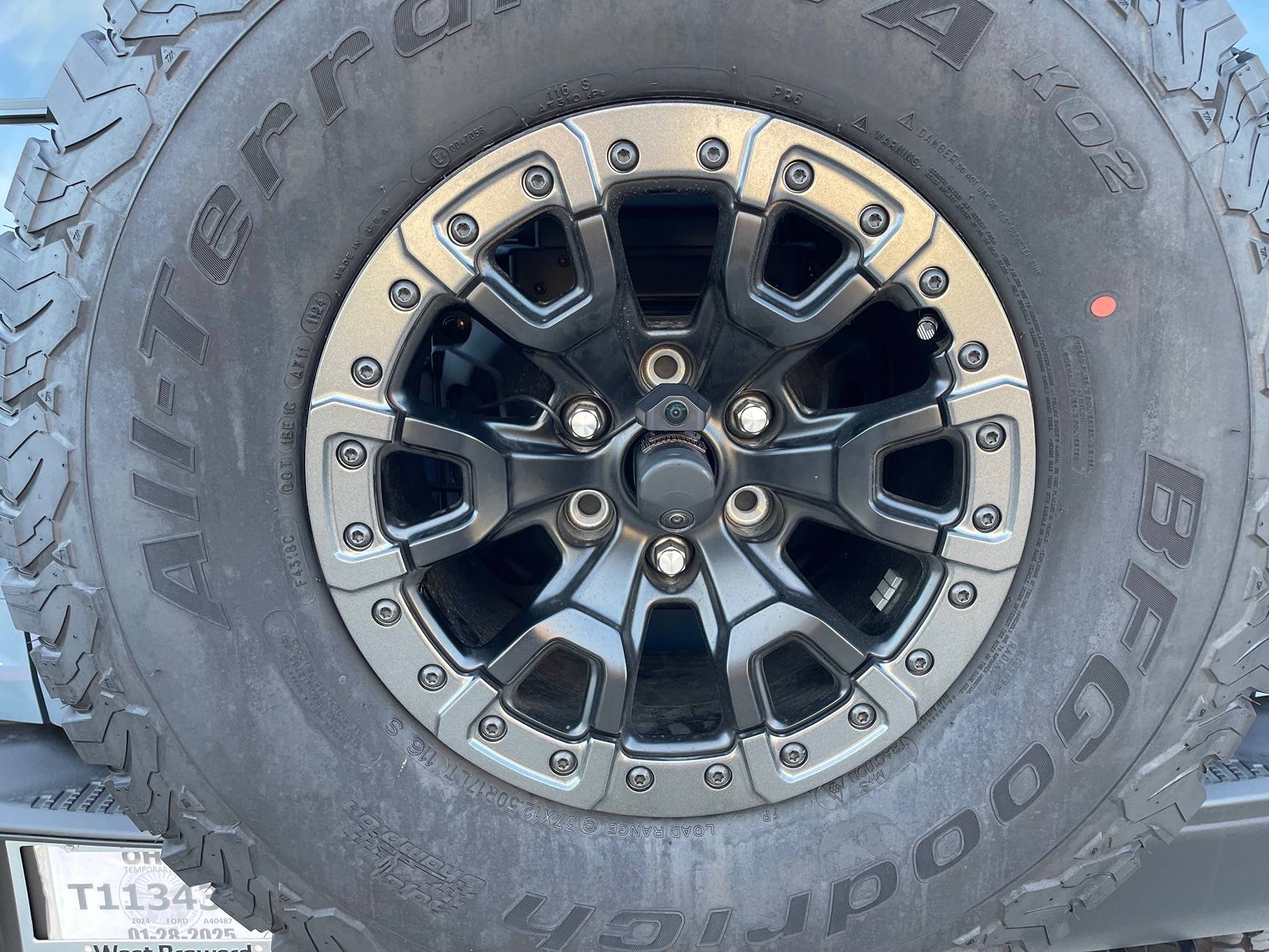

I have installed 2 of these systems, 1 in my wifes 2024 Kona and the other in my 2024 Bronco Raptor. The Kona has is installed inside and my Bronco Raptor I mounted it right above the factory rear camera on the spare tire. The outside camera image is much better IMO. You get a much wider cleaner view of whats behind you. mounted inside you loss alot of view. I would only mount it as far outside as possible for the best quality image.
You will want an extension cable to reach the rear tire. If you remove the larger plastic trim piece on the tailgate you will see a rubber grommet, take a small razor knife and put a small slice in it just enough to fit the extension cable through to make the connection. You will also remove the smaller/upper trim piece to run the rear camera cable. Thats where I started my extension cable and finished it outside the Bronco. I used outdoor velcro tape to mount the rear camera right above the factory camera if I ever needed to remove or replace it. Trust me, do it right the first time, mount it outside with a 6' foot extension cable from amazon, it was like $5 bucks

How did you mount the camera outside? What did you use to secure it ? I have my camera inside behind the molle, it does not bother me, but honestly I did not consider mounting it to the back-up camera stalk. I have a turn off-road mount, there are some place to put it if I extend it.
Ford Bronco Wolfbox G900Pro Install DIY How-To Writeup IMG_6884
easy to remove and replace if you want to take the tire off. I have the extension connection behind the camera too. That makes it better if I need to remove it for a new camera for any reason. You just need to bend and shape the bracket slightly to fit the curvature of the factory camera, very easy to do
