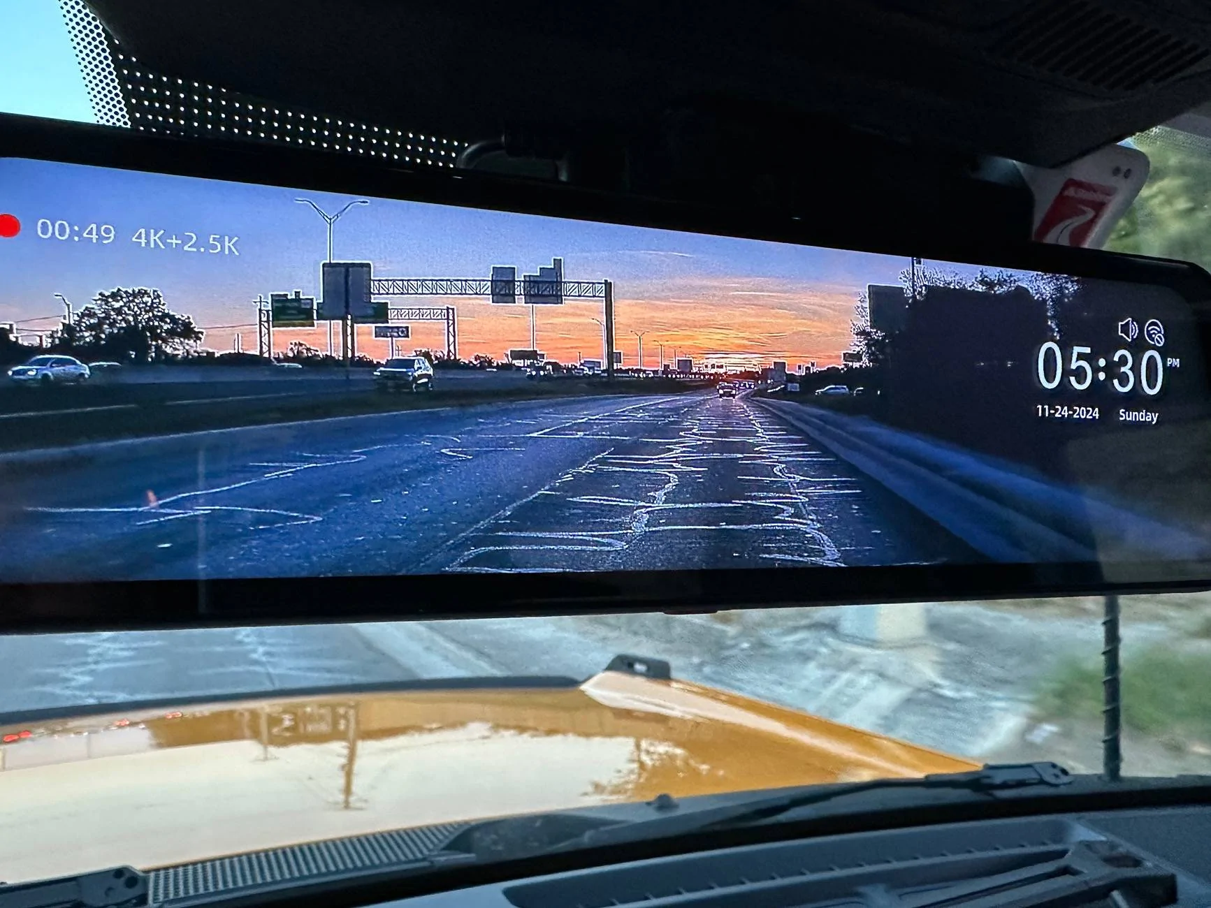

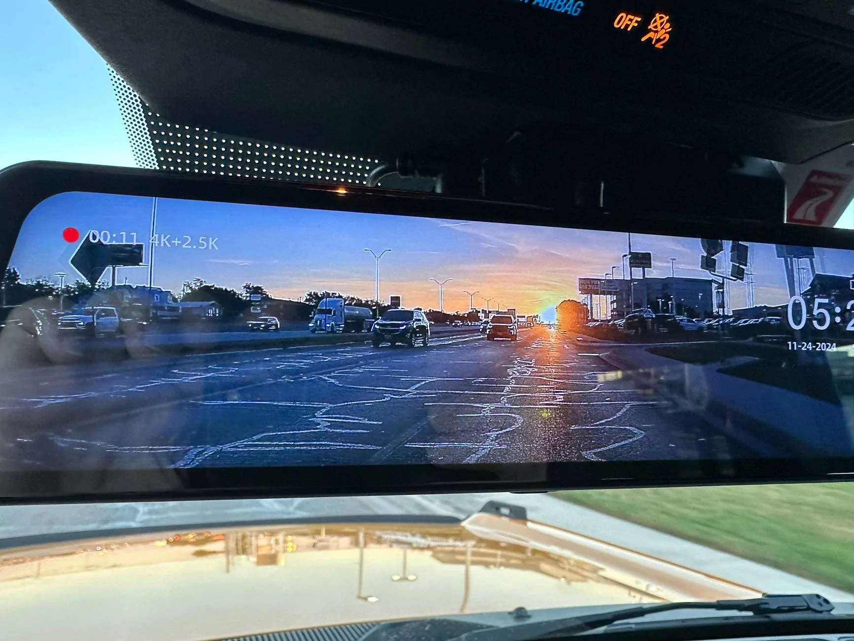

They sell a polarized filter for the front camera. But reviews say it doesn’t fit that great and can be seen in the corners of videos. That filter won’t fit o the rear camera.
The anti glare film isn’t made for the lens side. And polarization filter wouldn’t work with headlights most likely. Not to mention there are none that’ll fit it.
rain can be an issue as the water hits the lens directly. I’ll get a picture next time it rains.
meanwhile, some driving away from the sunset pics.
Ford Bronco Wolfbox G900Pro Install DIY How-To Writeup IMG_9090
Ford Bronco Wolfbox G900Pro Install DIY How-To Writeup IMG_9089

Sorry if I'm misunderstanding. Are you looking for film for the rear view mirror or the actual camera lens?
