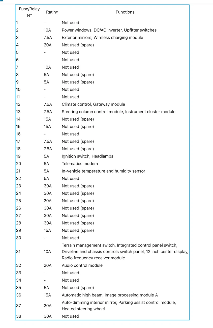

Install:
First thing I did was install the fuse connections
***EDIT*** Changed the fuses to 37 and 25 for constant power
After disconnecting the battery, use these little guys and connect the red (ACC) to fuse 37 and the yellow (BAT) to fuse 25. You just remove whatever fuse is currently in that spot, place it into the empty slot shown below​
Thanks for this post. I had mine hooked up to 3 and 37 and my battery drained. I need the parking mode so I will try 37 and 25.

Is the raptor fuse panel different? I have 2025 Bronco Badlands, should I use 37 and 25 instead of 3 and 37?
