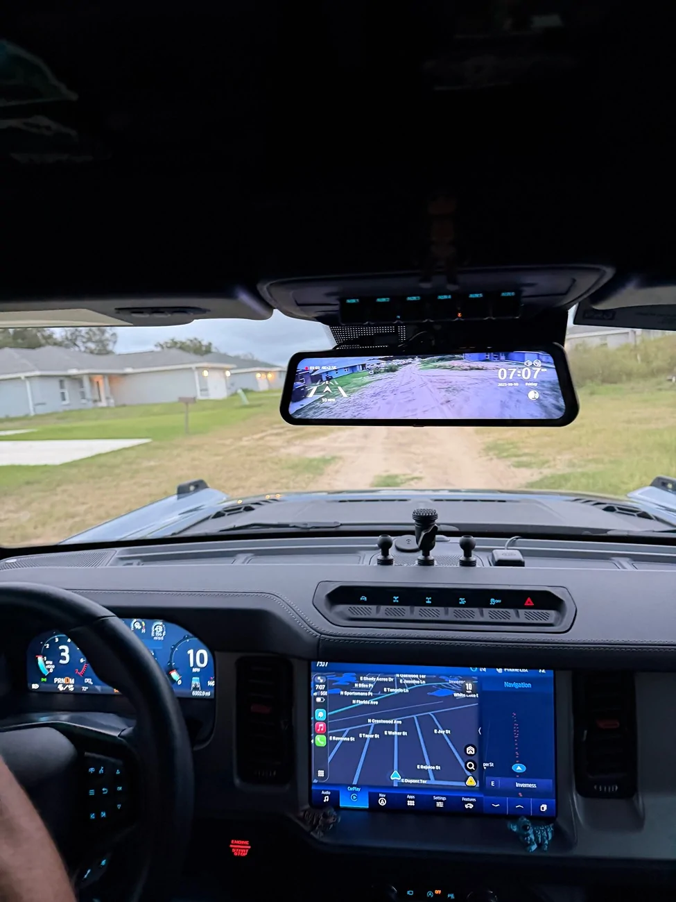

Installed my Wolfbox 900 pro yesterday. Followed the video posted by @RustysBronco. It was a big help. Rear cam was a little bouncy off road so used a small bumper between the cam and rear trim and it cured the bounce.

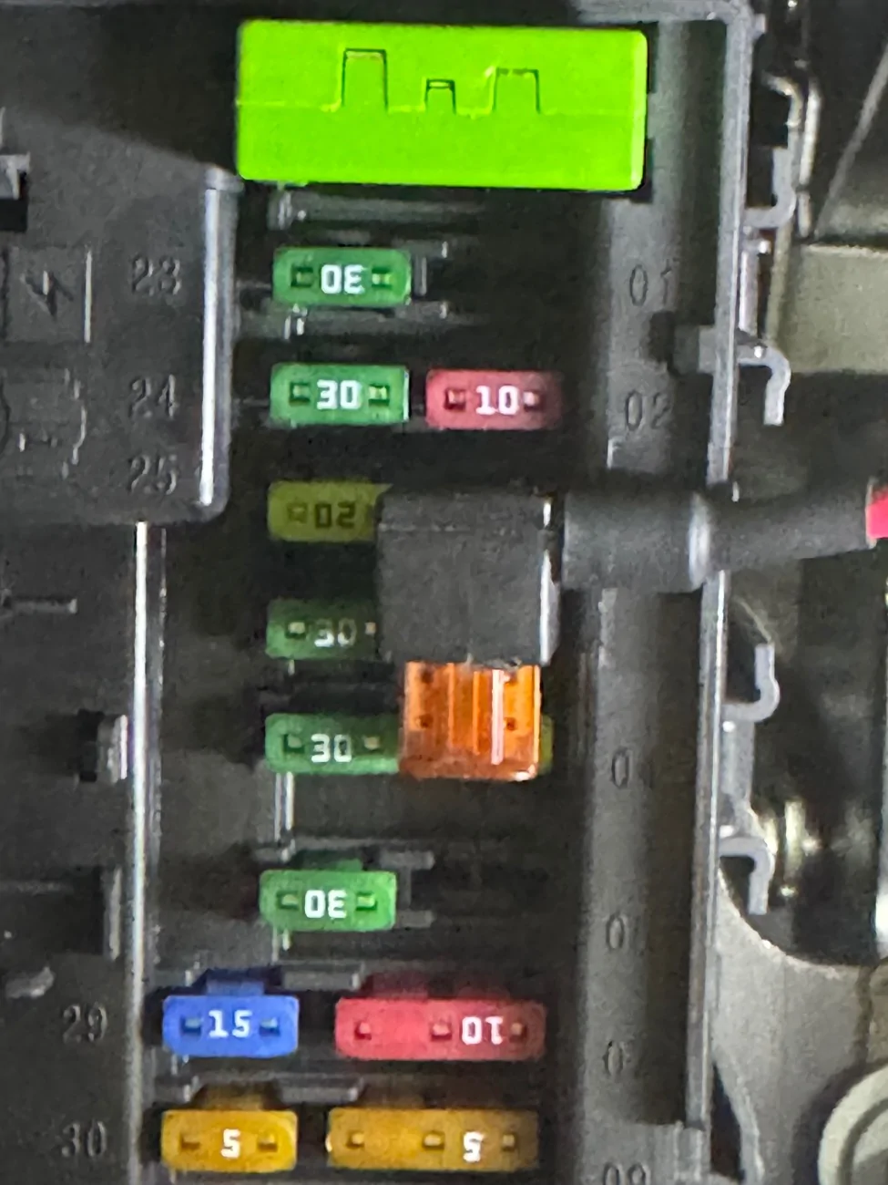

Found a fix! Reoriented the fuse tap to point down instead of up and replaced the blue Wolfbox fuse with the ACC fuse I pulled and boom! Power mirrors restored!
hope this helps folks!

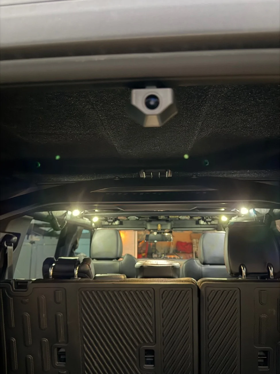

I came in here to find an answer to this problem. I had the wolfbox on my badlands mounted behind the spare, no shake, but any but of weather and it would be covered in water.
Now on my Raptor, I initially mounted it to the trim above my rear window, and it was both shaky and had weird reflections from being farther from the rear window. Thought iw as because the trim peice was separate from the top itself since it was a "tunnel" for other cables. So, I got a bracket and mounted it directly to the rear glass itself. Still shaky, especially above 50 mph - not sure if it is wind or the vehicle bouncing or just the play the rear glass has on the seals. I need to find a way to stabilize it. I was hoping to not mount it back on the spare again to avoid the weather issue. @RustysBronco do you have any shaking? Or have any recommendations?
Makes sense...I think the direction of add-a-fuses matters.
