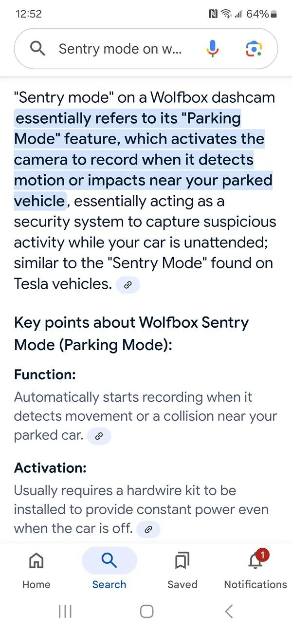

As for the sentry mode y’all are talking about: I think only the G900 has that function and not the G900Pro. I can’t find that setting in mine, only the “parking mode” which does a Timelapse and the G-Sensor if you get hit. Is that right or am I missing something?

I think you are correct. I do not see anything but the parking and the G sensor. I was not really worried about the sentry anyway.

Pretty sure they are one in the same.

Parking mode looks like it’s a Timelapse based off what I’m seeing in my settings, vs sentry mode is motion activated

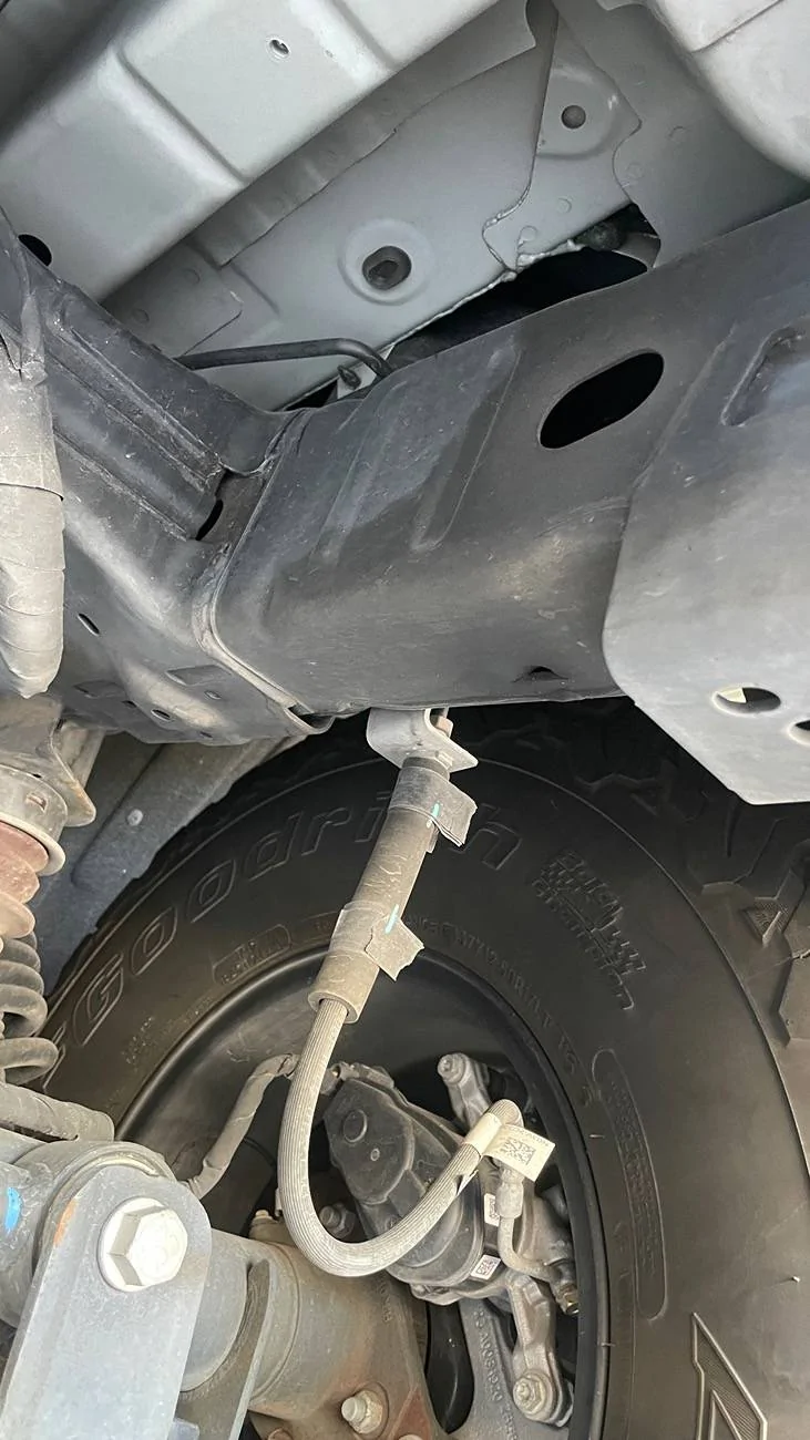

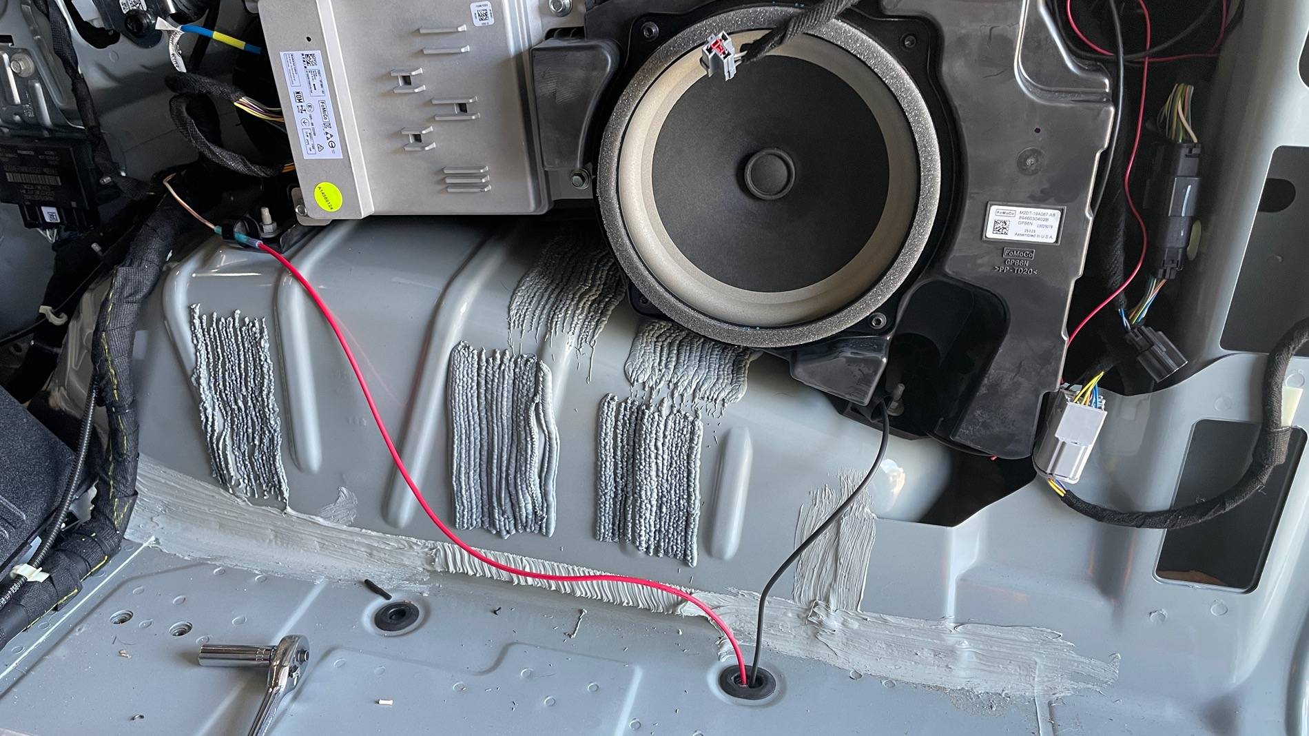

Has anyone used the license plate mount for rear camera?
How did you run the wire for rear camera?

Not running it that way myself but you could get the longer extension and run the wire through one of the grommets that are on the passenger's side of the cargo floor to the bottom of the Bronco and then up to where you need it by the license plate. Can't remember if said grommets are under the cargo panel cover on the passenger's side or if they're visible just by pulling the floor covering up. You'll want the rear-most grommet as it's very easy access underneath.
