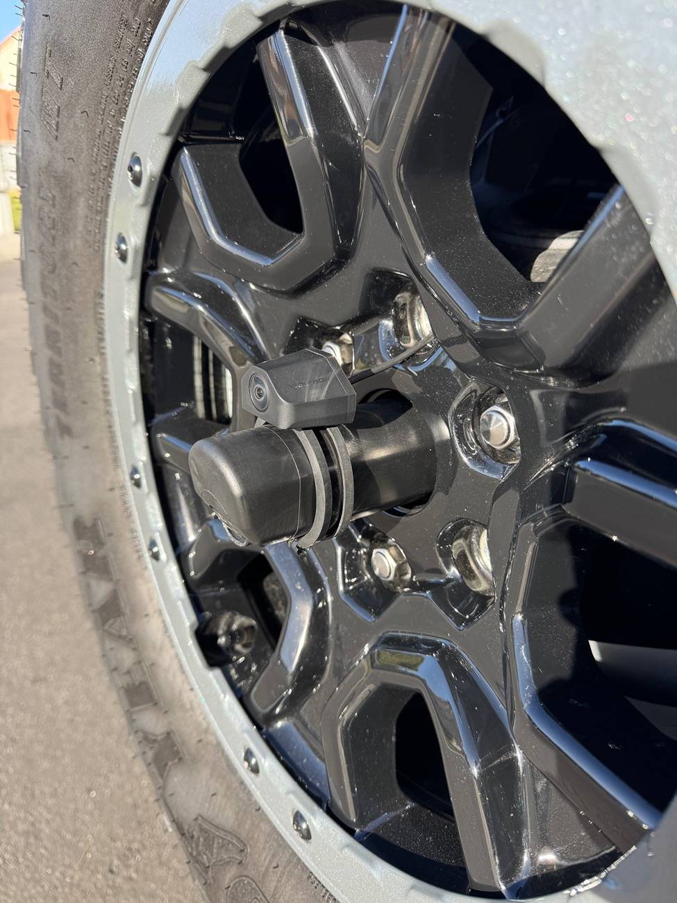

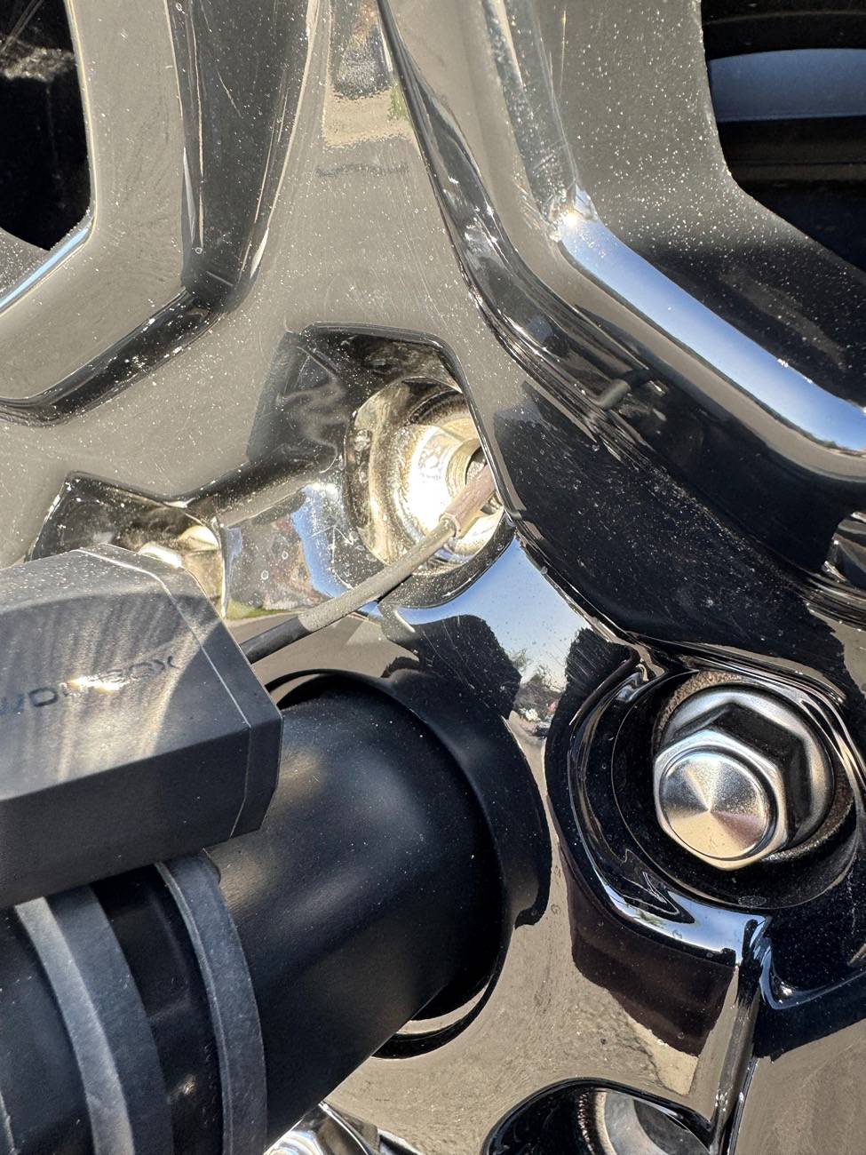

How did you mount the camera outside? What did you use to secure it ? I have my camera inside behind the molle, it does not bother me, but honestly I did not consider mounting it to the back-up camera stalk. I have a turn off-road mount, there are some place to put it if I extend it.
I have limo tinted windows so installing the camera inside on top of the rear window was too dark. I wasn’t a fan of putting it on top of the brake light due to the tire being in the way if I pull the view downward on the monitor. So I came up with this option. I used a black hose clamp with a black rubber liner from a rubber insulated clamp. They are the same size. The camera is clamped to the Bronco rear camera housing. The only thing is I would have to remove the camera to take off the spare. Quite easy though since it is just a hose clamp and the camera plug is behind rear brake light.
