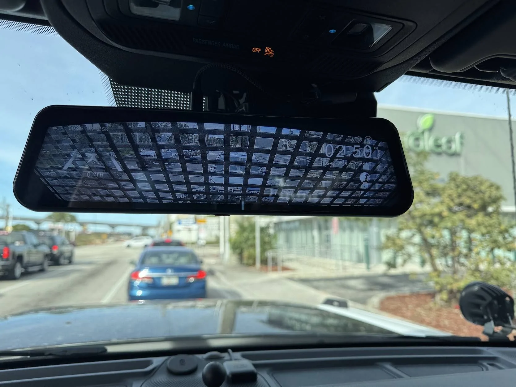

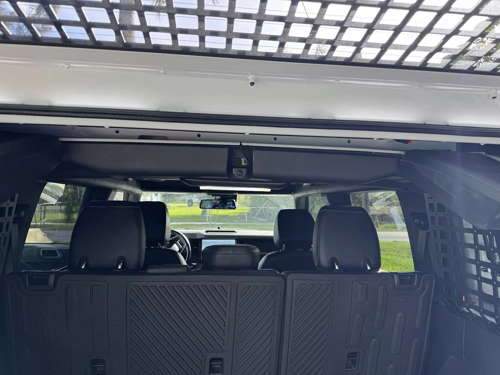

Finished up my install of the rear camera. In the end, I ran it inside, as lol I could not find where my 3rd brake light went to, also was not sure if I had the wire to run it outside. Looking at the camera mounted to the Ford cam is not a bad idea.
What I ended up doing is mounting it inside in the nook. Since I have the molle panel on the rear mounting it closer to the molle kind of skewed the pic. Where I have it now, it shows the full rear of the glass and besides the checkerboard, it looks good.
Yeah, the four door likely needs the 33’ extended cable they sell to get outside. I ran to the top of my third brake light on my two door going around the passenger side glass, down to the floor to the tailgate and had maybe 6” of slack in the cable.

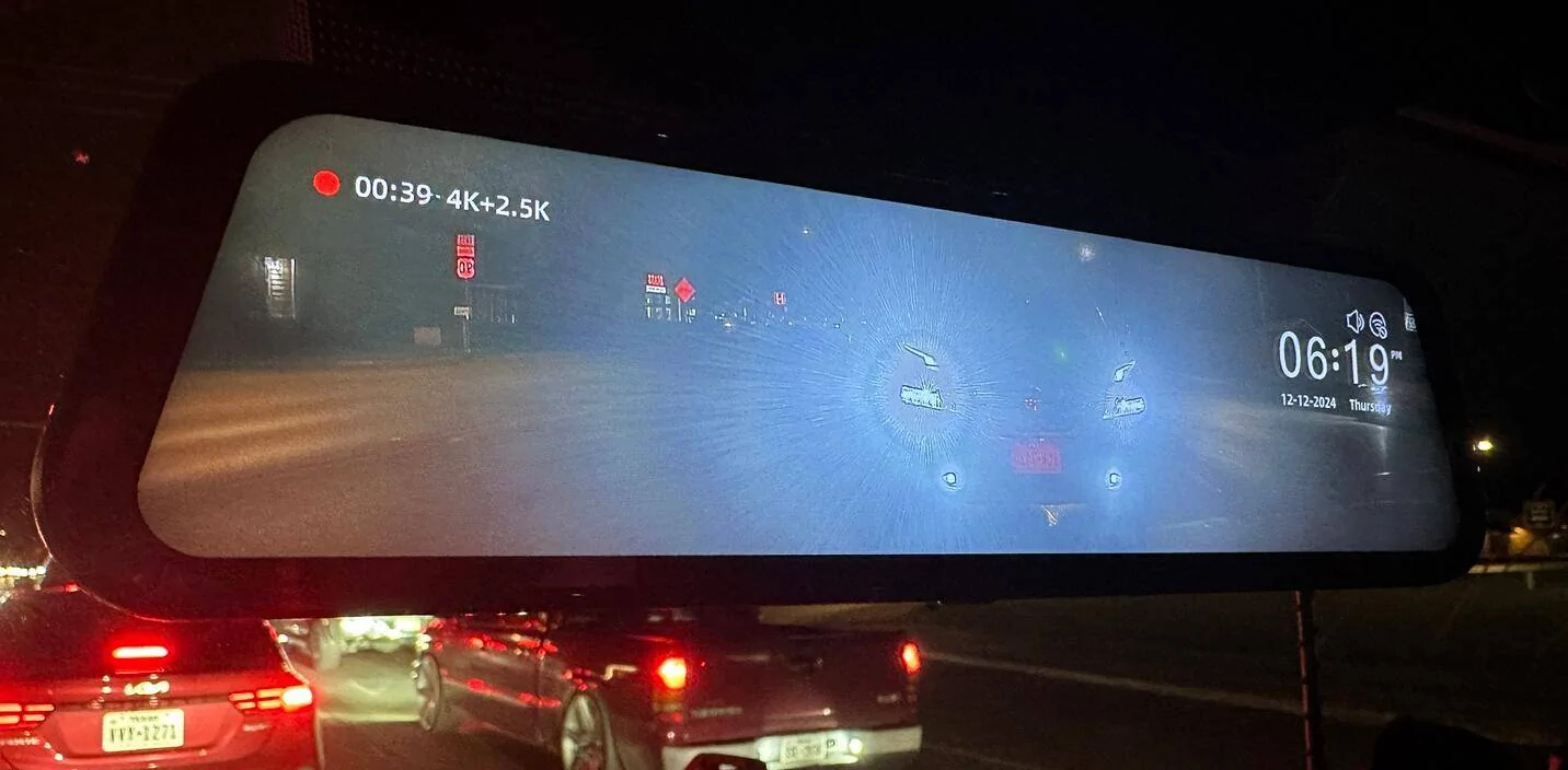

Mine's also on the backup camera. Do yall get as bad glare from headlights?
Ford Bronco Wolfbox G900Pro Install DIY How-To Writeup 1736185942665-0a
Wish I could get it mounted up higher. But, soft top.

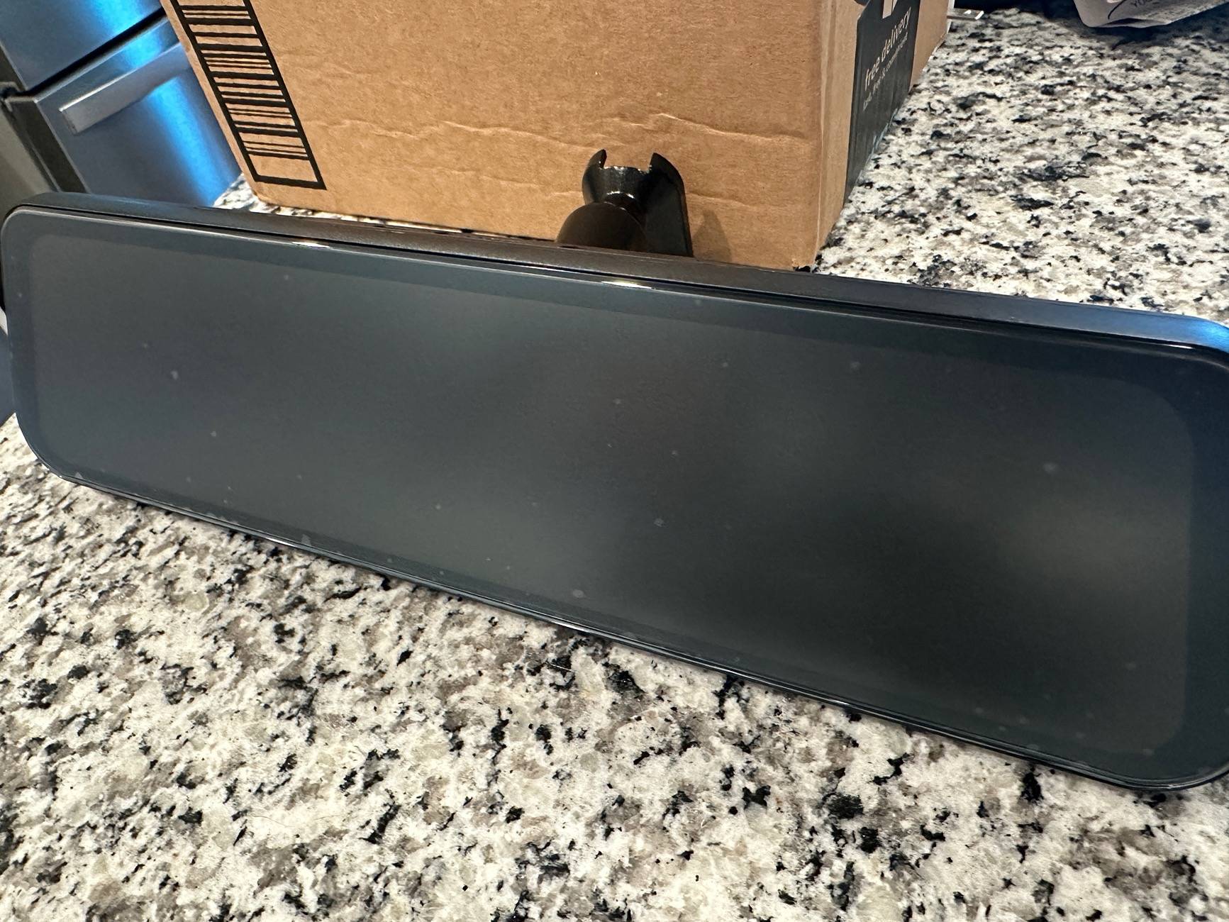

I got the anti-reflection cover for the mirror and this is the hardest protector screen I’ve ever put on and I’m really good at installing cell phone ones. It’s a dry installation method and it’s just so big that it’s nearly impossible to not get dust or bubbles. There are ways to get dust out, but because it’s so big when you get dust out more just gets in. I’m probably just gonna pull it off.
Ford Bronco Wolfbox G900Pro Install DIY How-To Writeup IMG_9303
Plus it makes it useless as a mirror if the power is off.
