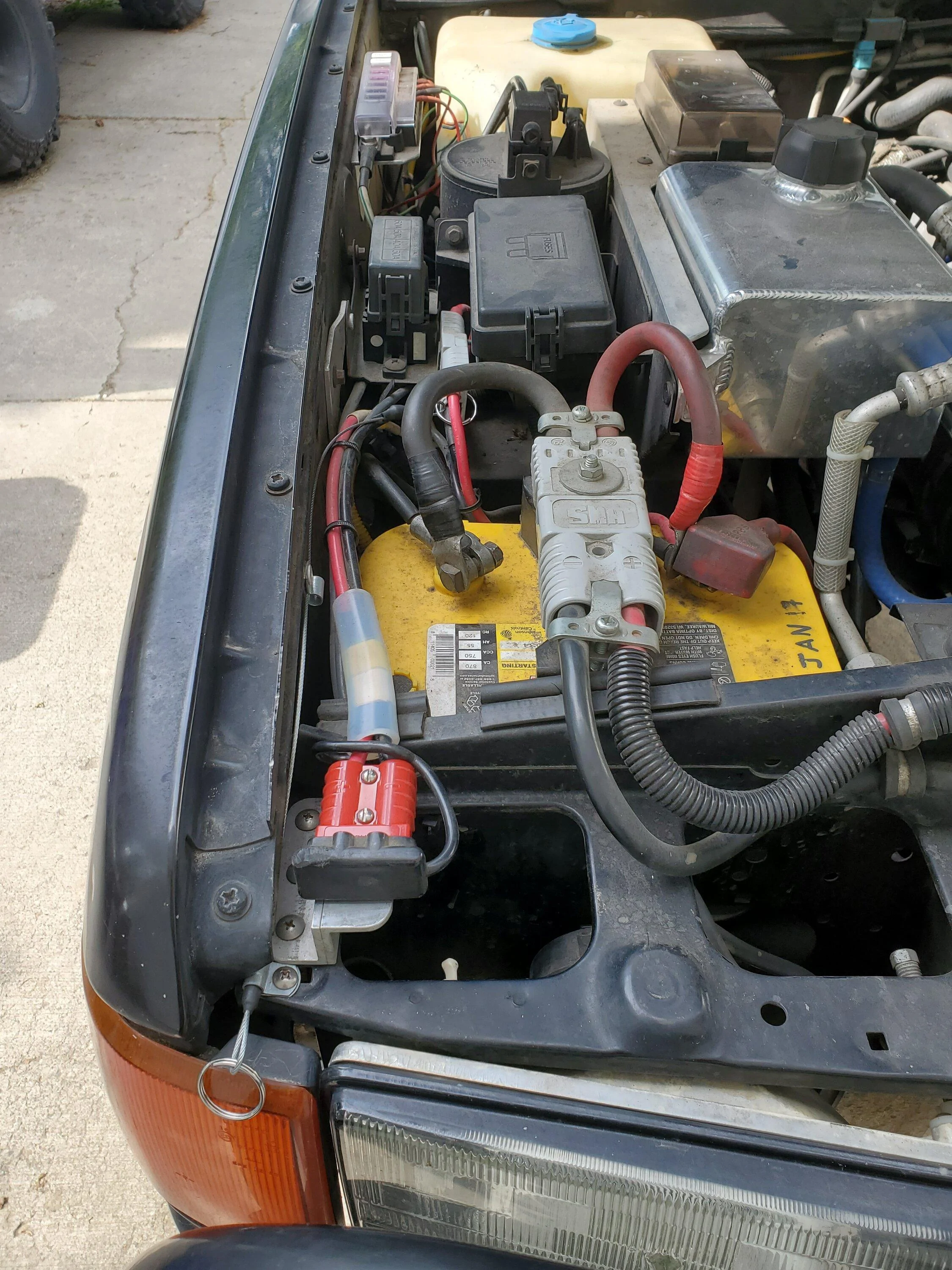

This is how I have opted to deal with a fail safe, manual disconnect. Dead reliable and my jumper cables plug into the same connector.
This is how I wired mine up to my truck. I also have a set of 30 foot jumper cables I can plug in and help someone if needed.
