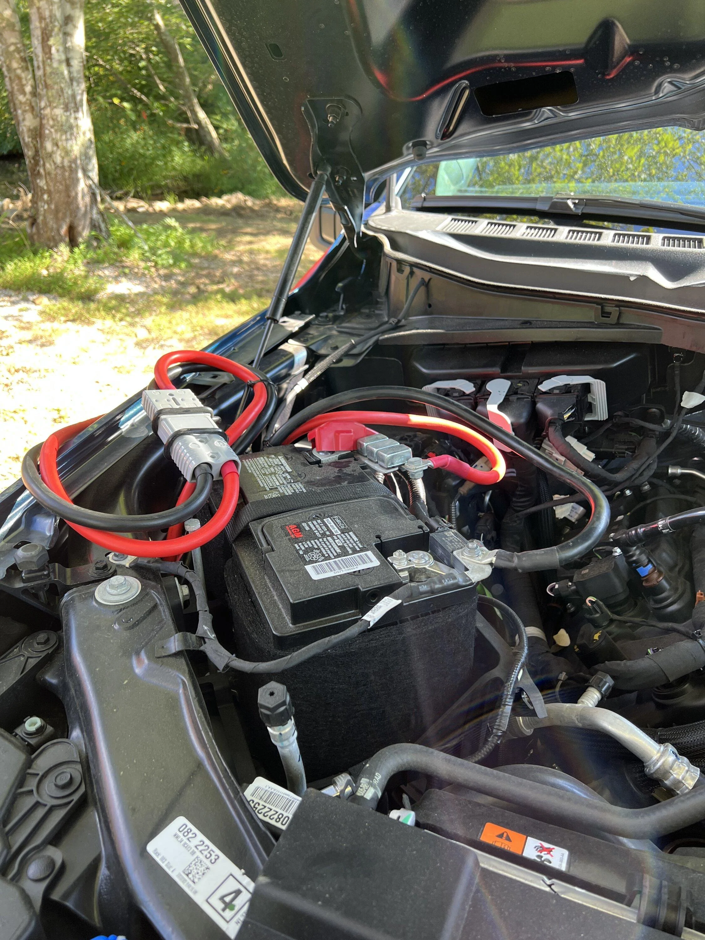

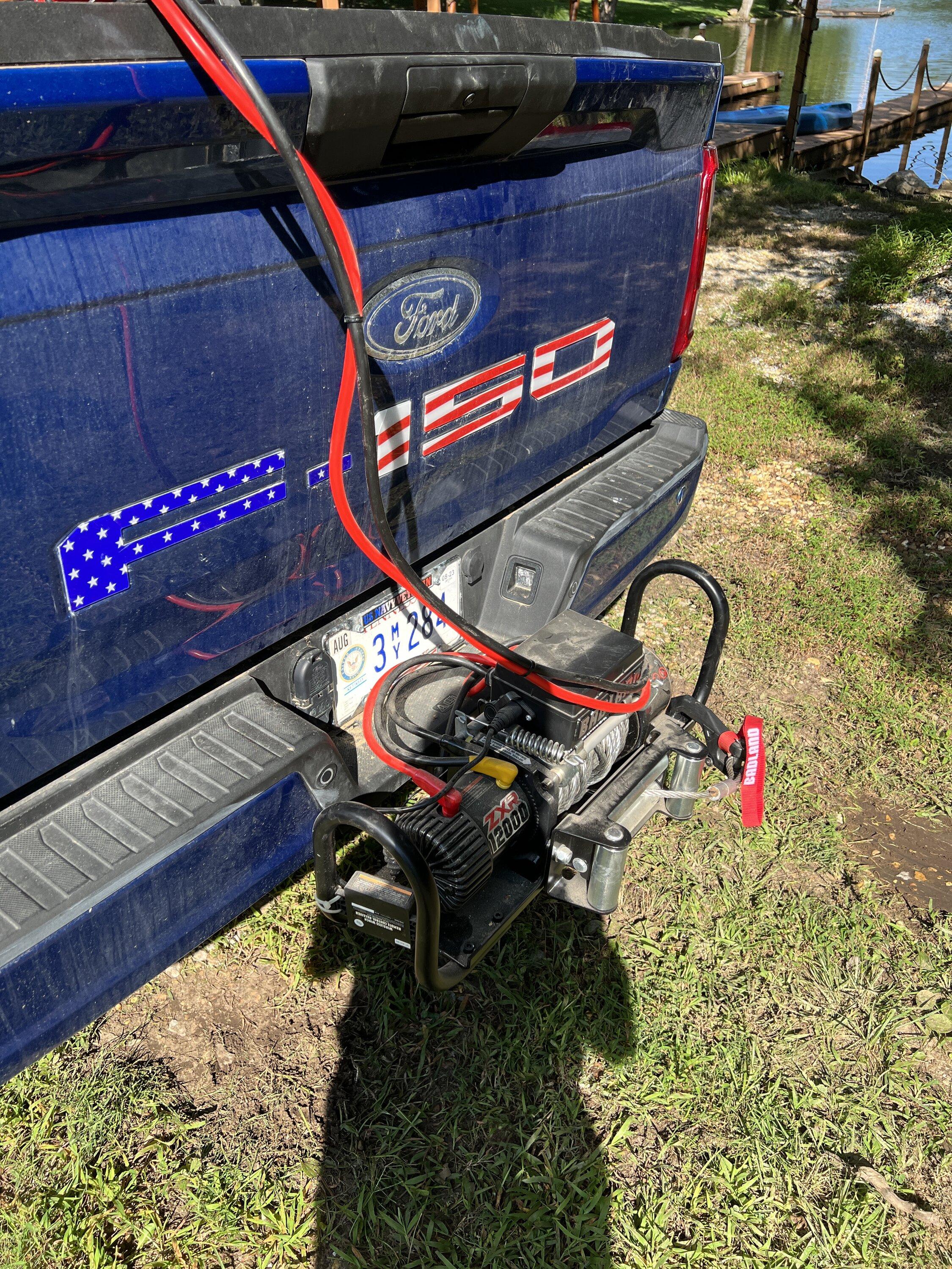

Alright I am trying to figure out which size relay to use to power a winch. Looks like I will be getting a 9.5K winch for the front. I want to power it off one of the AUX switches, so I will need a relay. The issue I am having is getting a real answer. I keep seeing isolators and new controllers, but not just a simple relay.
So what size relay (amps wise) and a source if you have one.
Anybody do this instead of running it straight back to the battery?
I have a setup like this on MY F150 for a portable winch or jumper cables. I might just go with it on the Bronco, but I want a clean install.

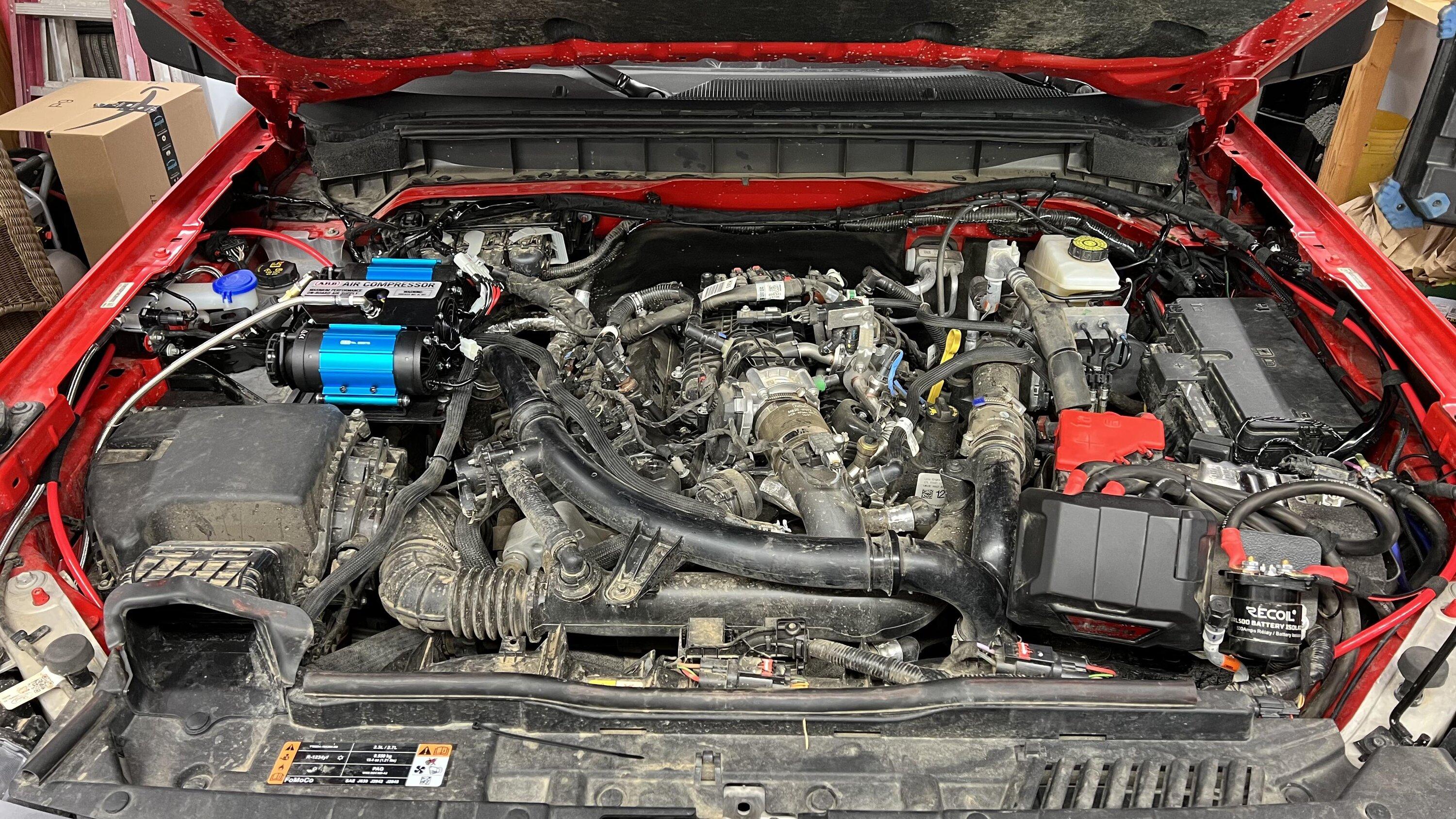

My 12K Warn Evo is rated for 396 Max Amp Draw. Once you know the max amp you choose the relay, I added a 100Amp buffer. I have the relay hooked to an Aux switch.
Edit: Added photo of my dirty engine bay, I spent a lot of time trying to keep the rat nest of wires under control.
Thank you! I'll be going this route also

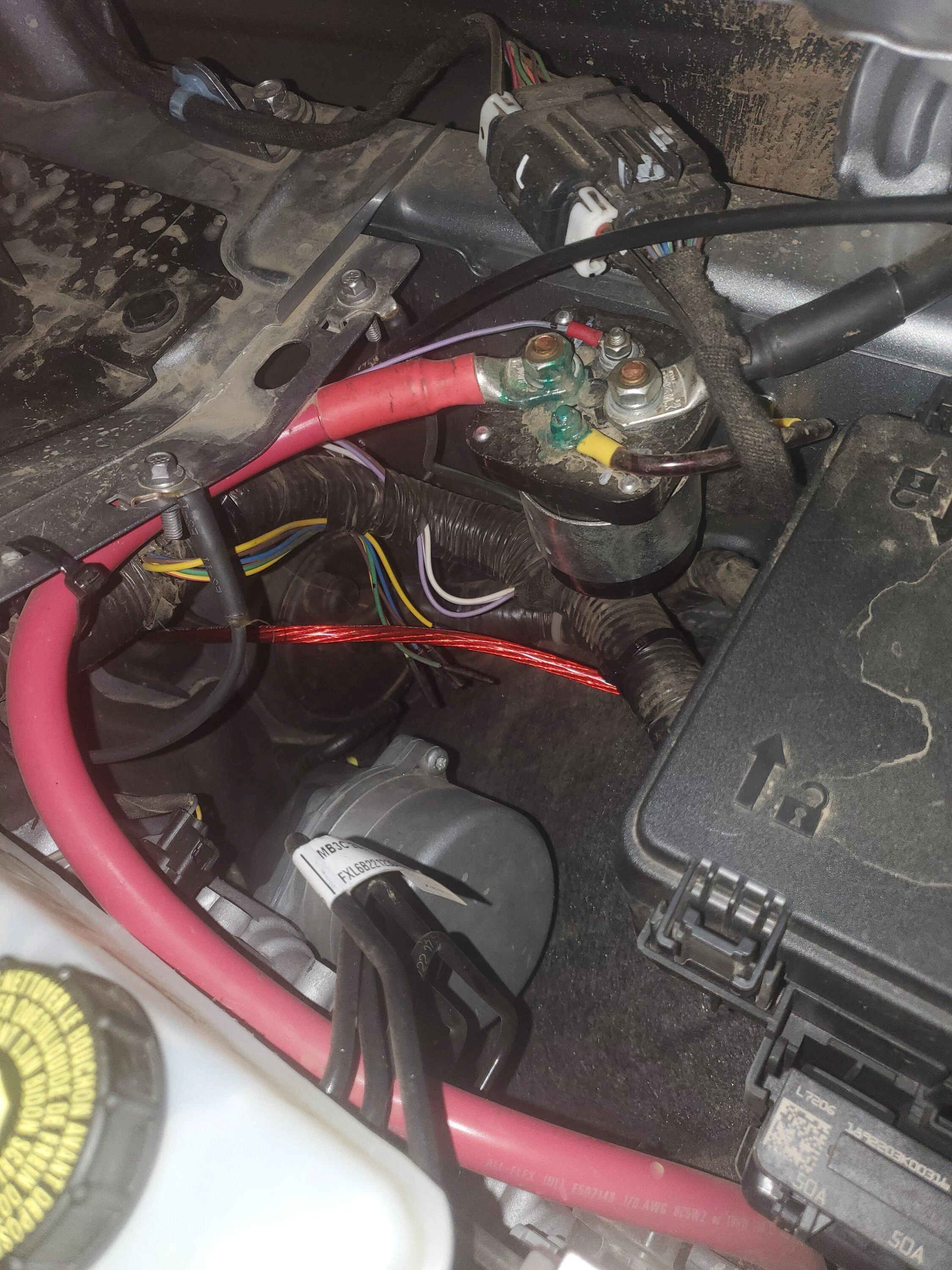

So the link to my post above shows more information, but just a toss in what I did..
