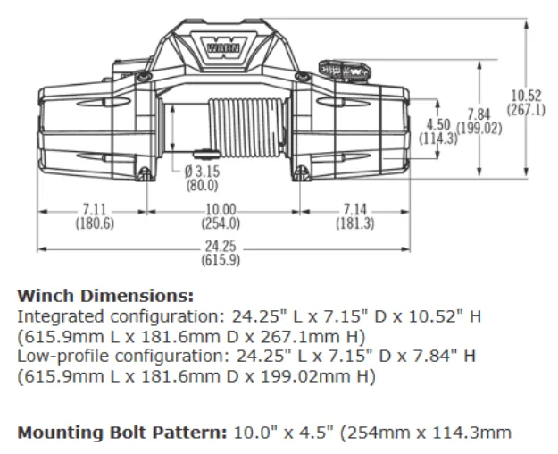

If the bumper is capable of fitting a Warn Zeon 10-S in it, then you can fit pretty much anything in there as the Zeon series winches are some of the largest on the market.
On our Bronco, I did a Superwinch SX 12K winch with the synthetic rope and I was very pleased with it.
The biggest thing to check would be dimensions.
Here's the Zeon 10-S specs:

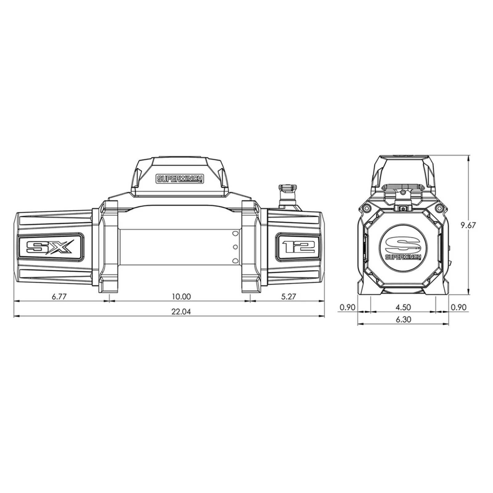

And just for grins, here's the Superwinch SX12SR Winch:
Ford Bronco What winch with ARB Summit bumper? e8a443a15f8b40ba507875e5cd133138
Based on the design and dimensions, the Superwinch 12K SR would fit with room to spare and you'd be able to get the full 12K capacity that you're after.

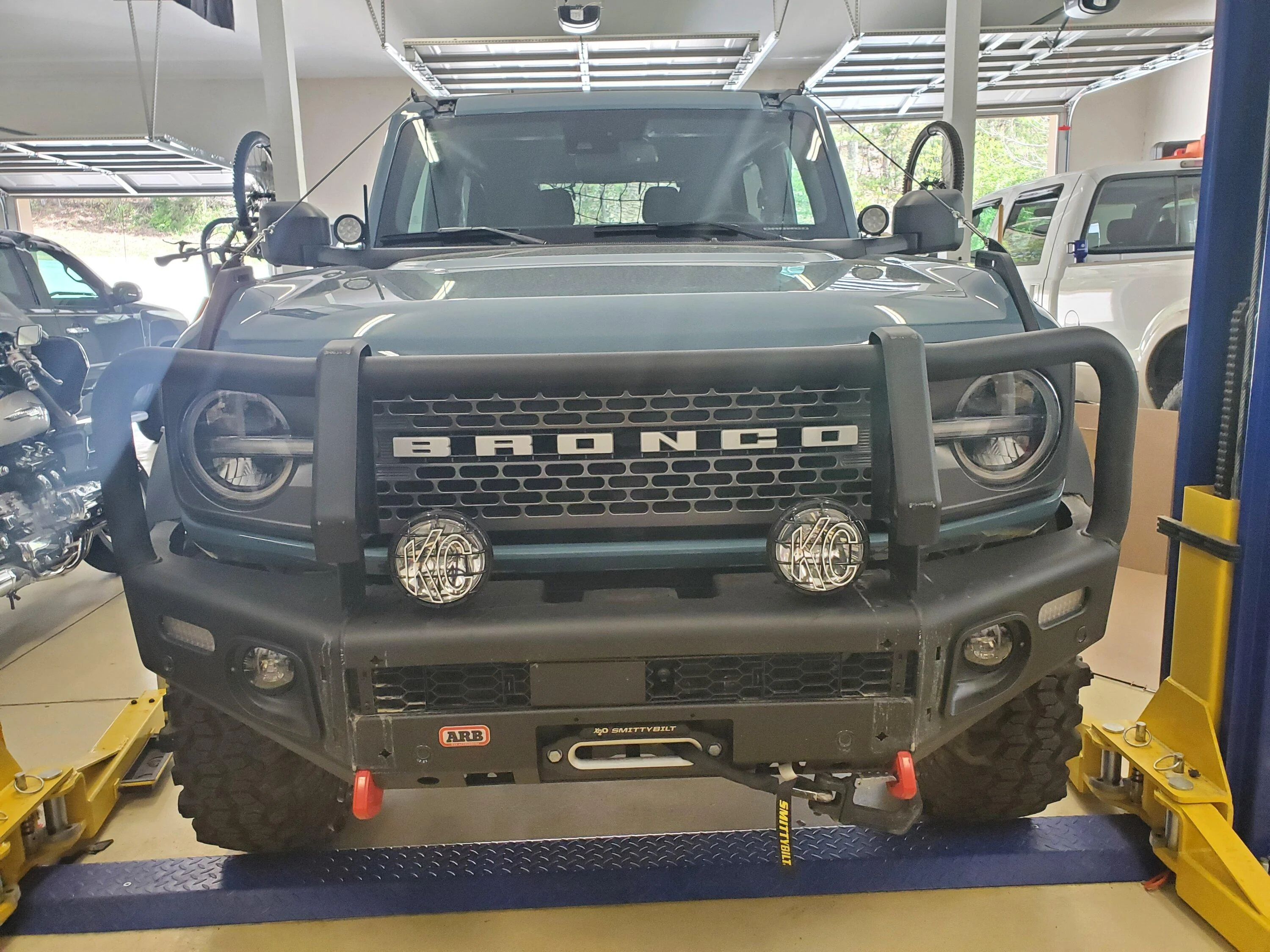

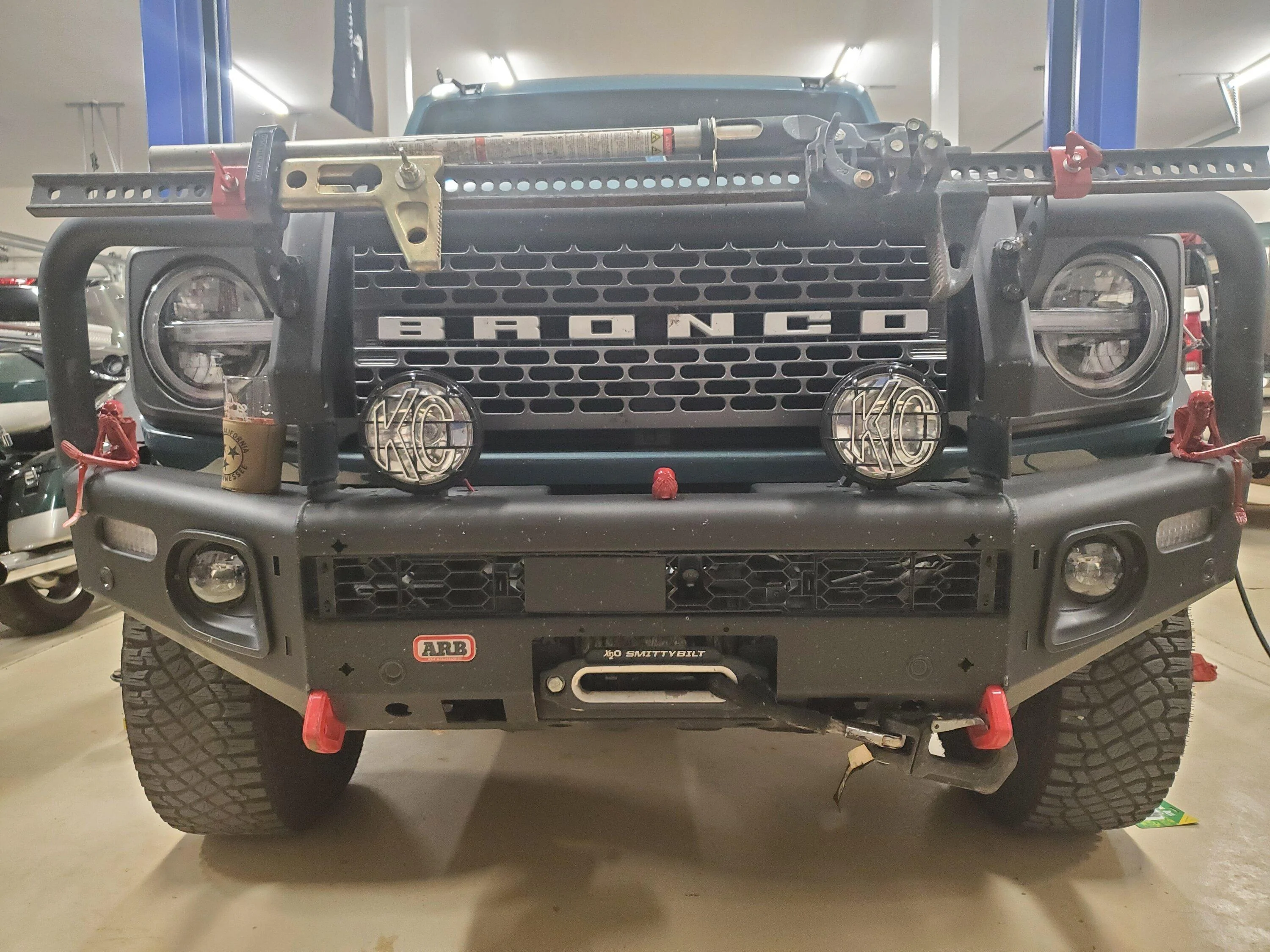

I've got the 12k KO2 in my summit, fits fine the spool in spool out is a bit hard to see, but not hard to reach, I'd say that'd be your biggest hurdle is the engaging disengage being seen plenty of room for any winch with a center based solenoid..

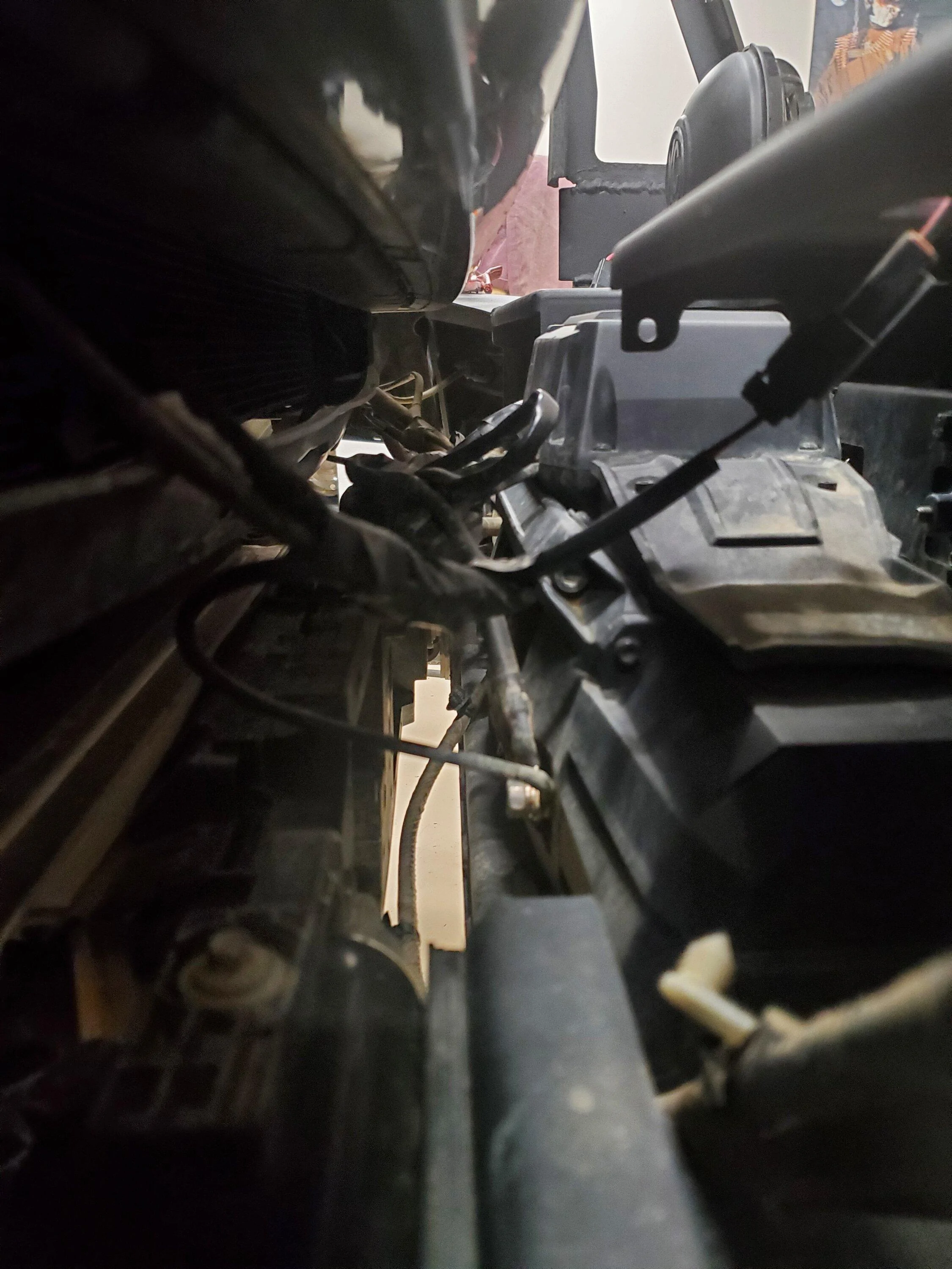

Quick question, does the winch block the intercooler at all? I have tried to research and get pics to see, but to no avail. Thx!
I have a 3" body lift, so mine is different than stock. I will get you a picture of mine after I get home. Of course there is no way to build a sturdy winch bumper without some restriction. I believe the ARB is the best compromise. The front is open where the plastic grill is reducing restriction of air flow.

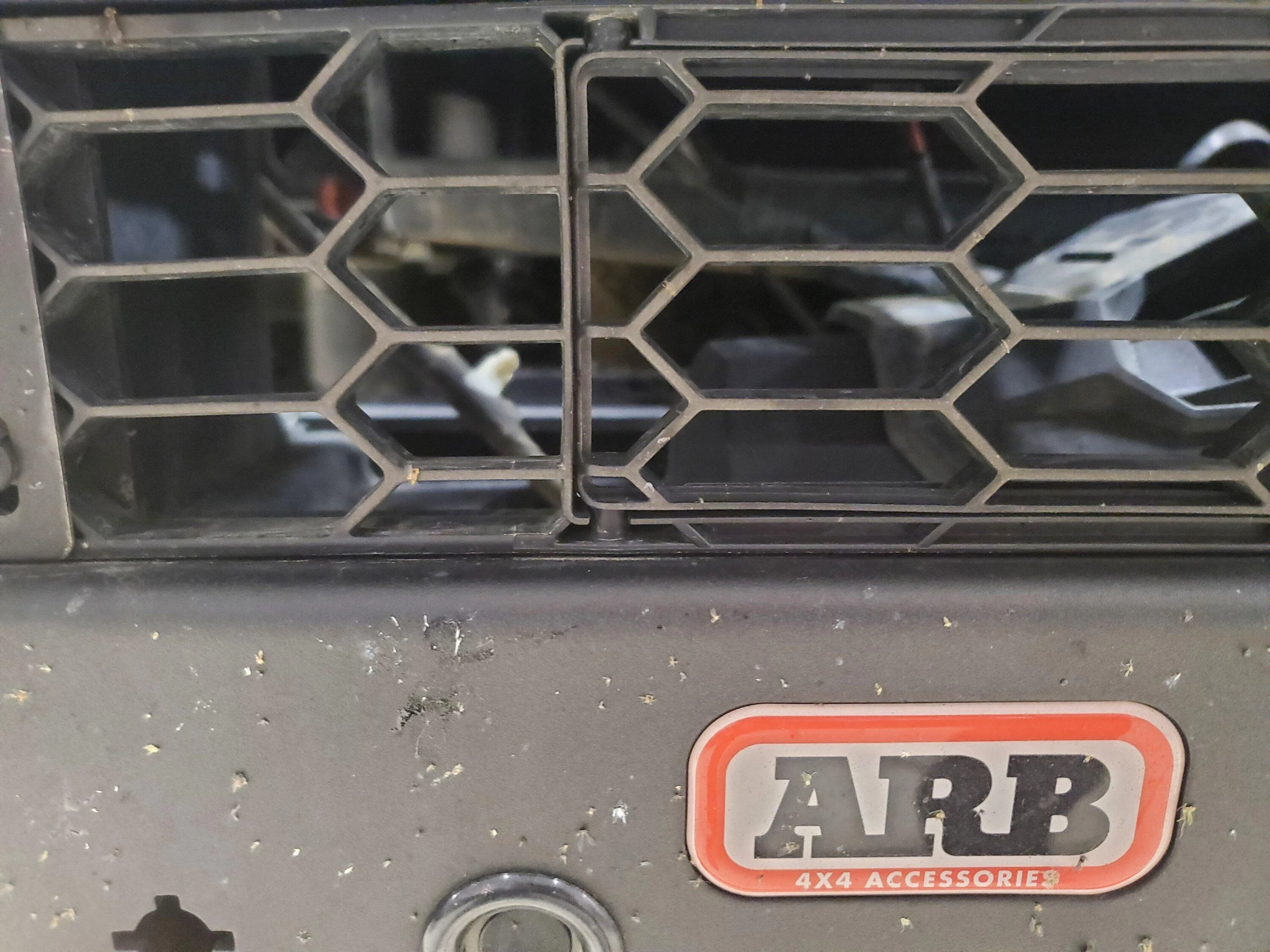

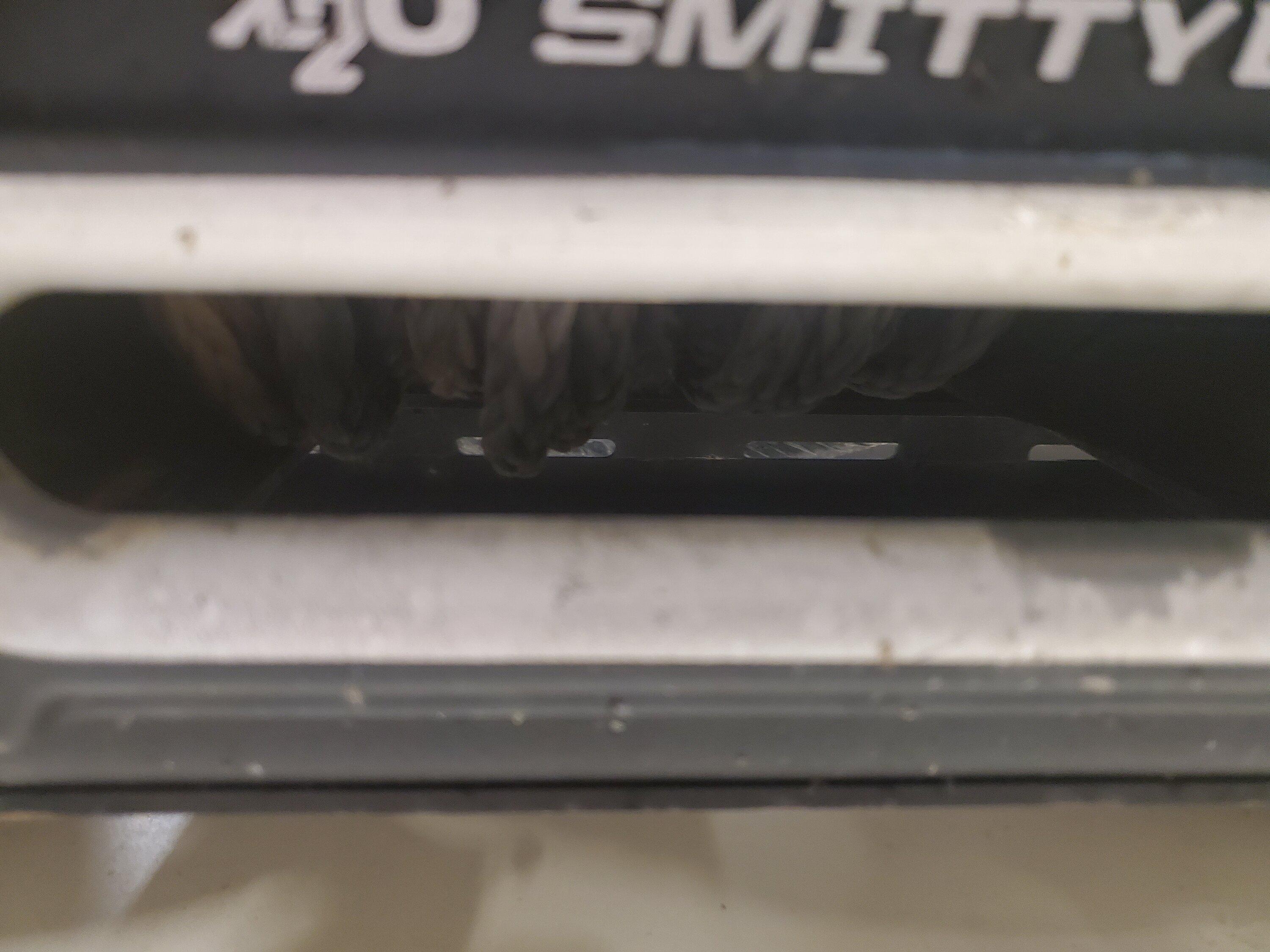

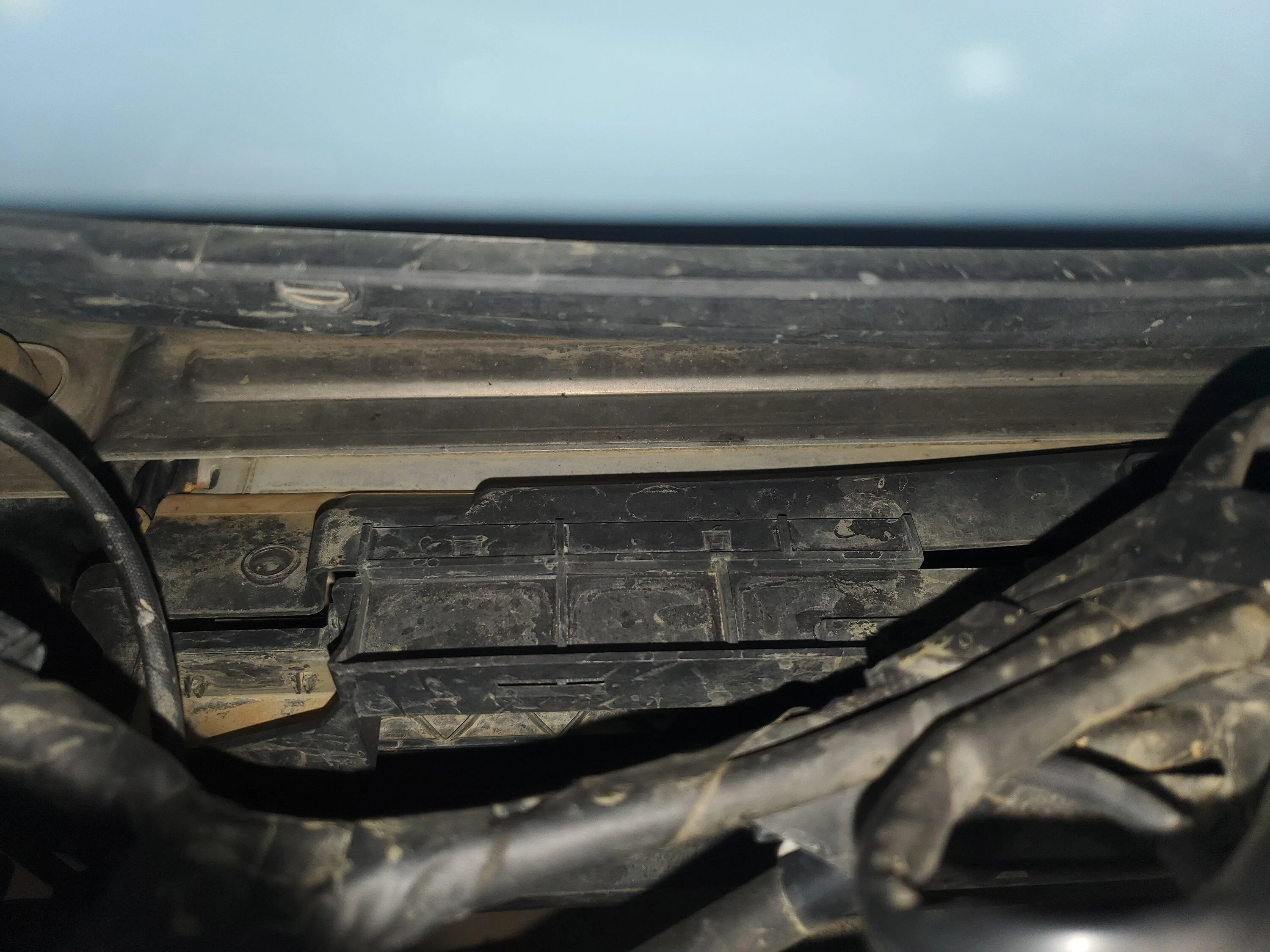

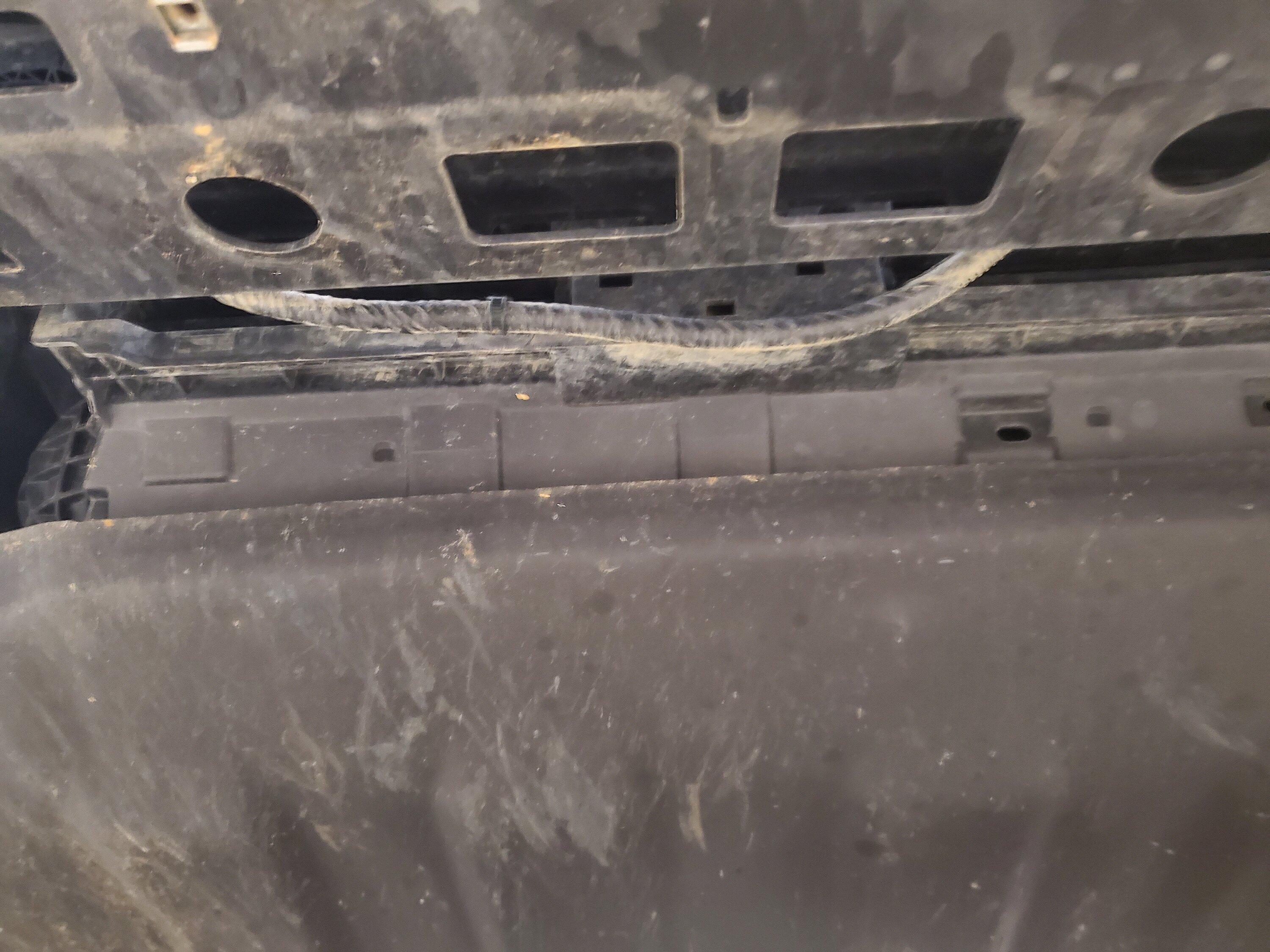

So it is hard to get a good picture. There is more space below my radiator and the top of the intercooler because of the body lift.
First picture is the holes they have in the bottom. Next I tried to get a birds eye view. Honestly the winch blocks more than anything.

The next two are of where air flows by the fairlead and the grills.
Ford Bronco What winch with ARB Summit bumper? 20231025_232937
Ford Bronco What winch with ARB Summit bumper? 20231025_232944
Okay, so there are air holes on each side of the fairlead? Correct? Like in the last picture?

Also, I reached out to ARB USA (they have pretty responsive CS), their reply was they state 10k because that’s the highest they tested it to. The Warn Zeon 12k and 10k are the same size physically.
