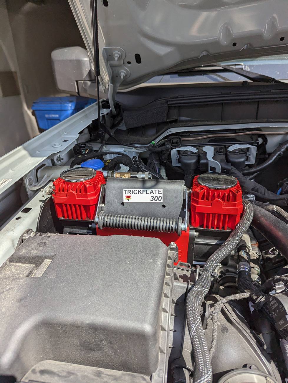

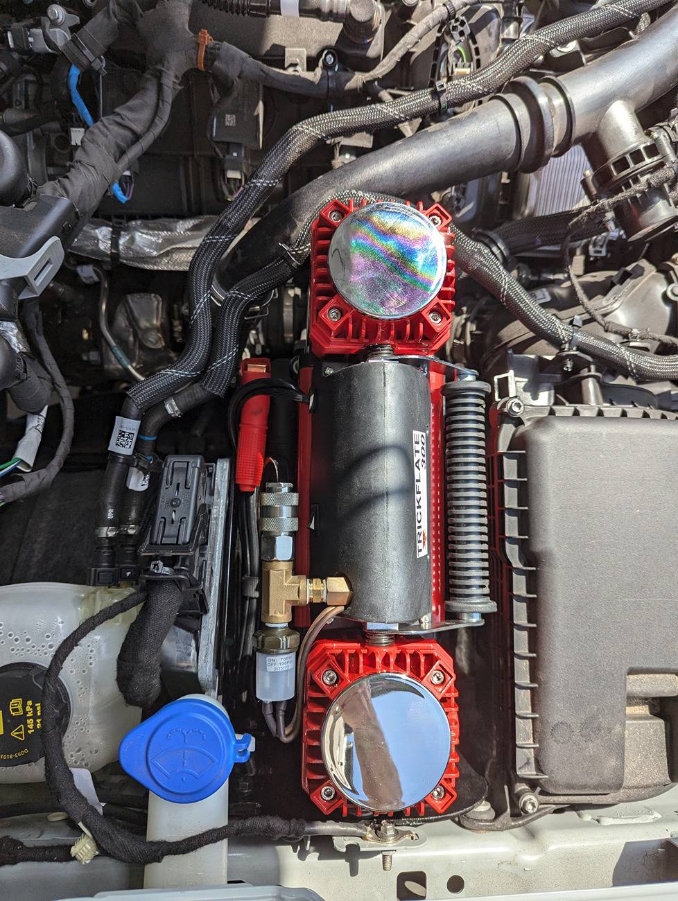

Just mounted my compressor under the hood and was thinking about the best way to power it. Thanks to this thread just purchased the Adventure Lab bracket kit, not sure which fuse to purchase for this air compressor? I don't think I need 400 amp worth of protection, any one know what I should use? I don't think the compressor will pull more than 90 amp, so maybe a 100 amp fuse?
Fuse has to be big enough to accommodate the amp rating of whatever you are running - which should be a spec of the equipment. So for your compressor - 90A is the given amps.
Then you want to add a bit of margin to that - because running amps and starting amps are two different things. It usually takes a bit of "umph" for electrical stuff to start - so it will surge a bit (totally normal) for start-up. If there is no given "startup current" - then I usually add about 25%. You don't want your fuse to blow every other time you start it up just because it has a totally normal high initial draw.
So - say 112A surge rating. (yes, in real life this can be much much higher, but it's also for a very short time, so you get into time delays and such - most of which is really is unnecessary for basic automotive electrical)
Now take that, and round up to the next standard size fuse. There are 120 and 140A fuses available as block fuses, and I see standard 120A and 150A inline fuses that fits most standard ANL-style holders. Any of those would be fine really - your preference. Could also pick a resettable circuit breaker, like a Bussman CB185-120.
Now - to complete this circle. Whatever size you pick for your fuse or breaker - that's what you have to size your wire to.
So you may only have a 90A compressor, but if you put a 150A fuse on there, you need to make sure the wire can handle 150A. We often say at work: Fuses protect wire - Loads protect themselves.
All of that said - your 100A idea would probably work fine too and you are onto the right track.

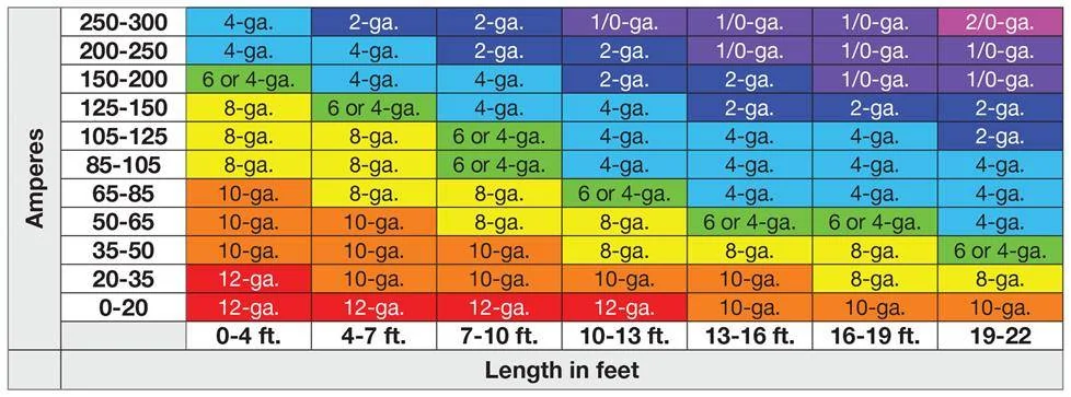

Keep in mind those nice charts are showing 1 wrap on the winch drum... This is not realistic. It rarely happens that you will pull loads with 1 wrap. Meaning you will have a higher load / amp draw for whatever weight you are pulling (most of the time - compared to the charts). And typically, your load will be increasing as you winch (winch ratio changing with additional wraps on the drum). Plus your voltage will be dropping as you winch (compounding the AMP draw).
Put a volt meter on your battery while running the winch (under load) for 30 seconds. Watch your voltage drop. Those charts don't specify what voltage for the listed load. The assumption is 12V. Yes, the alternator can assist to offset but it may only produce 150-200amps (depending on model). Battery voltage will drop with winching. As the voltage drops your amperage will increase.
I'd be careful adding additional complication into the system. The more connections the more failure points. The other thing I'd consider would be a high amp fuse. But keep in mind most fuses need about 20% buffer (400amp load = 480amp fuse) Fuse also needs to be rated for the "under hood conditions" (heat/water). You'd also want to carry spares.
The worst thing is your "safety" "protection" systems failing when you really need the winch. I've been in positions where the winch NEEDS to work and trail repairs are not feasible (think near roll over).
Keep it simple. Don't overthink.
Appreciate this experience and insight.
Didn't mean to mislead anyone with my charts. I created those when I was trying to decide what to buy and simply used the data the manufacturers give in their manuals, etc.
I do agree with you though. We get a pretty limited view of the technical data from all the manufacturers. At least Warn makes theirs easily accessible online. Some of them I had to call and request, which they did promptly respond but seemed like an unnecessary step. Generally speaking they all want to provide data showing the biggest/best numbers to help them sell more product. I get that but wish their was a nerd option that let you see the different layers, load conditioning, duty cycles, etc.
Speaking of duty cycles, Warn basically told me to pound sand. Said anything not industrial isn’t duty rated and recreational. This includes some of their more pricey models. One of the other manufacturers said they recommend running 30 seconds and then resting a few minutes before running again….but had no documentation and acted like I was pulling their teeth to get that info.
