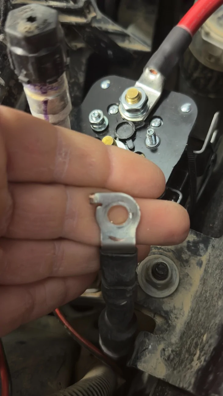

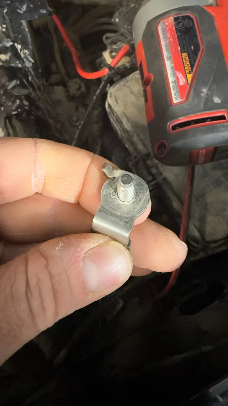

So I added two photo. The one with the post is the ground but the post measured at 1/4 and the other one measured at 5/16. So essentially I bored the hole from 1/4 to 5/16. Yes, I thought about just cutting this one off and crimping on a 5/16 connector but decided to see if this would work or not.

Looks OK to me. If you want to be sure, run the winch on a heavy load while touching the connection. If it's not too hot to touch you're good to go.

I took another look at your photos. I'd lose the split lock washer. They add resistance and don't really do anything. Just make sure the bolt is tight, not "farmer" tight and the cable doesn't move.
