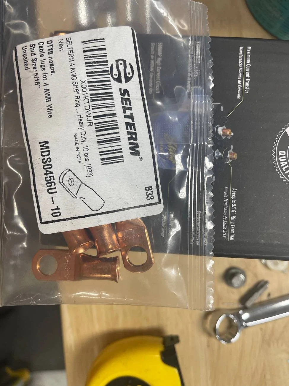

Nuts are 5/16 and 9/16. Not metric. Posts are 3/16 and 1/4. Box says large terminal accepts 5/16 ring terminal. I bought some copper crimp lugs on Amazon to terminate the cable ends. I used 4 awg wire same as Warn OEM kit.
Perfect, thank you!
One oddity I noticed, and maybe it’s just a typo, but a standard 9/16 bolt is supposed to marry up with a standard 3/8” bolt.
I saw in your pic you ordered and installed a 4 AWG terminal with 5/16” hole and clearly it fit.

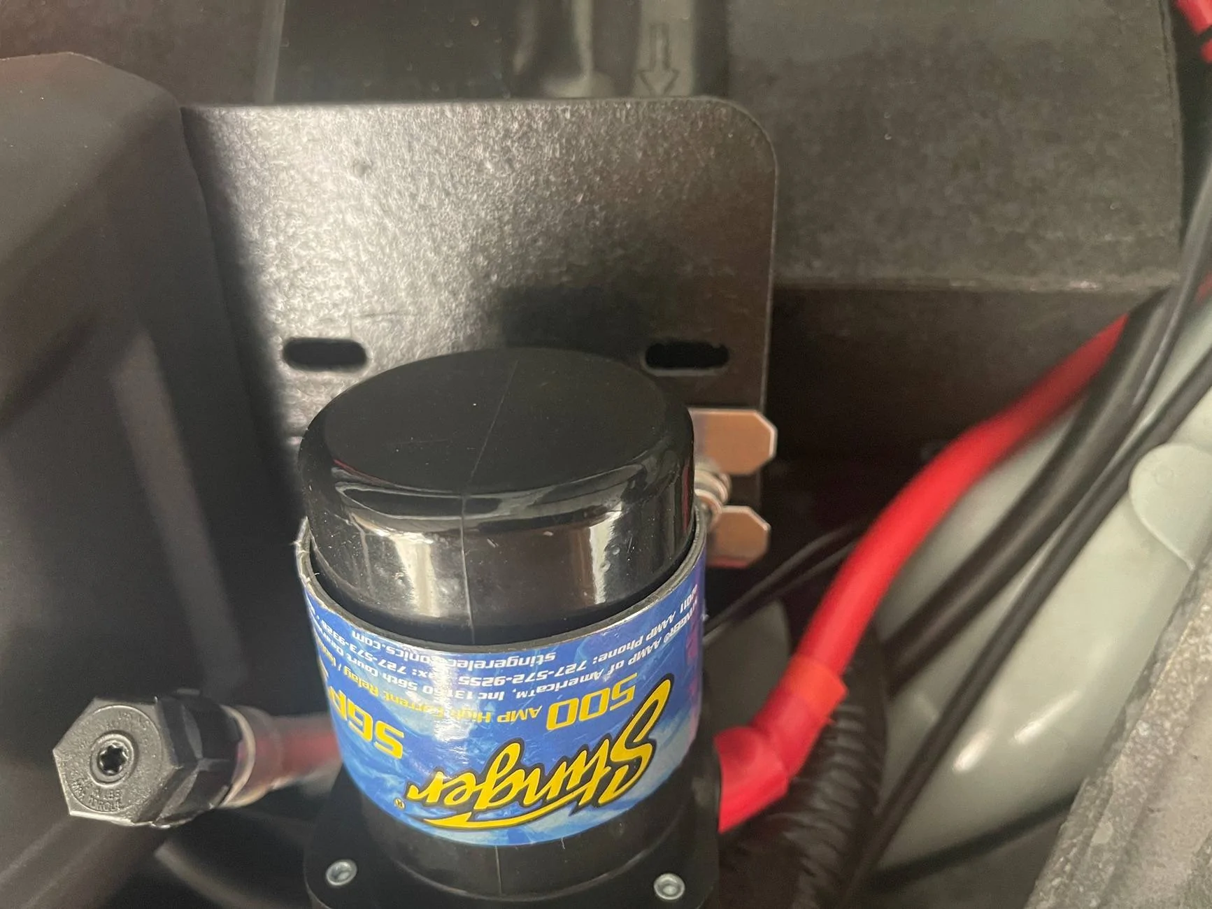

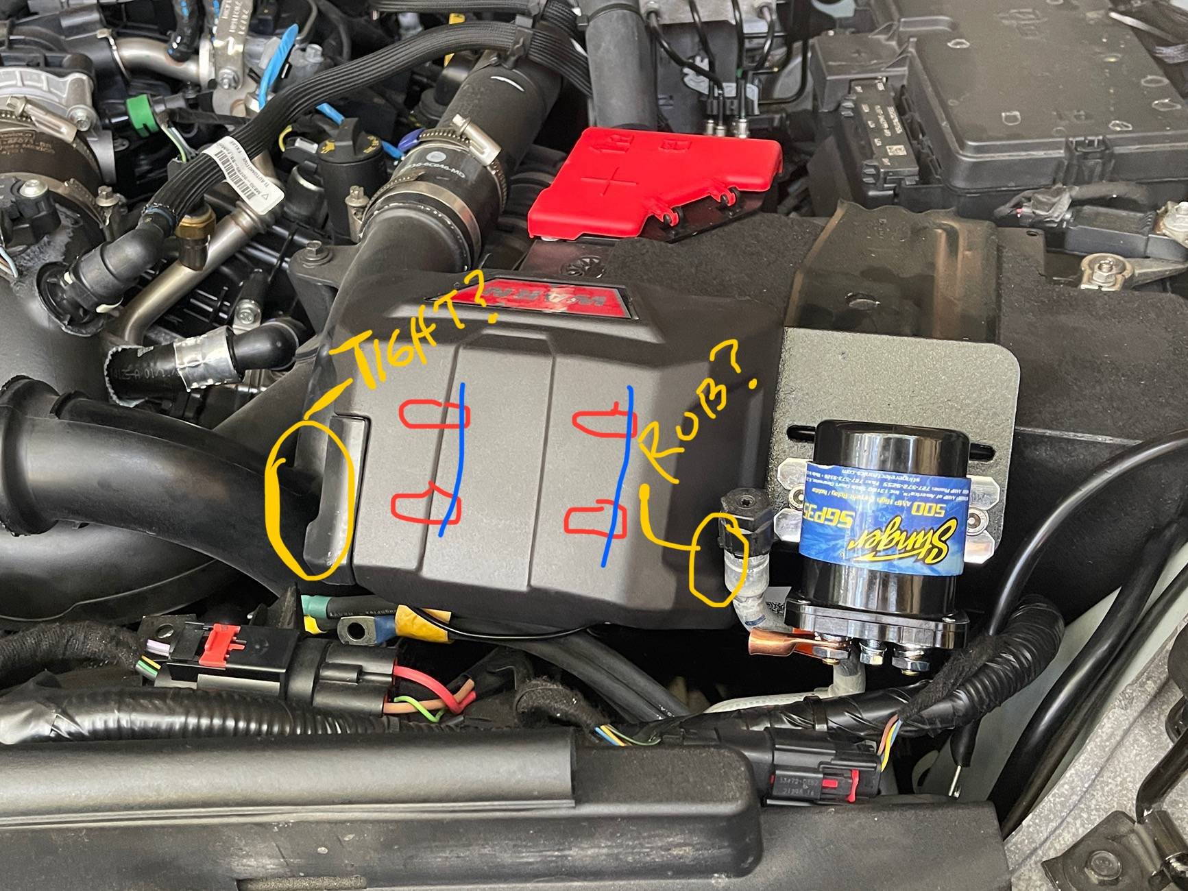

When you installed your bracket did you find the solenoid slightly rubbed on the AC line? I did a test fit (held bracket in place; didn’t bolt down) and things seemed tight.
When I mounted the solenoid to the bracket I optioned to move to the far right of the slotted holes. Obviously moving left a little will resolve the rub on the AC line, or make it a little better. However, I didn’t have much clearance on the charge pipes either so there doesn’t seem to be much wiggle room. Maybe when I get the bracket tightened securely it will shift a little and resolve those issues.
Also I’m assuming you installed both the solenoid and Stinger relay prior to tightening the bracket down? I didn’t try to tighten with a wrench but access seemed very restricted. Any tips or tricks?

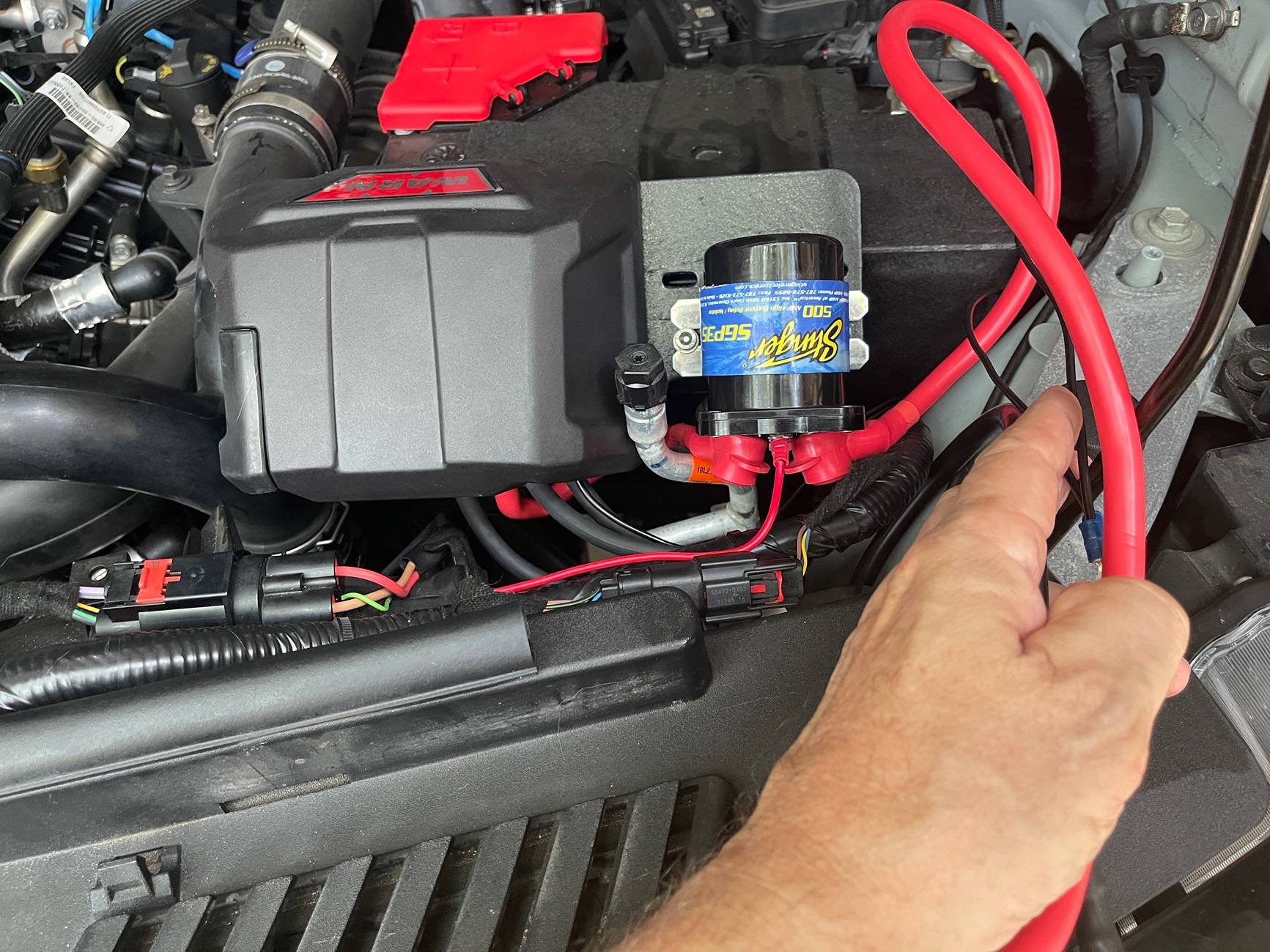

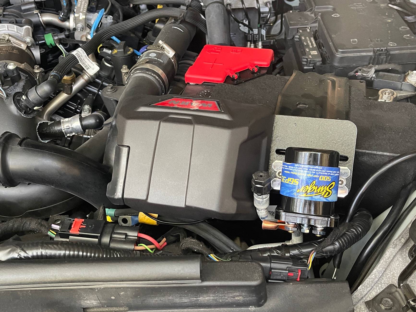

it was a tight fit. I had to drill new holes lower down on bracket and installed rivnuts in those holes. You can see it hangs over on right. Otherwise solenoid hit hood, i have hood insulation panel. I don’t recall if bracket had elongated mounting hole but it would give a bit more to right if you filed it that way. Zero clearance between cover and intake tube. Since i used rivnuts, i mounted bracket, then mounted solenoid with wire lugs already attached. Cable to controller is tight on ac line. I thought about sanding some clearance on cover for intake.

Or anyone else that has a physical Stinger 500 amp relay in hand….what are the two screw sizes on top?
The primary power bolts look larger, M8’s maybe? The switch bolts are smaller, maybe M5 or M6’s?
Alternatively if you know the nut/wrench size then I can work backwards.
Trying to make sure all my ring terminals for various wires are properly sized before I hit the buy button.
I used 5/16 lugs.

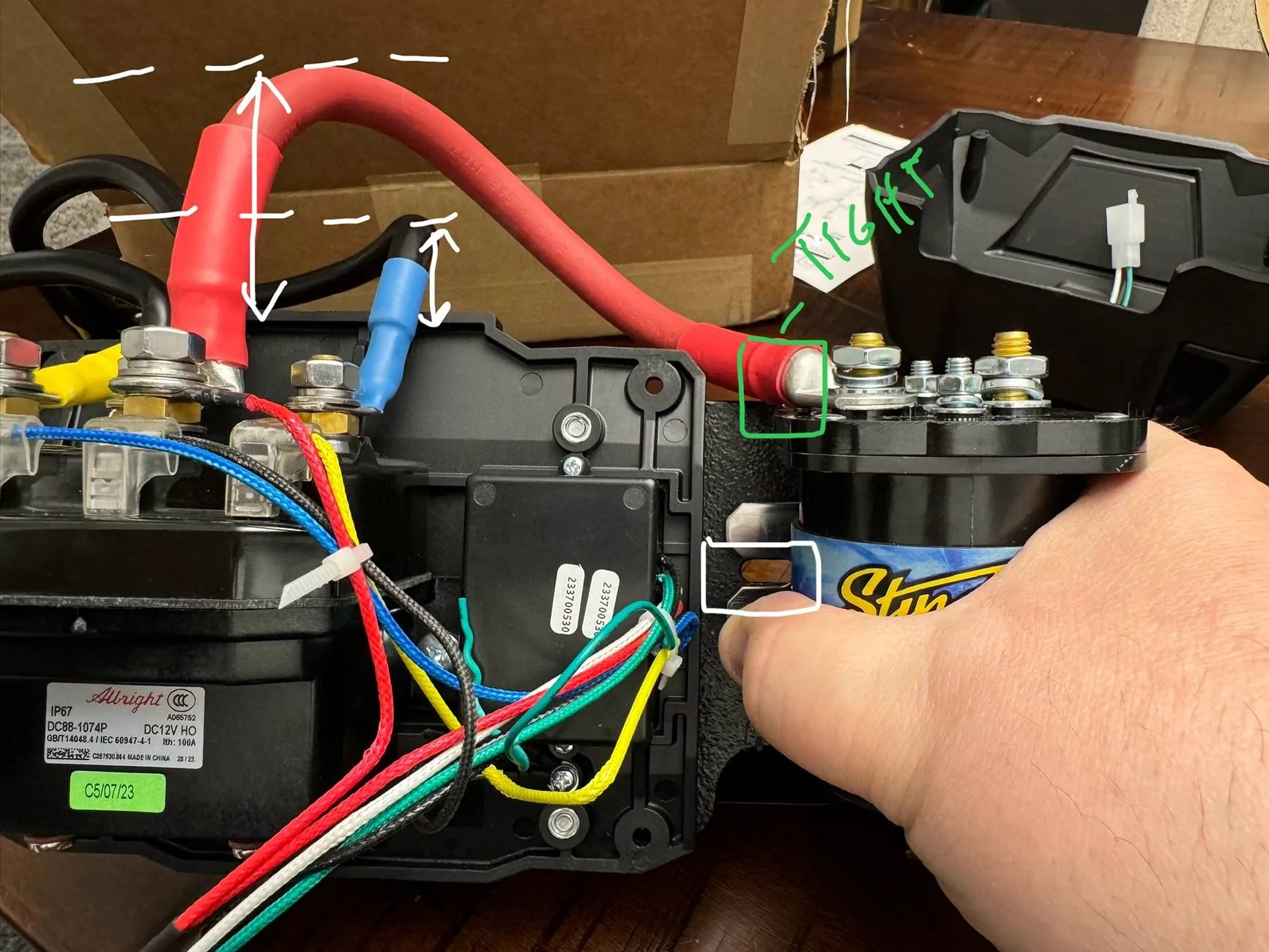

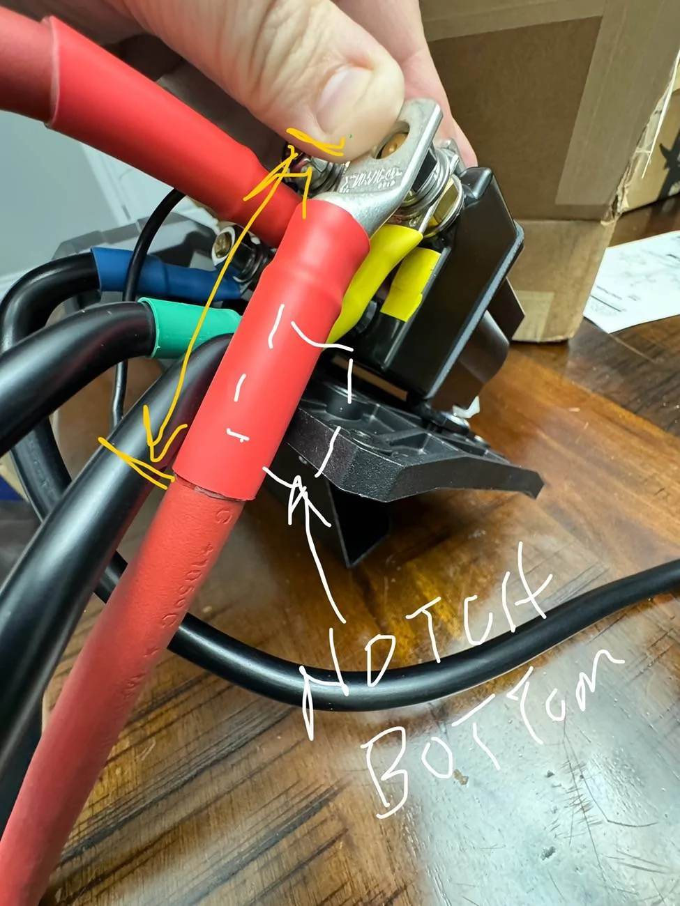

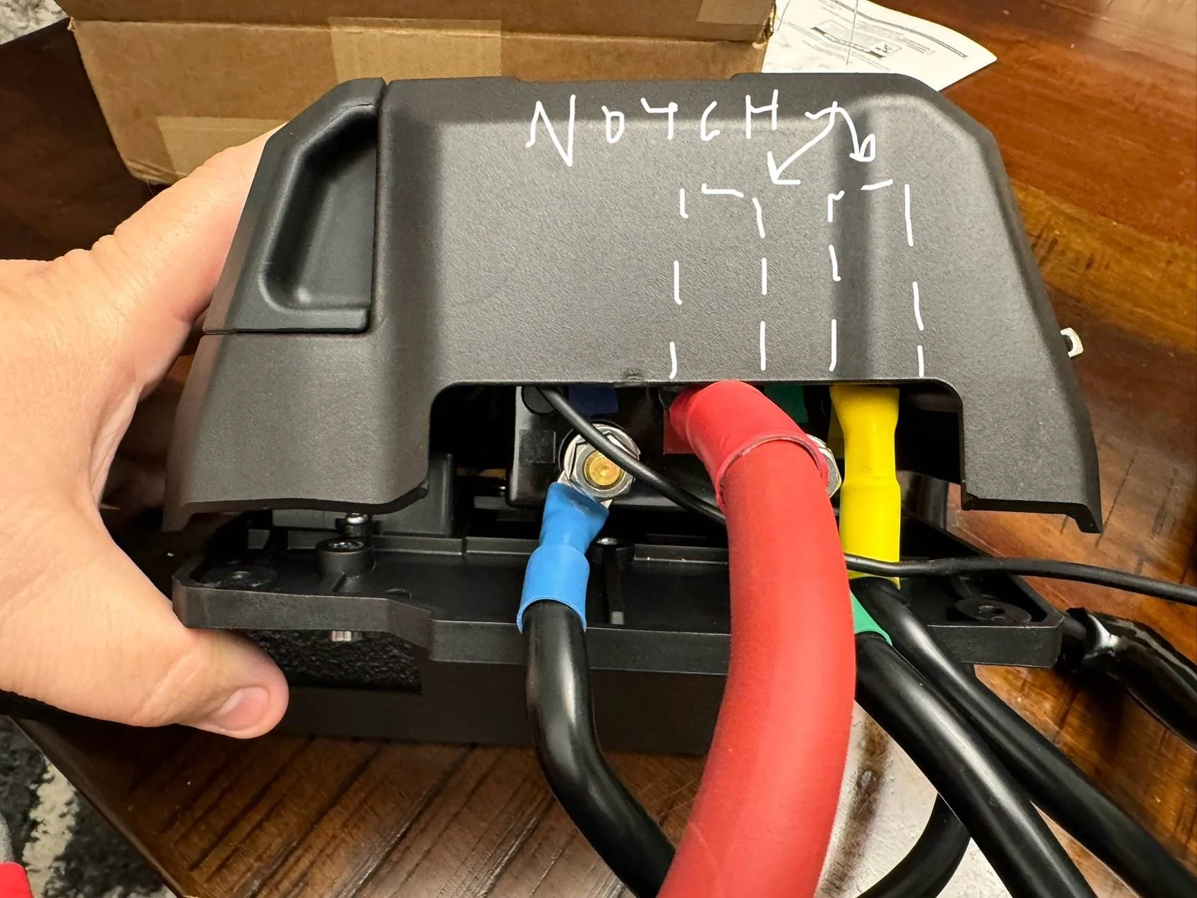

Anyone use 1/0 wire when doing the relocate? I’m having a bear of a time with mockup fitment. I got one end with 90 degree lugs and the other with normal flat lugs.
The issue on the red and yellow wires are they sit higher. With the 90 degree lugs the controller cover doesn’t fit. Easy solution is notch the cover so it works.
Ford Bronco Switch or Solenoid for Winch IMG_1584
If you use the flat lugs you can’t position the terminal on the screws because the heat shrink is too long & stiff (lol, what she said) to bend back out meaning you would need to notch the bottom/base of the controller for fitment. This likely gets complicated because the metal BAMF bracket would likely also interfere and you would be notching by one of the screws that holds the controller base to the BAMF bracket.
Ford Bronco Switch or Solenoid for Winch IMG_1586
Perhaps a 45 lug would be best but I didn’t see an option for those. Still not 100% you wouldn’t have to notch but if so, it would be a smaller notch.
I’m okay with notching the controller cover (not base/bottom) but even if I do that, the 1/0 wire is going to stick further out the back before it bends down. Meaning there is a higher likelihood of rubbing the hood.
if the hood clears the controller wiring, the next obstacle will be be landing the lug on the Stinger relay. Using the flat end of the cable this forces the install of the relay up using the predrilled holes in the BAMF bracket as the lowest point you could mount. All the pics I’ve seen, the mounting bracket of the relay was moved BELOW the predrilled holes. To shift that down I would need a 90 degree lug on that end.
Dang man. What a pain. Not sure what I’d do without seeing it in person. Easy to come up with an idea but then it needs to be completely revised once you open the hood. Just did that with ours where some items took up more space than expected.
