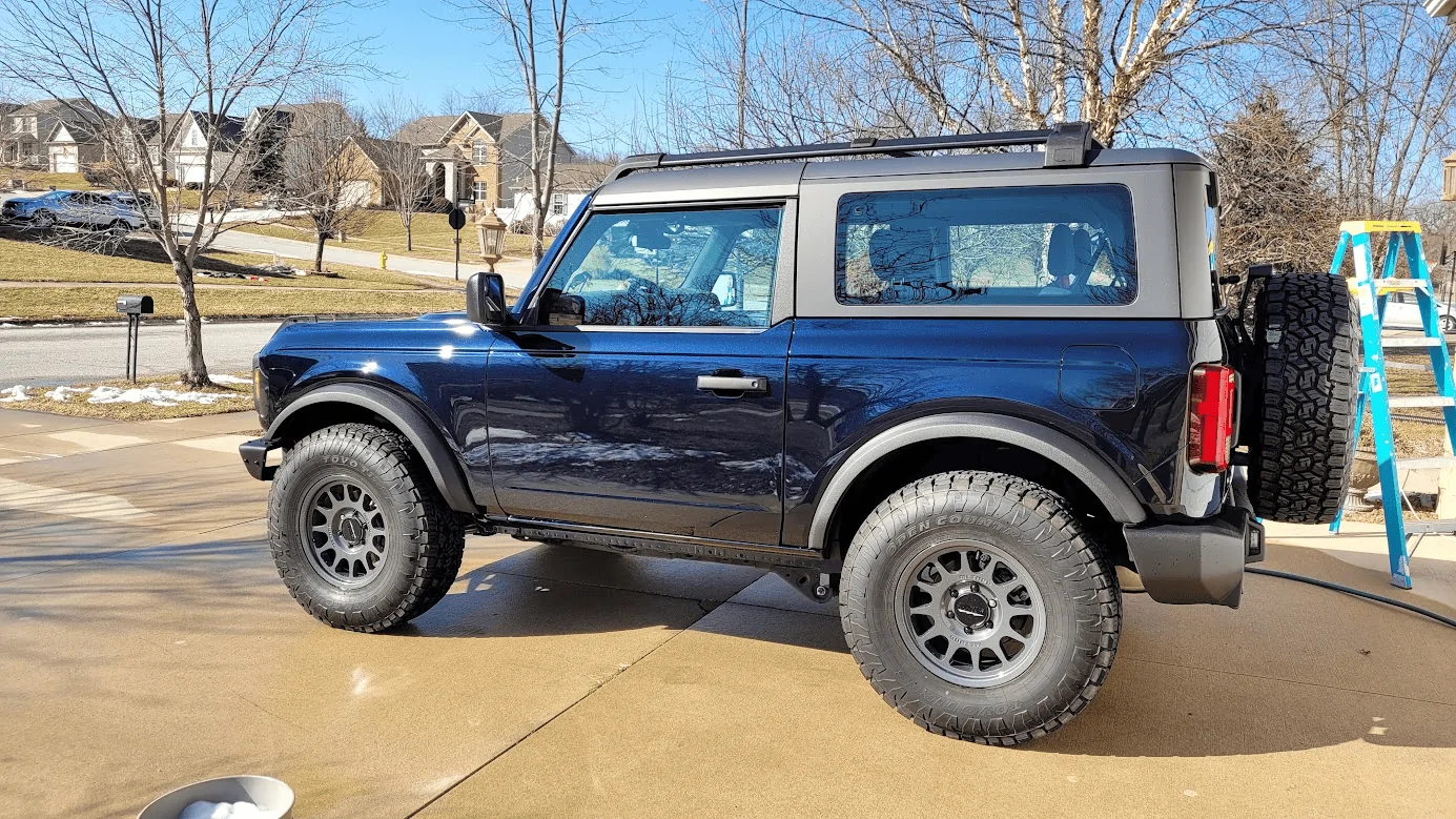

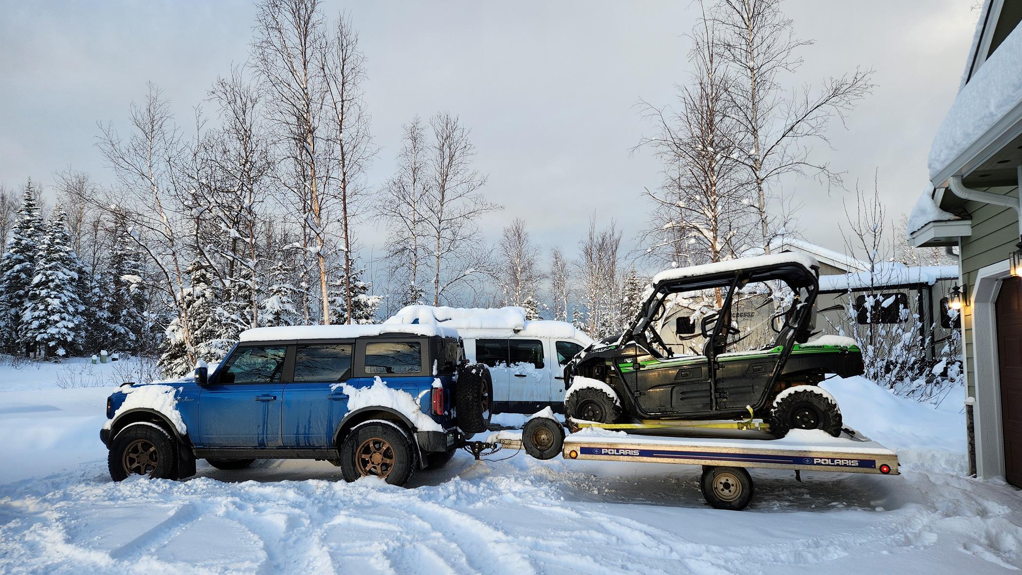

Seems like you've never heard of longer tow bars, or extensions.
(^^^^ Posts picture that literally has zero context to his comment, other than typical B6G bro braggartry)
:wink:
Ford Bronco What genius at Ford? 1716741761581-
HoosierDaddy
__ Eric
Mar 6, 2016
6,424
16,749
Indiana
Would love to see a picture of this. I am struggling to understand the problem. I cant imagine you wouldn't need some drop anyway given the height of the bronco. The trailer is supposed to be level to ride right anyway.

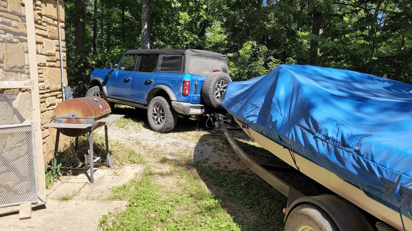

There is not enough room between the spare tire and the ball to get a normal trailer hitch under there with the locking handle in the up position .... unless you use a 3" to 4" drop hitch.
Something like that, I'll have to check what drop I ended buying for my factory Badlands on 33's ... might have been 3 1/4 and then it just BARRRELY cleared.
2" was a no go, had to put the spare in the trailer.
The same happens with both the base Base with 35"s (added) and the Badlands on 33's.
Another option might be to get a spare relocator bracket that raises the tire a couple inches.
Also, at whatever drop I ended up with, the trailer jack almost couldn't rotate down because it was so close to the ground.

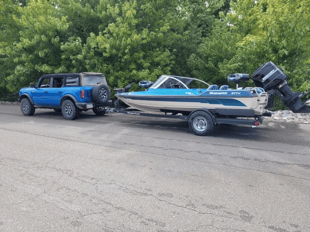

pic of Badlands & 2" drop.... I believe.
Ford Bronco What genius at Ford? 1716742453276-7u

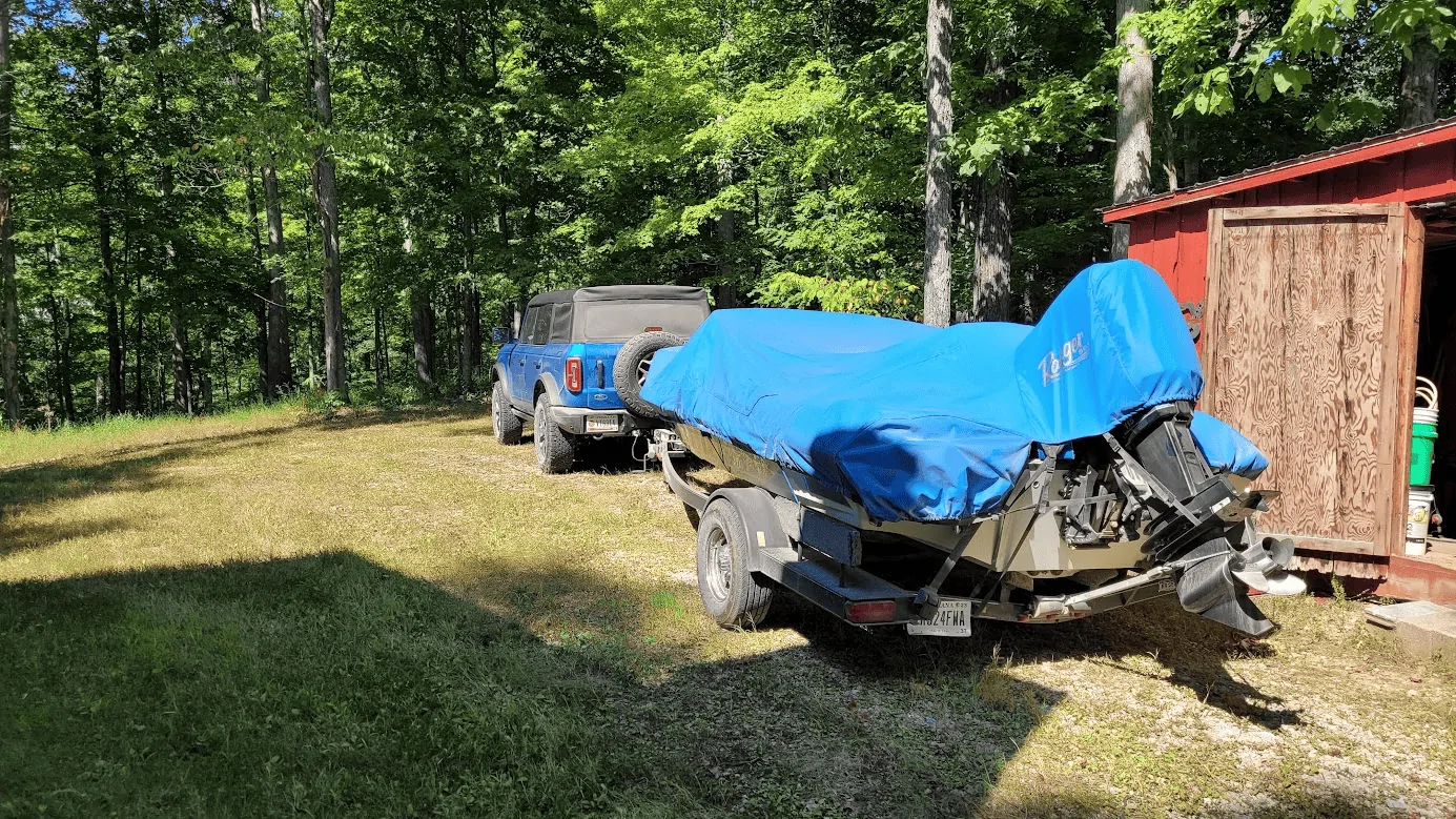

Idk what you are pulling but every boat trailer Ive towed with my Bronco has required taking off the tire so the safety pin doesnt hit the tire/bottom of tailgate
I'm confused. Does your safety pin go in vertically or horizontally?

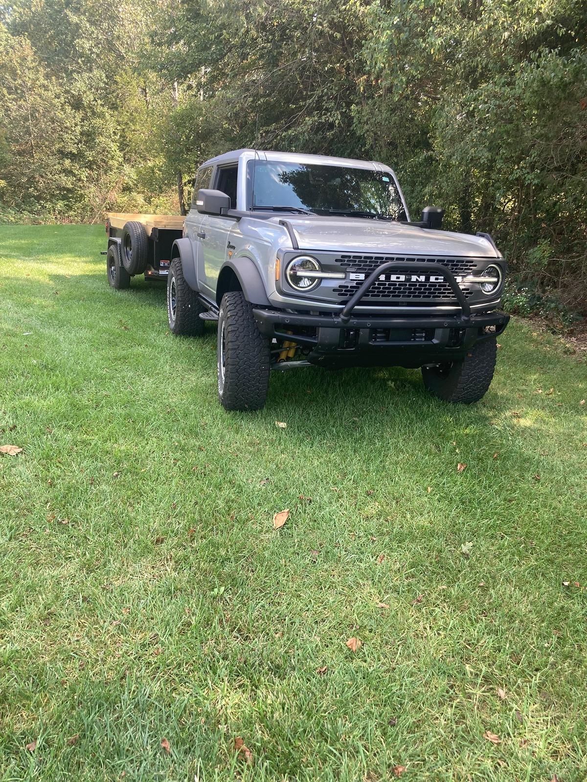

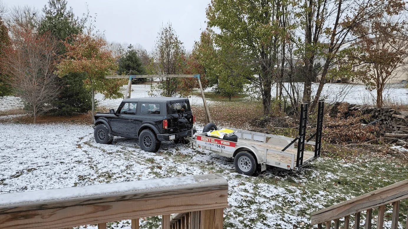

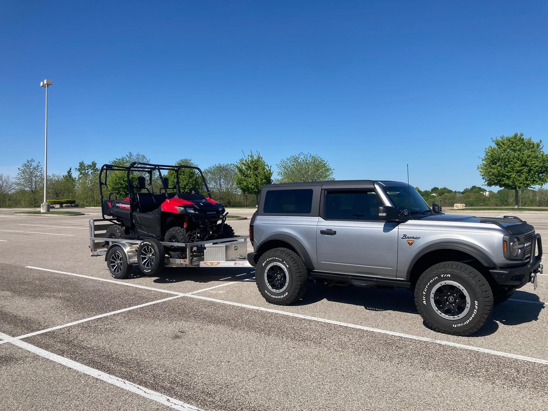

I use the standard hitch with the common 2” drop…I would need at least a 4” drop to be fine but at that point the trailers will be pointing down which is a no no

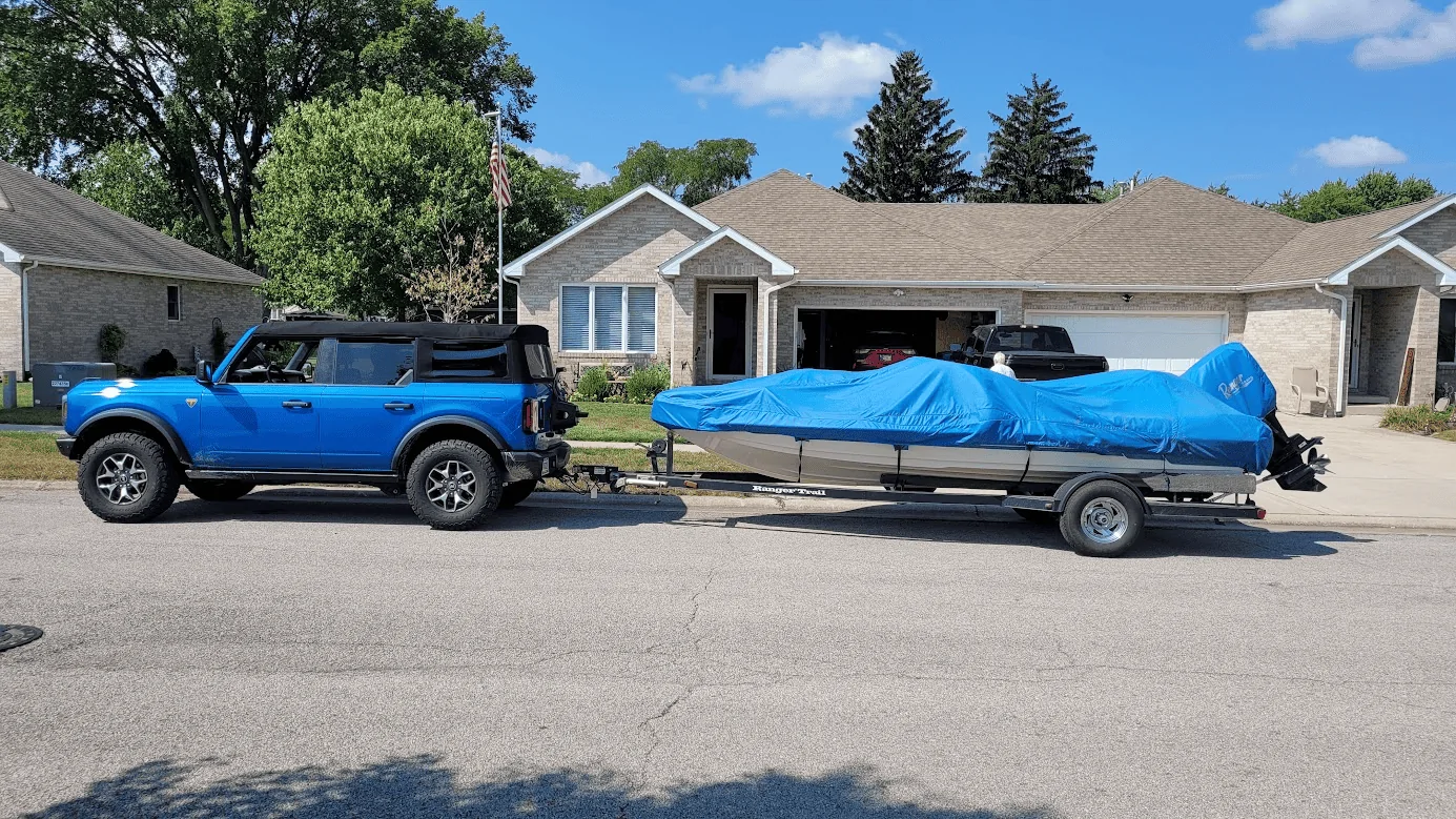

I have a 6 inch drop and my utility trailer and my dump trailer both just fit under the tire and they both have a slight upward pitch to the tongue of the trailer.
Ford Bronco What genius at Ford? IMG_0025
Ford Bronco What genius at Ford? IMG_9553

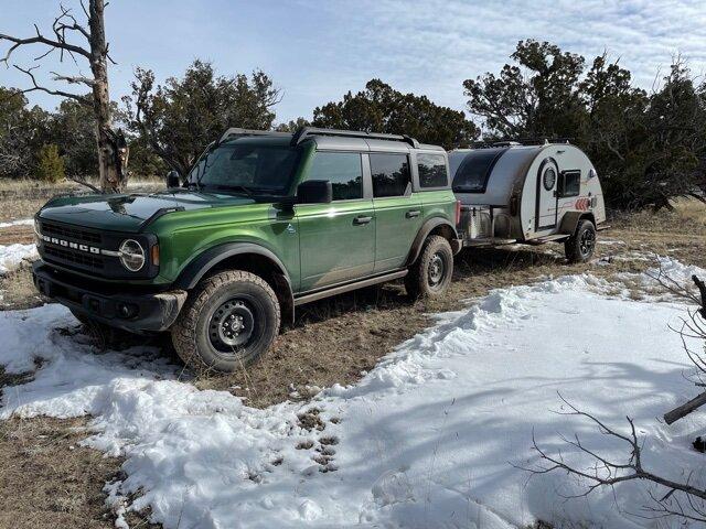

I have a buyers adjustable hitch, works great on the Bronco.
Ford Bronco What genius at Ford? 20231217_131249

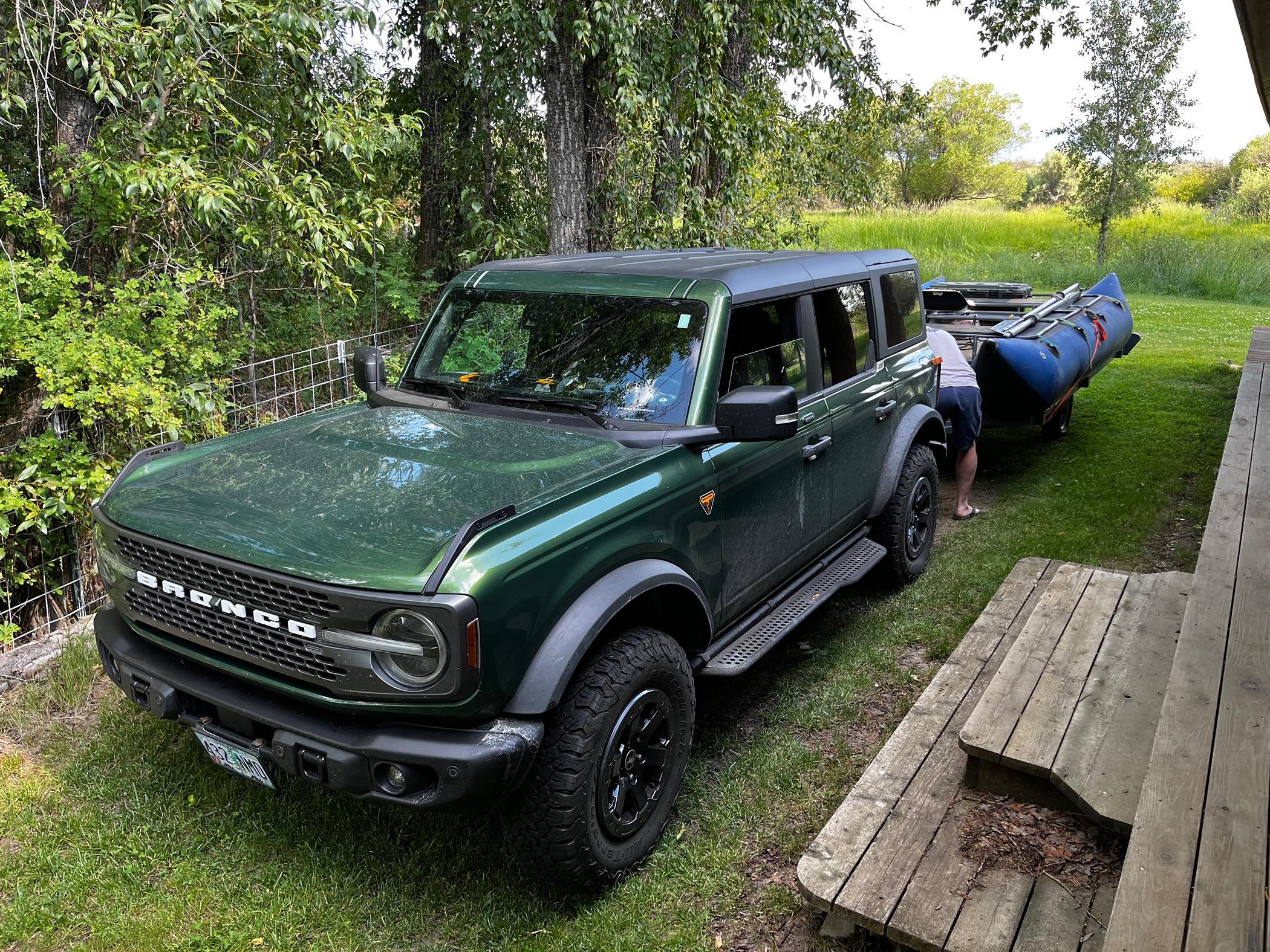

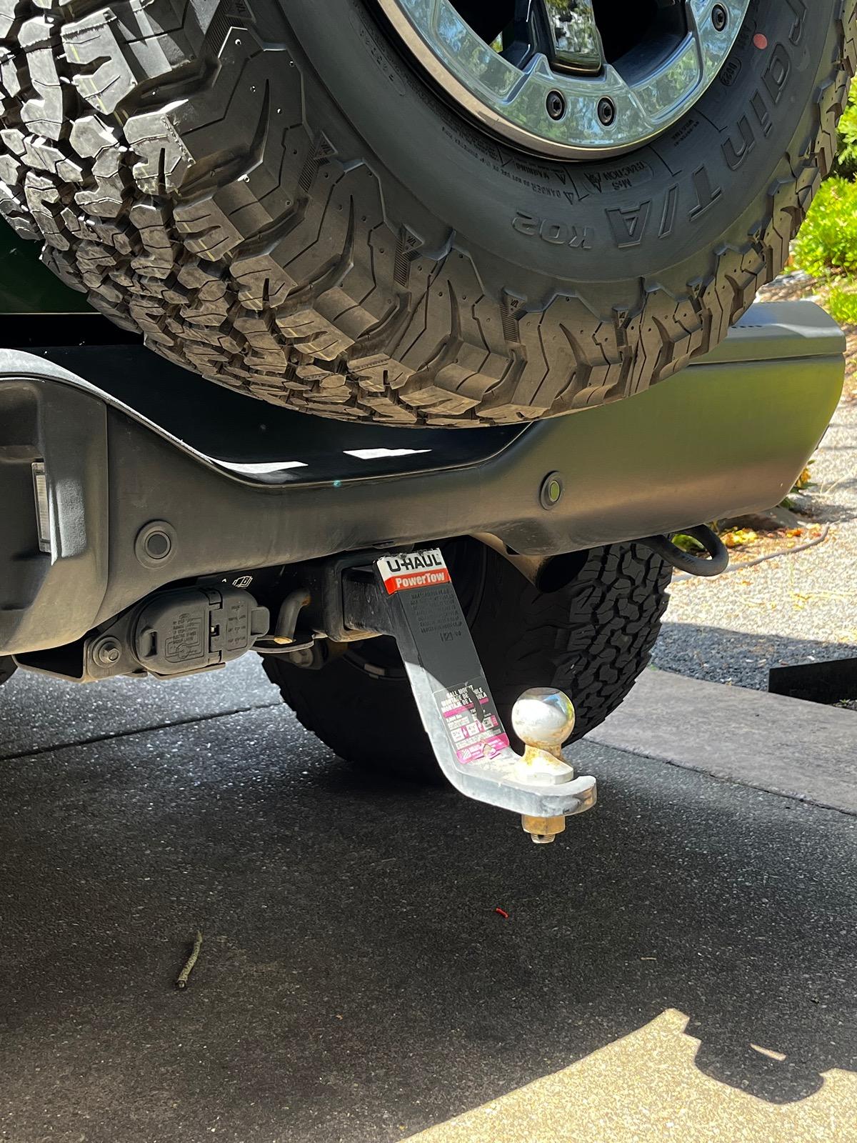

This is what I put on my BL. Works fine. Found it at U-Haul for $24.95.
Makes pulling a boat easy-peasy.
no clearance issues at all with the standard spare tire. Will add a photo with the boat trailer attached if I can find one.
Ford Bronco What genius at Ford? IMG_3632

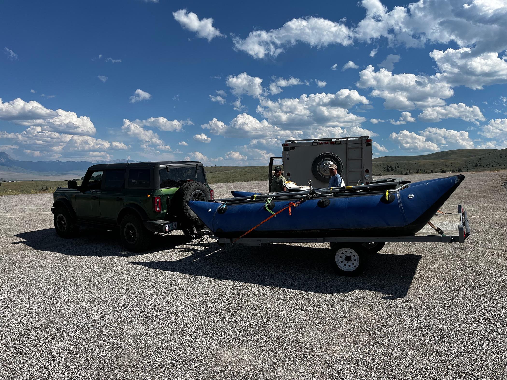

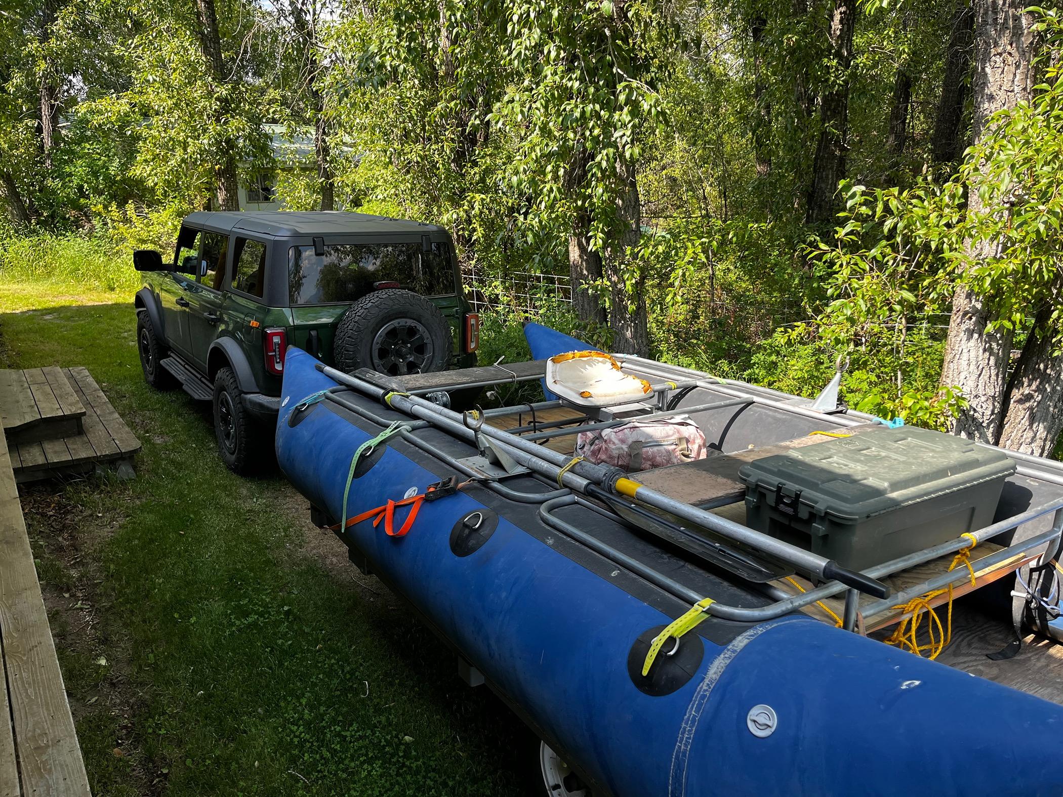

Here are some pics I found from last summer pulling a trailer with a river float rig. Again not an issue at all hooking it up. 2 min tops.
Ford Bronco What genius at Ford? IMG_9561
Ford Bronco What genius at Ford? IMG_9560
Ford Bronco What genius at Ford? IMG_9558
