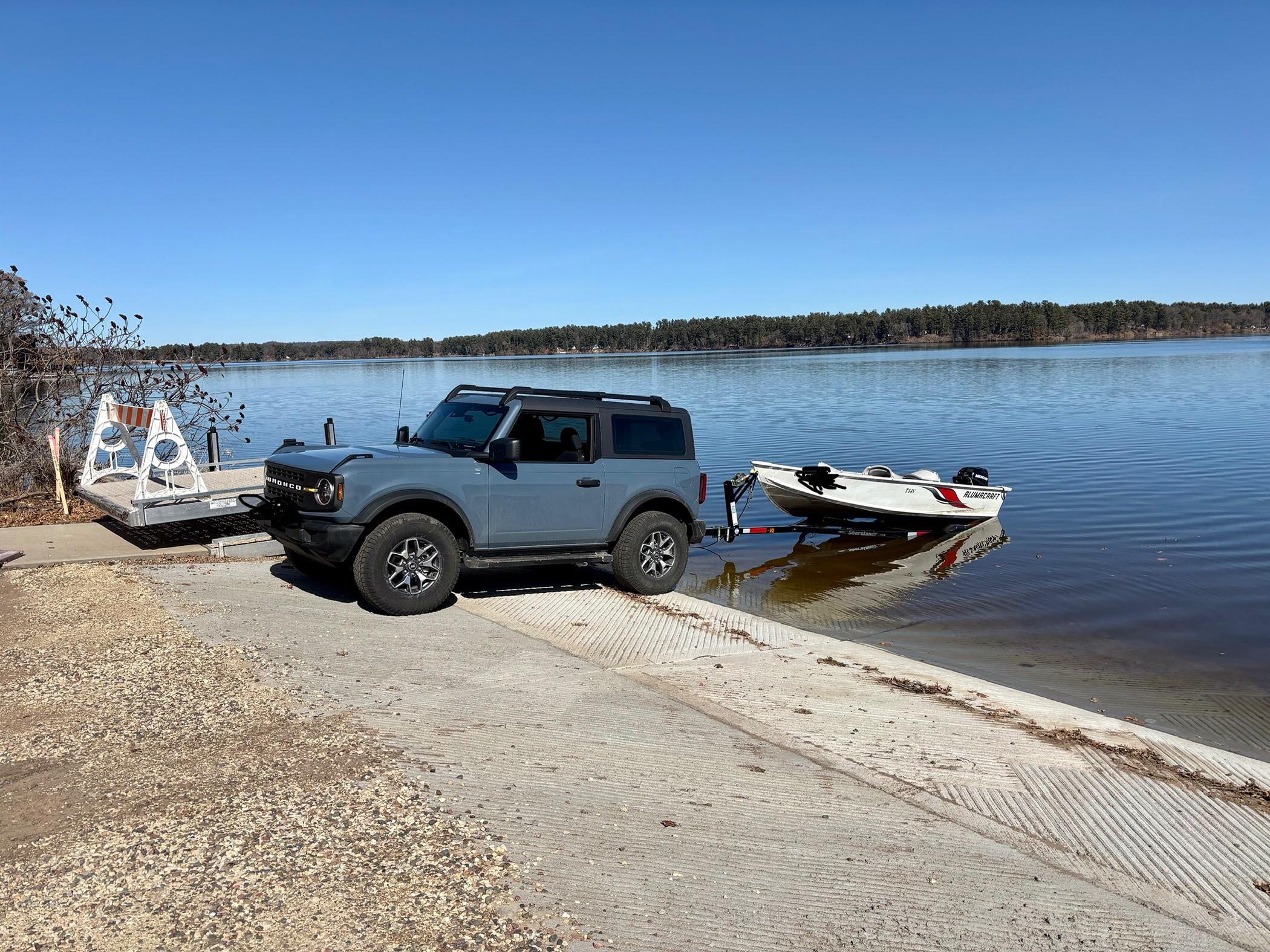

Hey OP, since you won’t post pics, I will.
This is what works for me.
I opted for a bigger drop for my ball mount so that mine could be shorter and sit under the spare tire but with enough clearance that I wouldn't have to remove the tire. I would be banging the heck out of my shins with my ball mount sticking out like that! :)

My battle is getting the trailer far enough away to be able to open the swing gate.
Extension solves that issue but the OEM receiver is so fuckin pathetic that it's actually flexing. No, not the hitch extension, but the receiver itself.
Ford really had the opportunity to build one of the best "overlanders" available but instead gave it a cardboard roof and a wet noodle of a hitch.
The rear crossmember appears to the weak point. The BRaptor has brace setup that raises capacity 1500lbs. You might look into that.
I’m not trying to be an ass, but extensions are not made for towing anything of weight because of the increase in torque put on the receiver. With an extension, you should at most only tow 1/2 your tow rating or less. With the Bronco’s receiver being both shallow and not particularly reinforced, it isn’t really surprising that it flexes. I do agree that Ford do compromise way too much on this aspect of the design.
